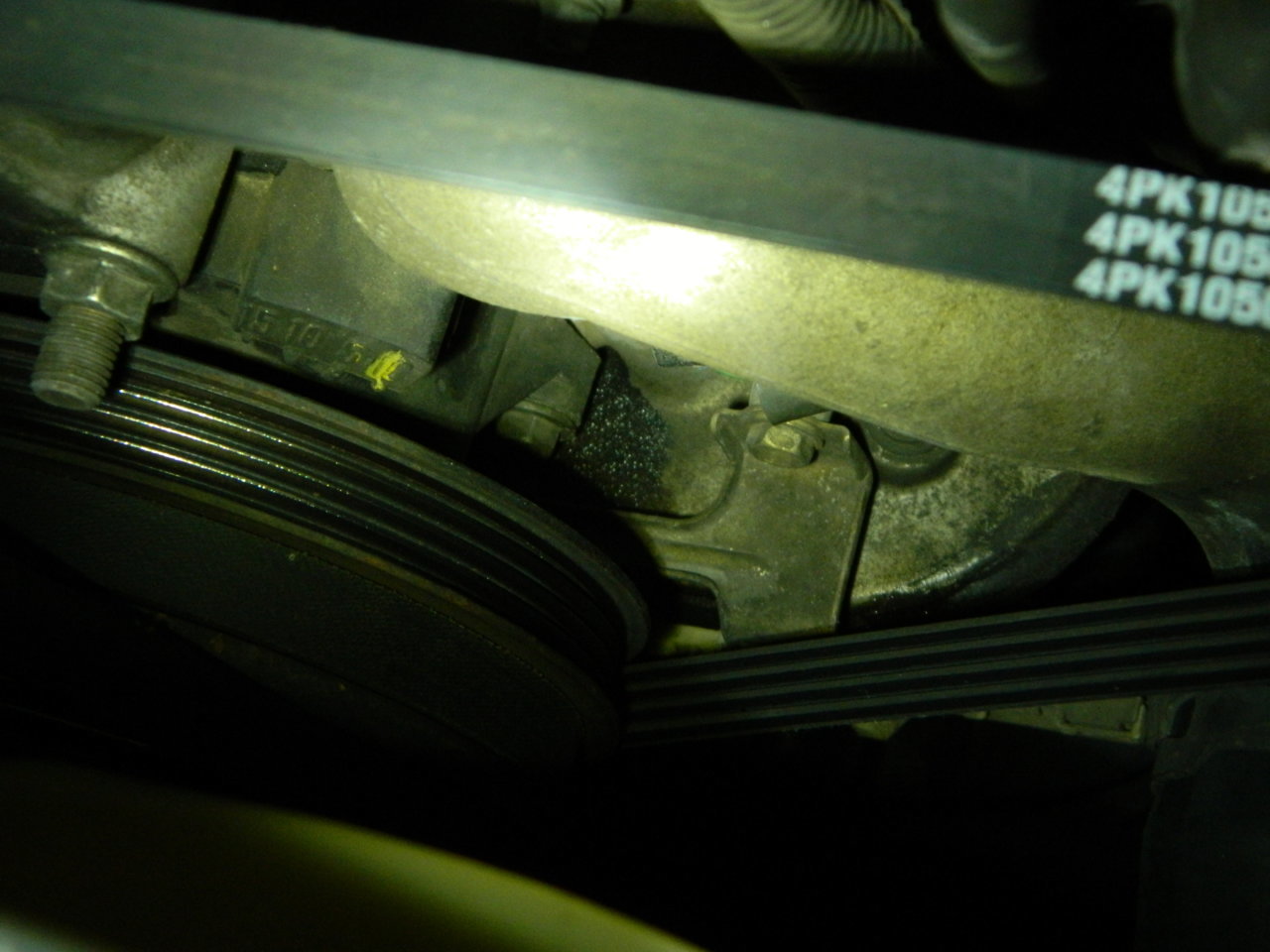

    O.P: Have you looked down below the belts at the front of the engine? When my crank and cam seals leaked, it dripped down ON TOP of the oil pan, and then proceeded down and aft from there, all the way to the sway bar and rear of engine. Photo below is the spot I'm speaking of.
