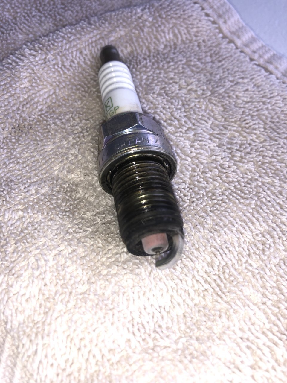

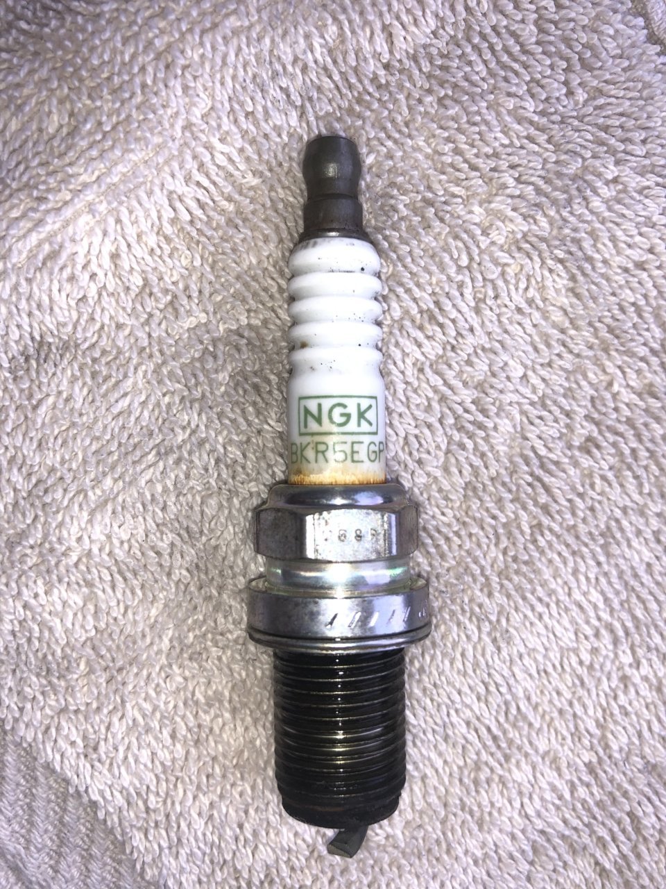

    I changed my spark plugs out yesterday and i had been running NGK BKR5EGP single electrode plugs for the past 2 years now and the appeared to be burning a little too hot so i finally changed them and went with the original plugs the NGK BKR5EKB-11 or 3967 dual electrode plugs and they make it run so much smoother! I never bought into the whole plug thing before but this will make you a firm believer.

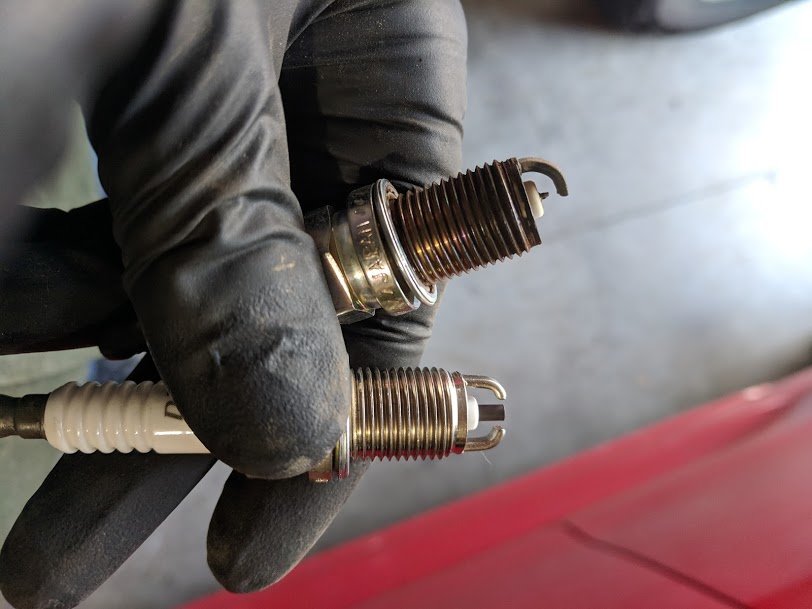

    This is what I pulled out and replaced with @ ~170k miles. Not sure if the previous owners had the plugs done at a stealership or independent shop, but either way they used the wrong plugs and now the taco is noticeably spicier.
  6. Nov 26, 2018 at 12:12 PM
    01GreenTacoma
    01GreenTacoma Well-Known Member
    Jan 9, 2017
    #207086
    849
    The ones that came out of my 2001 were the same way. Double on one side and single on the other, but one of those looks like iridium? Is the single an NGK?

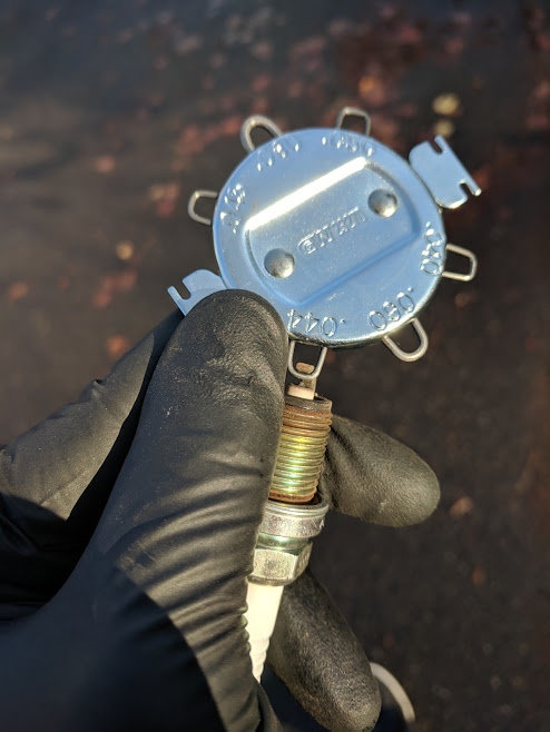

    NGK BKR5EGP

    Hard to tell from this picture but the gap must have been more than .070

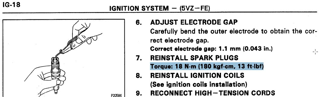

    Also did you torque the plugs or just tighten by feel? How many inch pounds did you torque to?
  18. Jan 2, 2019 at 4:59 PM
    #18
    mwrohde
    mwrohde Well-Known Member
    Mar 12, 2014
    #125160
    1,052
    Sugar Hill, GA
    2003 Tacoma 4x4 5-speed 3.4 TRD SR5
    Now I'm interested. I've never torqued spark plugs. Watching to see where this goes . . .
