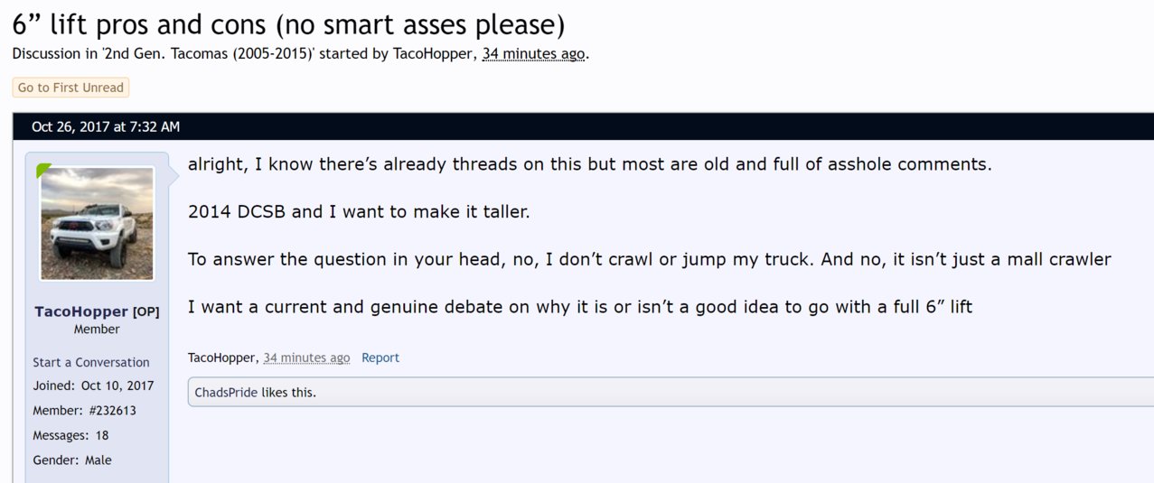

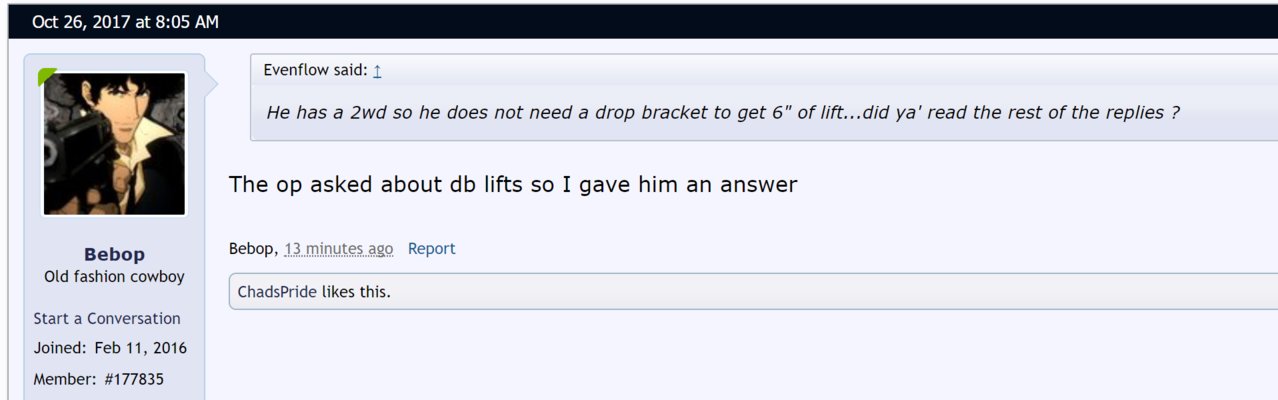

    ...oh and @ChadsPride you just lost credit for 100,000 likes for liking that
    EDIT - @ChadsPride I pasted the incorrect infraction of liking
    Here is the infraction :
    Jerry311SD and ChadsPride like this.
