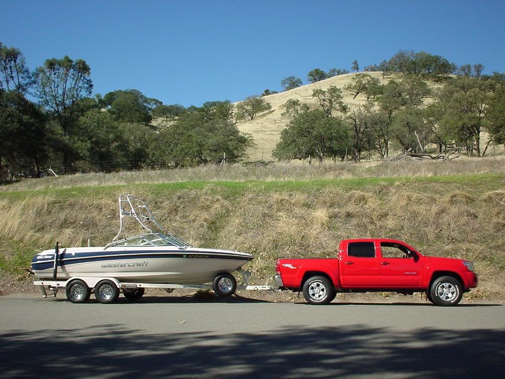

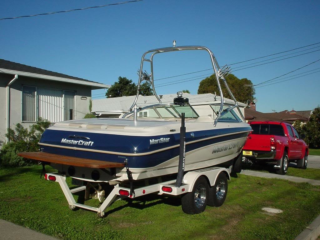

    I tow a MasterCraft that with Trailer, supplies, Gas and boat, I'm at 5200lbs. I have been told to use
    ONLY 4th GEAR
    when Towing anything over 1500lbs.
