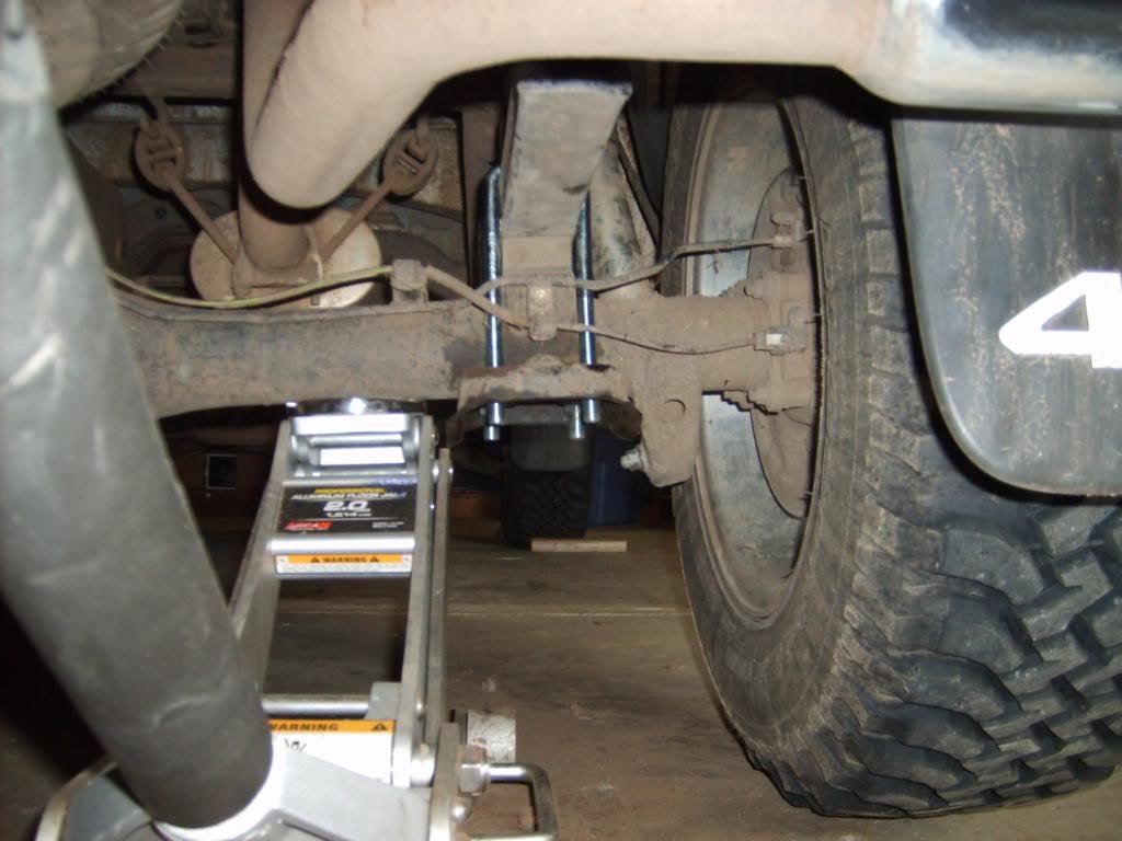

    Basically, look under the front of the truck and all of the bolts attached to the lift kit brackets should be checked over. On the rear, look on each side of the axle and you'll see the U-bolts, they're the shiny 'U shaped' bolts pointing downward in this pic. Yours probably wont be shiny, those were new ones I installed.
    Just check to make sure they're all nice and tight.
