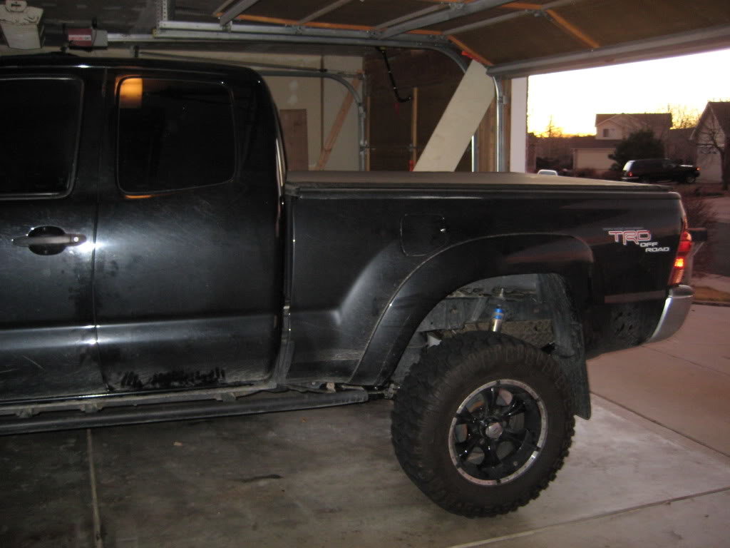

    The Alcan's definitely softened the ride and gave more flex to the rear. The biggest downside is that the back of my truck is roughly 1/2" lower than the front. When ordering that was one of my key points, that I wanted to level it out. Now I have two choices, add in a spacer or install the shackle flip to level it out again.

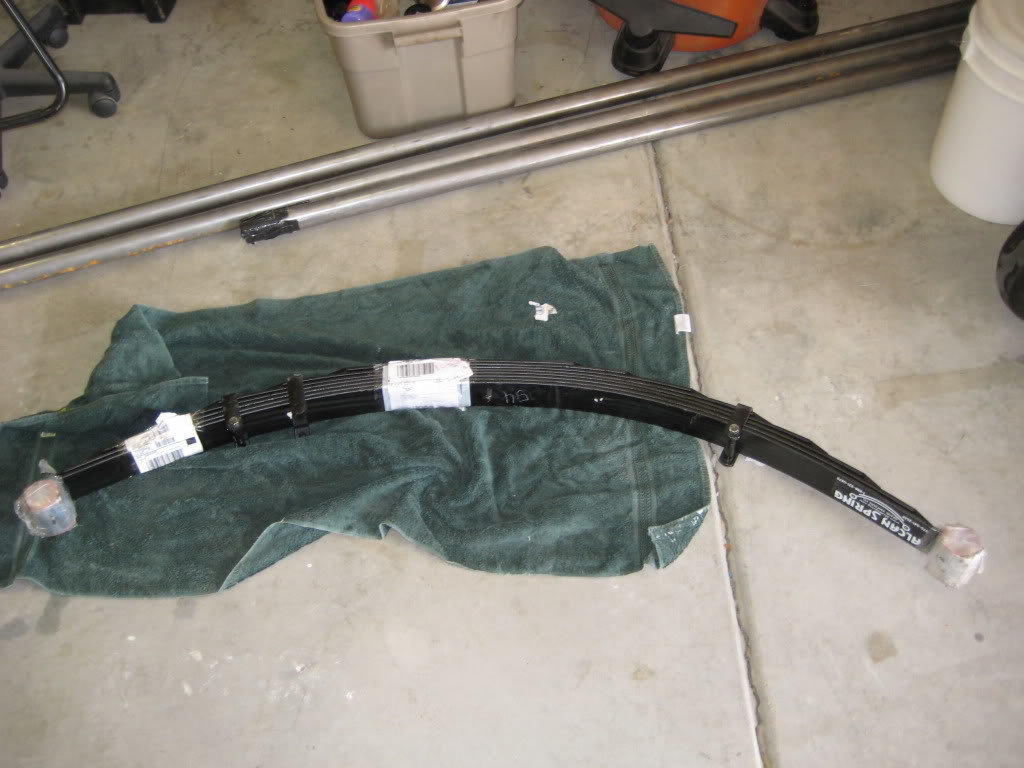

    Here's some pics of my alcan's.
    You can see the sag in the back in this pic:

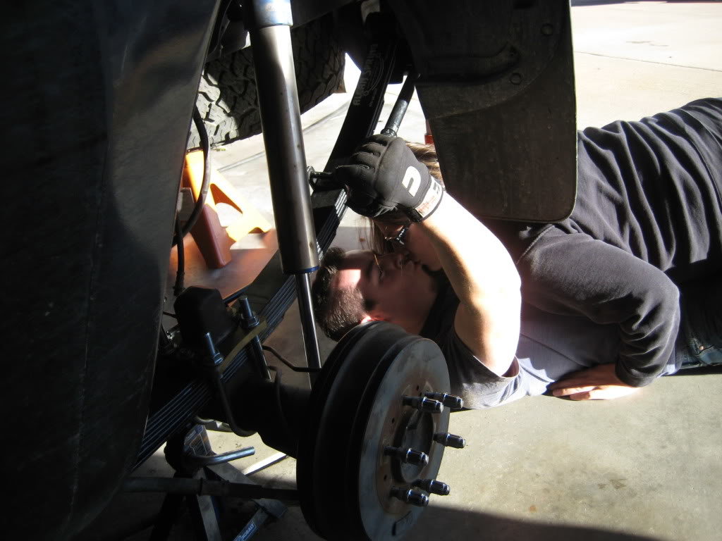

    Here is the proper way to work on your truck:
