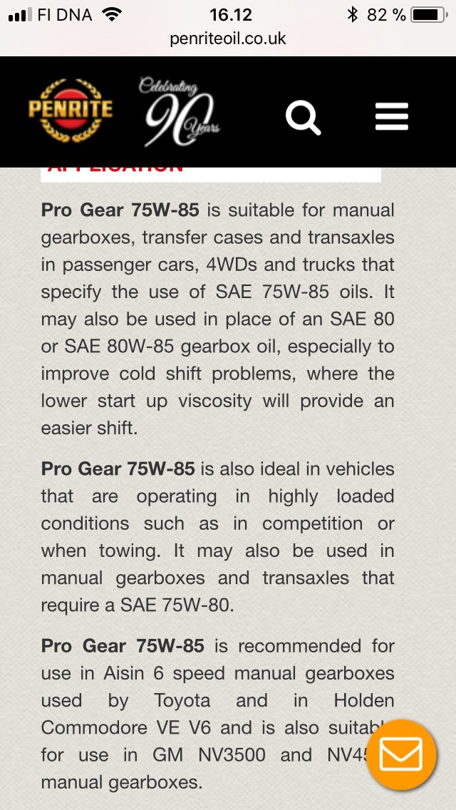

    They sell MT-85 in US too. I had first MT-90 in the transmission but MT-85 works better in cold. 75W-85 oil is suitable for Aisin 6-spd transmissions:
    and 75W-85 gear oil is which Toyota is recommend for differential gears.
    I have Red Line Synthetic 75W-85 Gear Oil in transfer box and front/rear gears.
