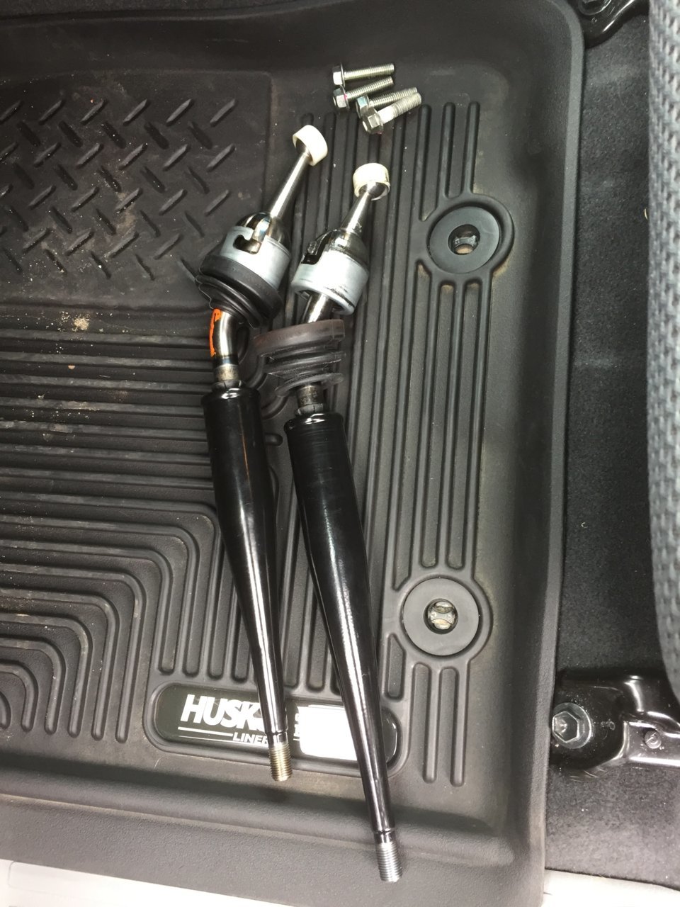

    Anyway I took the shifter apart and am trying to find anything that's missing or broken, do you see anything like that in these pictures?
    What could be preventing me from being able to go into reverse?

    Not sure if it’s normal to have all that greasy buildup in there. Here’s what my 2015 looked like when I installed the TRD shifter, but it was only like 6 months old at the time. Factory shorter is on the right.

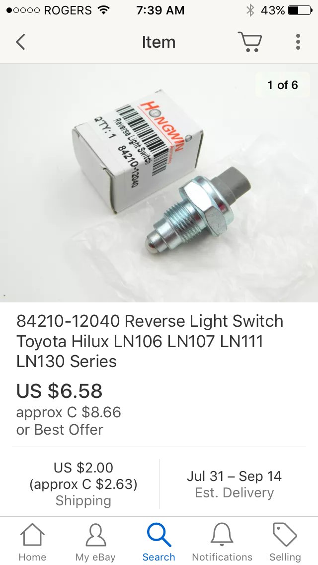

    I was having similar troubles where it felt as though I had to push the shifter lever "through reverse" before it would engage.
    My fix was replacing the reverse circuit switch, on the passenger side of the transmission. This switch has a spring loaded Normally Open contact, which is closed by selecting Reverse. On my switch, the spring was very tough to compress, and gritty. Also, the switch was only being closed after 85% travel.
    My replacement switch, PN 84210-12040 engaged with very little effort, and had "closed circuit continuity" from 10% to 100% travel.
    <ebay link below>
    https://www.ebay.ca/ulk/itm/252616694392
    *I had to file off 1-2mm of plastic of the locking tab for the pigtail harness. I filed the new switch rather than my truck side harness*
    **edit, forgot to mention.
    Got My truck with 10,000km and was was always "tricky" to get into reverse, problem made way worse when I put on URD short shifter @ 50,000km. At 90,000km I removed URD ss suspecting it was a factor. Since replacing the switch Dec 2017, never had another issue.**

    I'll also try that reverse circuit switch, where is that mounted?

    Before spending loads of money, you need to get a new shifter seat bushing. In the second picture, all that greasy buildup is parts of the bushing that has disintegrated. The part is about

    does it look like something is missing or has fallen off, where I circled in red here? and the shifter seat would cause the truck to not want to go into reverse?

    I agree with you... I had the same issue when I had my 05 .

    +1 shifter seat bushing
