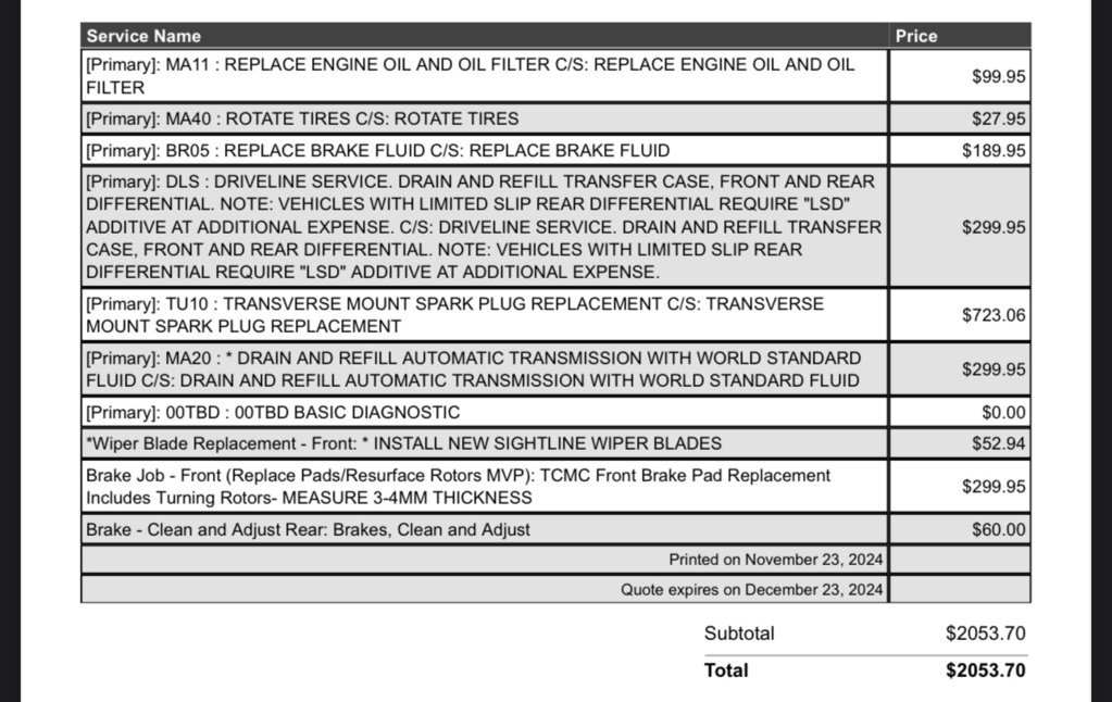

    Does this pricing look right? And do you think all this can all be done in 3 hours? Dropped my truck off at the dealer and it was
    a sh*t show. Left it there at 8AM but paperwork says they didn’t start till 3PM. Wondering if all this can really be done in 3 hours?
    When I finally got my truck after they closed it appeared the wipers weren’t changed. Then I noticed the brakes didn’t feel different either. Making me question if stuff was “missed”. I assume the pads were swapped but I wonder if they actually refinished the rotors and bled the brakes like they said…
    At least it appears the engine cover was removed. The brake fluid looks topped off but I was expecting the brakes to feel more sensitive.
    Considering taking to a smaller shop for another opinion. Appreciate any advice.

    Transverse mount engine in a Tacoma?
    Since when.....?
    All that would take me more than 3 hours for sure.
    But I'm not a tech....
    As for the brake fluid. It will feel the same with new fluid.
    Adjusting the rear brakes would make more of a "noticeable" feel.
    But at 60k?.....No.
    It will feel the same.....

    Does the pricing look right? That would be a relative question.
    They're certainly not parting from the dealership norm of getting top dollar for their work.
    Could it be done without distraction in three hours by one proficient guy with a lift with all the right tools within arms reach? Probably, maybe.
    You've paid the bill. I suppose the only question that remains would be, did they do the work.
    New wiper blades look new... If they didn't swap them, what else did they, or did they not do?
    If there was nothing inherently wrong with the brakes, there's no reason to expect any profound difference in feel. New pads, rotors and a flush don't necessarily translate to discernible difference in performance.

    FWIW, the price look right on par with dealership prices.
    The 299.00 for front, rear and transfer case is actually lower than I've seen at most places.
    Most are individually at about $150 each.

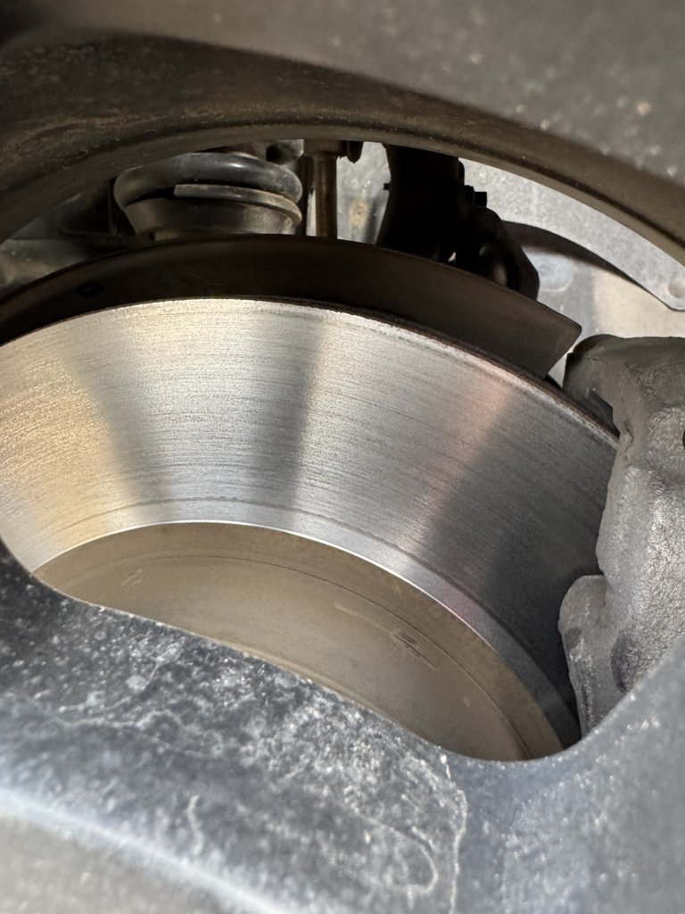

    You can look for a lip on the rotor surface. There should be no lip on the outside edge of the rotor if they were turned.
    And to be honest, i don't know any tech that would NOT turn them. Most replace them. Come backs for brake noise is "aggravating".
    You always do EVERYTHING possible to eliminate brake noise and pulsation. Skipping the rotors will bite you in the ass. No real tech does something like that.....
    Not on a customer car.

    And I'll second the rotors.
    A freshly turned rotor is as impossible to miss, as one that wasn't.

    do these look resurfaced to you?

    Yes, they looked to have been turned.

    *$300 is fair for brakes and turning rotors IF THEY WERE NEEDED. My rotors have been turned and at 252,000 miles are still factory. Will need new ones next time.
    * No need to clean/adjust rear brakes.
