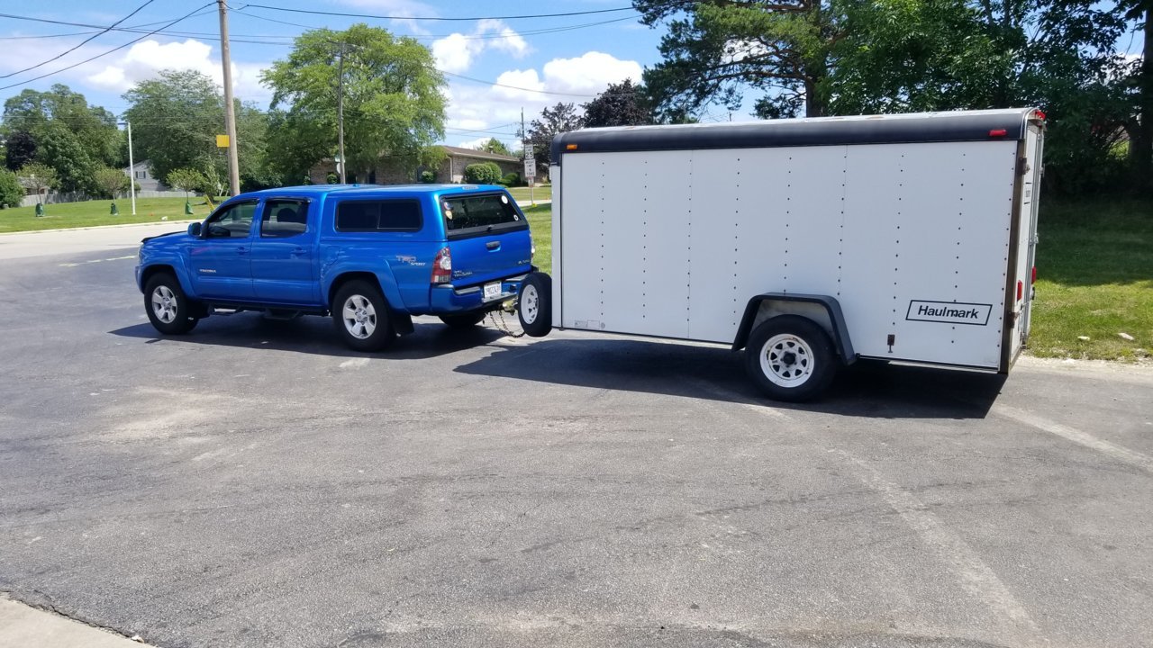

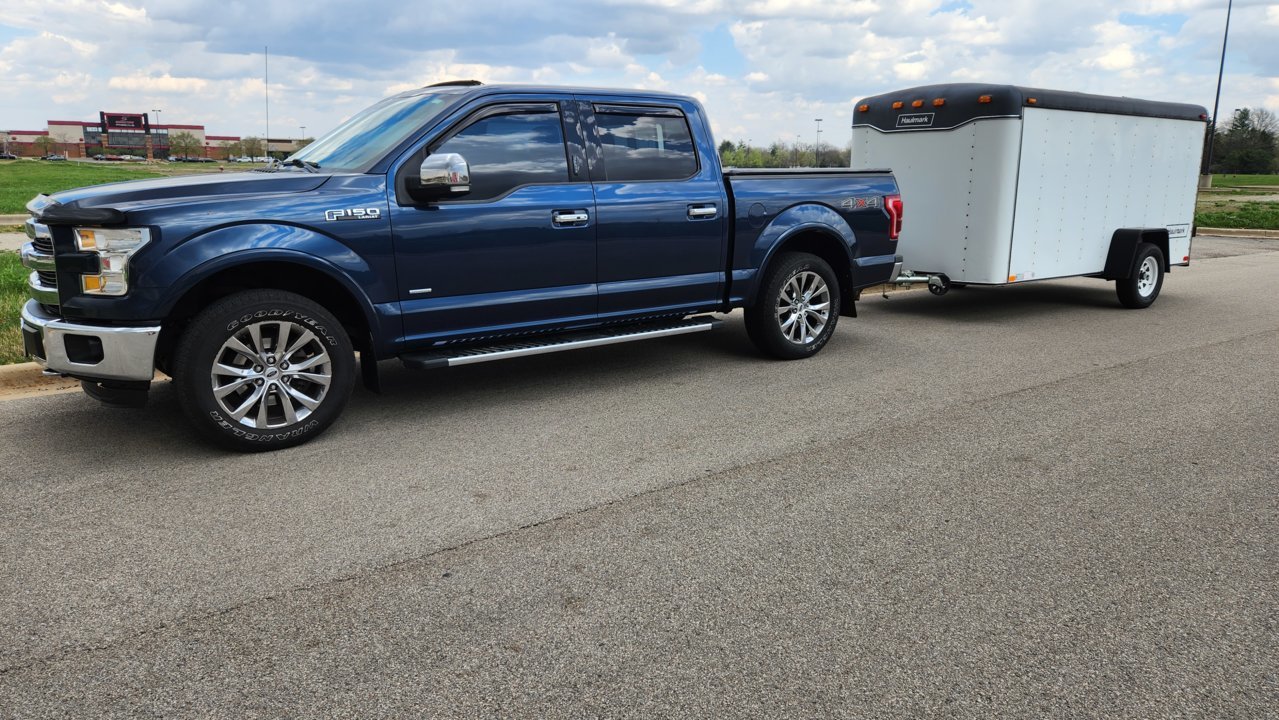

    Comparing my old 4.0L Tacoma to my F150 when pulling my landscaping trailer the F150 blows the Tacoma out of the water. What's shocking to me is my F150 has only about 500lbs more of GVWR than the my old Tacoma! Certain new F150s with the higher towing capacity packages can tow on paper 14k!

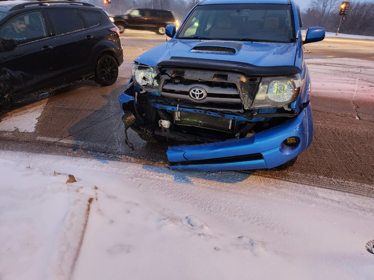

    Well I miss my Taco. Didn't really get to choose when it was time to trade it in. Someone made the decision for me. If it wasn't for that guy that day I'd still have my Tacoma:pout:

    Knarly Ben ! ... glad you're ok
