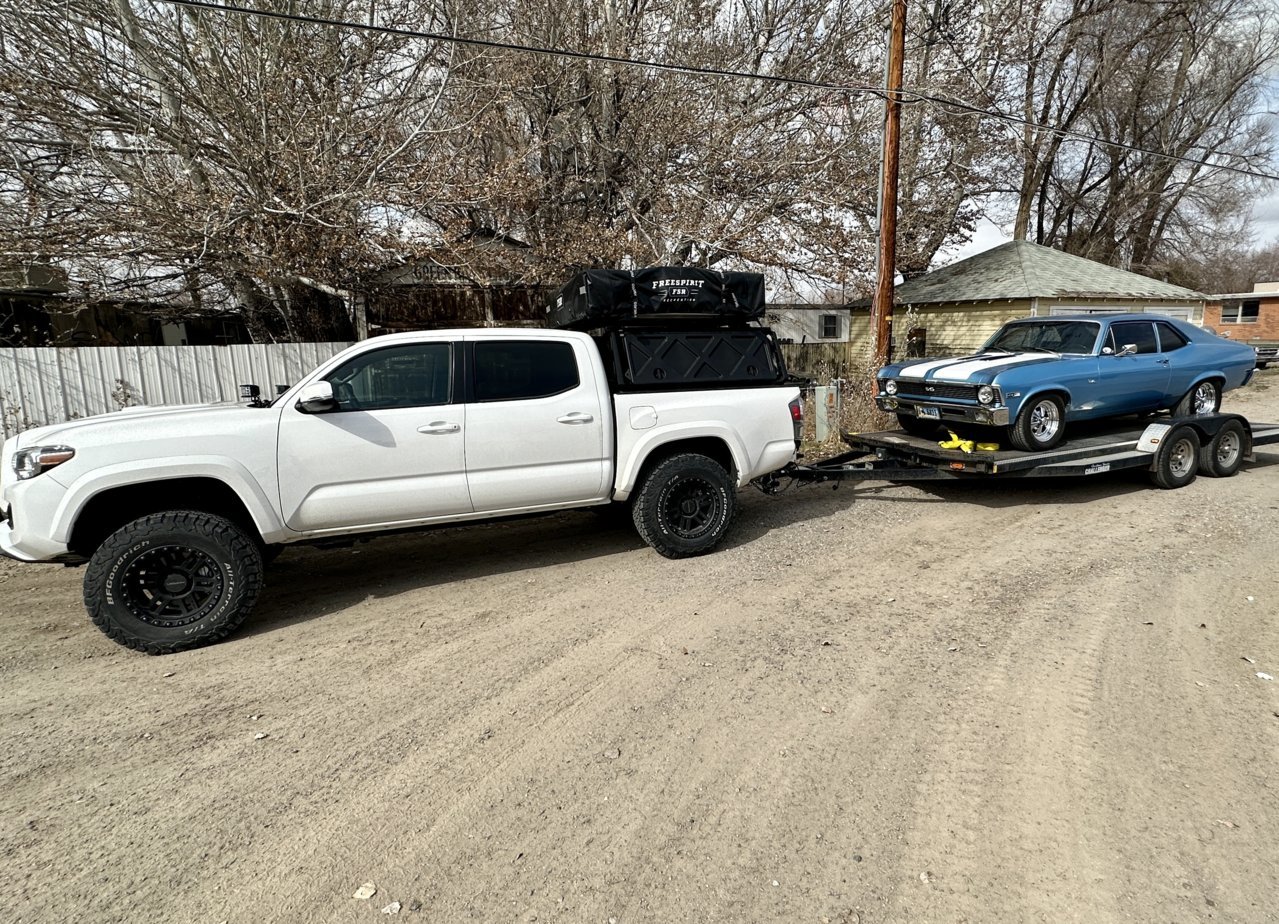

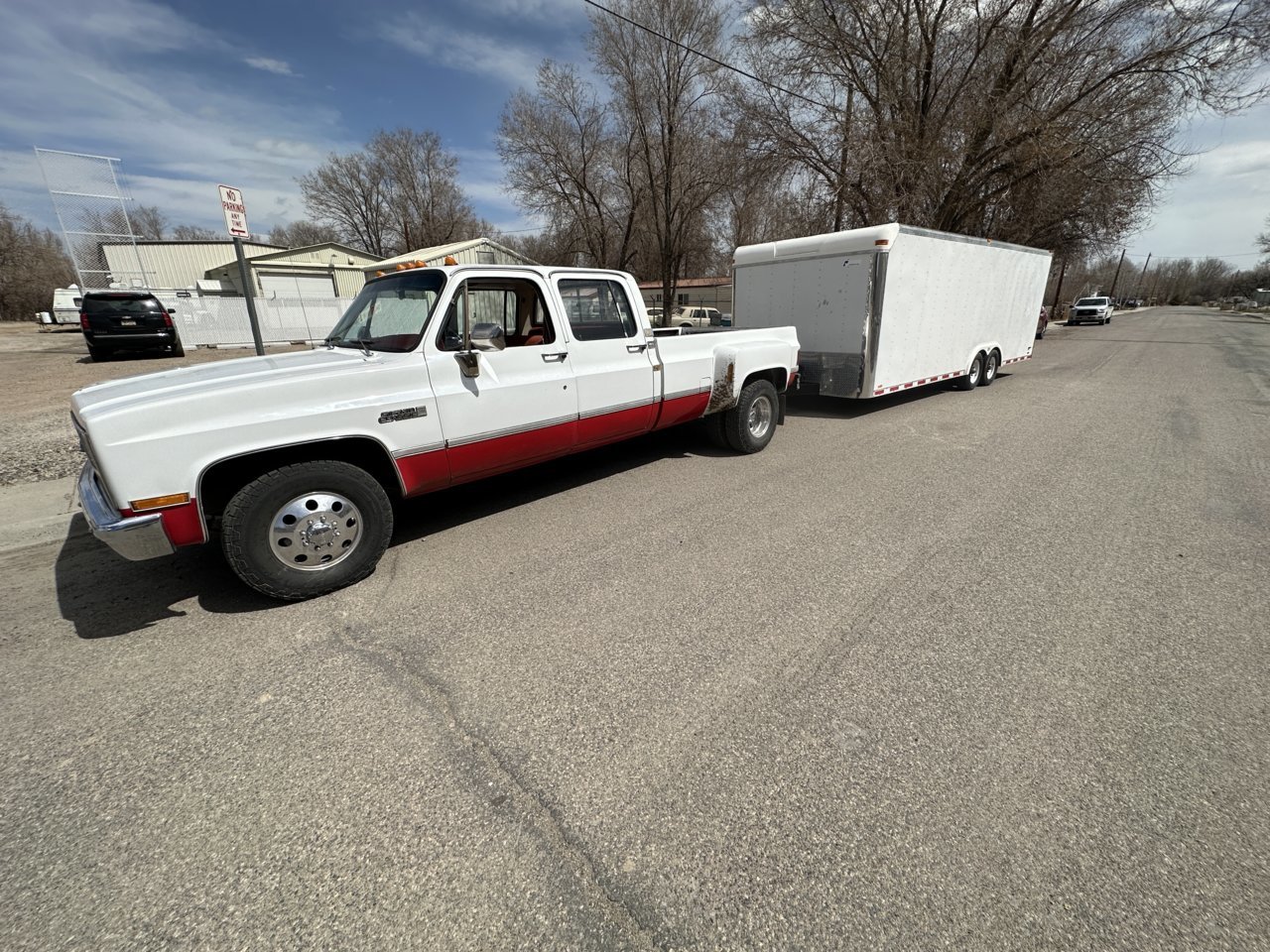

    My dude, I pulled a 3500# off road travel trailer full time for 9 months and it was a square drop and I had a roof top tent on my taco as well. 60 MPH winds gusting to 80 through Cheyenne and Casper was effing miserable and I averaged 6 MPG from Cheyenne to Casper. Stock gears and a stock tune were no help. That is with a 3500# trailer that has a lower profile than what you are considering.
    I cannot imagine towing the weight you are considering more than a few miles across town. F to the No, I don't think you should tow that trailer with your Taco.
    Here are a few of my towing pics if street cred is in question.
    The Nova I only went about 6 miles across town. Keep in mind I have a heavy OME setup with the stiff dakars in the rear. Re gear to 5.29, ott tune, lockers for more fun off road, and an external trans cooler are my last upgrade items on this rig.
    When I tow heavy I tow with my 7.4L 4spd dually.
