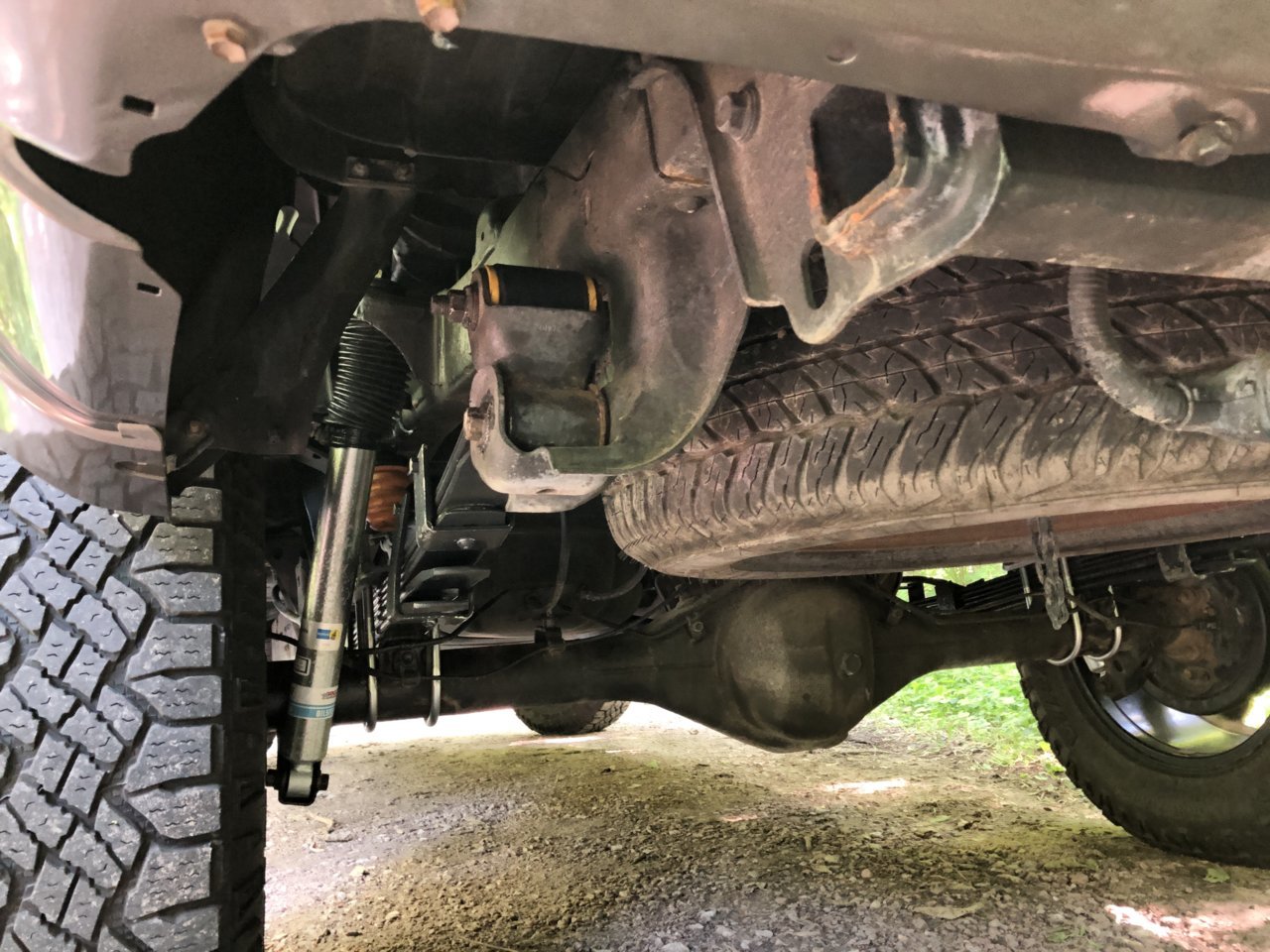

    I used a GM 15712438 bump stops as they are the length I needed, they are progressive (meaning they get stiffer as it compresses which is nice so acts as a buffer instead of a hard stop) and they are far cheaper than other bump stops specifically made for our applications. I know sumo springs and others are great products, but $200+ bump stops seem outrageous to me, just my opinion. You can kinda see the bump stops in the picture below.

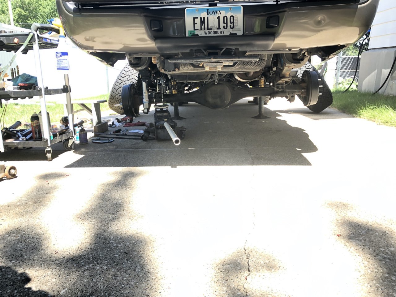

    Just to give you an idea of resting droop between B110 5100's (on the left with dakar leaf springs) and the stock (right) rear shock. The available droop is actually more than what is seen here since there is no additional weight on the left, I would say by at least 2" more available droop. It looks like the axle is resting on the jack, but it isn't.
