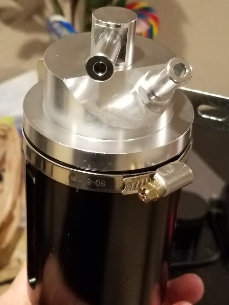

    Anybody in here have catch can?? Just bought a new one and make sure i have it hooked up right. Have the pcv vale dumping into lower part of the can and the higher part bringing air back to the intake. That is correct right?

    I'd assume that was correct as you'd want the oil to dump lower than an intake. I don't have one but was subbed to this thread for awhile.

    Exactly pcv to bottom of the can. Top vent to the intake. If it is just an open can with no baffles stuff some steel wool in there.

    ok thanks guys. :thumbsup:
