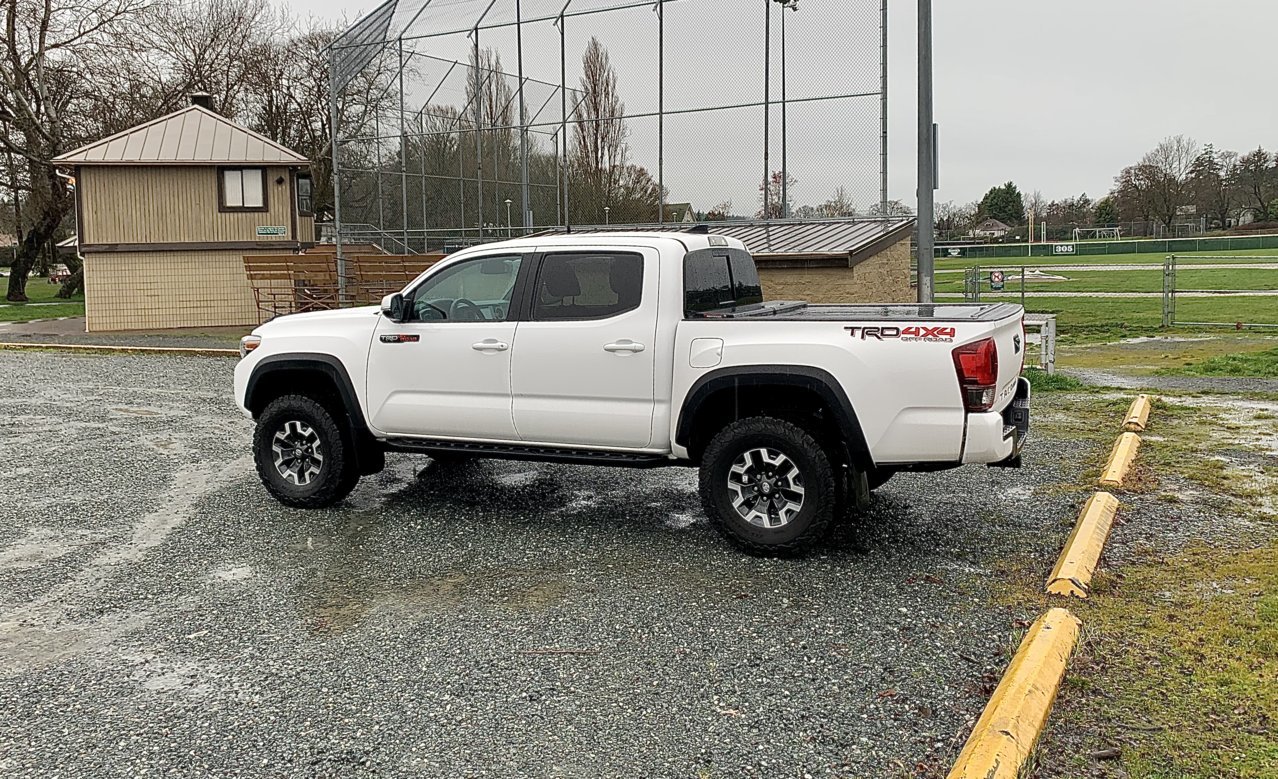

    I have about 5k mi on mine and feel the ride is nice though a small bit firmer over the stock OR Bilstein's. I am at .65 in the front on stock springs and no rear lift for now. On road I run the stock Wrangler tires and the ride is perfect. Off road I'm on 235/85 r16 Falken Wildpeak MT01 and I feel the 5100's have just the right amount of firmness and stability.
    Ride height with the Wildpeaks:
    With Wranglers:

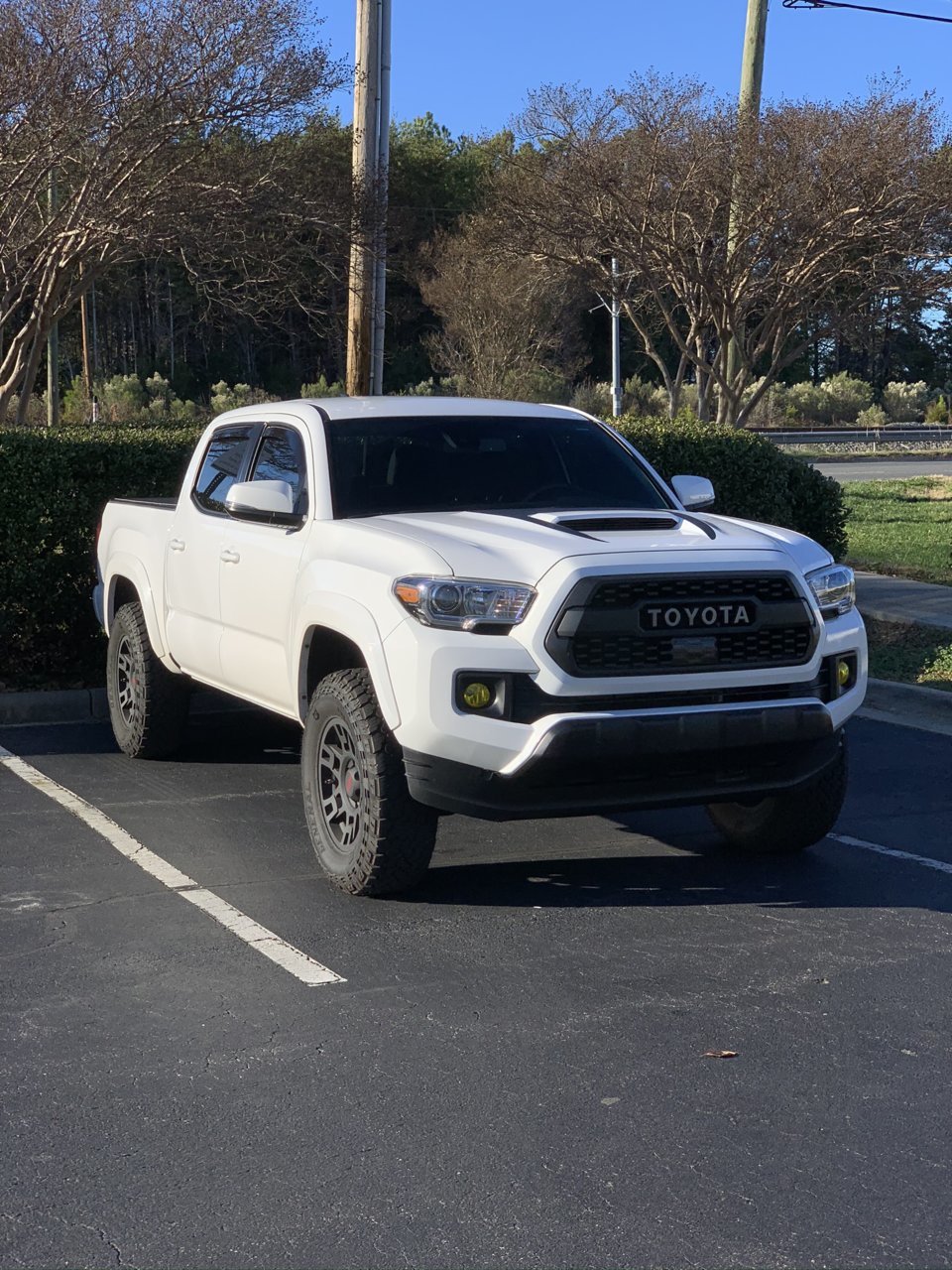

  6. Dec 29, 2019 at 1:16 PM
    #26
    DSMHokie
    DSMHokie Well-Known Member
    Jul 11, 2013
    #108050
    67
    Caleb
    Charlotte, NC
    2019 Super White TRD Sport DCSB 4x4
    Bilstein 5100s on 3rd Setting (1.1”) TRD Pro Grille 17” SEMA Wheels 265/70r17 General Grabber ATX Custom Fabricated Sliders Lomax Bed Cover
    I have only had mine on for probably a month but was in a similar situation to you with a Sport. The right definitely improved and the truck feels like it takes bumps better than the stock front Sport suspension did. I am planning to eventually do aftermarket coils and AAL in the back but am going to run this setup for as I am very happy with it then once I get bored do more. I had the shop put mine on 1.1" setting and sits perfectly level to me. Sitting on 265/70r17 for reference.
