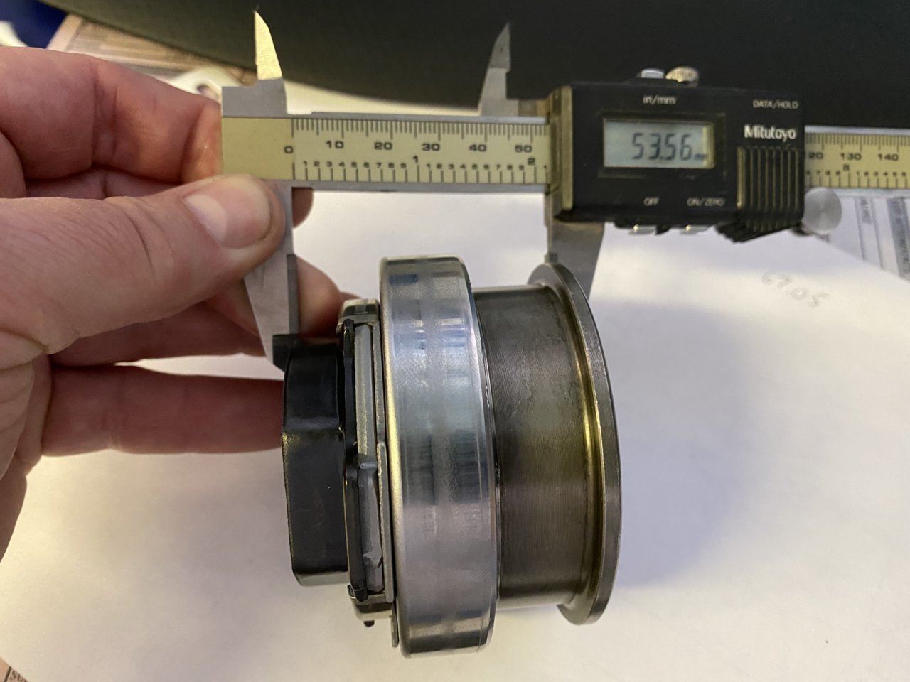

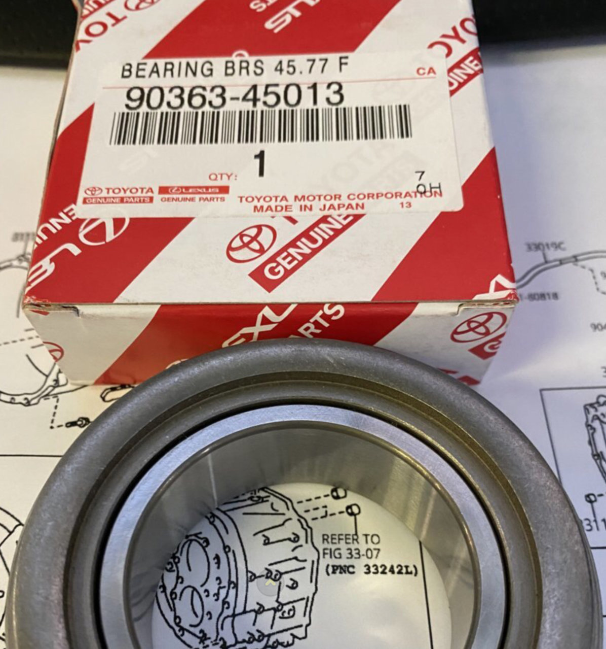

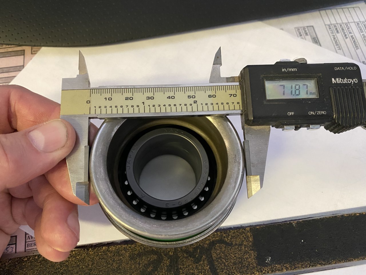

    90363-45013 x 1 Is the actual clutch release bearing suitable for the 2nd gen OE clutch pressure plate with 60mm diameter opening in the fingers. You will likely have to source it from overseas. I ordered mine off of ebay. It shipped out of Dubai. It only took 3-4 days to receive.

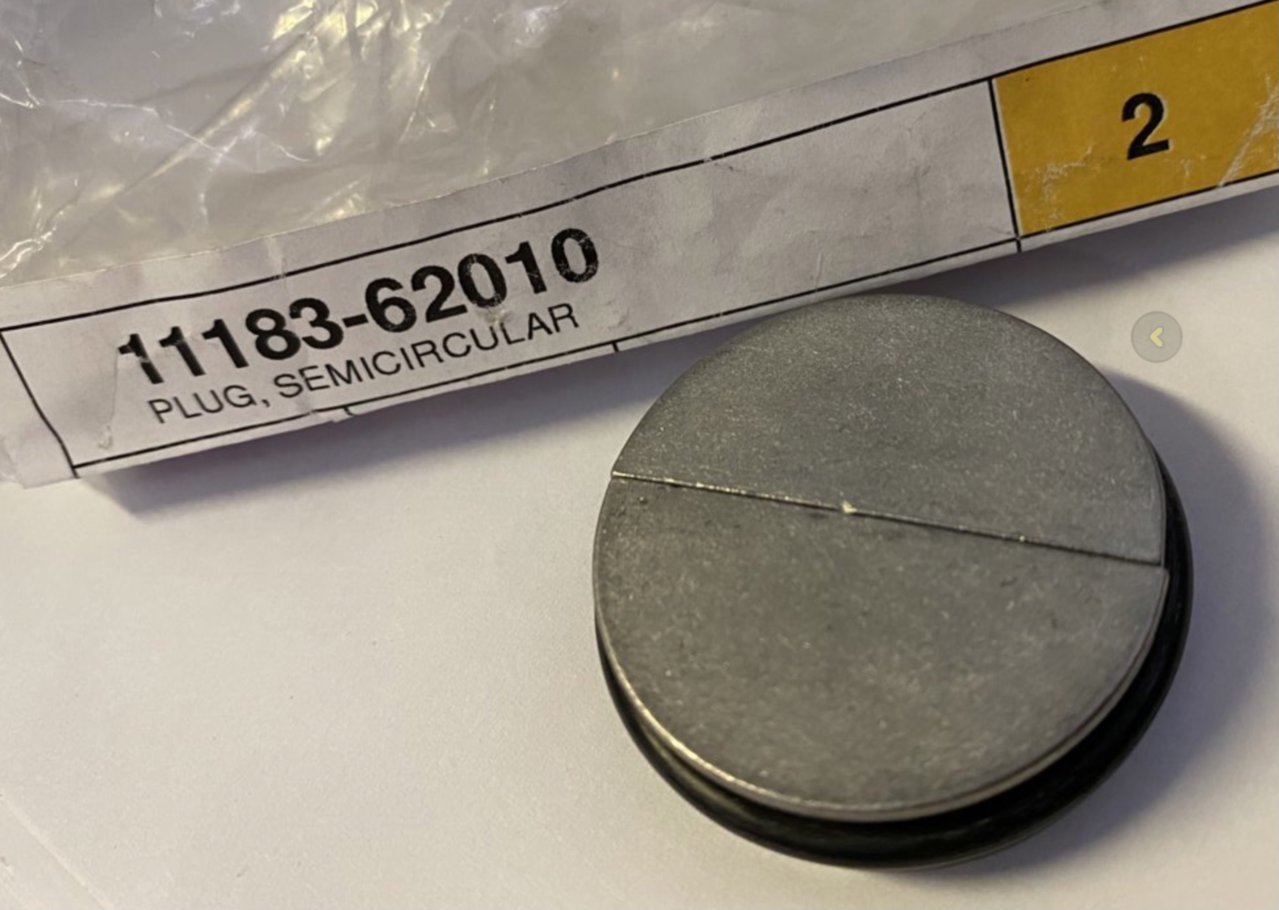

    11183-62010 x 2 I modified and used these half moons to seal up the 34mm hole where the original release cylinder was. I haven’t tried, but I’m betting that, due to casting differences, these will only work with the RC62F. @Kasbien kit users will not need these.

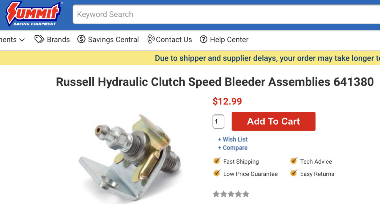

    Russell 641380 Speed Bleeder. Not absolutely necessary. But, nice. Summit Russell Napa

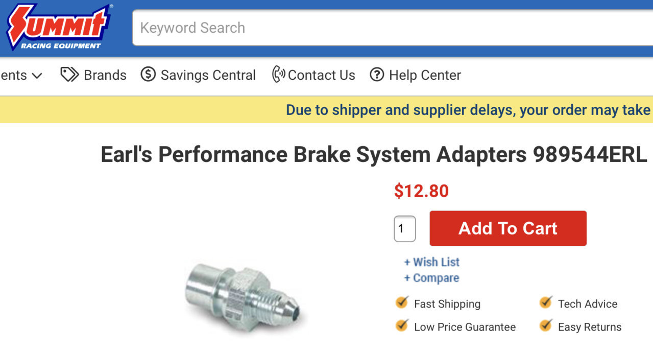

    Earls 989544 adapter fitting for OE hydraulic hard line to HRB connection. Summit

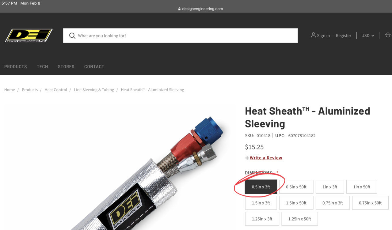

    DEI 010418 Heat sheath Summit DEI

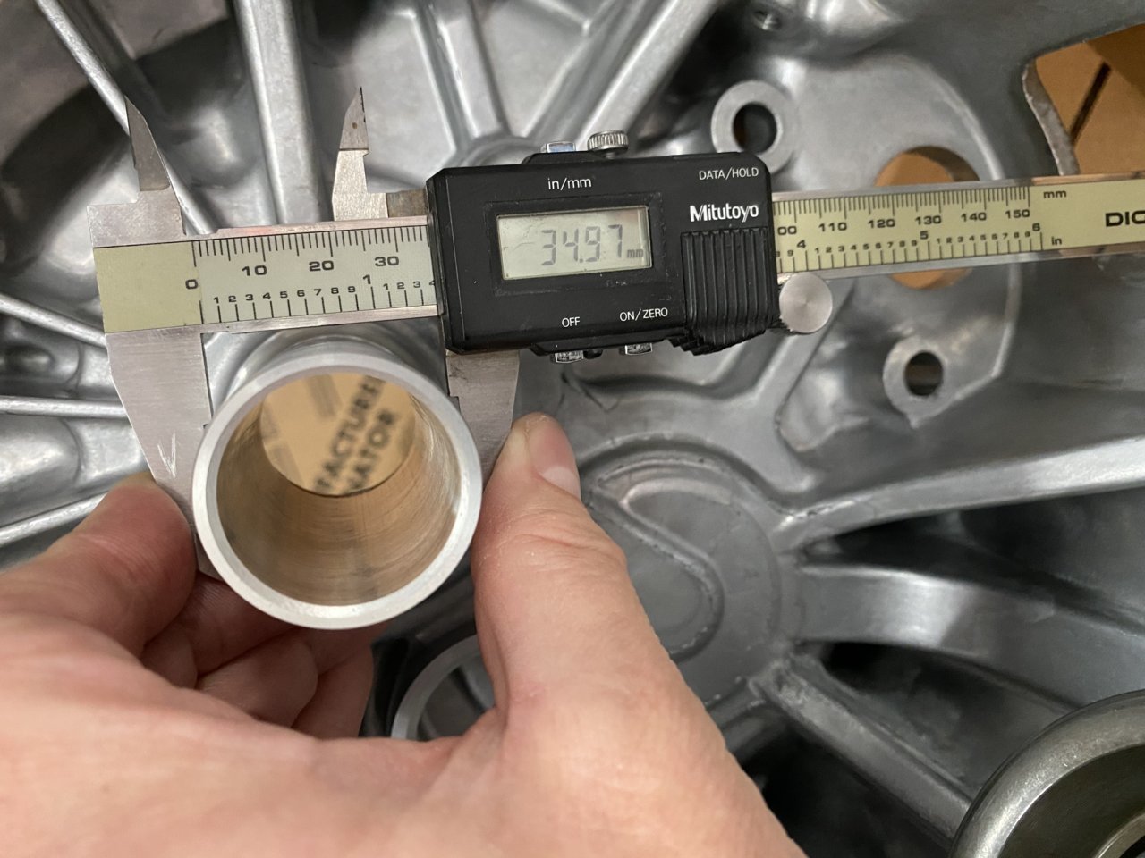

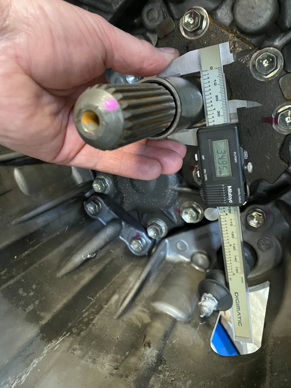

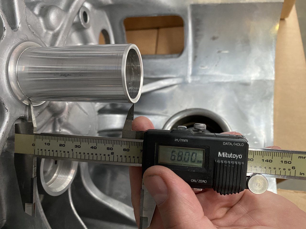

    A few pics with part numbers of some of the stuff I bought…

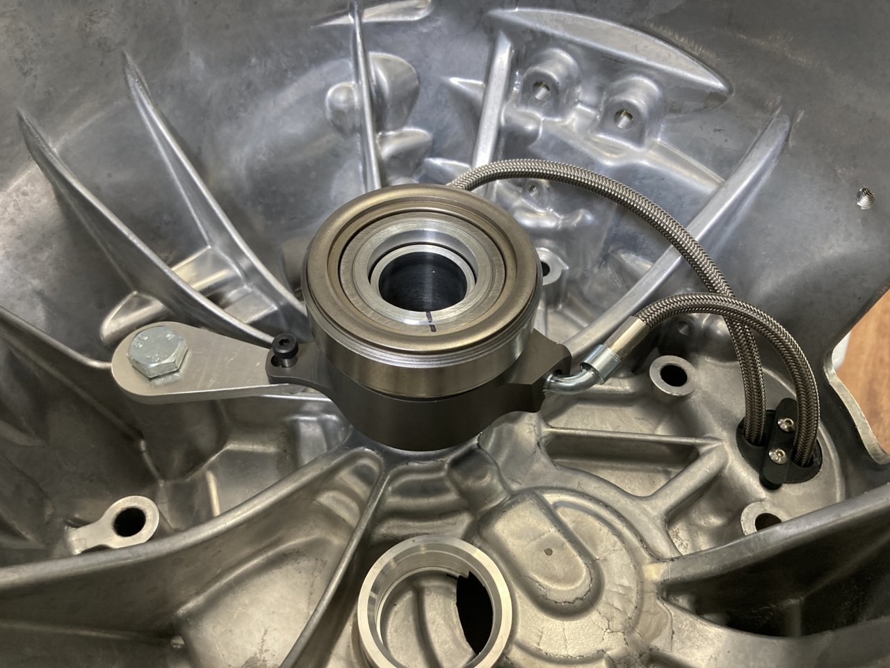

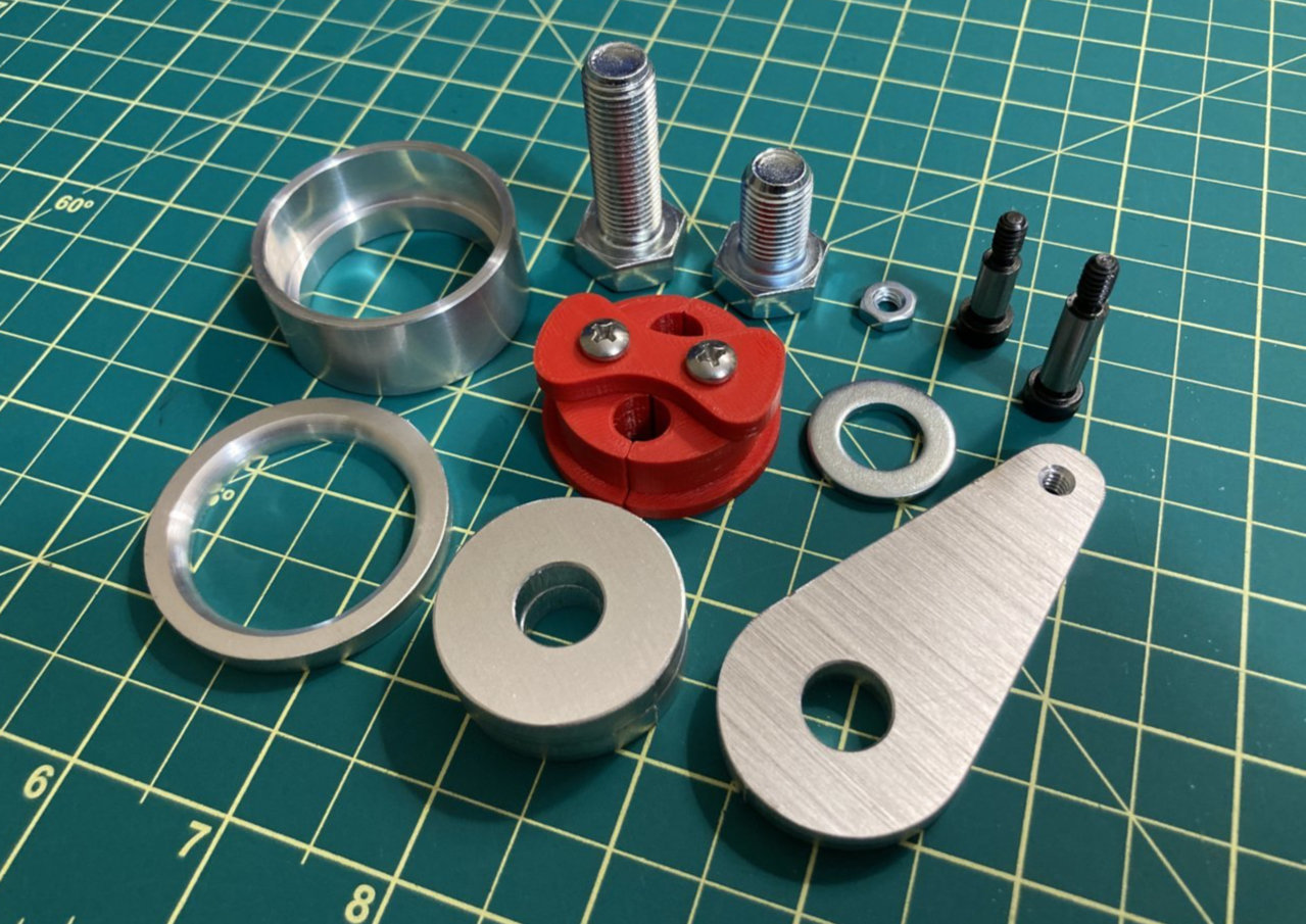

    So, I'm going to skim through this thread and dump the highlights into this post. It is a work in progress as I attempt to organize the info contained in this thread for easier digestion.
    That being said, I do still encourage you to read through the entire thread as I will inevitably forget an important detail or fail to completely explain something. Please, if you see anything that I need to add or edit, let me know.
    Toyota 90363-45013. I’d like you to meet Tilton 62-612. I think you two are going to get along great.
    Spacer to mate piston to bearing machined and then assembled. I ended up machining for a .001” interference fit. I then froze the piston and heated the ring. They slid together like butter. I forgot to take pics of that part.
    Here’s the piston back in the freezer about to be mated to the bearing. You can see the spacer already installed here. I even have the spacer pre-lubed with a light coating of grease. Dont tell the wife. Yes, those are ice chunks it is sitting on.
    Aaand here it is pushed into the bearing. Took a bit more force this time to push it into place. I’m guessing because my spacer ring had “grown” .001” or so after it was installed on the piston. Next time I’ll be ready for that little change.
    Slid it all together and a quick test fit in the RC62F. It would look pretty much the same in the RA60F.
    The old RA60F and the new RC62F side by side.
    Spec 3+ clutch has landed. This thing is pretty gnarly. The disk is quite heavy. Which is a bad thing. I do not recommend this clutch. At least not this disk.
    Got the flywheel back from the machine shop. Here’s the way it looks when cut on a true flywheel machine. 1.5mm or .060” is the correct spec for the step. Make sure your machine shop understands that. Also, MAKE SURE the alignment pins are installed in the flywheel. Machine shops love to forget to re-install these. They do not come on a new flywheel either.
    Difficult to see here. For the RC62F, When the bearing height is adjusted to where it needs to be, the anti- rotation tab on the Tilton unit ends up below the boss for the pivot ball.
    I made the bracket to hold the anti-rotation pin. I just used some aluminum scrap I had laying around. I’ll replace the pivot ball with a proper bolt before final assembly.
    As viewed through the inspection hole in the bell housing. By looking at this pic, I can see that I still need to massage the threaded sleeve to fully sit against the base of the quill. This is one thing where the RC trans differs from the RA trans. It seated perfectly on the RA.
    This is a better angle to see how the anti-rotation tab sits behind/lower than the pivot ball boss. No problem. We just put the pin in @BassAckwards ;)
    Chucked up and ready to knock that edge off. This step won't be necessary for those of you using the @Kasbien kit. He has created a spacer to handle this.
    Ahh. That’s more like it. Sleeve is fully seated against the base of the quill.
    I added some shrink tubing on the bolt that is acting as my anti-rotation pin. Just to tighten things up a bit and to help protect that hydro housing from getting too chewed up by those threads.

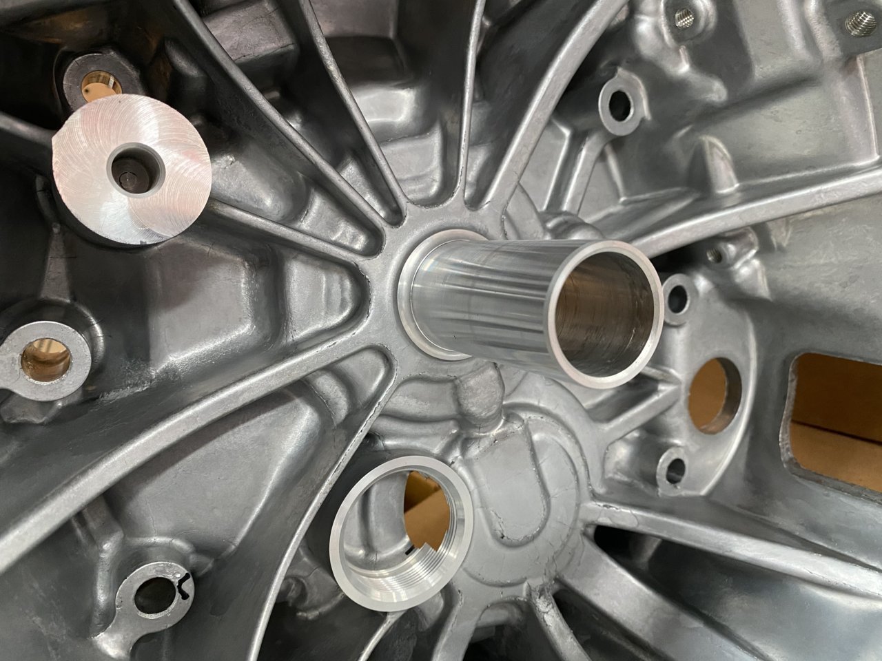

    So, sealing up the 34mm hole where the OE slave cylinder was is something that still needs to be done. But, I have an idea...
    So, this is what I did with those half-moons: This step won't be necessary for those of you using the @Kasbien kit obviously.
    Flywheel is bolted up. Always use new OE flywheel bolts. Torque them evenly in a cross pattern to 22 ft lbs. Then turn another 90° in two steps. I use a sharpie pen to mark things and then do the 90’s in two steps. The bolts are designed to stretch a particular amount. That's why we replace them EVERY time. They're not that expensive. /rant
    Spec 3+ clutch is ready to go.
    New bolts for the clutch pressure plate too. The previous clutch took a lot of torque on these bolts to get the pressure plate seated against the flywheel. So much so that I thought that I was going to break them. Definitely wanted to replace them for this go-around.
    All bolted down and ready.
    Make sure the pressure plate seats against the flywheel. You’ll feel it contact as you tighten the bolts. I’ve heard several stories of pressure plates coming loose. Likely from the installer not paying attention and just shooting for a torque spec.

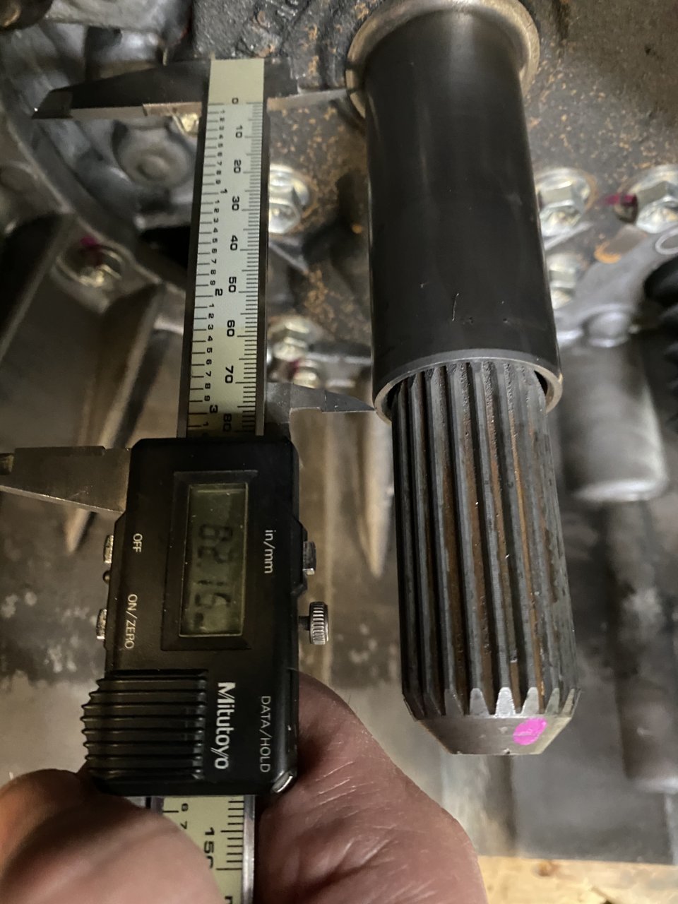

    This was my first attempt to rig up a way to measure finger height. It didn’t work out. The back end of the rulers were hitting the trans tunnel of the body.
    Rummaging through my garage, I found some door frame shims left over from a house project. That’ll do. Paint mixing sticks would’ve been good too. But, I didn’t find any.
    Here it is in action. Final results: 105mm from block/bell housing to clutch fingers. So, that means that we need to set the release bearing to be 108mm deep in the bell housing. The 3mm gap allows for clutch wear.
    Transmission is in! I’d say that I nailed it on the bearing gap.
    A little extra insurance against any thermal issues. I slid it all the way up to the topmost pressure line holding bracket on the back of the engine block. It’s all bunched up here until I get the hardline connected to the braided line. At that point I’ll slide it over the full length of the pressure line.
    As I was typing the previous post. The delivery truck of happiness showed up.
    One more thing done.
    Here’s the connection with the adapter in play.
    Had to split the heat sheath. It was just a bit too small to slide over the adapter.
    Bolted down the Russell bleed bracket. Pretty cool. Should make bleeding a bit easier.
    OE RC62F heat shield in place. I notched the bottom of it to make room for the bleed line.

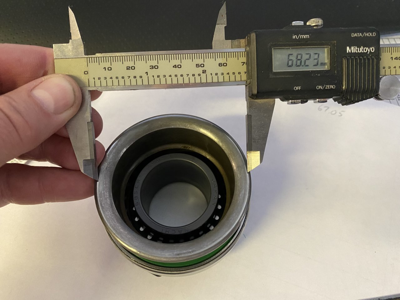

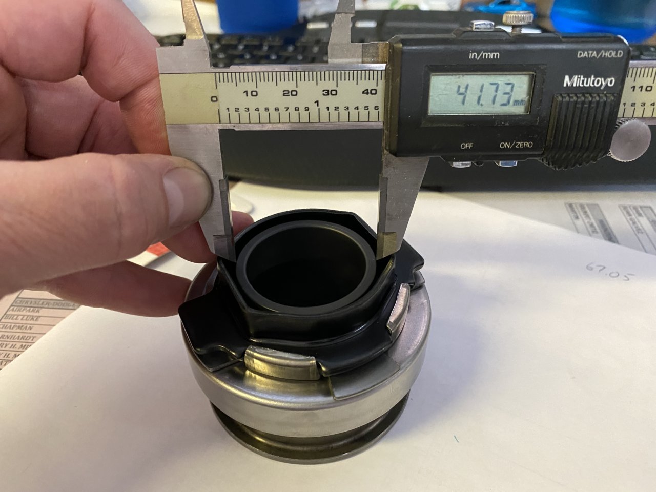

    When researching how this was all going to work:

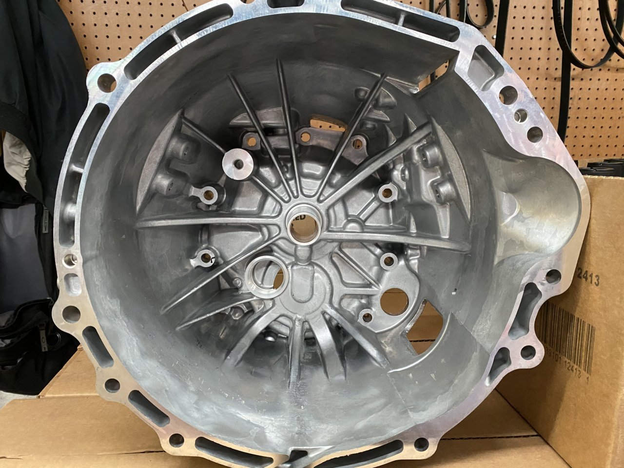

    RA60F bell housing acquired for measurements and test fitting.
    Below pics are the RC62F of the 3rd gen Tacoma

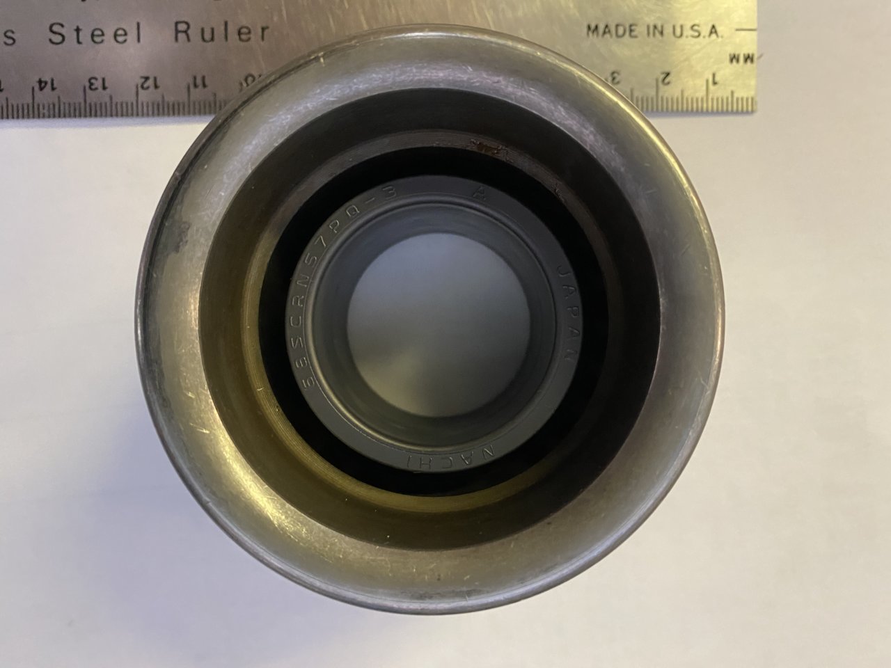

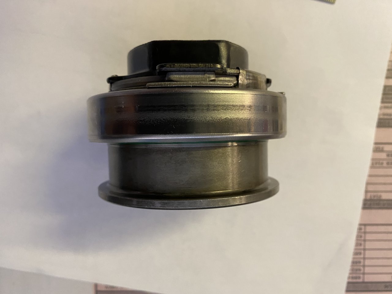

    OE RA60F throwout bearing:
    The new 90363-45013 bearing:

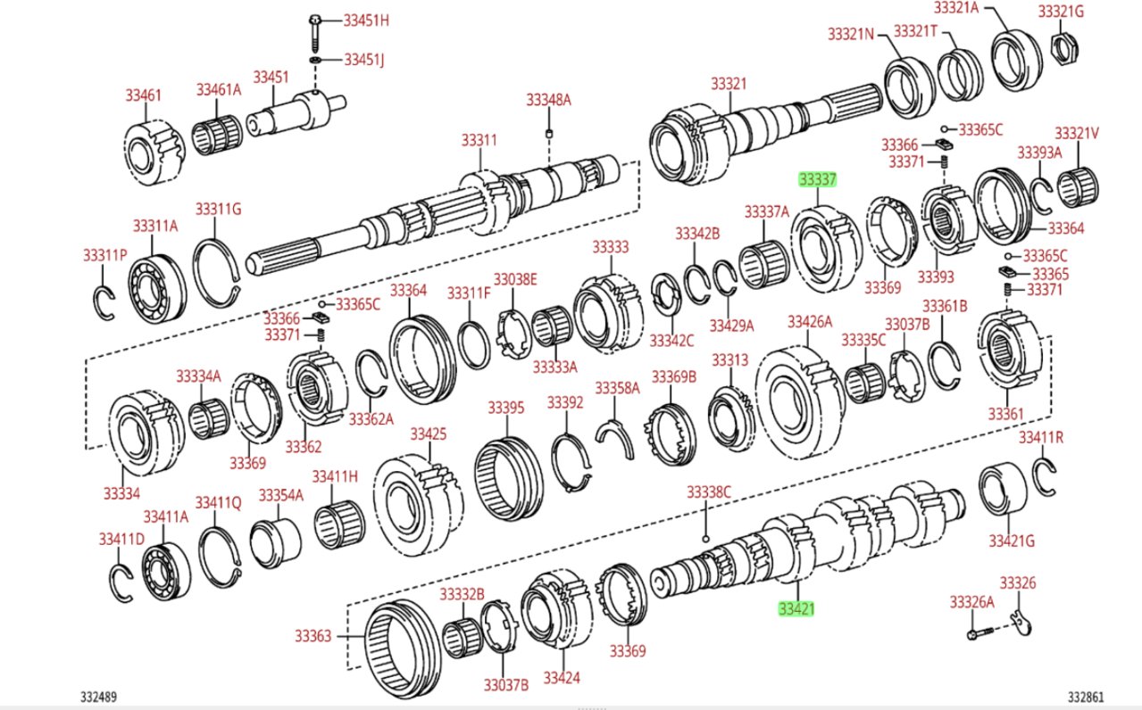

    1,876
    I don't want to be the bearer of bad news but you do know that the whole transmission has to come apart, starting at the rear side, to get that thing on? Neverless, I've followed your travails and you probably already know that. Sorry your hydro bearing has been such a pain...

    Yes. I’m aware of what needs to happen to replace that. I do not intend to. My existing one is fine. I ordered this thing to get some measurements and to test fit things.
    I do however intend to dive inside of mine when it’s out. I have a slight grind going into third that I want to address. I’m also contemplating a swap-out of 6th gear and the countershaft to the .799 OD of the FJcruiser. But, that’s another thread.

    d have done
    Wished I had been following you a bit closer as I have one and could have done the measurements for you.
    I have been into a couple of these now and on your '08 the shift fork for 3rd is immediately suspect (it is crummy cast aluminum). That and the syncromesh keys and springs on the respective clutch hub have been a recurrent failure point (later revised). And naturally the 3rd syncro and its bearing (slop develops).
    If you get to the surgery stage I would invite you to PM me before spending any money on parts as there have been a boat load of part revisions quietly upgrading the transmission over the years. In addition there have been two revisions of the entire transmission, for three total versions.
    For a long time on this forum I have advocated that IMHO it would be a better idea to find a '13-'15 transmission instead, and preferably a late-'14(from March 2014 on) to late-'15 as you will get the upgraded counter shaft.

    I'm looking at another OEM bearing that might work in place of the stock unit. It's slightly larger in some areas, though it sees use with a 275mm clutch. LMK if you have any interest.
    3rd gear bearing slop can be reduced/eliminated by cross drilling the main shaft so it receives oil from the shaft center... though I should ask, is the RA shaft center drilled like the RC? We can move this discussion elsewhere so we don't muddy the T/O bearing info.

    You should consider making this into a thread all about this throw out bearing issue, since you clearly have some experience with it. It would be cool to have one thread with all known answers, like what causes the problem, and all of the different ways you can “fix” the issue, even though we know none of them work. I would love to start such a thread but I don’t know much about this issue yet, I just started researching it.

    Yes, please. Do tell on the TO bearing you’re looking at. I’ve been researching for days now. I’ve found few prospects from vehicles that weren’t imported to the states. And they’d need to be modified.
