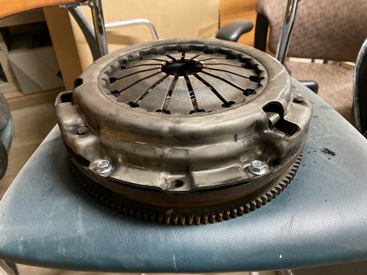

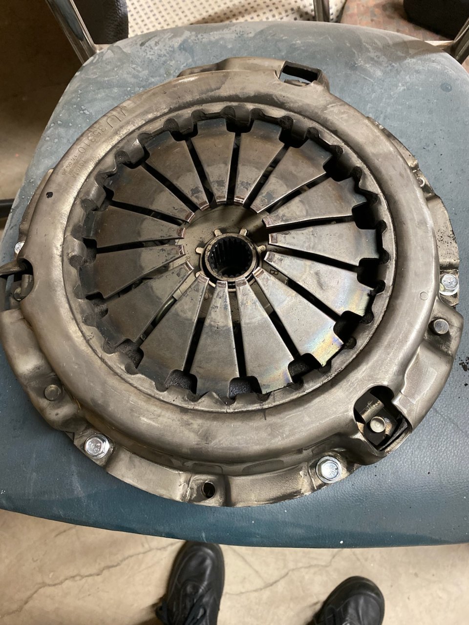

    I had the idea to get rid of the plastic pedal and was digging around to see what could be adapted. I got lucky when I was searching on all applications that used the same pivot collar sleeve thingy.
    The FJ being the only vehicle of that group (besides Tacoma) that came with a MTM led me to dig deeper there.
    It sure looked similar to the Tacoma pedal in the pic. So, I ordered one up for comparison. Once I had both pedals in hand I knew it'd be an easy swap. I did bounce a couple of the part numbers off of TW and got a couple hits. So, I certainly wasn't the first to think of this. I'm sure your post on the subject was in there too. One guy that did the swap used a master cylinder from an overseas application to obtain the clevis. I thought I'd try to find something easier to get paws on and came up with the one I ended up using.
    My FJ pedal required zero modifications. It went right in like it was meant for the Tacoma. I'm surprised to hear that yours needed so much adapting. Still have the part number you bought? Should be a 31301-35270.
    I did need to extend the contact pad at the base to contact the interlock switch. But, that was because I incorporated an adjustable pedal stop bolt that keeps The Tilton unit happy. I just used a fatter cushion there.
    As for the pilot; I've given it a bit of thought. But, imo, effort to benefit ratio is abysmal. I really don't think it'd significantly change anything. The input bearings are plenty beefy to keep that shaft in line.

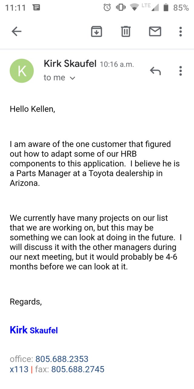

    Here's what Tilton had to say:

    That's a long timeframe. Probably be a year until something comes of it unfortunately.

    Definately sucks. I thought I was really convincing in my email. :D
    Wish I had the time to R&D the 6000 series kit for the RA60F myself!

    It all pretty much works with off the shelf bits. I’ve provided the numbers for the items needed at the beginning of this thread. Kirk was in fact the Tilton employee that I was working with. So, he knows what all I bought. @garciav @Kasbien
    That being said, now is the time to start hounding Tilton. The seed has been planted. The more contacts and interest they get from us, the more likely they’ll seriously consider doing up a kit.
