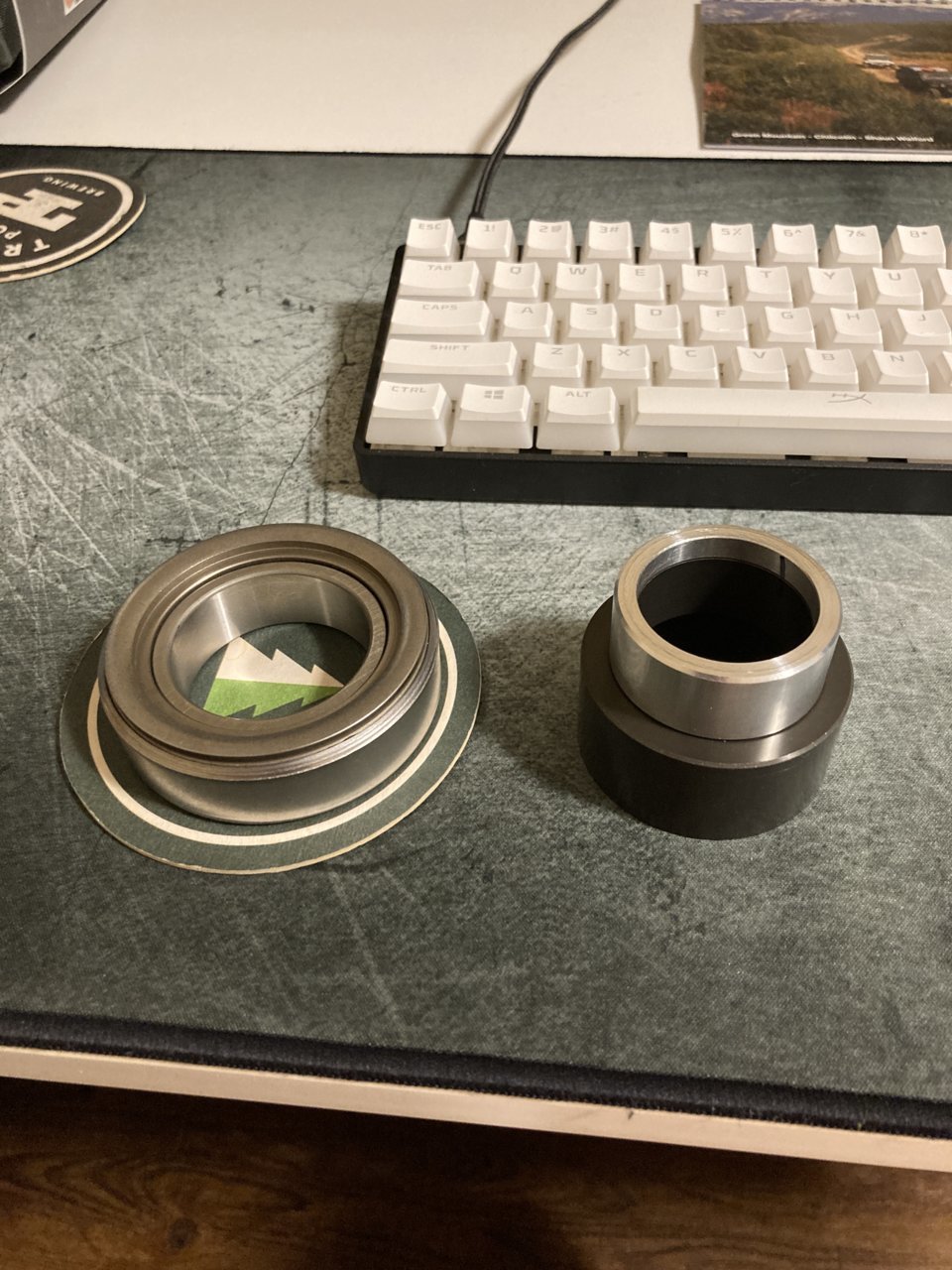

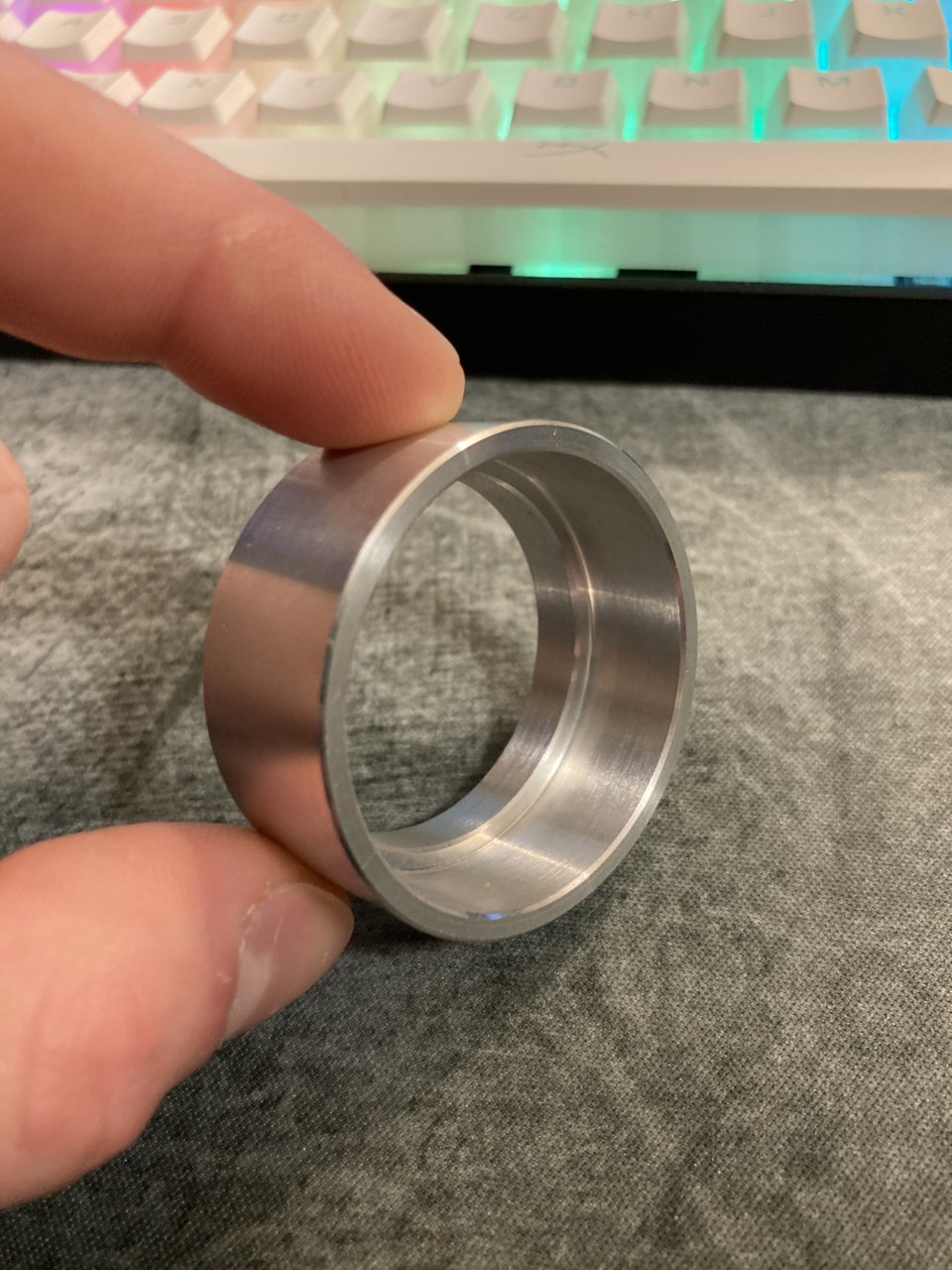

    Progress Update #2
    I received a few adapter bushings back from amigo (finally). I added a shoulder on the bushing to help support the weight of the bearing and to extend the entire length of the bearing race. I have two extra bushings, so if people want one to help guinea pig this Tilton experiment then just pay the shipping and I’ll send one your way. :cheers:
    Next up is the anti-rotation bracket and hole plug for routing the hoses.

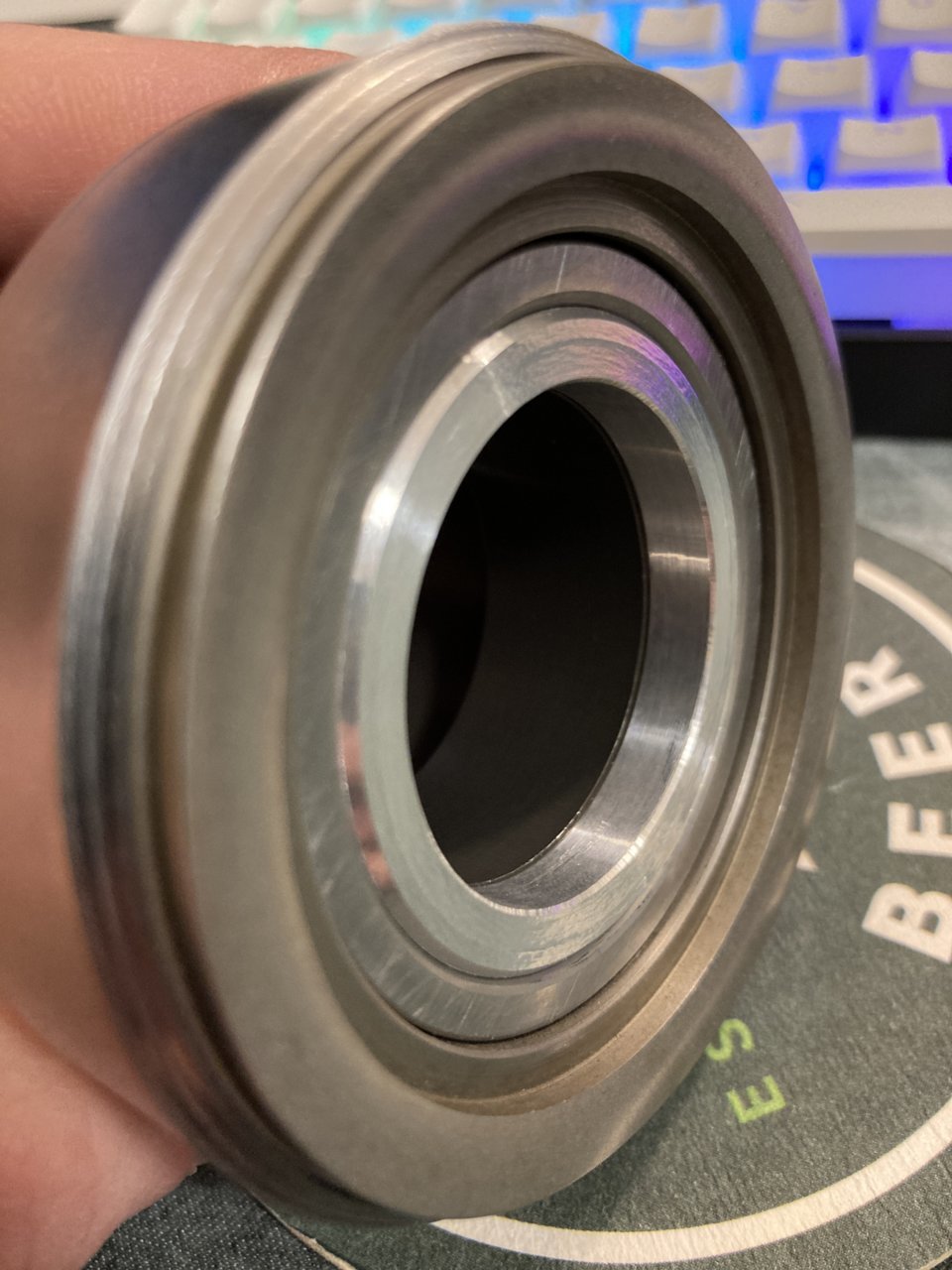

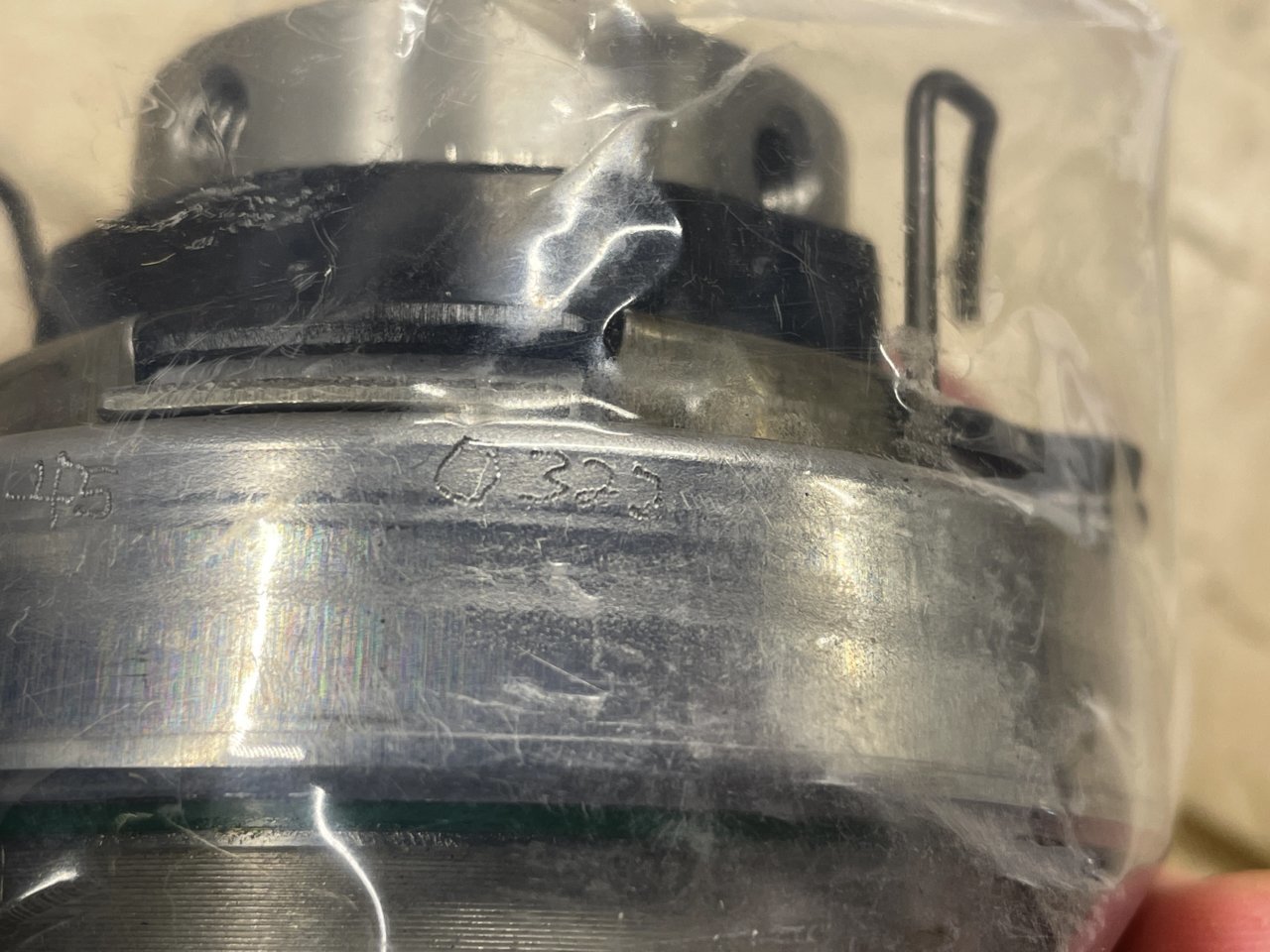

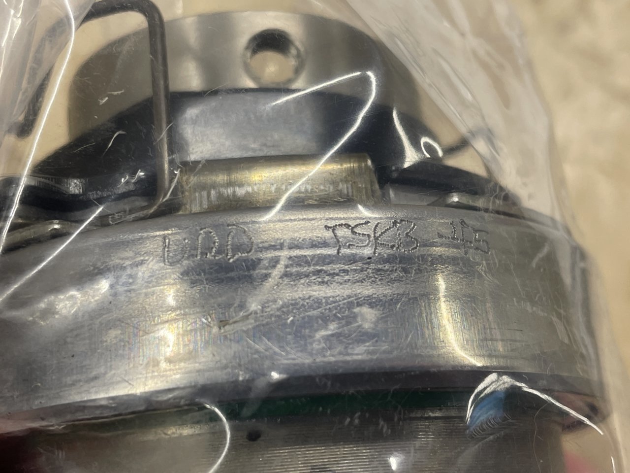

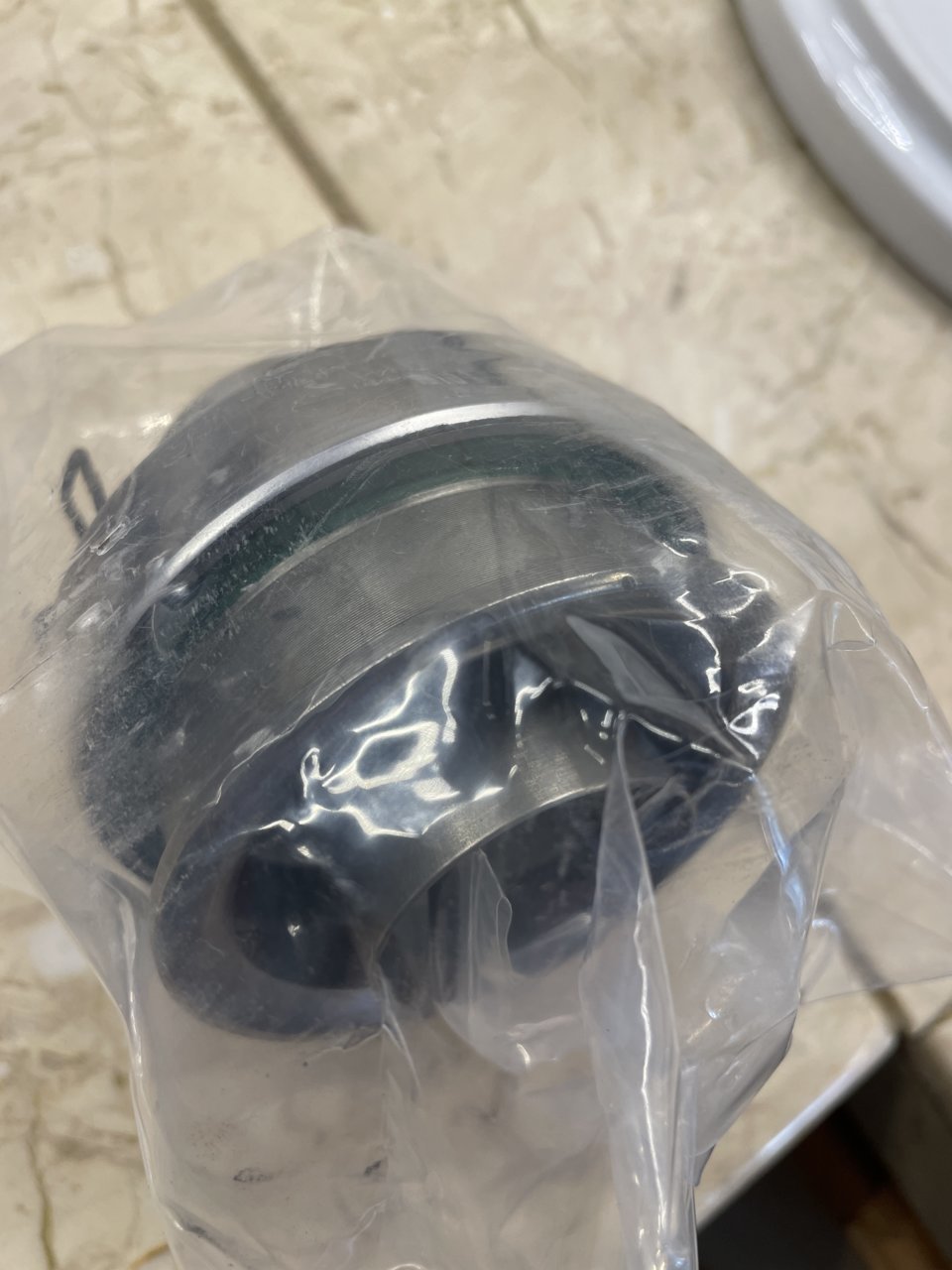

    63K miles on my 2014 AC 4.0 TR ORD MT, no problems so far other than somewhat squeaky throwout bearing.
    I just bought this 6MT throwout bearting kit from URD, possibly because I'm still in the "naive enough to think that URD is the answer to a lot of things Tacoma." :help: Should I bother installing this, or send it back? (Just got it 3 days ago, still new in box, can probably just pay URD a restocking fee.):
    I noticed there are hand-engraved markings around the outside rim of the bearing, as follows:
    "URD TSKB-45 0322"
    (I'm guessing that 0322 might be meant as a date code, maybe it indicates this is a later revision which fixes problems with earlier revisions of this kit?)
    Attaching photos here for further reference:
