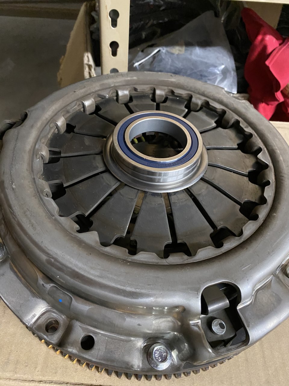

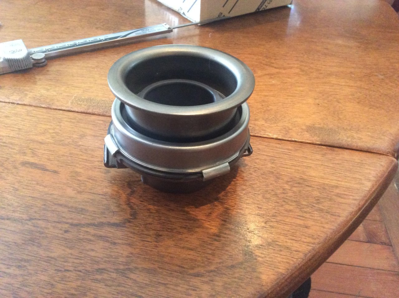

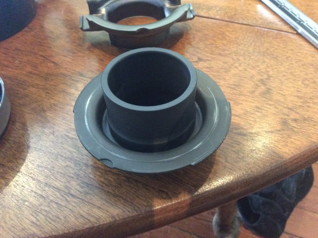

    Part number 31230-60190. It comes from the V6 200 Series Land Cruiser. Looks much like the stock bearing, larger OD 76mm where it presses on the fingers, ID 38mm x 44mm L. Overall length is 64mm.

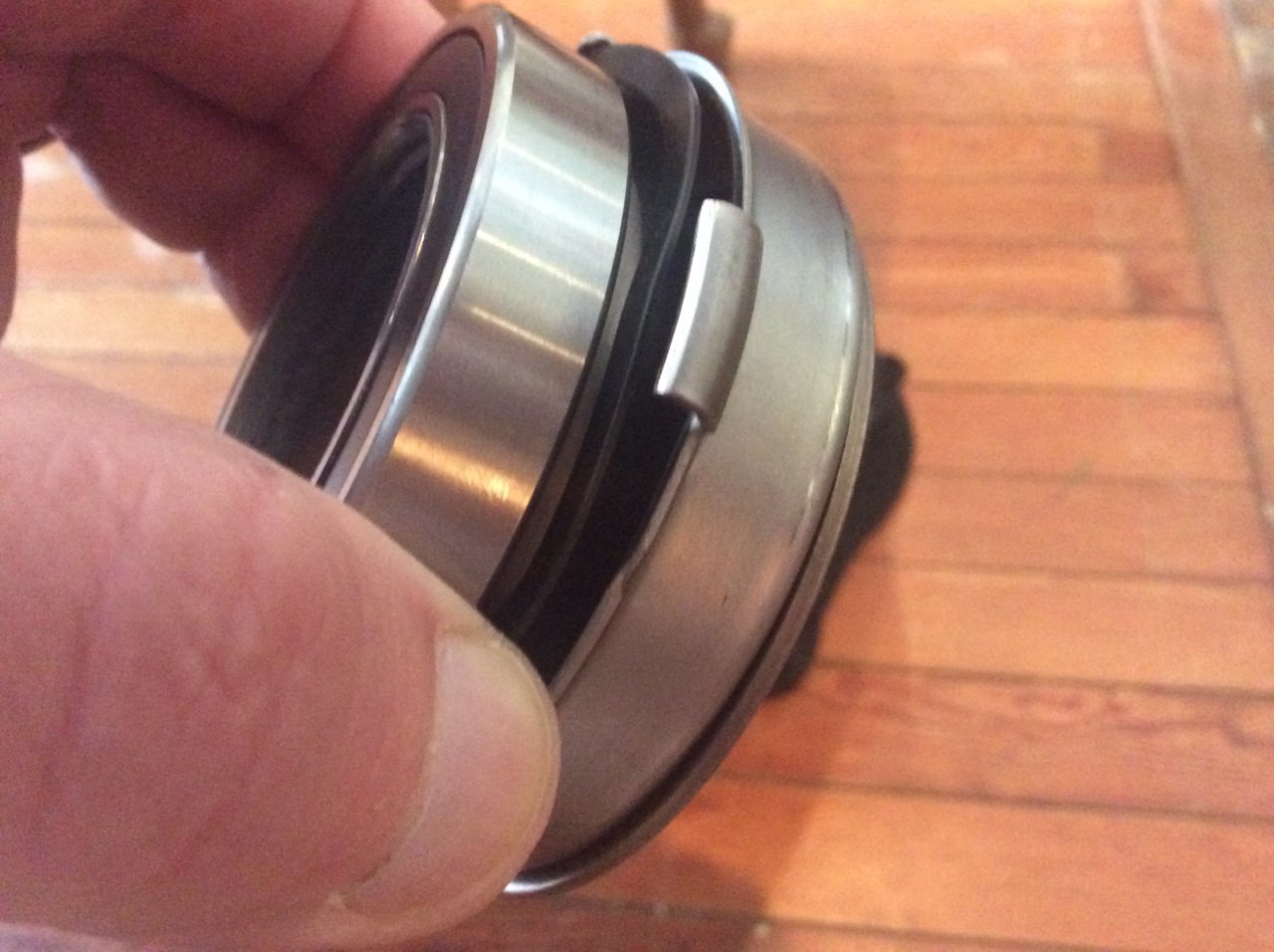

    I believe this bearing may have some self aligning capabilities. The bearing is crimped into a housing with a wave spring behind it. This appears to allow it to float...
    Dissected....

    It does move. This bearing was a NTO... maybe 1 mile of driving, the movement can also be seen on the rub/wear mark inside the hub.

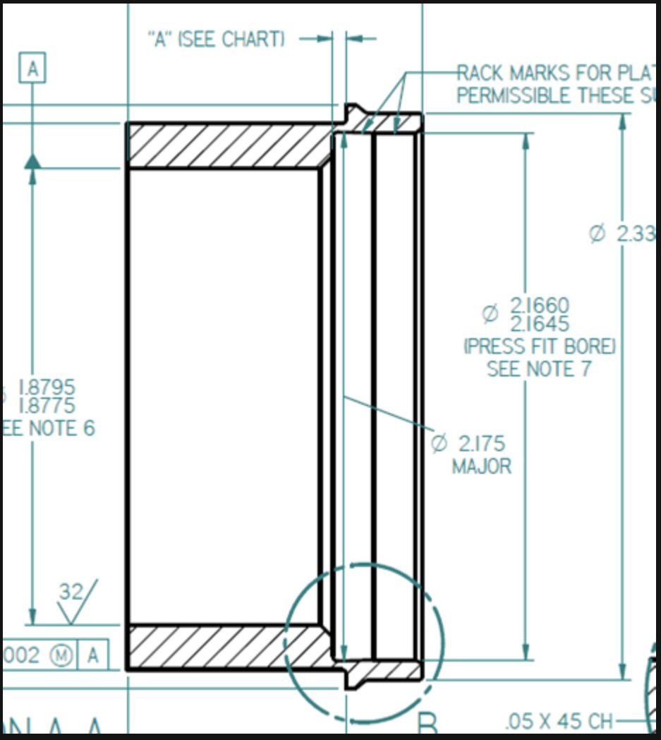

    Ok.

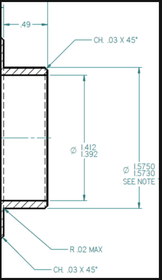

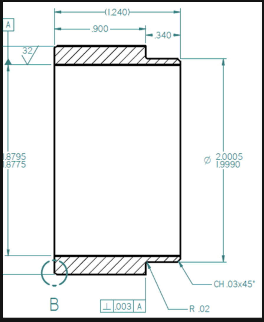

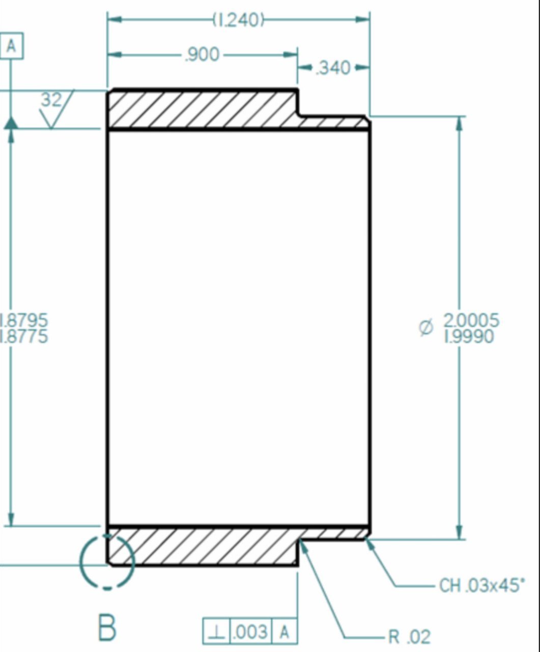

    Here’s the three pistons we have to play with. Remember, the goal is a bearing (preferably self-aligning) with an id suitable for one of these and the other end suitable for our clutch. 68-ish mm contact circle, radius face. Oh, and low profile too. Under 1” would be best.
    I know, I know... in to mm. Ugh. Use this.
    Right side of each drawing is the bearing end btw...
    42A10698-97AA-4507-8E4B-035C52E9FF3D.jpg F59AC7C0-2290-4351-B889-2788D00FC08B.jpg 44B7293F-E09B-4DE5-9FA8-9CD7D9B98710.jpg

    The preferred piston would need a bearing with a 40mm (1.5748") bore.
    The other option would need a bearing with a 2" (50.8mm) bore

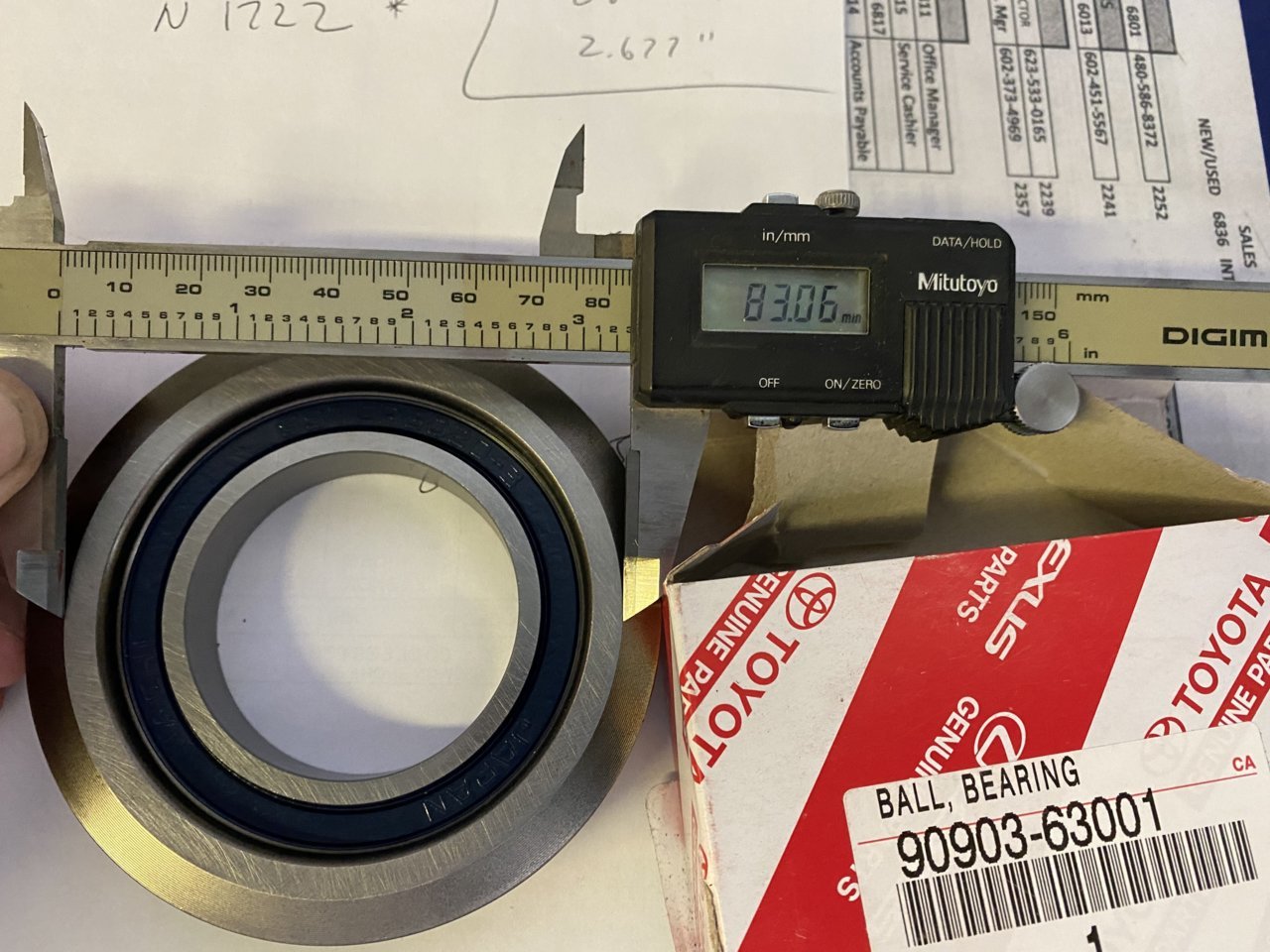

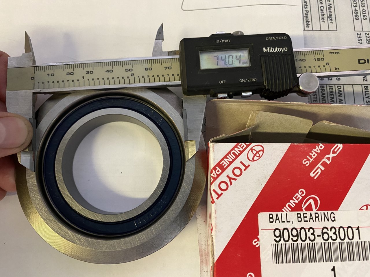

    My shit is all stock.

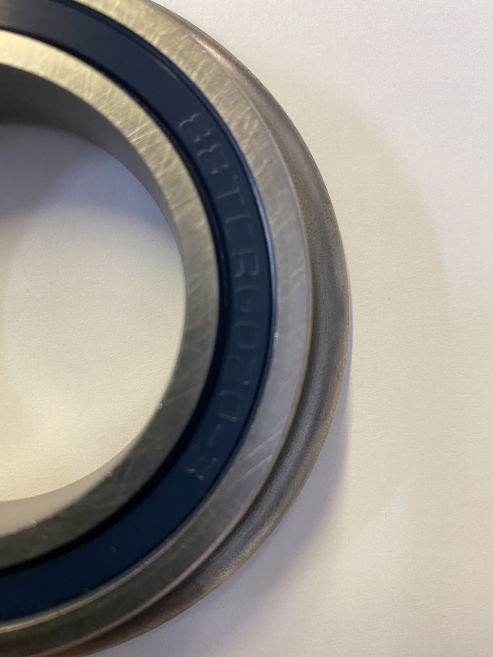

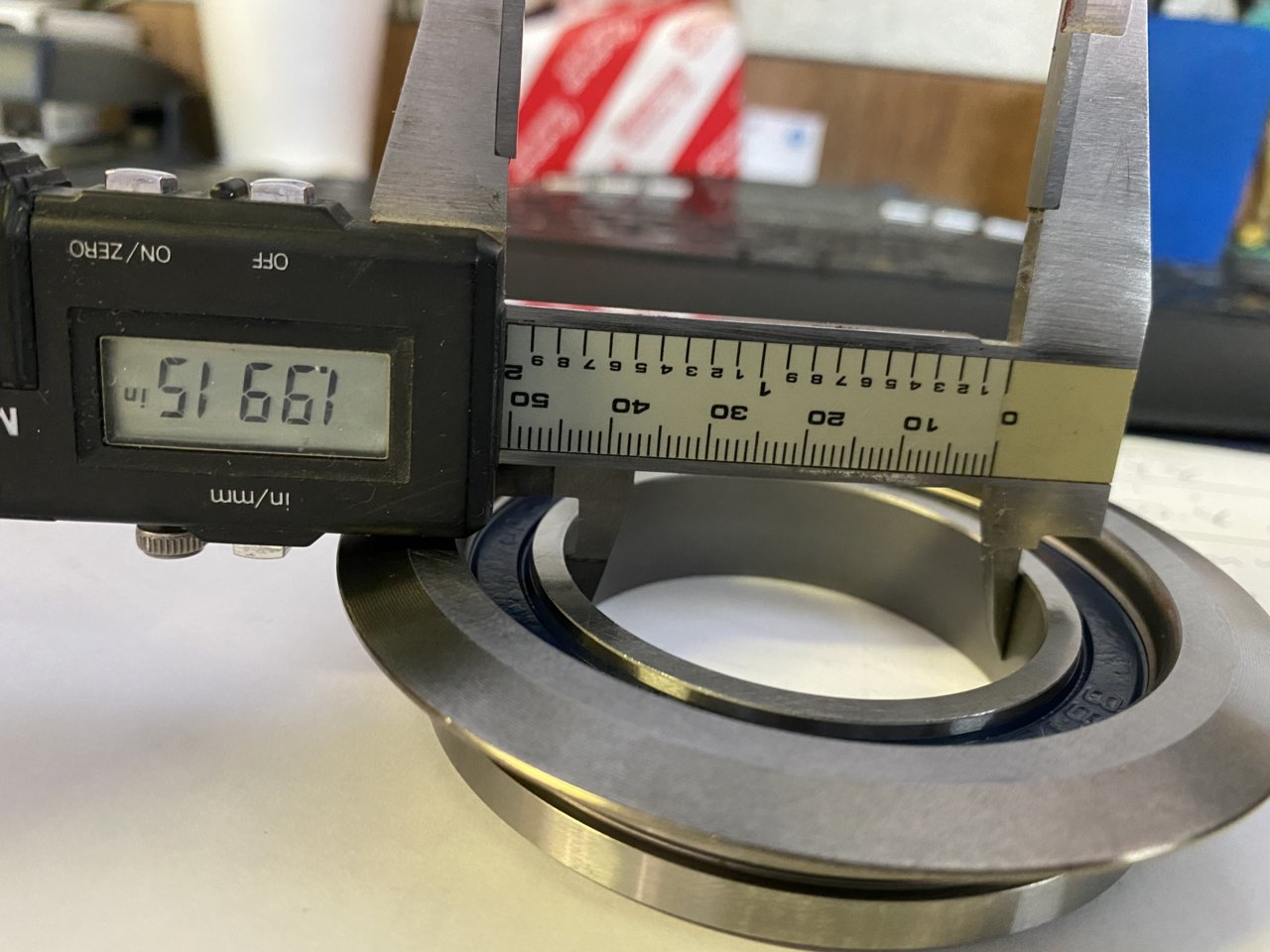

    Ok. So, I’ve found a bearing I’m liking. Should work perfectly with the Tilton 2” piston.
    Cool points. I get to tell people that it’s a Supra part. Chicks dig that. Anyway... it’s a tad bigger than the 68mm diameter contact point of the stock bearing. Which, I don’t believe to be an issue. It’s not a self-centering bearing either. But, with a hydro bearing like this, I’m questioning if it’s really necessary. Everyone, I’d like you to meet 90903-63001.

    Is that bearing made to be loaded in that direction? I've wondered in the past if the whole thing could be utilized like the Supra and Lexus IS, but flipped over for push... the finger length would need to be just right.

    You and I think alike. I asked that very same question too. I intend to research the bearing itself to find out.
    Holding it and looking carefully at it. It sure seems as though it’d work either way. Everything is symmetrical with the exception of the lip.
