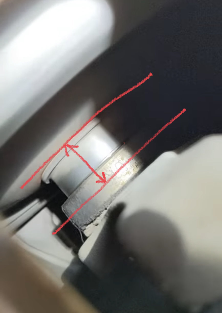

    Yep. It’s always going to spin. The OE slave cylinder has a spring that keeps a bit of pressure on the fork to do just that. TSB’s attempting to solve the squeek called for a new slave cylinder with an even stronger spring there.
    My opinion is that the squeeking has more to do with the OE TOB design and that tall standoff between the actual bearing and the pressure plate. When things aren’t just brand new and perfect, that extra bit of length allows a bit more wiggling. This increases wear on the quill. Once it can’t hold that long bearing exactly on center against a spinning pressure plate with a bunch of individual fingers under light (slave cyl spring) pressure, we get the squeek.
    Just my opinion. Regardless, it is a shitty design. Else, we wouldn’t be here taking about all of this, would we?

    I wonder if the design of the clutch fork has something additional to do with it. Due to basic geometry it doesn't look like it would push completely straight on bearing/shaft axis of rotation. It pivots on ball & socket way off-center from the shaft. I'd think it has some off-axis vector component in the force it exerts which tends to want to push the TOB & sleeve off-axis as well.
    The Tilton HRB solution avoids this entirely, giving uniformly-distributed and 100% axial thrust against the TOB.
