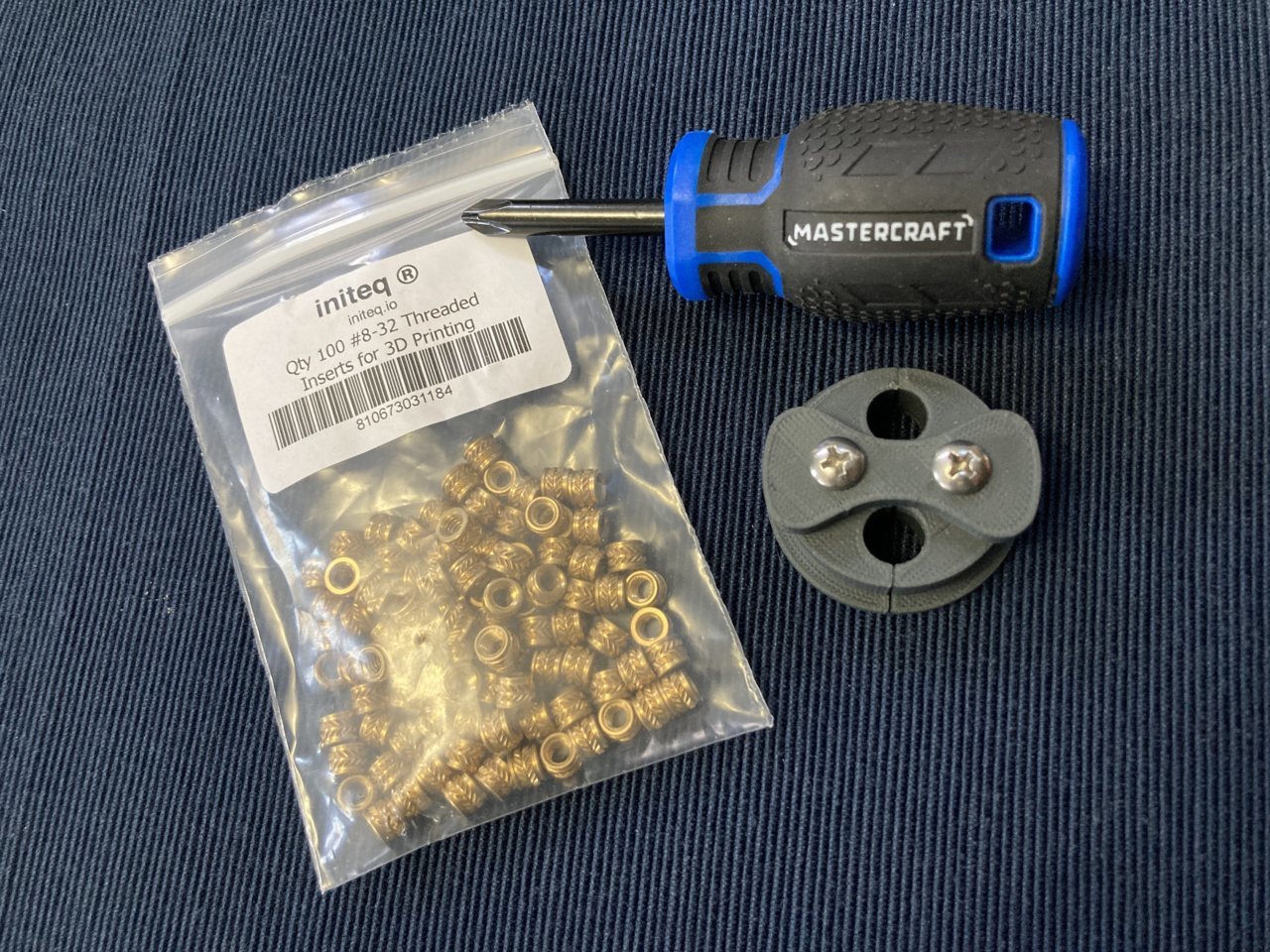

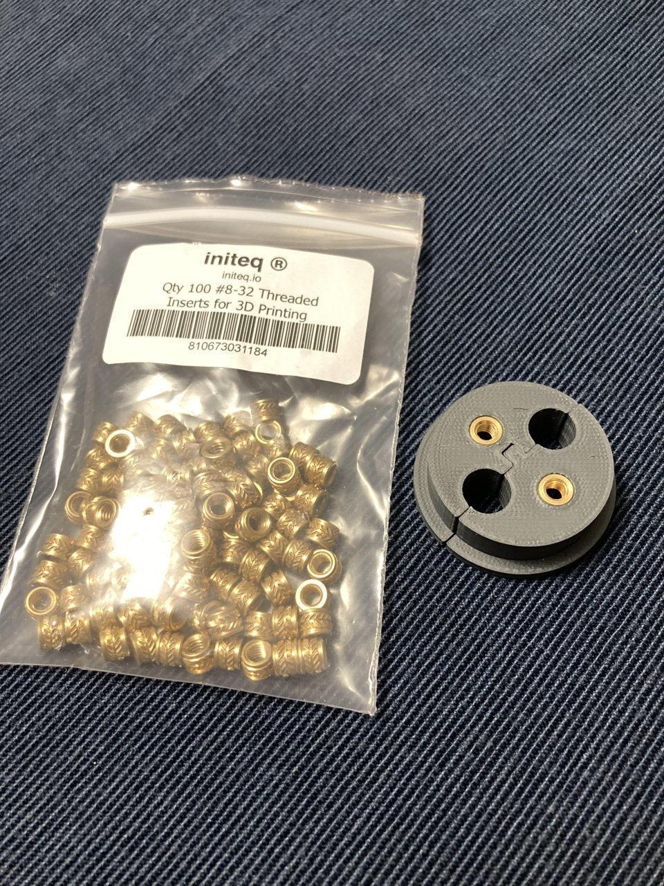

    A friend of mine likes to (jokingly) impersonate non-understanding shop management by saying "No setbacks. Only solutions!" any time we encounter the slightest problem. I applied that here. My printer wasn't able to consistently handle printing M4 threads throughout the production run, so I switched to heat-set thread inserts instead. Very happy with strength and final results. :cool:

    Nice.. gotta love trying to print threads with a 3D printer.. I know your pain. Did you happen to try Helicoils or Keyserts at all? Curious.. I wonder if they would work as well. I used some Keyserts in Polycarbonate recently and it bit in good.

    I think if I were to downsize my nozzle I could make it happen consistently but that would put the print time through the roof for the whole assembly. Another bonus of the insert is the ability to use a thread locking compound without it eating away at the plastic. Oh, and an excuse to buy a new variable temperature soldering iron haha.
    I can't say I've really tried the common thread inserts in plastic before, other than the odd mold or two when I was in that discipline. These little knurled units have proven to be a fantastic option so far. Super quick compared to a helicoil!

    The keyserts I would be interested in trying out in a Print, as they essentially broach the ID with tangs you hammer/press in. I may have to take a couple home and try out this weekend.... for science. lol
    Those look great though, gotta love a simple design that just works. :cheers:

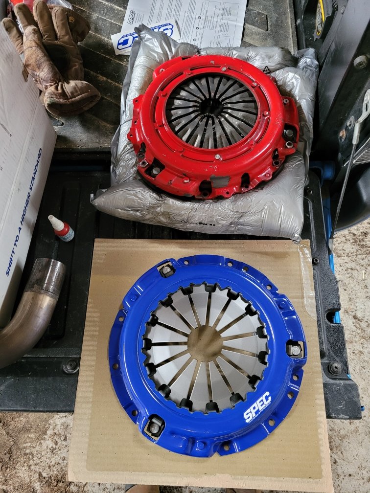

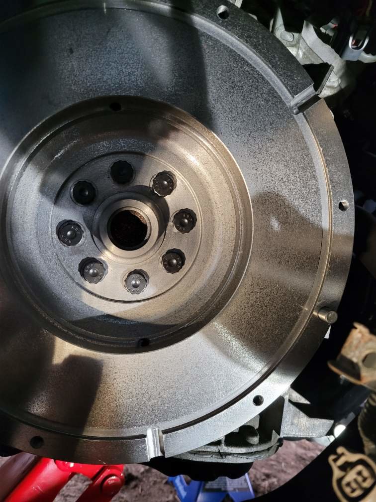

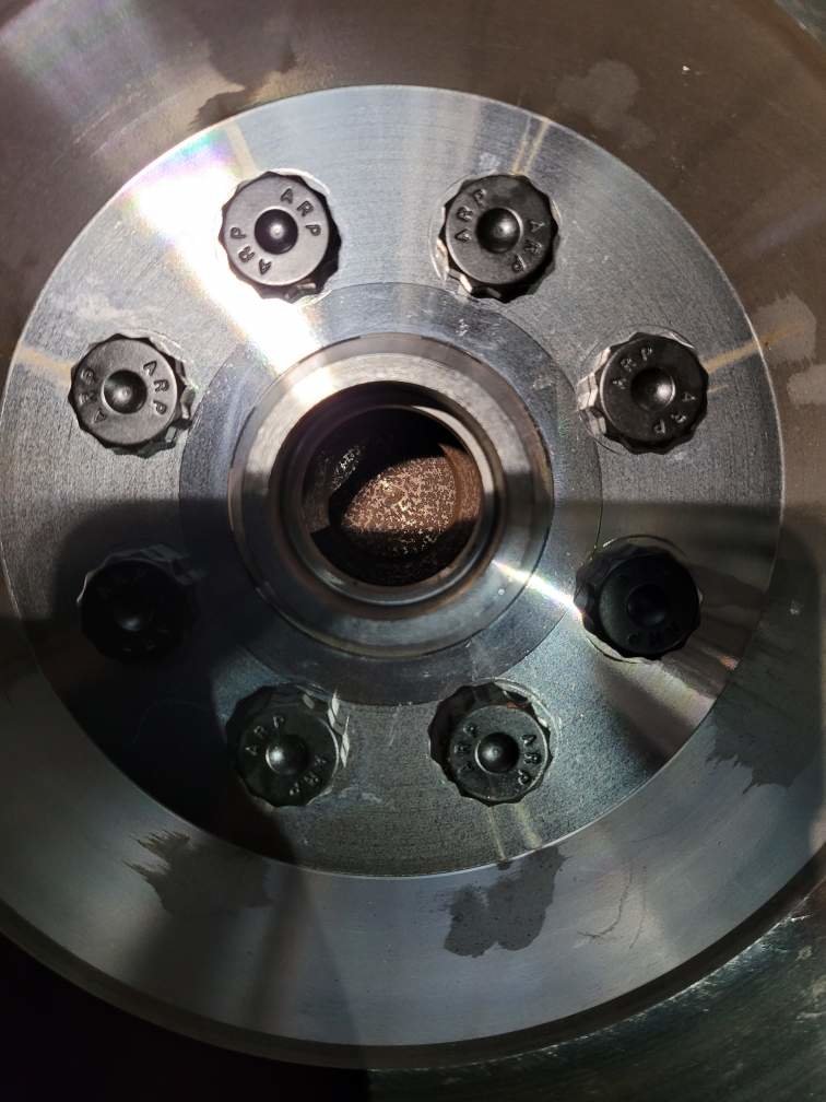

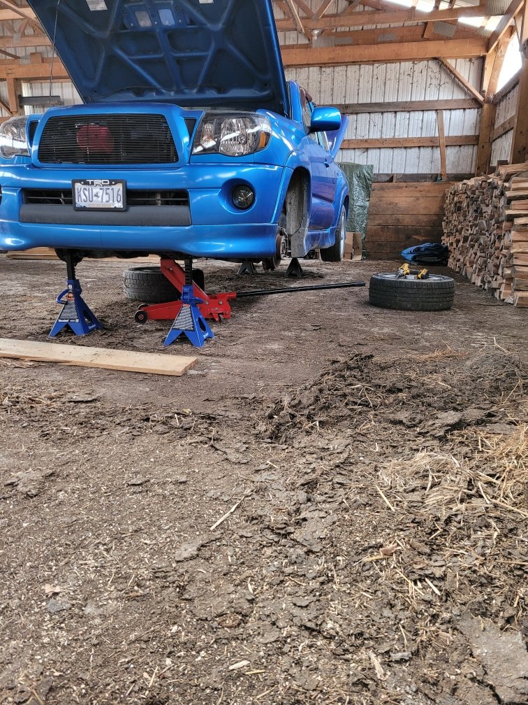

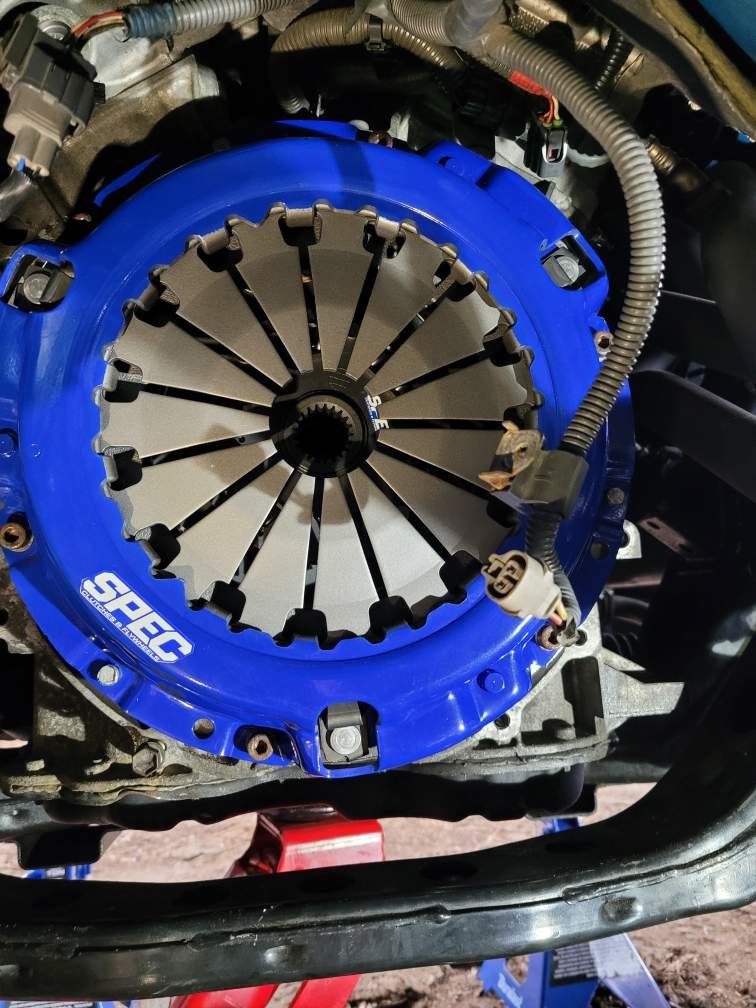

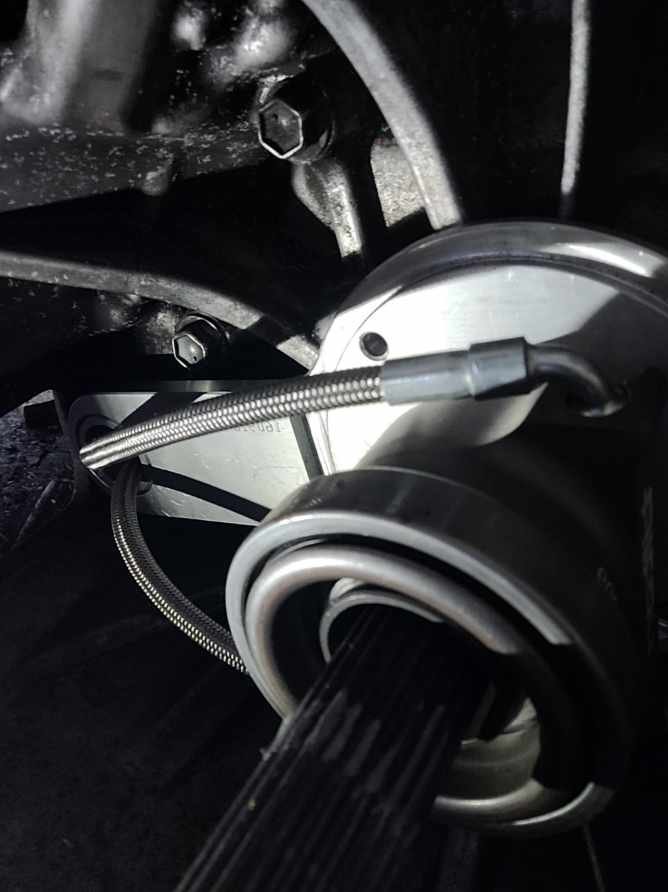

    Hello again everyone! I am happy to report that the X is back up and running - better than ever with the Stage 2+ Spec Clutch, OEM flywheel, Tilton HRB setup!!! All I need now is an inspection, but NY is soooo strict. If anyone knows anyone that'll slap an inspection sticker near the Finger Lakes - i would highly appreciate it! Thanks again to all the folks that did the dirty work! If anyone accidentally oversizes their Clutch Masters base plate / Tilton threaded sleeve... don't worry, sleeve retainer is your friend! TO ANYONE READING THIS THREAD - this option is expensive...clutch - $900, oem flywheel - $200, tilton HRB setup - $500 and still climbing (using Clutchmasters base). If you choose any of the affordable setups please note: if you get anything from this thread...any setup you choose ABSOLUTELY MUST INCLUDE a mechanical clutch pedal stop! That is the ONLY thing that will prevent over travel on ANY of the available kits...happy wrenching. Cheers to all the information on just these 23 pages. Absolutely mind blowing...

    where did you get your ARP flywheel bolts ?
  19. Mar 9, 2023 at 2:03 PM
    #459
    wrmathis
    wrmathis Dark Lord of the Sith
    Sep 10, 2008
    #9126
    9,460
    Bonaire, GA
    2006 Tacoma TRD OR 4x4
    parts and stuff
    you can probably get some from URD since they sell them with their flywheels. not on their website so probably would have to call
  20. Mar 9, 2023 at 2:47 PM
    #460
    Jowett
    Jowett Well-Known Member
    May 5, 2016
    #186182
    1,635
    Brian
    North Adams, MA
    There are several ARP flywheel bolts that could fit here, just need to compare to the stock pieces.
