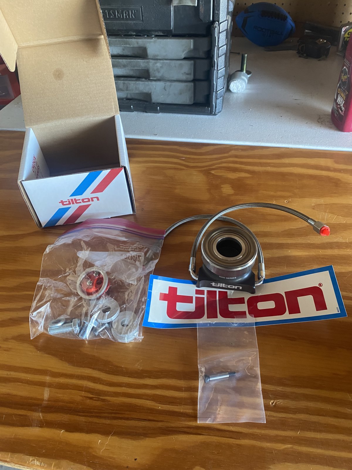

    Hmm I thought you use the FJ master? At least that’s what I bought lol
    they look different that’s for sure.

    The FJ pedal attaches to the Tacoma clutch master cylinder with the clevis extension that you fabricate. It also has a bracket to accommodate the pedal stop that you will make as requires by Tilton. Bill covers this all in detail at this he beginning of the thread it's reiterated in the kit Install Notes.
    From wear and deformation of the cast aluminum you'll likely find some high and low spots along the length of the quill. You only want to remove the absolute minimum. To navigate those waters you can use some layout dye, sharpie marker or a sharpie marker AND an air hose to make your own DIY layout dye and coat the shaft. As you lightly sand around the circumference of the quill with 120-220grit emery you'll begin to find the hills and valleys indicating where you should be focusing your efforts more. Test fitment with the threaded sleeve as you go.
    I only have a cheapie airline vacuum bleeder and honestly it never works for me. I'm curious if a fancy unit would make short work of it though.
    It's not required but it's certainly an upgrade over the plastic Tacoma clutch master cylinder being that the housing is actually cast aluminum with this one. Tacoma one has the ball tip that sits inside the plastic Tacoma clutch pedal, whereas the FJ one has a more familiar clevis pin attachment to the metal FJ pedal. The connection method to the pedal is swappable in each case regardless of what master cylinder you end up using.

    I have another question: what keeps that threaded sleeve from rotating in or out over time? The Tilton throwout has a tab attached to the anti-rotation bracket yes, but that sleeve is just threaded into the Tilton and sits against the base of the quill.

    Technically nothing. Other than the snug fitment and axial "pressure" from the bearing being in contact with the pressure plate fingers. If Tilton engineers were concerned about it moving I'm sure they would have added set screws to the sleeve.

    All installed and bled. Adjusted and set the pedal stop. We were definitely way overthrowing the Clutchmaster's TOB. The throw after adjusting the stop on the Tilton is super short. Super short. Which makes sense with the way you set the stop. It doesn't need to move that far to do it's job
