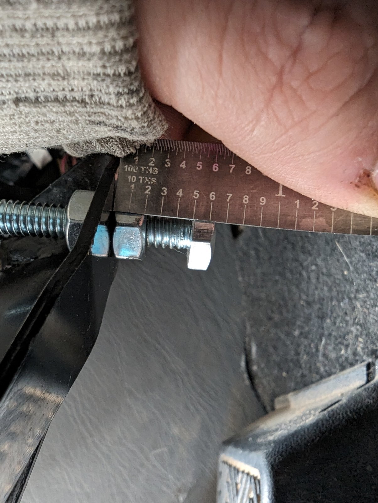

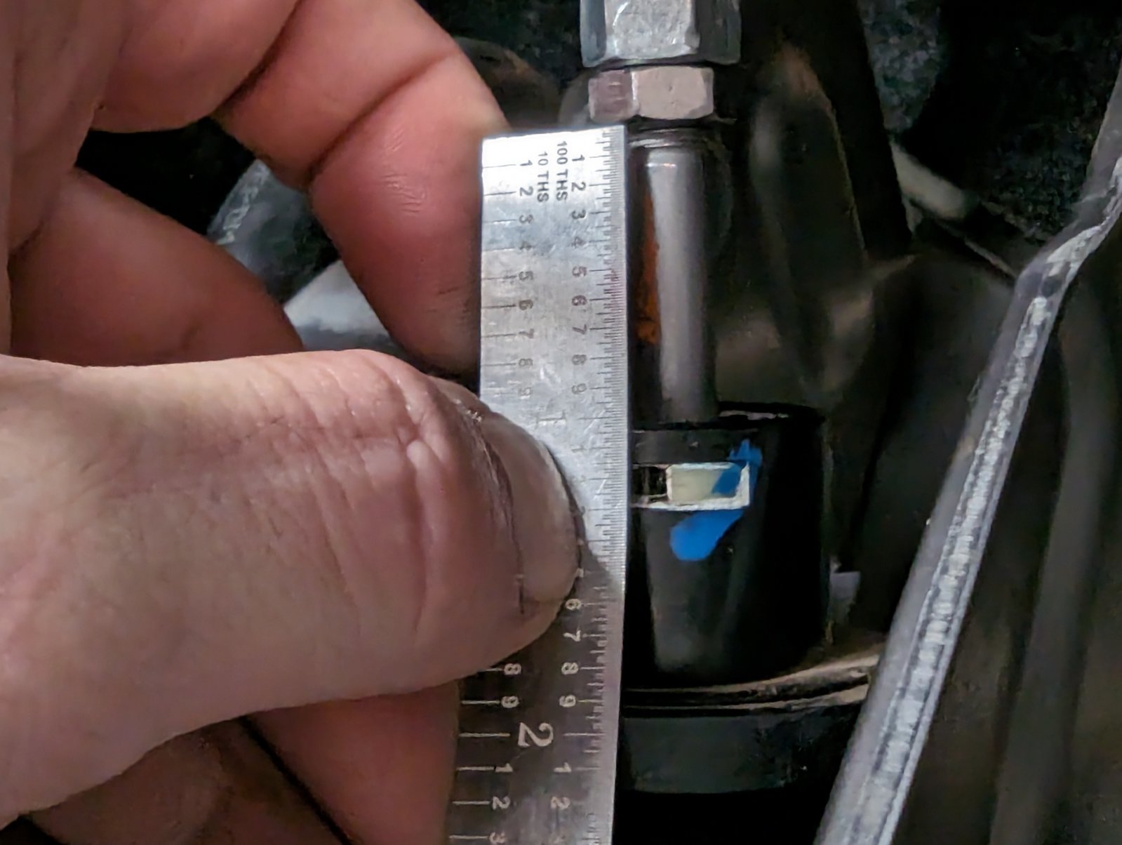

    Got the new setup all installed with new clutch and flywheel. Still slightly unsure about my pedal stop position... Set it up per the tilton video instructions. Find the point of release, then give an additional 1/4" of travel measured at the end of the pedal by adjusting the stop. Maybe it's just weirding me out since it feels so different than my old clutch which didn't start to engage until it was well withing half the range of pedal travel. The engagement point on this new setup is almost immediately. It feels really nice though, nice and light pedal feel, just have to get used to the new engagement point and also driving now without the clutch accumulator helping I think has made me a bit of a sloppy shifter.
    It did however, feel like complete crap initially but I found out I had the rod end of the master cylinder screwed way too far into the union piece I had welded to the clevis. I backed this out a few turns and it made the whole movement of the pedal much smoother, were as before the pedal spring was almost binding up half way through which made the pedal stick or clunk at the end of its travel.
    I might jack up the rear end and have the wife and kids help me triple check my stop adjustment/ clutch engagement point when I get home from work today just to satisfy my paranoia at this point because I really don't wanna get under there and have to do this all again.
    Also to anyone else doing this, the bleeding technique really is strange for this system. Cycling the pedal through the full travel really doesn't do anything, you literally just move the pedal through it's first 1/2" or so of travel and then crack the bleeder, this for some reason works the best.
    What are you guys getting for these two measurements (pictured below) out of curiosity? First is the total length of master cylinder rod from cylinder to jam nut and the second is the length of the stop I have set currently. About 1" and .625" currently... Just trying to ballpark if this looks right. This is with the stop set with 1/4" additional freeplay at pedal end after disengagement point per end of the tilton video.

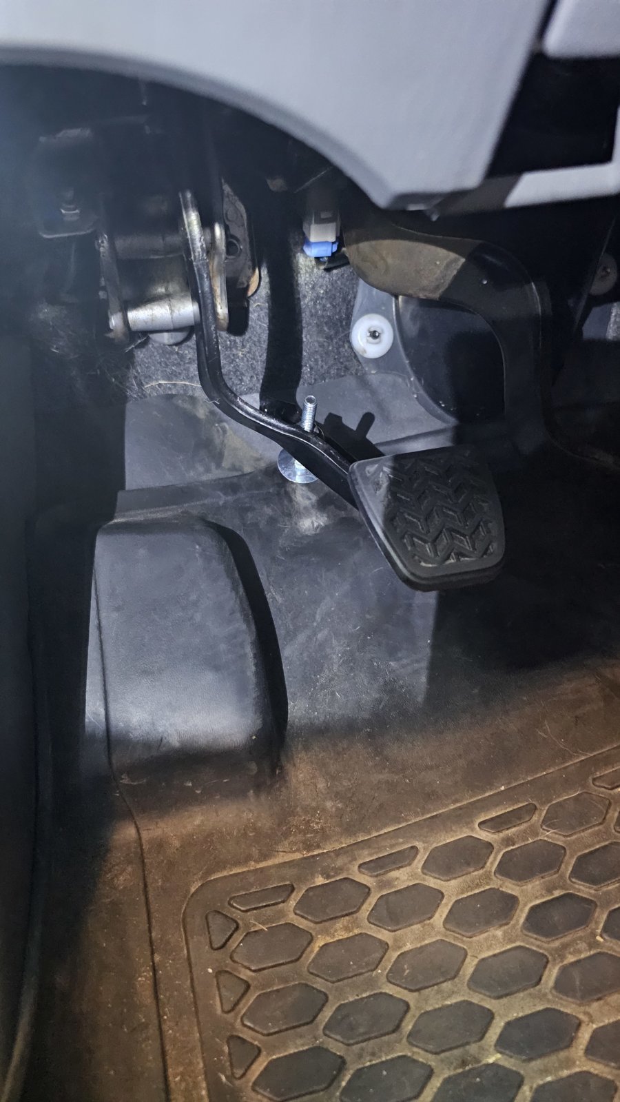

    Truck likely didn't start as the clutch switch needs adjustment with the new pedal that was installed. If the switch isn't adjusted right, truck won't start. You can verify by pushing your Clutch Start Cancel button on the dash. It should start then.

    So I just installed the pedal stop so that the clutch start switch (shown marked) wasn't being smashed/over extended. The markings kind of shows the sweet spot. Not to far in and not out enough to where it won't start it. While I was down there I checked on the rest of the connectors as well as the cruise control switch and since they were all connected and fine I gave them a push n wiggle for good measure.. what do you know cruise control works again lol
    Pedal stop also helps the shifts!
    I THINK everything is done at this point amd all I can say is it feels like a different truck. Can't believe shifting into gears can be like butter

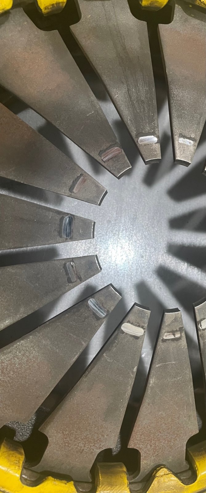

    Well, unfortunately I started to get an inconsistent pedal feel a few thousand miles ago and decided that I needed to pull the transmission to see what was going on. Looks like the tilton piston continued to rotate in its bore until both surfaces were rough, causing inconsistent feel in the pedal. Throwout bearing felt perfect, slightly less resistance than when installed new.
    With the tilton unit on the bench it was pretty obvious what was going on. It takes very little torque to rotate the piston in the bore, and there is no provision for preventing this from happening. The TO bearing felt very smooth, but offered a small amount of resistance as would be expected. It is hard to image how the tilton piston would NOT rotate in the bore, given the only thing stopping it from doing so is the dust seal tension. Kind of puzzled by the design honestly. The TO bearing also maintains light contact with the pressure plate fingers with the clutch released, so this is a continuous problem.
    Anyway, I couldn't bring myself to reinstall the setup given the lack of an anti-rotation feature in the tilton design, so I instead went with a quill sleeve and stock setup. Tilton was also fairly useless on the phone when describing the issue. They basically said it shouldn't rotate but couldn't explain why it shouldn't and couldn't offer assistance since it wasn't a complete kit from them.
    One thing I immediately noticed was that the stock slave cylinder has a relatively heavy spring that pushes the TO bearing against the pressure plate fingers at all times. I am guessing this is to reduce relative motion between the pressure plate fingers and bearing, reducing wear on the fingers. The fingers on the pressure plate I removed after 8K miles would never have made 100K miles with the wear rate present.
    Not trying to knock the setup, but I figured I should share my experience. The kit didn't fail, but was giving me enough red flags to not trust it long term.

    @lzalusky Would you mind posting a pic of your pressure plate fingers? Thanks

    Here you go. This is @8K miles. This looks slightly better than the stock pressure plate I removed at around 110K miles.

    What a bummer to see this but I appreciate the info. It's a good reminder to keep checking my system and be mindful of changes in pedal feel. The OEM slave assembly is labeled in box and sitting on a shelf waiting as a backup but selfishly hoping your experience is isolated.
    Thanks again for posting.

    Man that looks worse than mine did at 130k

    Ugh... that really sucks dude. I'm sorry. I wanted to add a mechanical means of keeping the piston indexed but the wiping seal really hinders that. Both the piston and the hydraulic unit would require modification to make something work.
    Since they AREN'T like that already from the manufacturer, it begs to the question of how "loose" the Tilton-made release bearings are? Do they have so-little initial rolling resistance (think cheap skateboard bearing) that the thought of the piston ever rotating wasn't a consideration? You'd expect poor longevity out of the bearing if that was the case. I kind of want to order one of theirs and see.
    Do any other aftermarket hydraulic release being manufactures lock the orientation of the piston as it travels?
