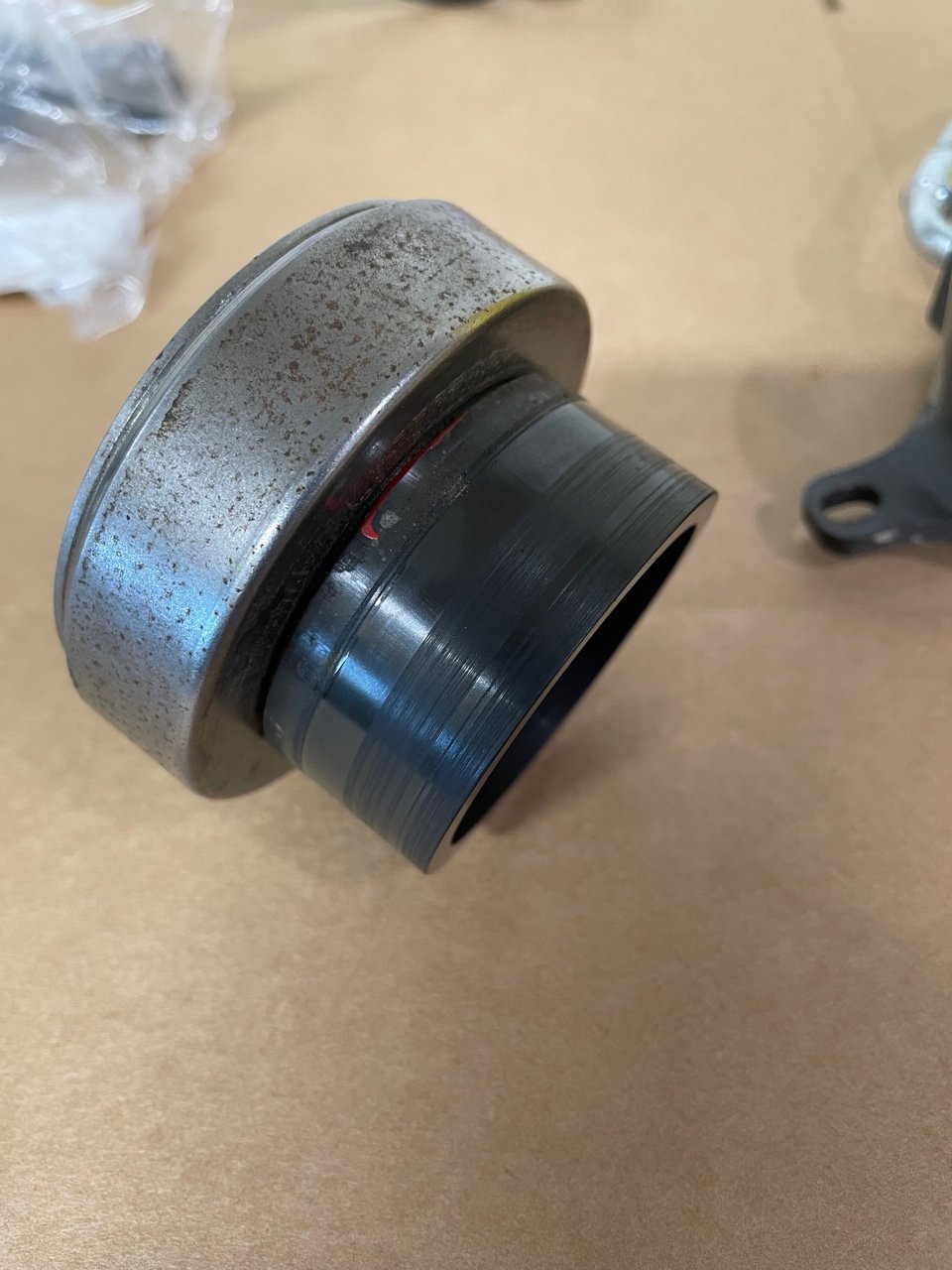

    I’m late to the party here. Sorry. I’m just learning that someone had an issue with one of these.
    This looks like the result of a bad bearing.
    What bearing did you use? That wear on the fingers looks excessive to me. A bad bearing could definitely cause something like this.
    I had outlined a sort of “break-in” procedure for new bearings somewhere back in this thread. Any chance that you saw it ?
    https://www.tacomaworld.com/threads...stem-shenanigans.698464/page-28#post-29224732
    Can you share a pic of the bearing housing and the orange wiper seal? That wiper holds that piston pretty firmly and is a large part of what the design relies on to help prevent piston rotation.

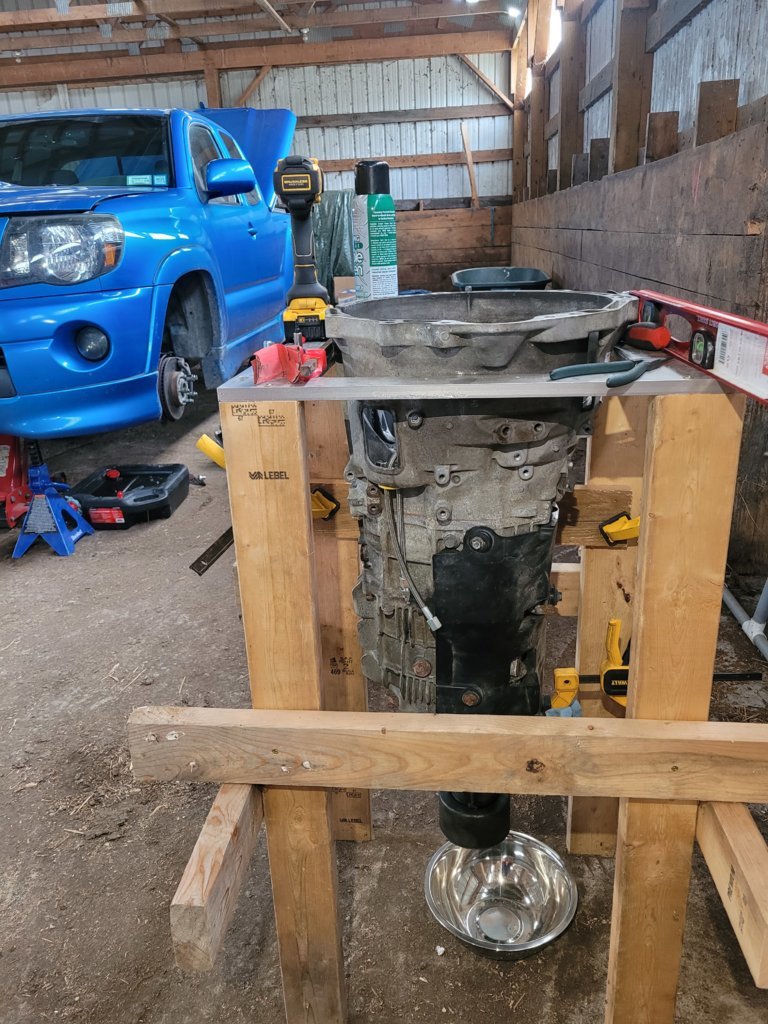

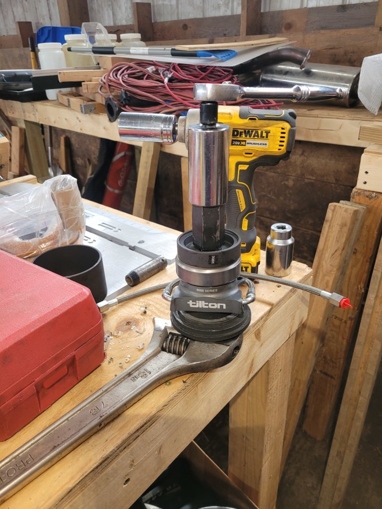

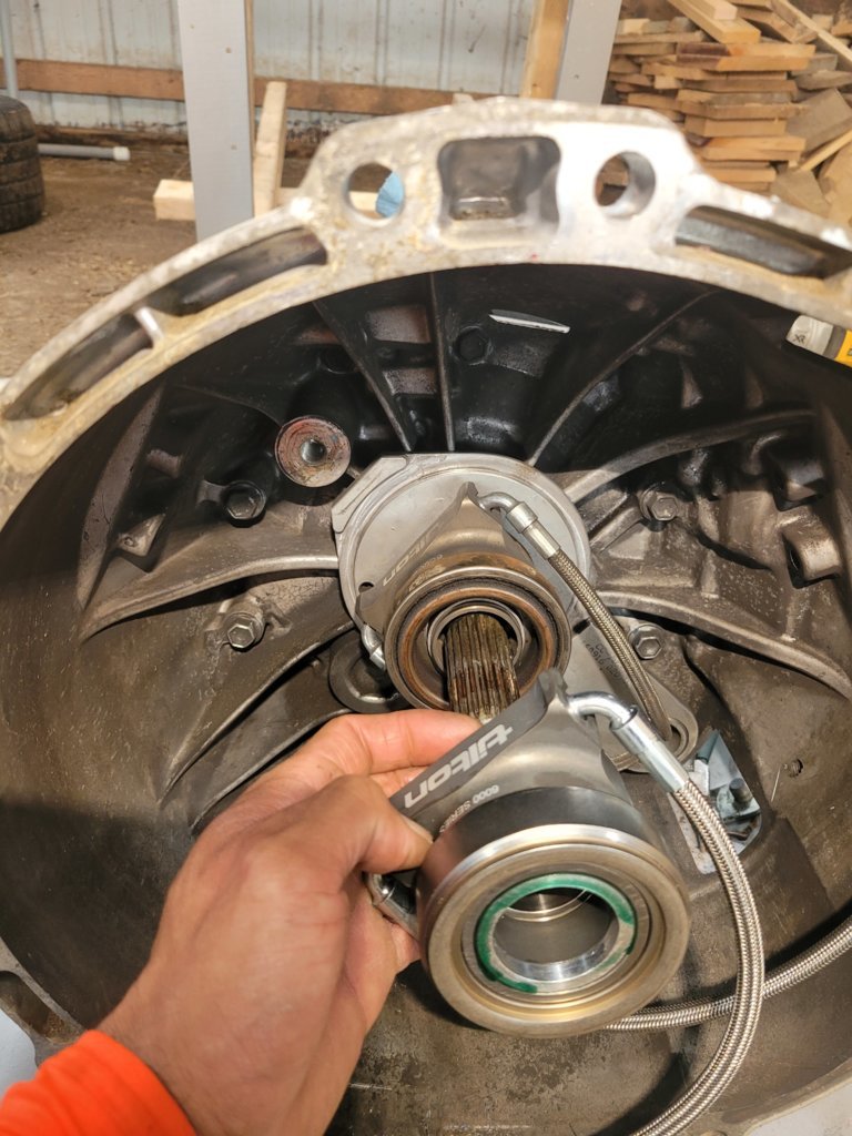

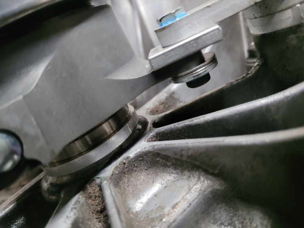

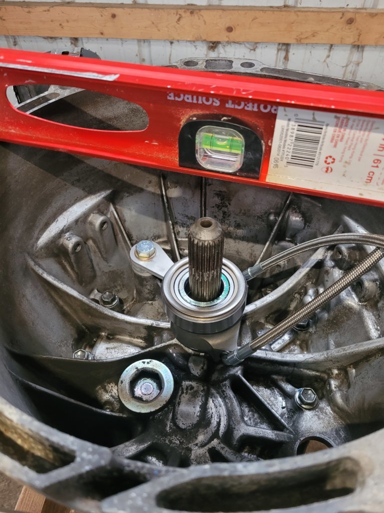

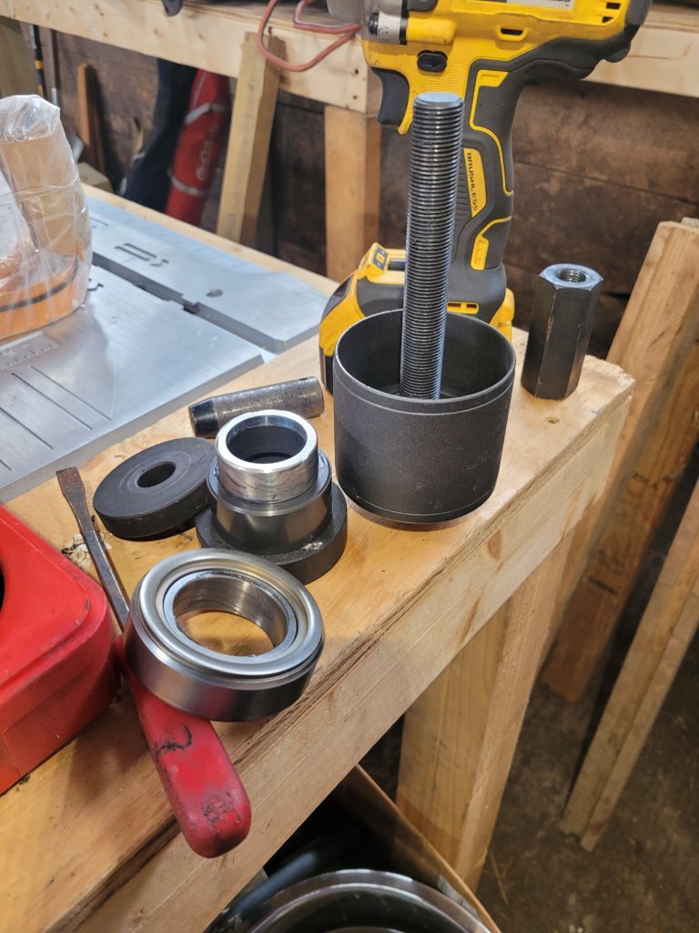

    Back again to add to the testimonials with my personal experience. I installed the parts from page one, including Kasbiens kit, with a twist...
    I cut my quill down to a half inch, a hundred years ago to accommodate for "the FIX" from URD. It was anything but "the FIX". (I am still a HUGE URD advocate)
    So this is a unique review, but could be useful to those who may encounter a "snapped / broken" quill at some point.
    The Tilton setup with adapter kit, I can only imagine works best when installed over an intact quill. (Or at least one that is a couple inches long to "engage" and prevent any "wobble" / imbalance of the setup while engaging / disengaging the pressure plate fingers.)
    Kasbiens kit, the Titon setup, and the shim I added (using the anti-rotation bolt and tab on the HRB housing) to sturdy the entire setup have surpassed my expectations, albeit for 3000 miles.
    After 5 years of issues and temporary fixes, I finally feel like Corrine, my X-runner is doing what she was made to do... Freakin' drive!
    Thank you to everyone involved and I feel your pain "azzwethinkweiz" - my first Tilton HRB setup, shown in one of these photos (mated to the aluminum plate from "the FIX"), exhibits the same failures as you have noted. I wish you all the best!
    Keep turning wrenches everyone - because you want to, not because you need to.
