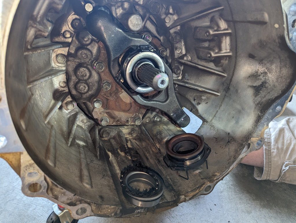

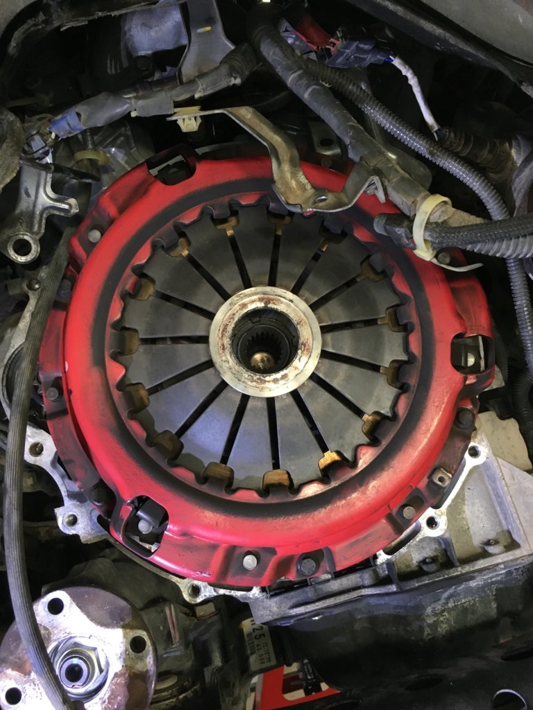

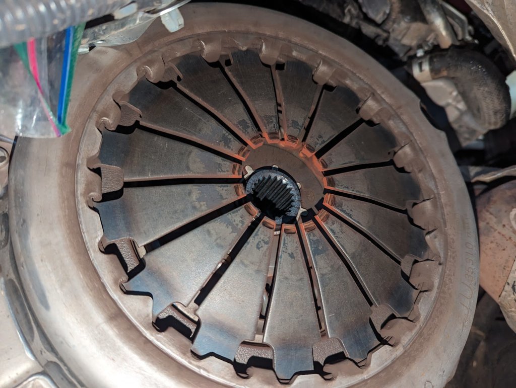

    I think we’ve discussed this before, but the noise 99% of the time is the bearing face slipping on the pressure plate surface. The spring in the slave is what keeps that from happening, but the spring can go weak or the surfaces can start to slip for other reasons. Once the surfaces start to slip, it’s highly recommended to replace both the pressure plate and the TOB so you have two new surfaces, otherwise it’s likely to experience what you are…a solution for 10k miles that gives up again. Ideally rounding that out with a new slave cylinder spring would ensure you’re back to stock levels of preload and essentially set you back to a brand new setup.
    Ny brand new OEM TOB had a film of oil on it. I got rid of that to help make the surface less slick. I’d recommend doing that on a new bearing.
    I don’t think there is a better solution than new stock parts. And if you can live with the noise when it does start to happen, ignore fixing it at that point or try a heavier spring.
    Clutches in pretty much all vehicles have been spinning the bearing full time since at least the early 90s, so I don’t think that itself is a problem, but for that to work well you need it held tight to the pressure plate so it can’t slip.
    What I still don’t know is why the ones that start to chirp, ever began doing so. Did the spring go weak? Something on the surface caused the friction to give up? Nobody knows. But it’s almost never the bearing itself (which is why people can continue to drive on a chirping one for a long time, because the bearing itself is still fine).
    Unfortunately I can not provide any input on aftermarket options, but I can say what I have seen hasn’t looked good.

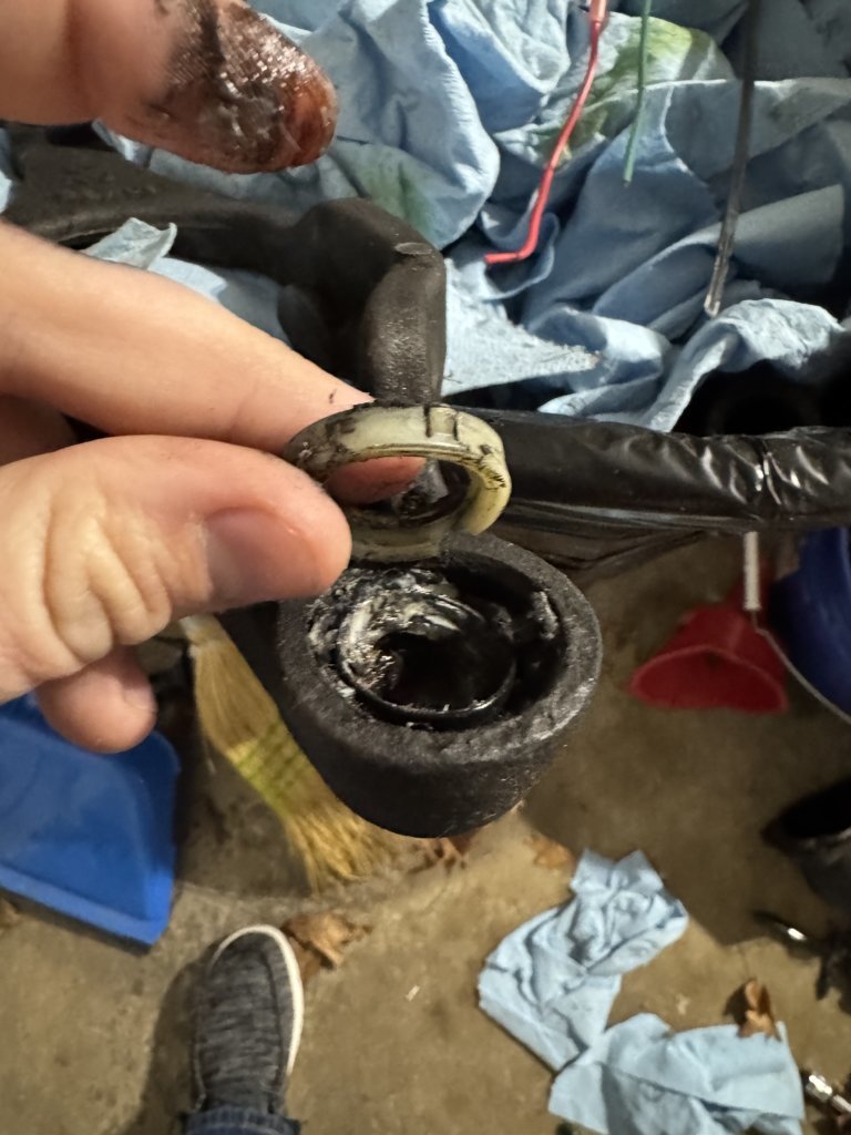

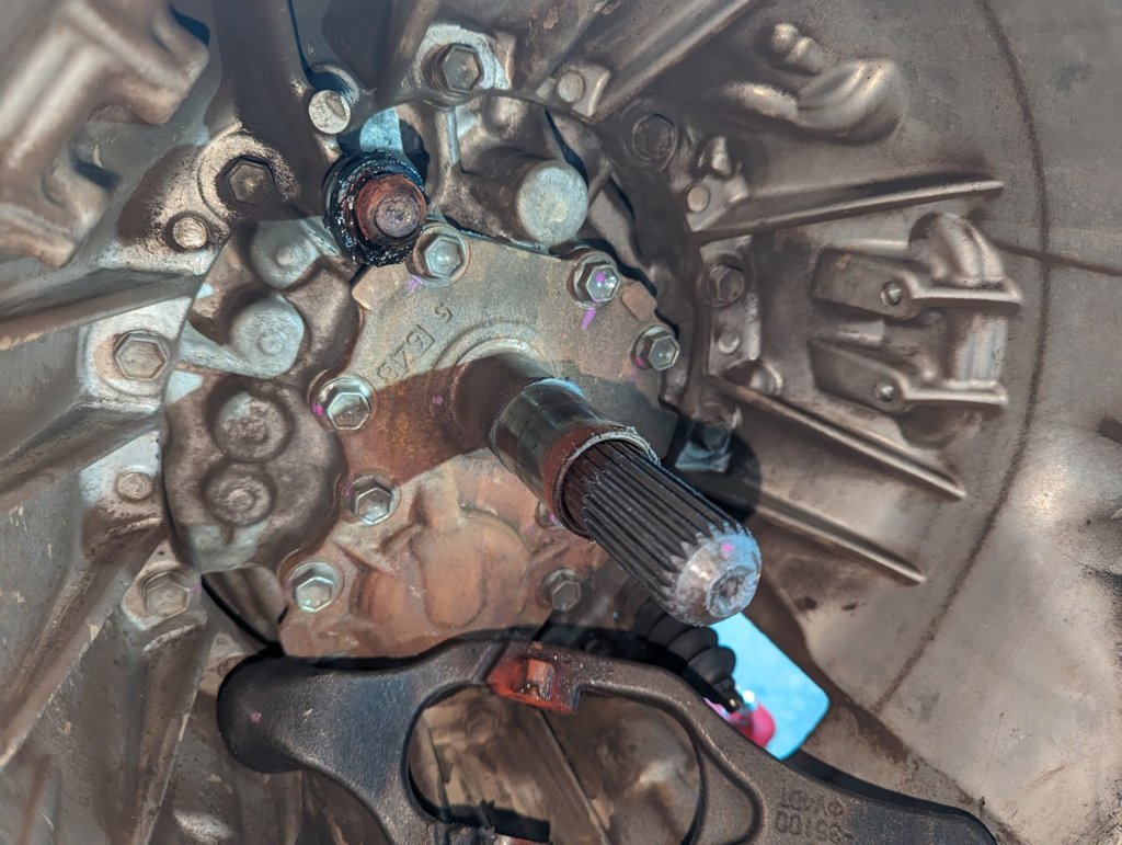

    Looking closer at your photos, did your fork fall apart? Looks like it left behind a bunch of crap on the fork support ball…if you didn’t replace the fork I would think that is at least contributing to the problem at this point.

    Look at the vid. No slip either with or without the spring. I will mark the TOB and PP to verify with another vid.
    The only part ever replaced was the TOBs. What you see on the pivot is remnants of high temp lube. Just in case, what you might see on the PP fingers is flung off moly assembly lube.

    Saw the vid, but I would think they’re both going to be moving fast enough that you’re not able to see any real differences in speed.
    The pivot ball in your photos looks to have the bushing from the fork stuck on it. I don’t think it’s just grease. I just dug my old fork out of the trash for comparison and my bushing was crooked in my fork. I popped it out. If that was not noticed and the bushing out back into the fork properly, that is almost certainly causing things to be wonky this latest time. If that was caught and corrected when reinstalling the fork, then probably disregard.

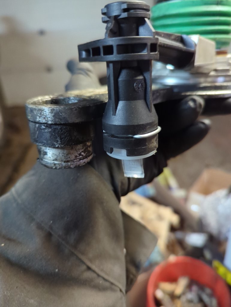

    I noticed the plastic piece both times. Both it and the fork were cleaned. I re-lubed the fork. I felt behind and re-seated that retainer. The only function of it as far as I can tell is to keep lube in the pivot.

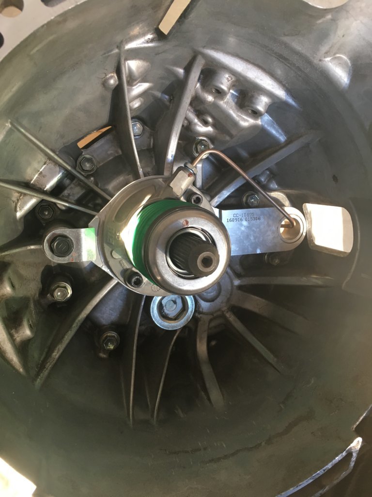

    That’s the URD Fix-U hydro bearing kit. That picture is from when I had originally installed it on my truck.
    The URD kit included a spacer ring adapter to close the ID of the pressure plate fingers. This allowed the smaller T56 bearing face to mate properly to the Tacoma pressure plate.

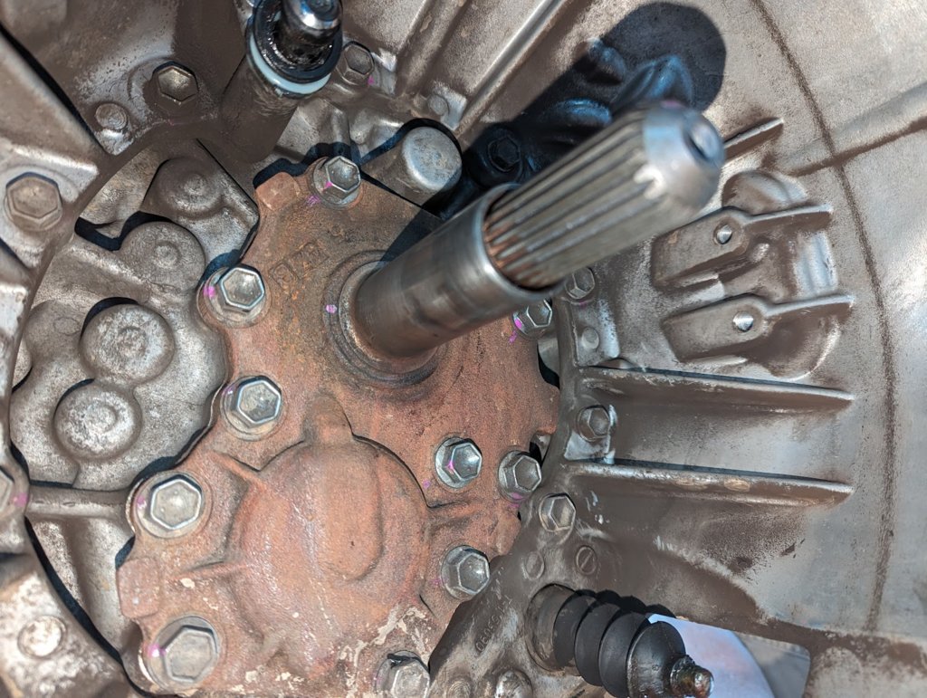

    Long time follower of this post as I had the quill on my FJ let go a couple years ago. Been limping it on the CM HRB for a while and decided it was time, after the transmission started acting up. Ordered a new transmission and all the parts! Just got my @Kasbien kit and started putting parts together. The adapter and the bearing fit nice and snug. The issue I’m currently having is that the adjuster sleeve I ordered (Tilton 61-628) showed up as a different part number (62-652) and from the pictures I’ve seen and the pictures from @Kasbien ’s guide, it should still work. Now recall that I ordered a brand new transmission and while doing some test fitting, I noticed that the sleeve won’t slide over the quill. Pulled out the caliper micrometer, and there is almost a quarter cm difference. Has anyone had to remove material from their quill to get it all to work? I’m sure most people are working with a well worn quill, but should it be a snug fit or how far should I take the quill down? Hopefully someone on here is still reading this thread!

    I had some high spots on my quill that I had to sand down a smidge in order to get the sleeve to slide down it. Nothing serious, marked it up with a sharpie marker, slid the sleeve on to where it stopped so I would know where to sand, and did that process a dozen or so times.

    This isn't just high spots, like it won't even slide on! Luckily it's aluminum (which if it weren't we wouldn't be having this conversation...). It feels wrong to have to shave the quill, knowing that it's the cause of all this!

    Update: so my calibrated eyeball isn’t what it used to be, I replaced the batteries in the micrometer and they both mic’d at 1.375. In the slow process of taking down the quill with 2500 grit. I want it snug but still be able to turn the adjuster sleeve.
