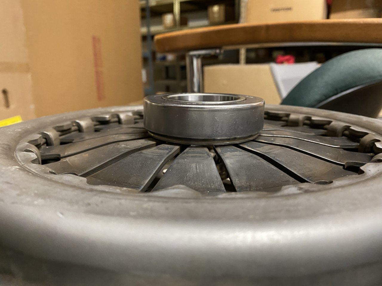

    A 3/4” master needs a 1.400” stroke to move the bearing its full .700” of stroke. That being said; Best I can tell, the clutch needs something like .400 to .500” to fully disengage. Add in the gap necessary to completely pull that bearing off the fingers, and, it’s gonna be close. The way my pedal is currently adjusted, I’m getting about 1.1” of stroke at the cylinder. I could probably sneak a tiny bit more, but that would put the clutch pedal up higher than I’d like it. I like it adjusted so that it is at an even height with the brake pedal.

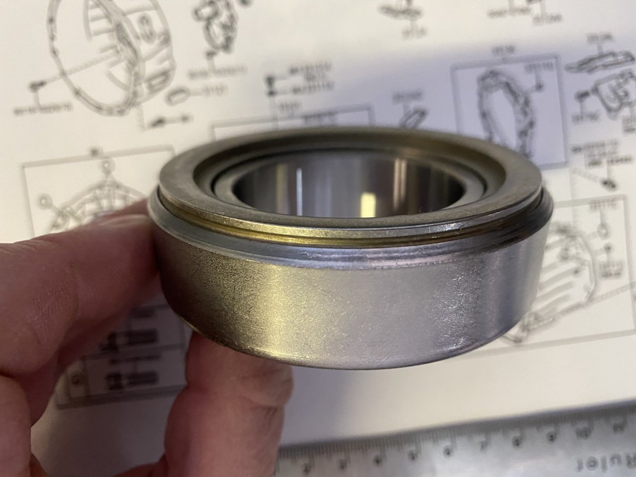

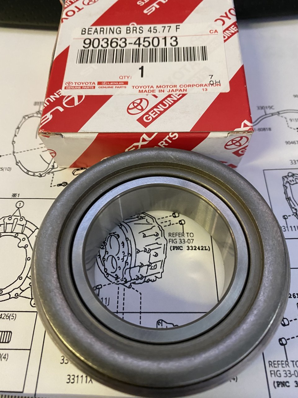

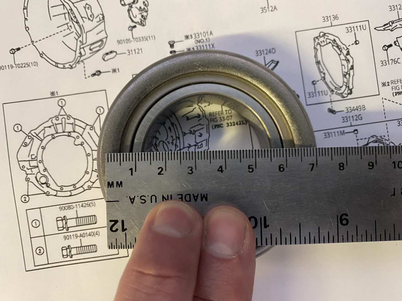

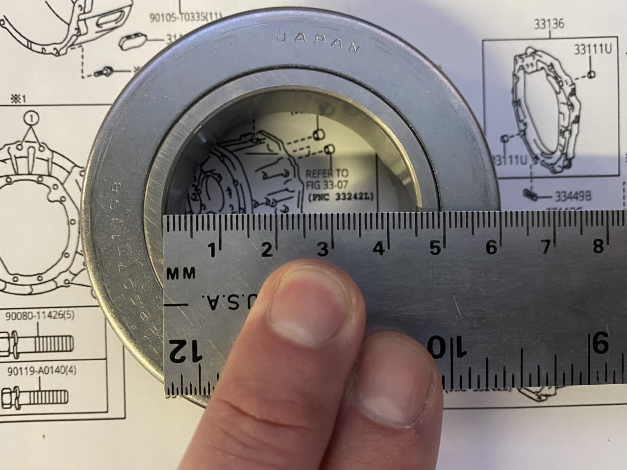

    Wait wait wait! Stop the presses. What’s this? A bearing with the dimensions I need!? Well, almost... It has a 45mm id which means I need to make a spacer to adapt it to the 40mm Tilton piston. No problem. I’ll happily do that to have the correct 68mm radius faced contact circle of this 90363-45013 bearing. It’s intended for a non-USDM Toyota Land Cruiser. Which means I had to order one from overseas. If anyone knows of a better source for these, please let me know.
    Toyota: 90363-45013 or 90363-45009
    Koyo: RCTS45A
    Nachi: 45TRBC07-13SB
    Switching to the 40mm piston means that I’ll need a different hydro housing as well. Tilton calls the one I’m going to need their “short” housing. So, I’ll be returning this one tomorrow to trade for the appropriate pieces. Yay.

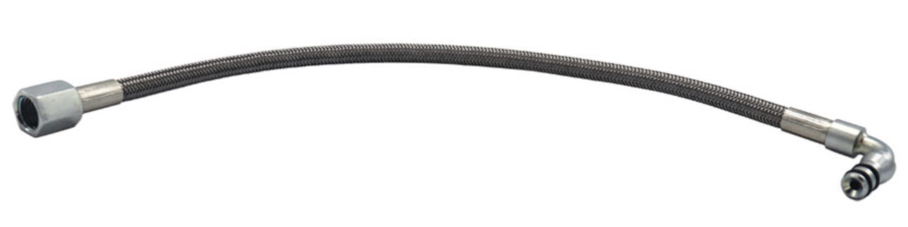

    Hows the tilton kit looking? I like that the hoses appear permanently attached straight into the housing. Would be unlikely to loosen or leak.

    It’s certainly a class act. Definitely a cut above the pos I was running before. The hoses are pushed into the housing with a double o-ring and a c-clip to retain it. They swivel around to wherever you need them.

    Oh yeeeeah! It’s here. Shipped out of Dubai.

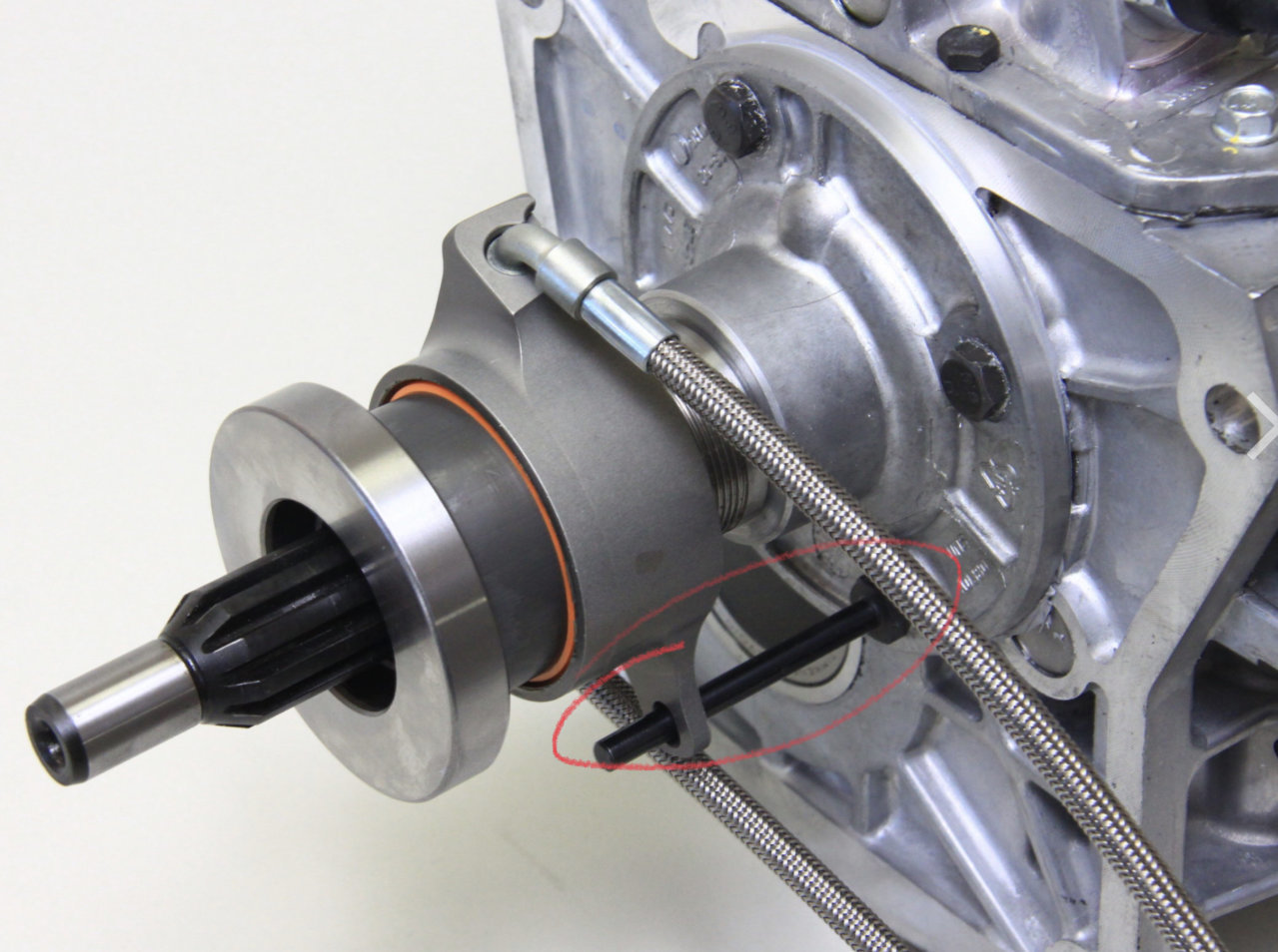

    Question about the Tilton unit. Once the threaded shaft is adjusted, what keeps the unit from spinning when the clutch is applied?
  14. Jan 4, 2021 at 5:42 PM
    #74
    BillDaCat8
    BillDaCat8 [OP] Well-Known Member
    Jun 25, 2017
    #222348
    1,919
    Jake
    PHX
    07 4x4 Access Cab M/T
    My shit is all stock.
    There’s a pin that prevents rotation.

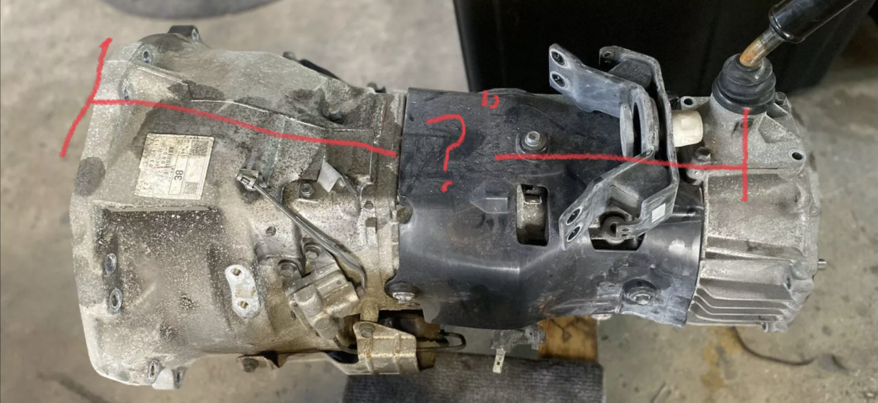

    Anyone have their 6mt out of the truck? Or possibly one laying around in the corner of the garage? I need a measurement. Bell housing face to center of shifter socket.
  17. Jan 10, 2021 at 4:17 PM
    #77
    BillDaCat8
    Jun 25, 2017
    #222348
    1,919
    Jake
    PHX
    Thank you.
    So, it looks like RA60 and RA61 are in the same spot.
    And thank you @Jowett for the measurement of the RC62F which is 25.625”.
    This means that the shifter is going to sit roughly 1.8” further back than the RA trans.

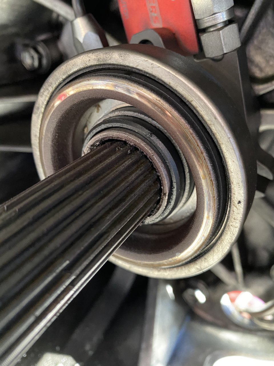

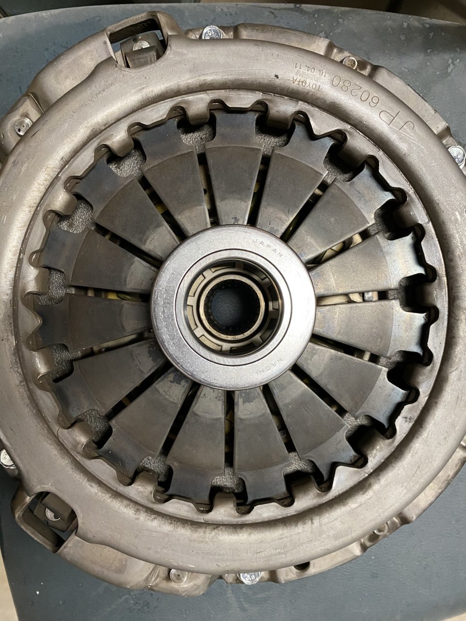

    I’ll just leave this here...
    garciav, spencermarkd, samiam and 2 others like this.

    I'm sure mine will look the same. I hear it squealing in the mornings when she cold.
