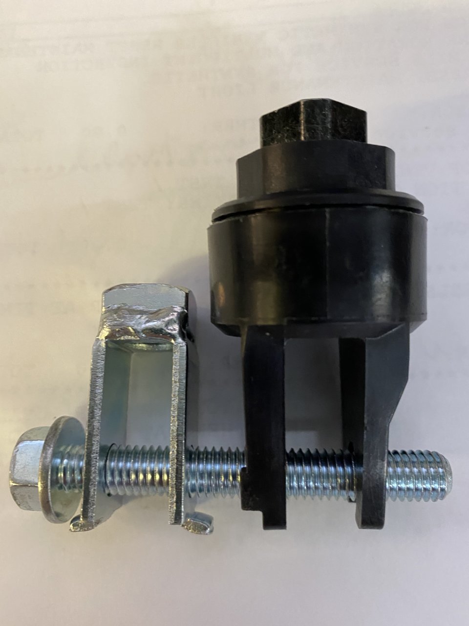

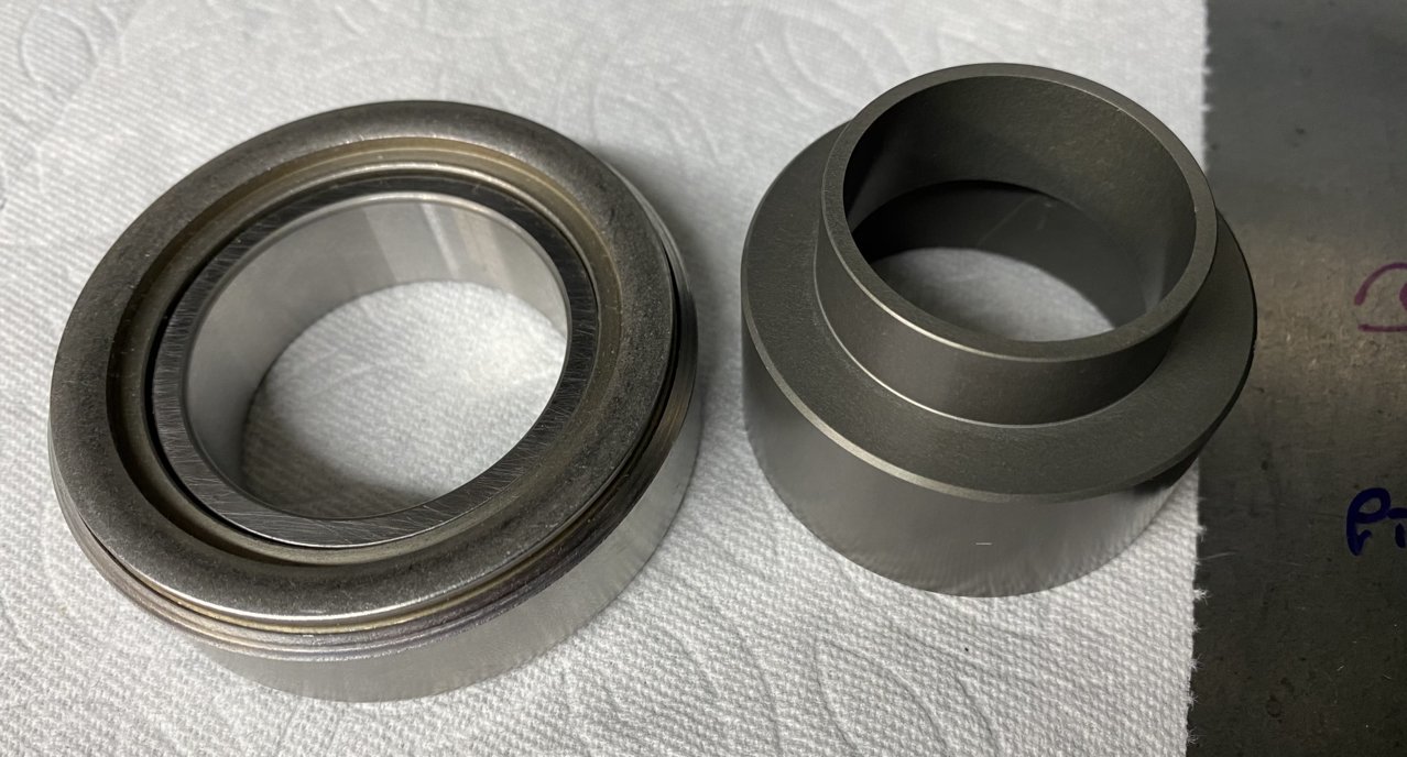

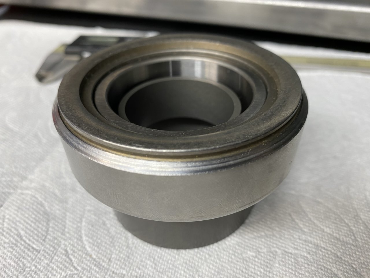

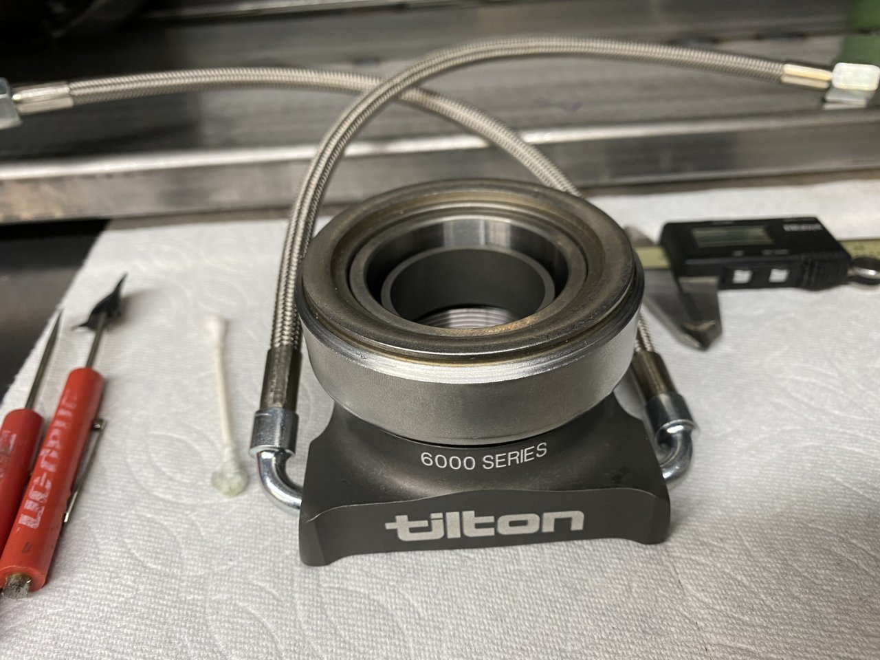

    Toyota 90363-45013. I’d like you to meet Tilton 62-612. I think you two are going to get along great.

    A sneak peek of another phase of my clutch re-vamp.

    what’s going on here ?

    No more plastic shit!

    It’ll make more sense once I’ve taken more pictures.
