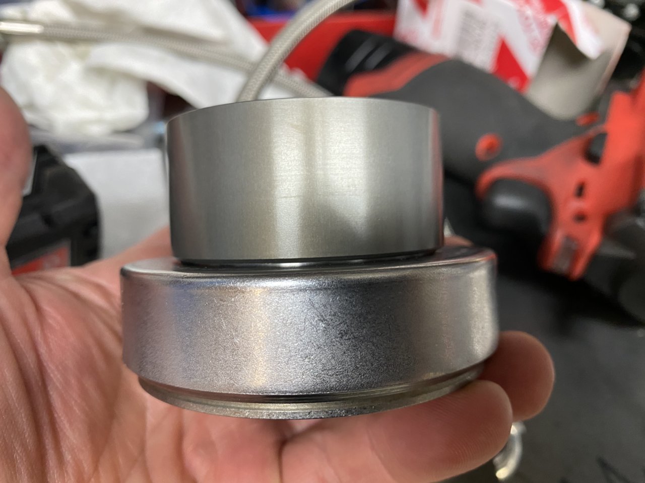

    is this for the rod end of the clutch master cylinder ?

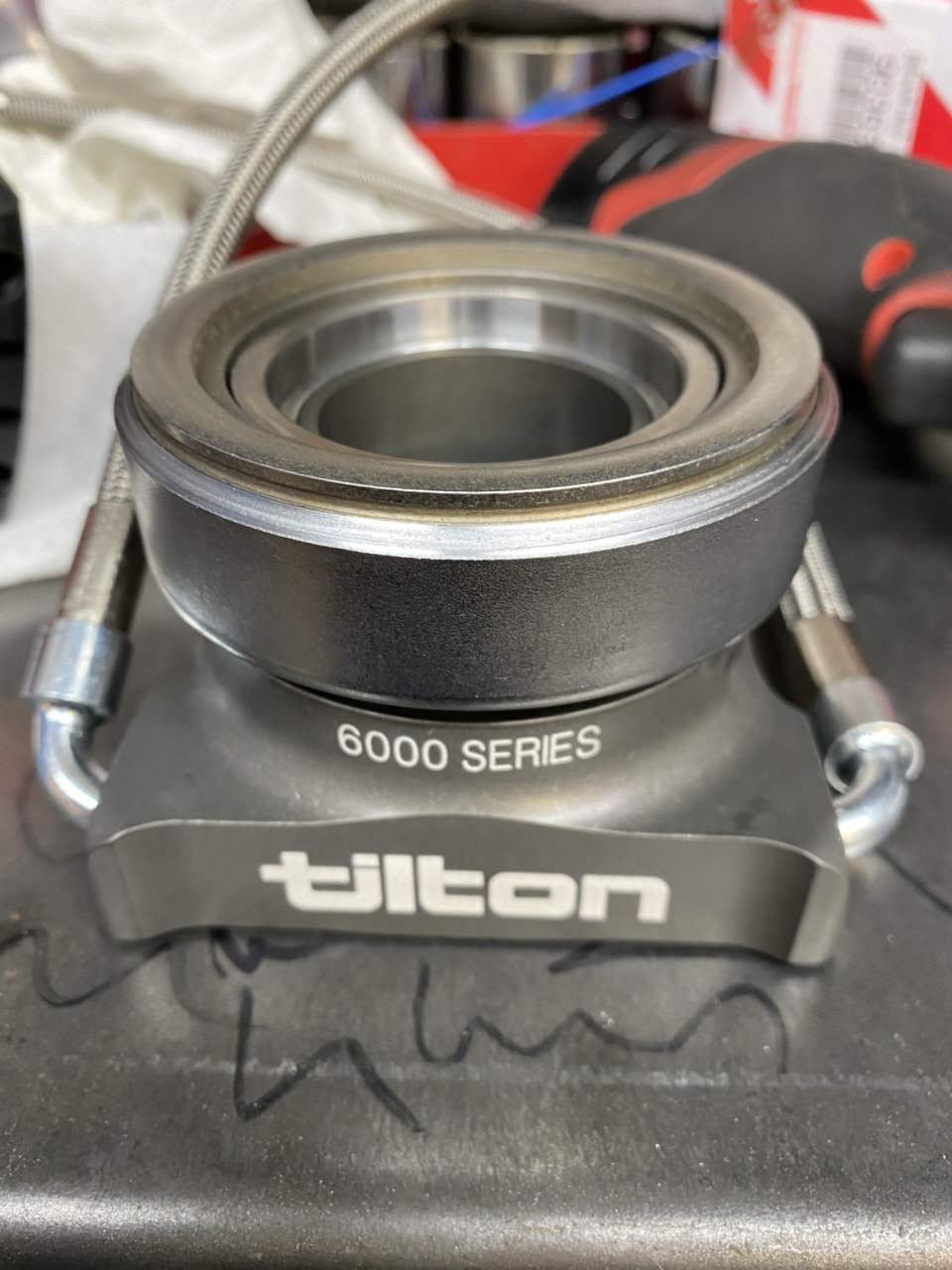

    @BillDaCat8 from what you can tell off your research, can this bearing work with the CM piston ?

    Possibly. Would need to machine a spacer to adapt it to their piston. Would likely need to edit that spacer behind the unit as well to get the clearance just right.

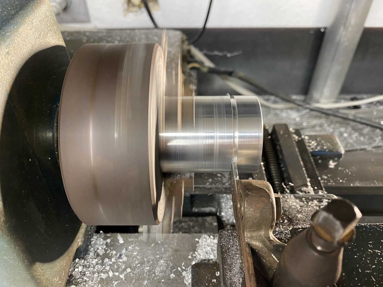

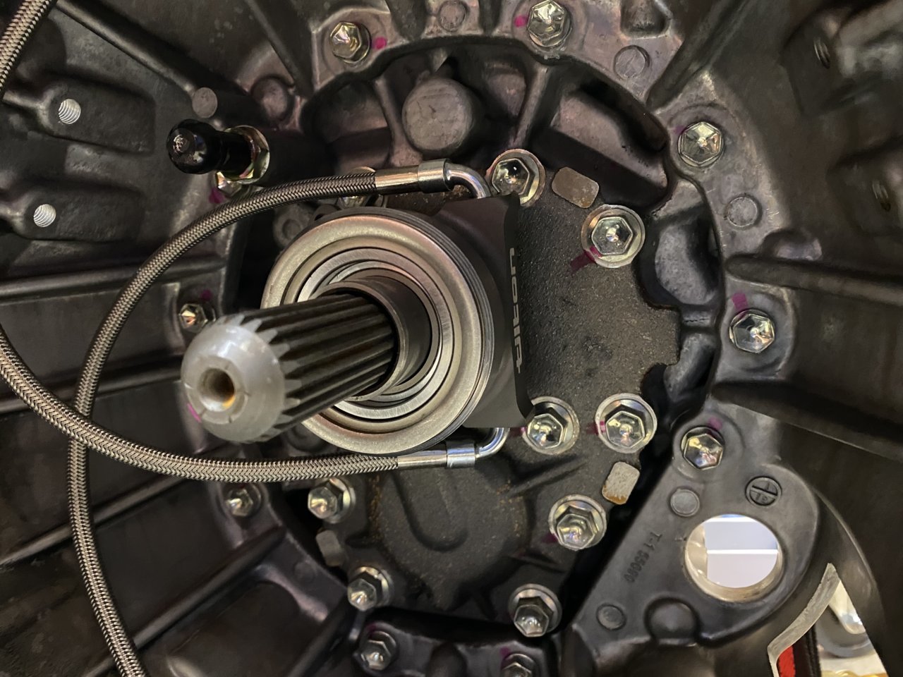

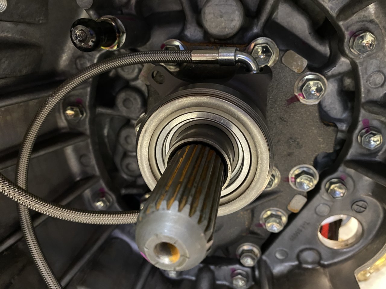

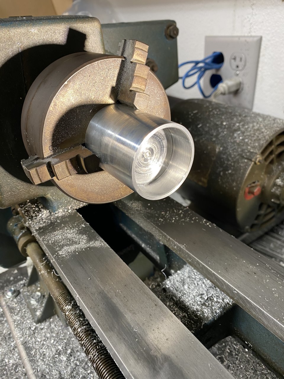

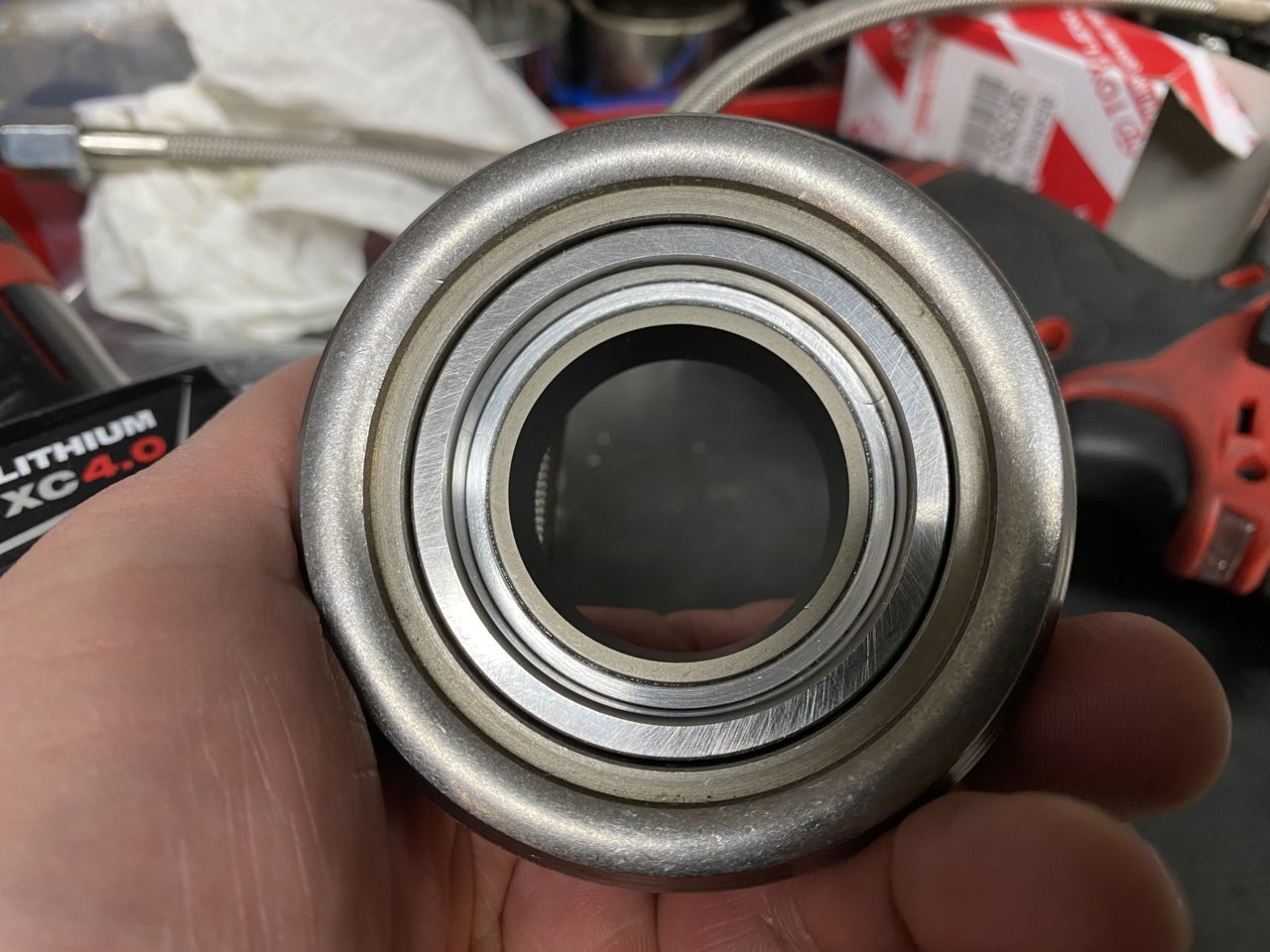

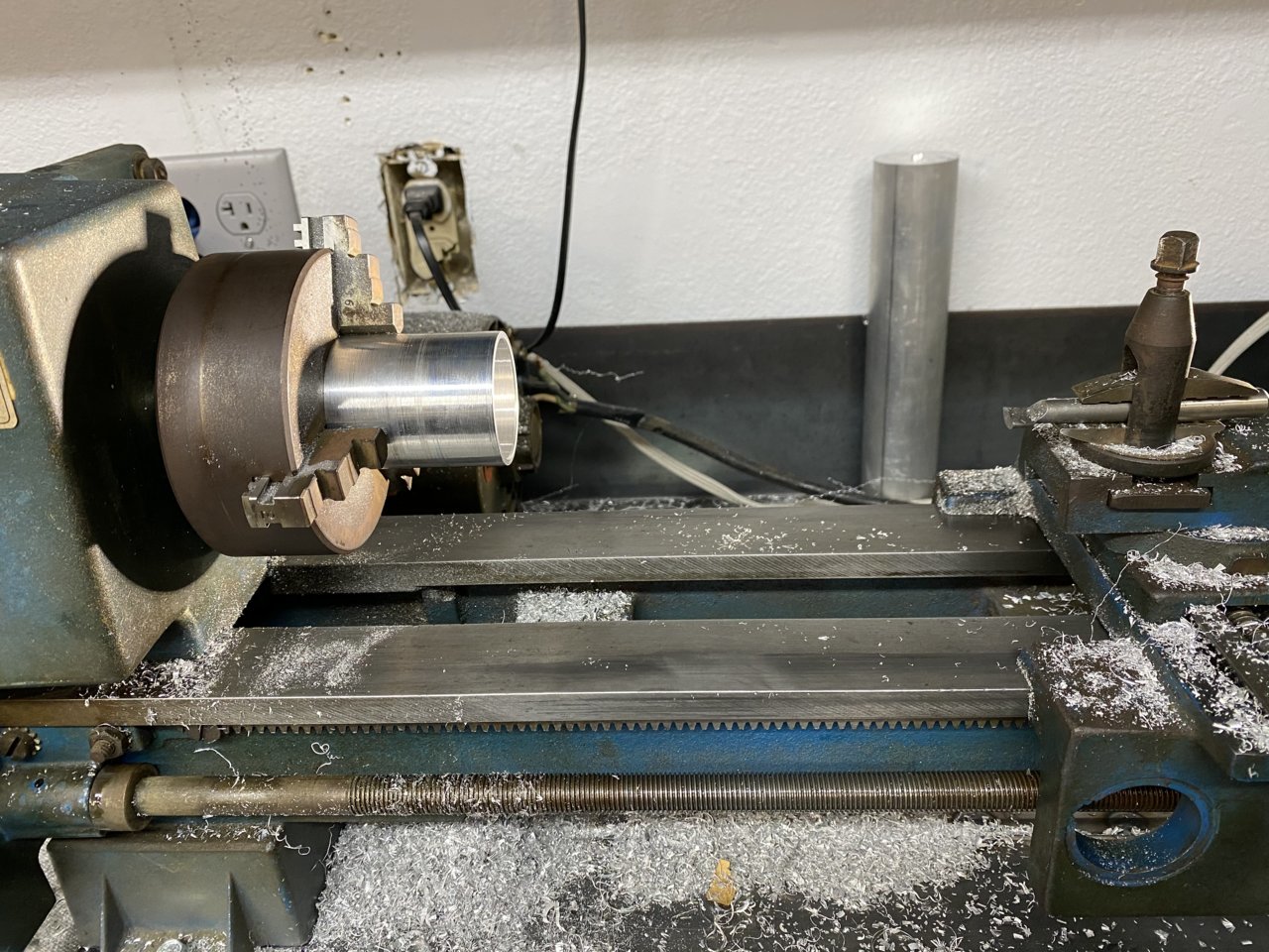

    Spacer to mate piston to bearing completed and then assembled.
    I ended up machining for a .001” interference fit. Froze the piston and heated the ring. They slid together like butter. I forgot to take pics of that part. Here’s the piston back in the freezer about to be mated to the bearing. You can see the spacer already installed here. Yes, those are ice chunks it is sitting on.
    Aaand here it is pushed into the bearing. Took a bit more force this time to push it into place. I’m guessing because my spacer ring had “grown” .001” or so after it was installed on the piston. Next time I’ll be ready for that little change.
    Slid it all together and a quick test fit in the RC62F. It would look pretty much the same in the RA60F.
    Once I have the new clutch bolted up, I’ll measure that up and will at that point be able to finalize the spacer length needed behind this assembly. Although, it’s not super critical due to the adjustable nature of the Tilton bearing. Just as long as it’s not too thick.
    The old and the new.

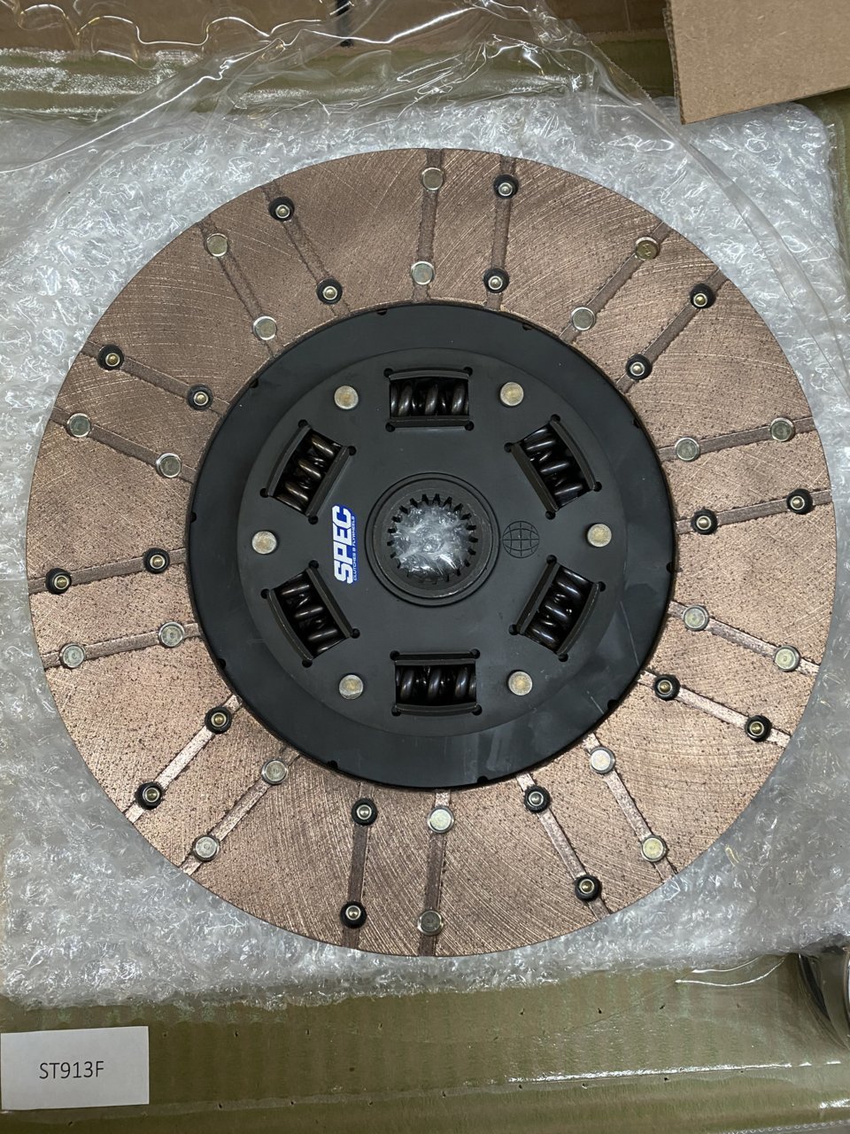

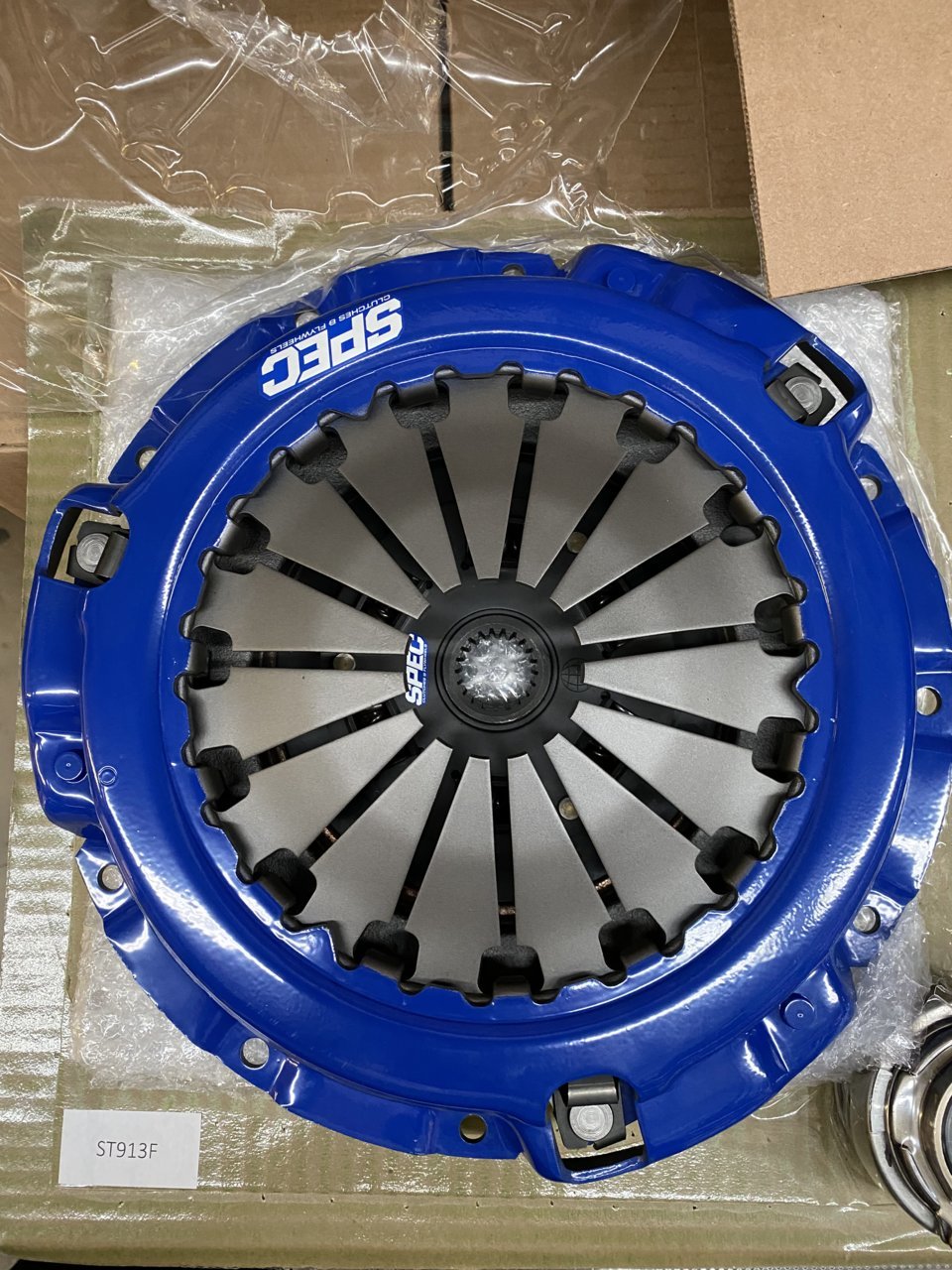

    Spec 3+ clutch has landed. This thing is pretty gnarly. Disk is quite heavy.
