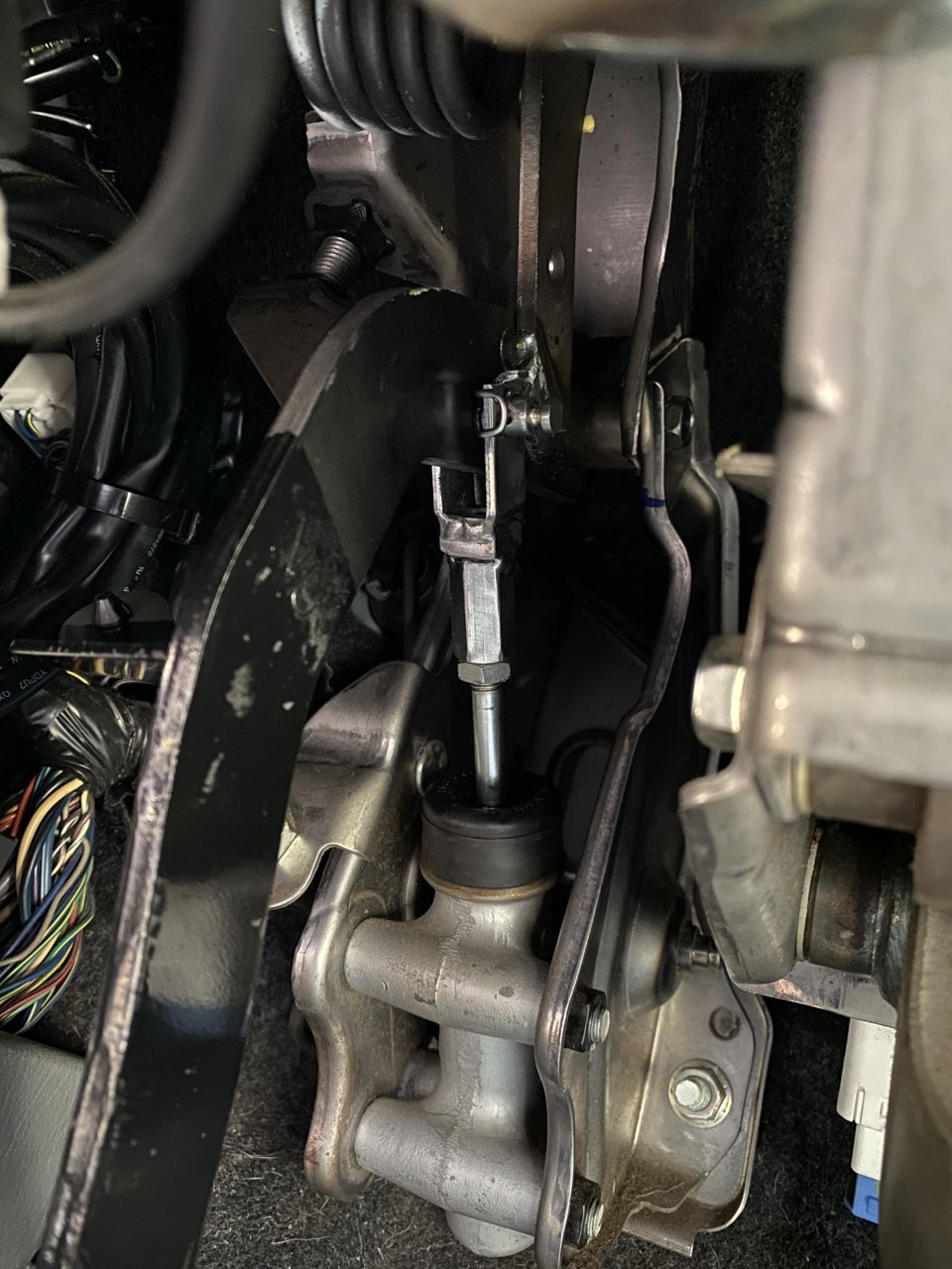

    megillet Resident Badass
    May 20, 2010

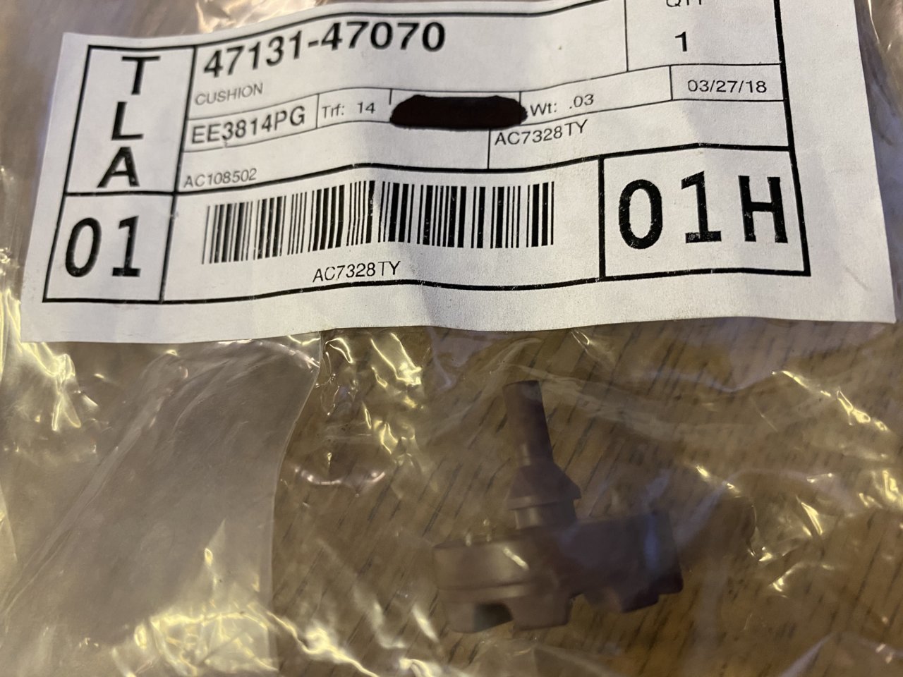

  4. Feb 15, 2021 at 5:58 PM
    #164
    BillDaCat8
    BillDaCat8 [OP] Well-Known Member
    Jun 25, 2017
    #222348
    1,915
    Jake
    PHX
    07 4x4 Access Cab M/T
    My shit is all stock.

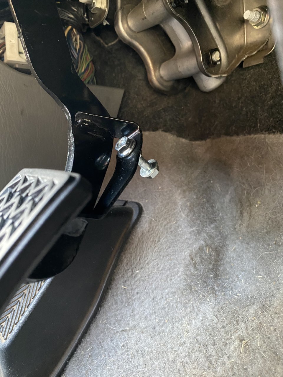

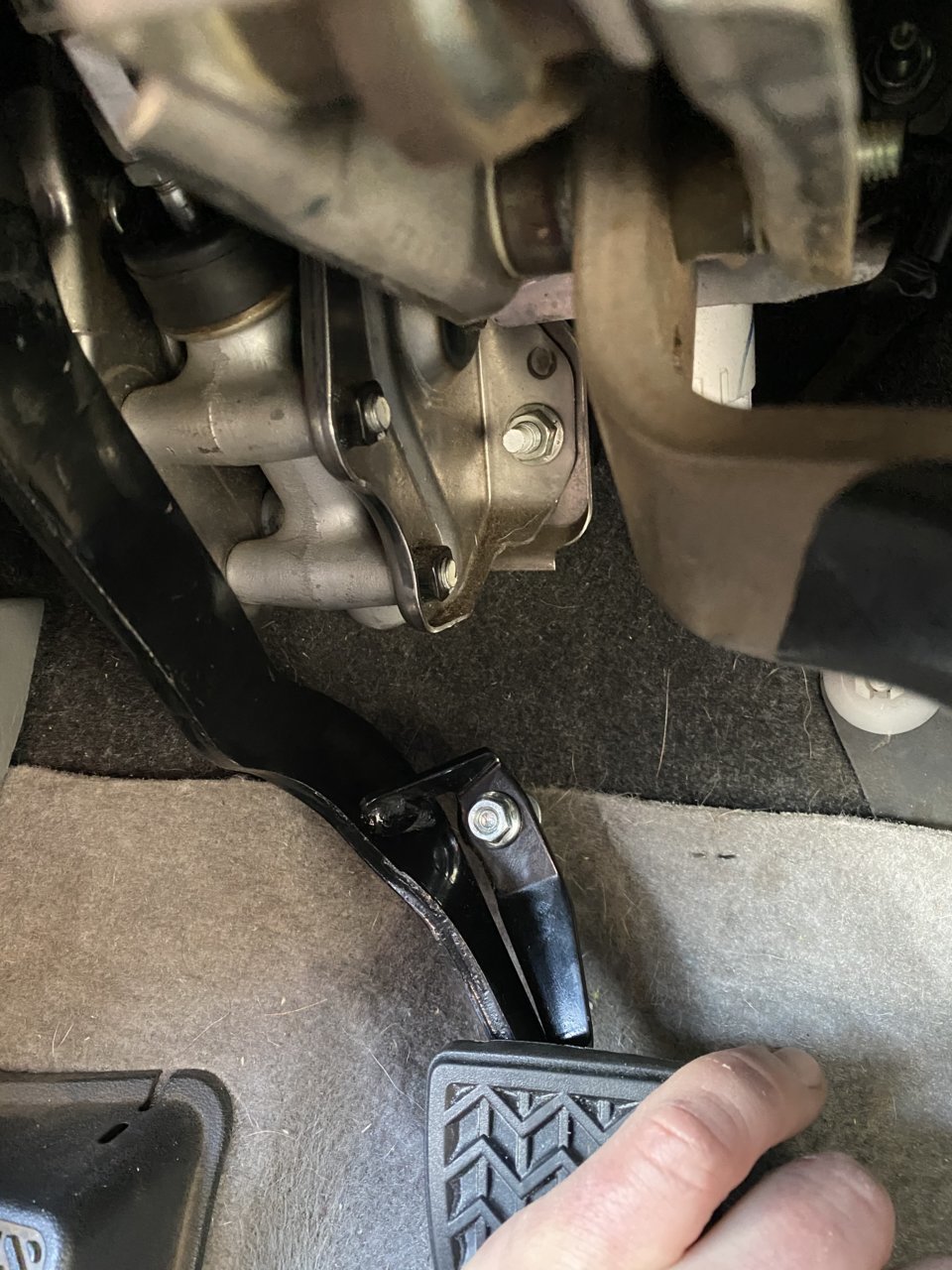

    So, I had this thing on hand. Did the trick. With the switch pulled all the way back, and this thing on the pedal, it is enough to push the switch. Not the perfect solution. But, functional.

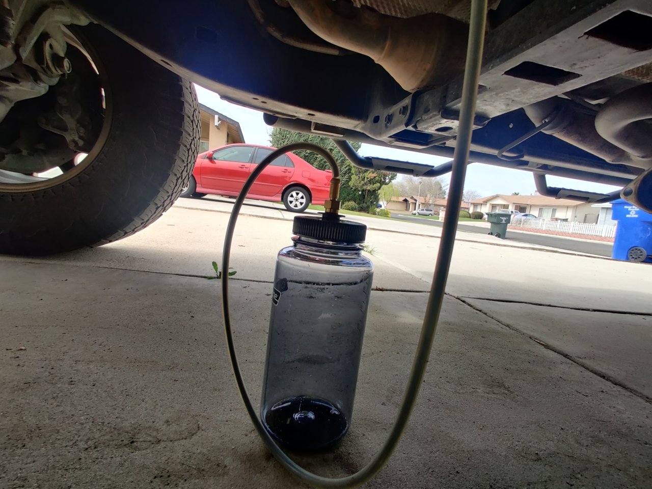

    So I decided to bleed my clutch masters hydro bearing over the weekend. The fluid came out black. Looked like used diesel oil.
    The clutch feels a little better but still squeaks.

    Uh-ooooh. I bet that seal is about to die on you.
    TodayWasTHeDaY likes this.

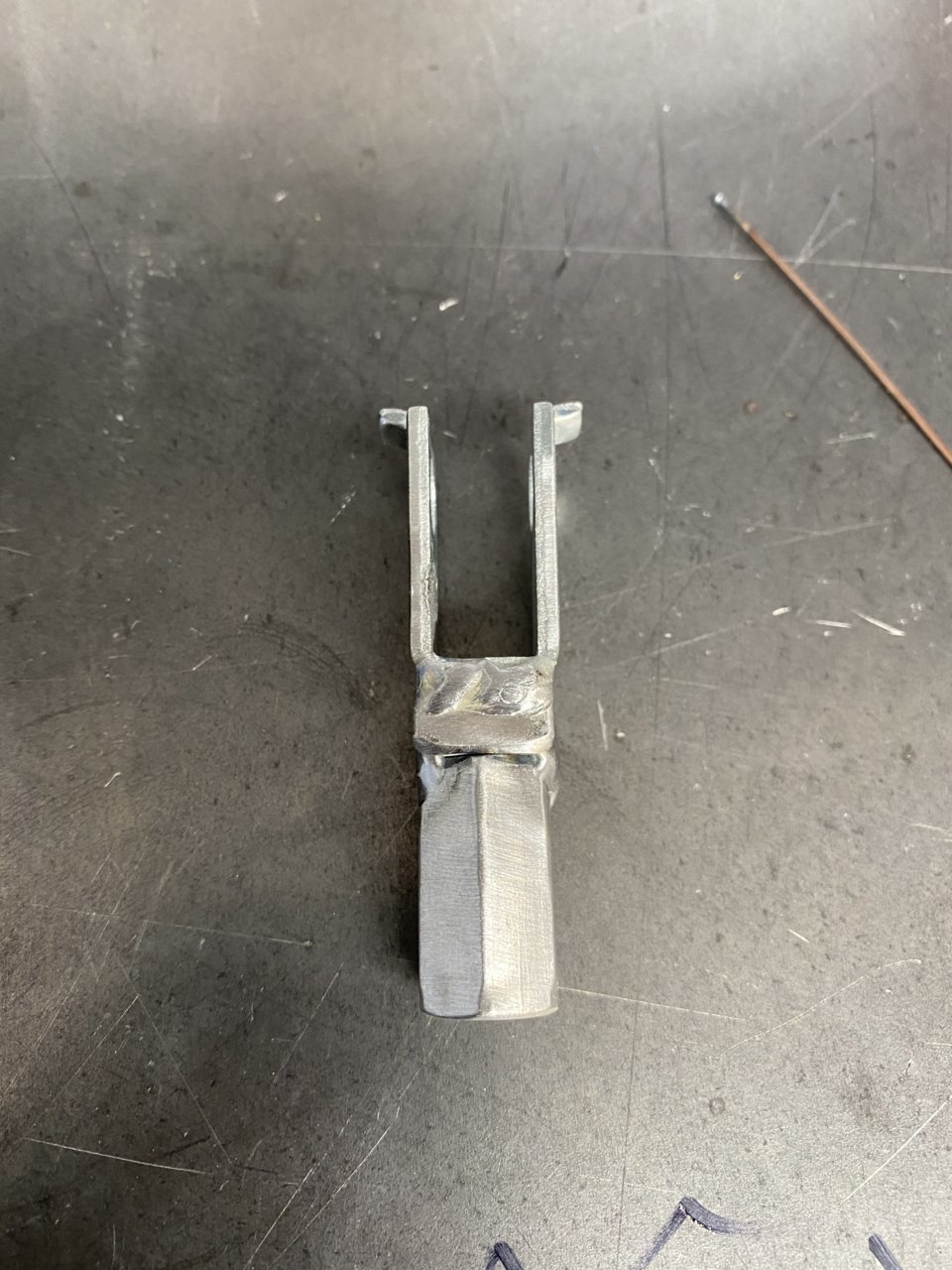

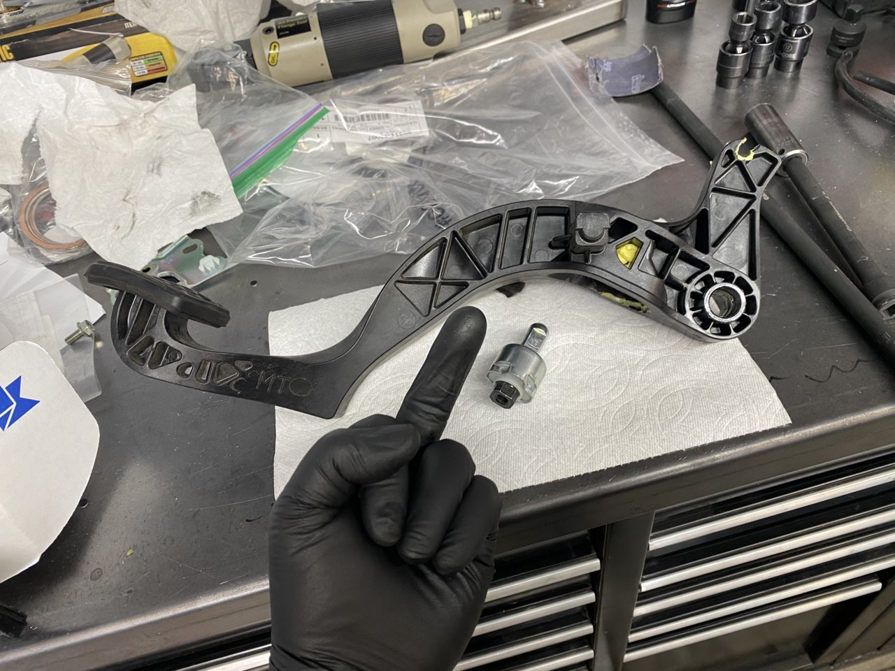

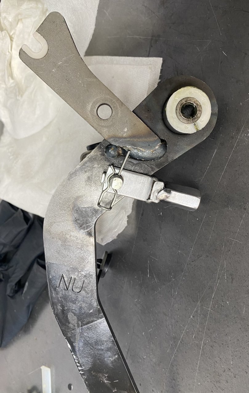

    Reading your other posts and seeing your ingenuity your resourcefulness and your access to machinery, I suspect you came to the conclusion about the metal FJ cruiser pedal on your own, but part of me hopes that you somehow came across my endeavor to retrofit the FJ cruiser clutch pedal into a second gen Tacoma for the inspiration.
    :rofl:
    I welded a piece of scrap metal onto the FJ pedal to extend down to the MC and used a Honda Motorcycle rear brake MC clevis. I'm also using an FJ cruiser MC as they are cast instead of plastic like my OE one was. My clutch is rather heavy, I've been blaming this on having the urd stage 2 clutch and heavy flywheel, but I'm beginning to wonder if extending the pedal instead of extending the rod changed my fulcrum enough to require additional leg effort.
    I also had to shorten and change some of the bends on the FJ pedal as well as I welded on extensions to reach the clutch start cancel and cruise control up switches, not too long ago I purchased a new OEM plastic pedal and was going to use it to make a jig and get another FJ pedal to make sure the contours matched as I'm not quite happy with my clutch pedal position.
    Apparently new Tacoma MC's are cast.
    I'm curious on your thoughts on the matter, if you've got the time I'd like to pick your brain about it and perhaps swap some pictures around shoot me a pm if you're willing.
