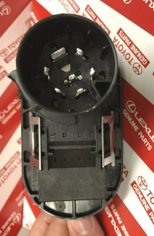

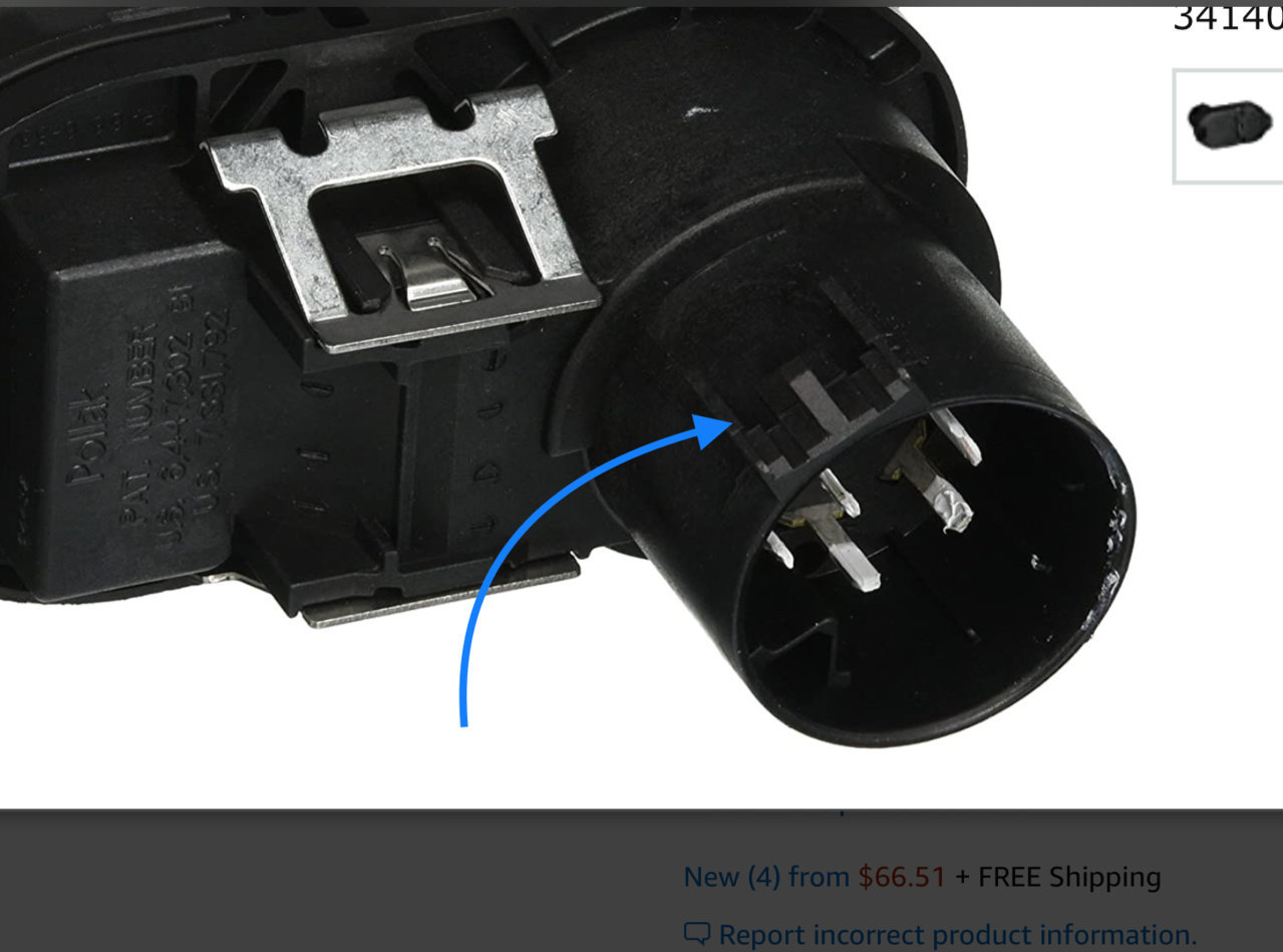

    a pic of the back of it here it's just a male connector with pins, looks like you unplug the OEM T12 and plug this in. Not sure if this will works for 2nd gen though without physically seeing the connector and don't see a schematic for pinouts included to know wire functions match up with the correct pins. Been many moons since I saw my OEM connector lol
    https://www.amazon.com/Genuine-Toyota-PT725-34140-Trailer-Connector/dp/B00T4K2GW2

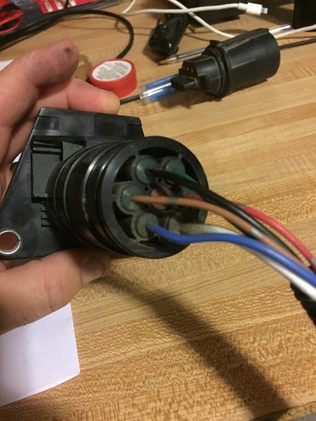

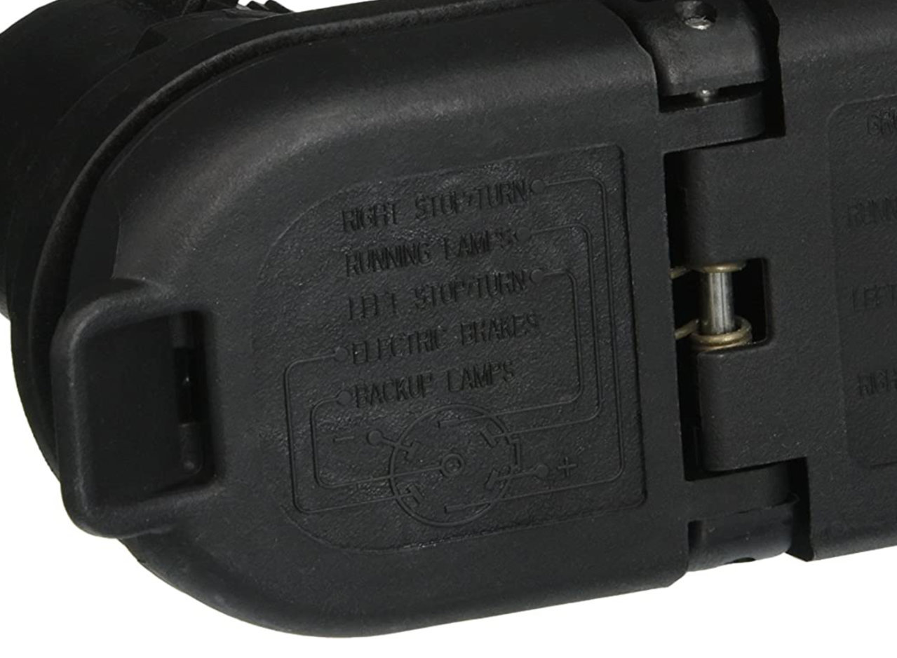

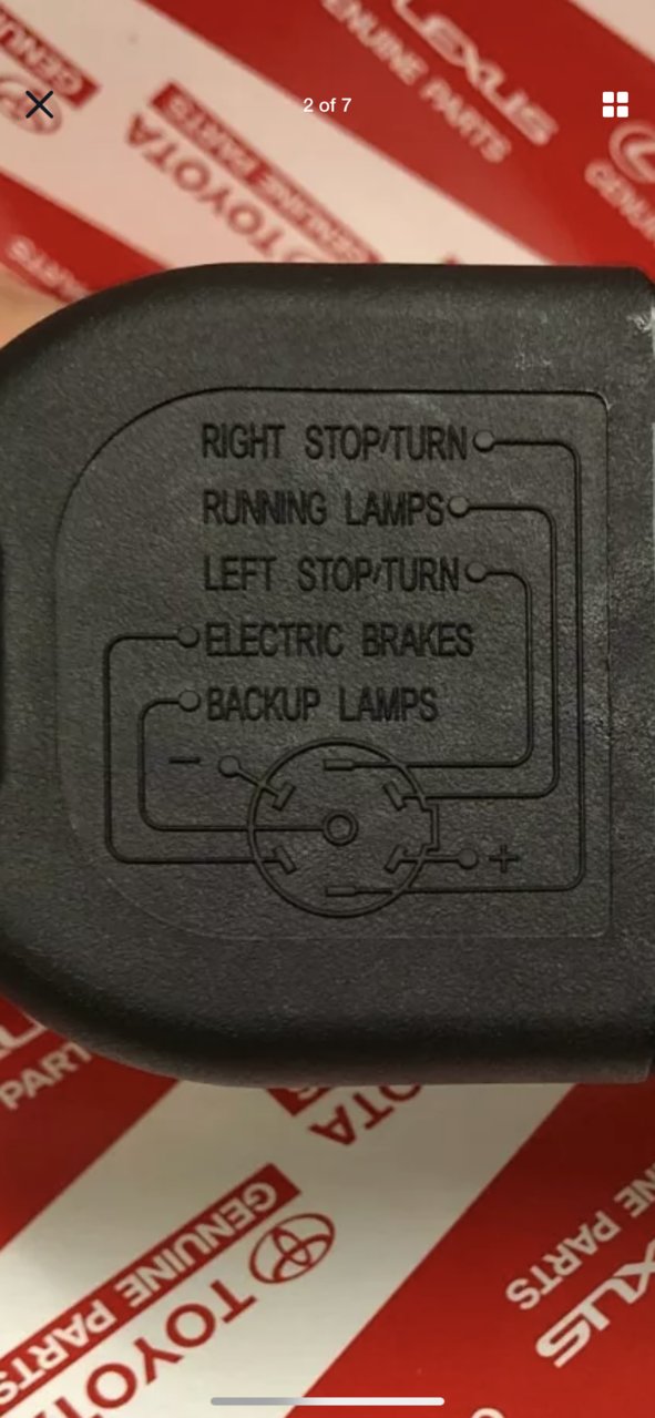

    Here’s the pics of the 3rd gen
    F7C3DA55-B0A4-4737-B247-DCFBD1274274.jpg CC171138-CB9A-4AD0-B6D7-C5AB683256BC.jpg F7C3DA55-B0A4-4737-B247-DCFBD1274274.jpg CC171138-CB9A-4AD0-B6D7-C5AB683256BC.jpg

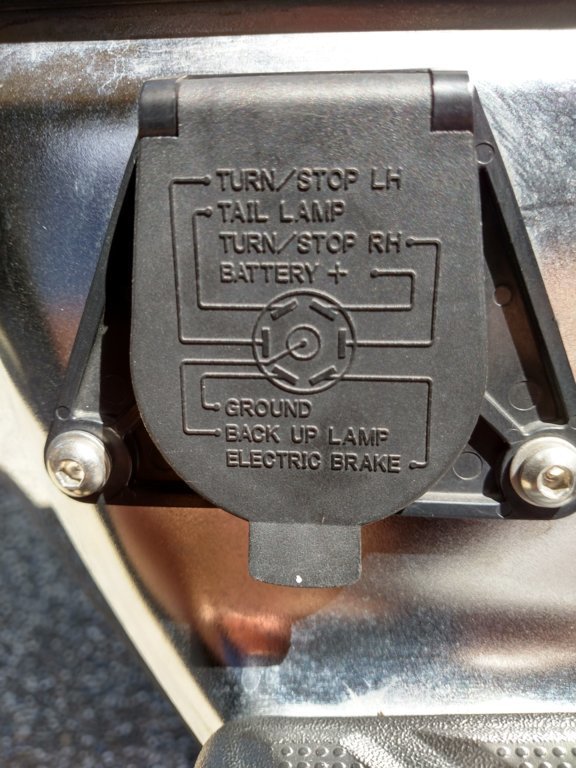

    2nd Gen

    I’m going to be honest. I haven’t crawled under my truck an looked at how the T12 plugs in.
    But goin by these pics, it doesn’t look like it will fit?
    I don’t see any snap for the clip, like you see on the 3rd Gen or the one on Amazon?

    So looks like maybe if the connector physically fit, It would work but the 4 pin wouldn’t be wired to the right pins. You’d have to depin and match the 2nd gen pin #s to match the 3rd gen layout. Of course that cover would be incorrect for which wire is which function at that point.

    Looks just like the 3rd Gen?

    there isn’t. It’s that BE1 connector upstream. The 2nd gen comes as a whole assembly with the connector on the other end that plugs in near the spare tire on the drivers side.
    https://www.ebay.com/itm/Genuine-OE...169-04010-FAST/152993033875?fits=Model:Tacoma
