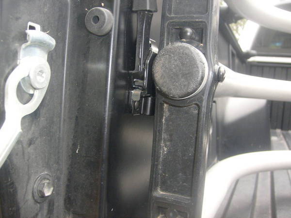

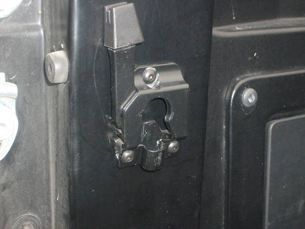

    I recently found a bed extender for $50 on Craigslist. I was less than thrilled when I realized the bracket kit was a "quick release" set. So I set out to make it as hard as possible for someone to steal my bed extender. I flipped the brackets upside down, then added a slide latch piece to close in the extender.

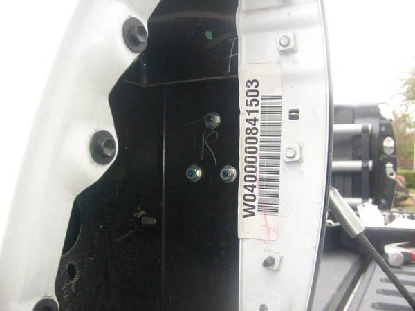

    You'll need to remove your taillights so that you can get to the area behind where the brackets attach to your bed. Remove the bolts that are circled, then pull straight out on the taillights:

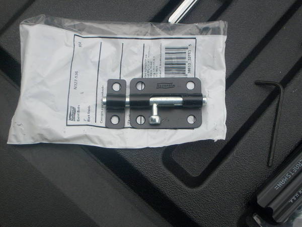

    I found some black slide latches at Lowe's for $3.50 a piece.

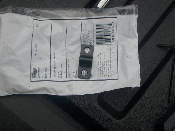

    You'll only need this part:
    You'll have to flatten it out a little bit (I used a hammer on the concrete) so that the holes are spaced out to 1 1/4". It should look like this when attached:
    Here's where it gets annoying. You have to insert the bed extender into the brackets, then bolt in the slide latch piece. It should look like this:
    Tighten the 3 nuts on each side. I put some blue threadlock on all 6 bolts just to be sure.

    so what was the point of mounting the brackett upside down?

    To make it one step harder to get to the bolts when the tailgate is closed.

    I would imagine mouthing it upside down would cause more ware and tear on the bracket. I actually have had to remove the extender fairly frequently also so this wouldn’t be an option for me.
