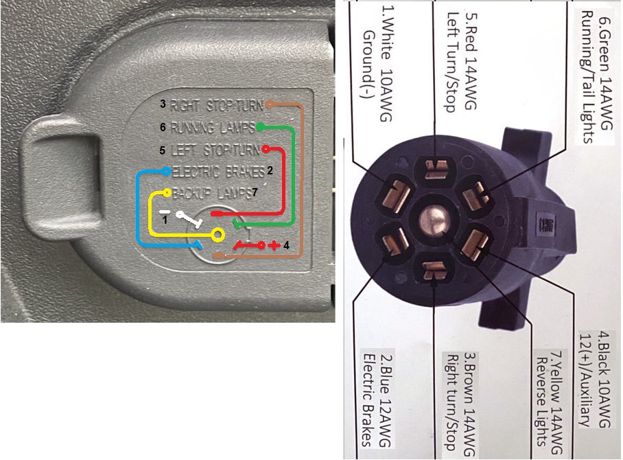

    I am hoping someone can help me with 7 pin wiring on my 2019 SR5. The photo on the left is the cover over my 7 pin receptacle and the photo on the right is of my standard wiring harness. The part that has me confused is on my truck the receptacle is keyed at the 3 o'clock position and the standard wiring is set up to be keyed at the 12 o'clock position. It looks to me as though it will change by two positions. Green will now be + positive, red will now be right turn/stop ECT.IMG_4052-2 copy.jpg

    What is happening, is that you are looking at the trailer plug from the wrong direction.
    When looking at the trailer plug, you need to be looking at it inverted. As if you were plugging it in.
    It looks correct to me.

    Thank you for the info. I feel a little foolish for not figuring it out but am glad I asked before cutting wires.

    The notch in the plug is the reference. The trailer connector I inverted the view so you can see the relation of the pins. If you still are unconvinced, test each pin to function of both side, vehicle and trailer.

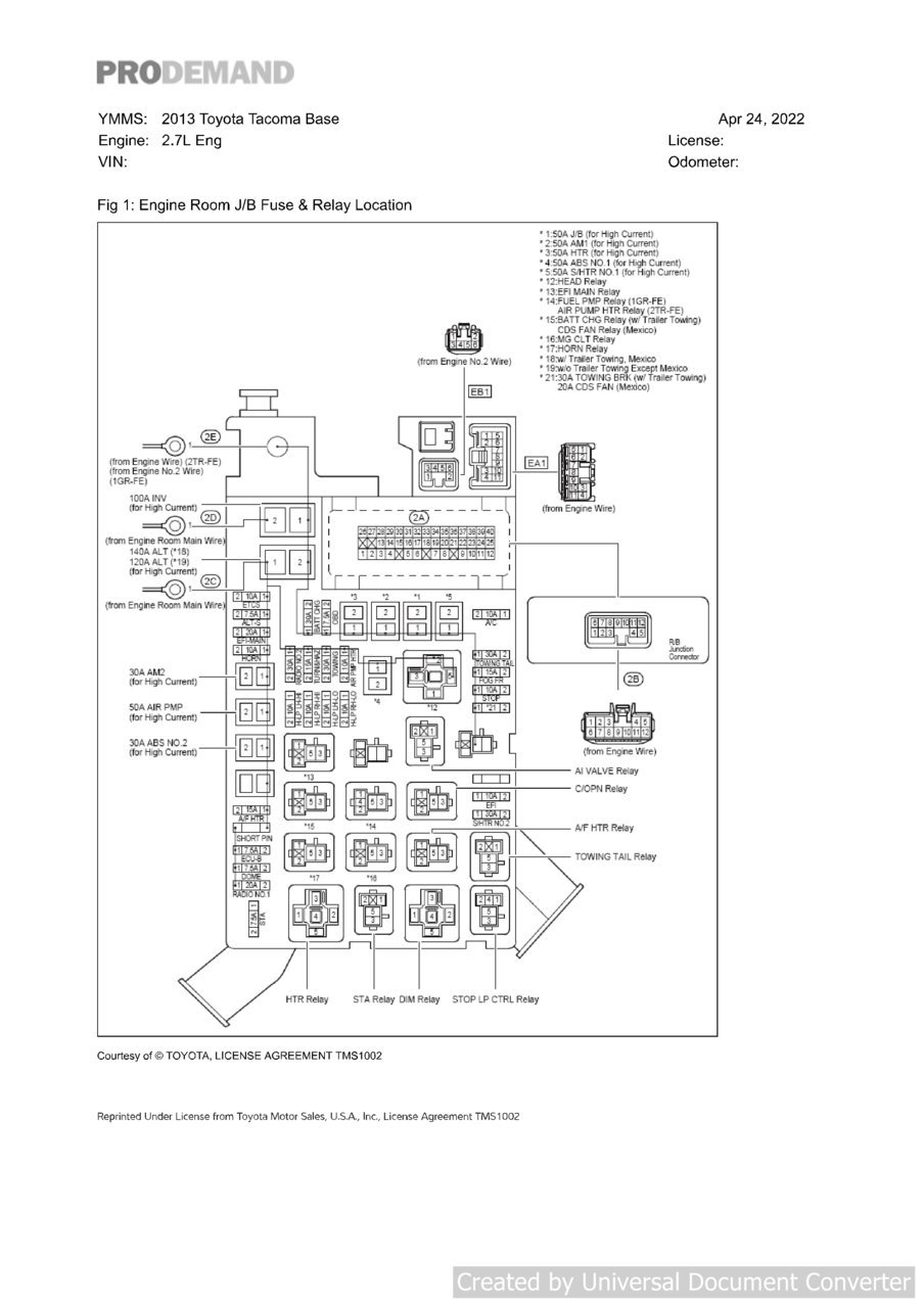

    Um.... does anyone have an answer to this?

    @Dm93 help me out bud.
    I can’t answer that question until Sunday. No access to diagrams.

    jumper on towing brake circuit (no towing brake module)
    Trailer charger circuit (ign on)

    I just happened to be sitting on my tailgate waiting for my dad, just checked and it has power with the key in the run position only.

    Thank you all. Any idea if there is a constant hot 12v+ available in the rear area? I'm trying to tap in an LED dome light in the cap.

    There's nothing that I'm aware of.
    Assuming the truck in question is the 2013 in your profile information I see 2 options:
    A:Remove the BATT CHG relay and jump pins 3 and 5 together to have constant power at the trailer plug and changing the 30A BATT CHG fuse out for one appropriate for the size wire you run to your light (no larger than 30A).
    B:Run your own wire from the battery being sure to use the appropriate fuse for the size wire you run.

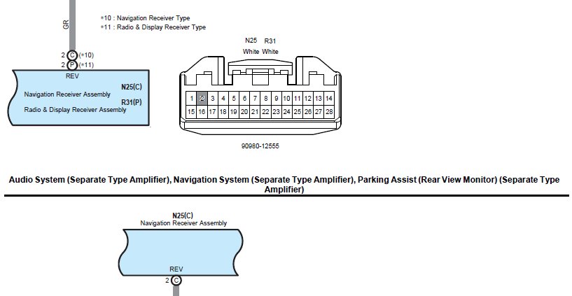

    I have a four-wheel camper now, so I can't use my rearview mirror, I am not interested in an LED mirror combo, so I want to connect a rear view mirror to my JVC After market head that has a backup camera Video-in. Rather than have the camera only work when backing up, I want it to work with a switch too, so I need power when the truck is on, rather than only when the backup lights are on.
    Here is my thought, a switch that when in the off position turns on with the back up, and in the on position will allow me to see what is behind me.
    1) Is anyone using a nice after market switch or can you suggest which toyota switch to use?
    2) My thought is that in the on position it would connect to the power when the truck is on,
    3) when off the the reverse trigger on the head unit.
    4) Connect the power and ground on the 7pin
    If anyone has any thoughts, other than your batt shit crazy please let me know them. :)

    Aftermarket Head Unit usually has/needs a back up circuit "trigger" so the anytime view can function.
    Your added switch (SPDT) would be a duplicate of the aftermarket head unit feature.

    This what I am thinking with one connection being the trigger and the other being the power so I can leave it as a backup camera, and then when driving down the road turn it on to use as a rearview "mirror". Does anyone know if the trigger is a 12v connection?

    The back up (reverse) circuit is 12v DC.
    Which original version Head Unit are you changing?
