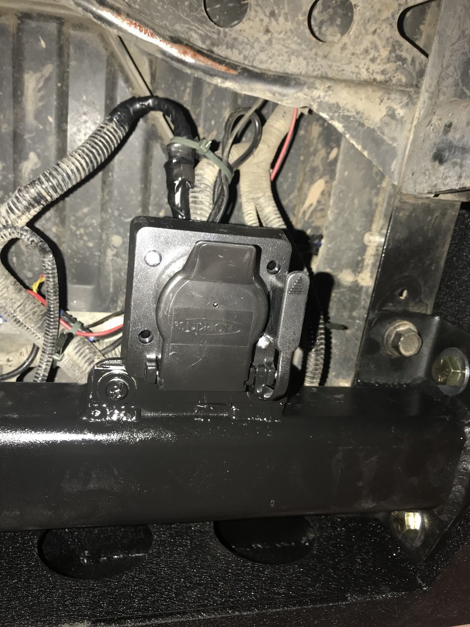

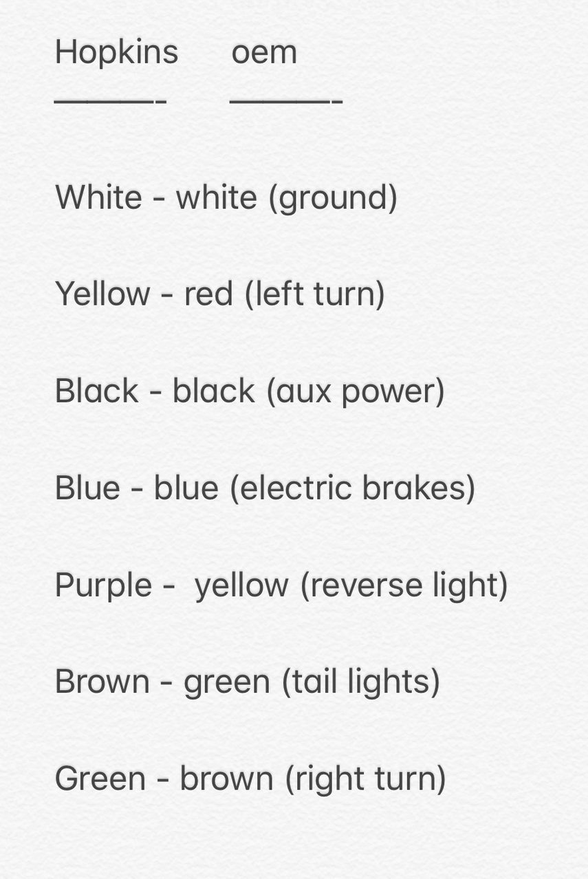

    I used a Hopkins 7/4. 15$
    AB64BADD-B0FC-493A-B7CA-BD36A349C5C2.jpg 1D7A52B9-D05E-46CC-9BD8-D300D304FCA8.jpg
    Gunshot-6A, bobank, mrbalky and 3 others like this.

    Those wire colors that Anthony posted aren't entirely correct. Those are the colors if you just chopped off the 7 way connector and attached a replacement. Unfortunately, Brent doesn't have that plug in harness part. He has nothing after the inline harness connectors. So, the truck harness wires are different colors, than the wires after the harness connector.
    http://www.customtacos.com/tech.old...toyewd/06toypdf/ewd/2006/tacoma/h/em01d40.pdf
