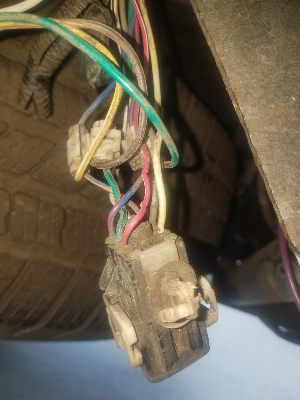

    Can anybody clear this up for me and tell me what wire goes where? I bought a universal plug from U-Haul that has the four flat that plugs into the four flat now I have to hook in my electric brake controller reverse and the power. If anybody can tell me what color are those wires are could be a lifesaver

    It is a universal plug you plug the four flat and to make the other four flat. Then you have to run the electric brake wire, the reverse wire, and the power wire. After you run those three wires that gives you your 7 pin. My problem is I don't know where to put my black, blue and purple wire into the factory harness. As stated before I don't have the plug that comes off of the harness I'm going just into the harness itself in front of the plug if that makes sense

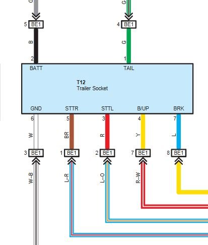

    If you look at the schematic, you see the truck harness colors are different than the colors after the connector. so, on the truck harness side, you will have
    trailer brake+ Yellow
    Back up red/white
    Battery charge wire grey
    Also, you need to make sure the ground wire is large enough wire to carry the load of the trailer brakes.
    Kolter45 likes this.

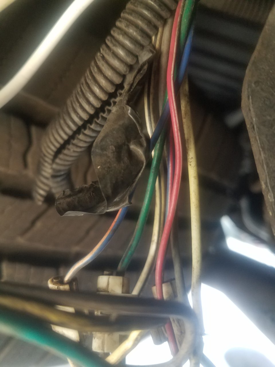

    I do not have a yellow wire my only wires left is a all white the red with a white striped, Gray, and white with a black stripe wire?
  10. Jan 17, 2019 at 12:18 PM
    #70
    Lil red 02
    Lil red 02 Spendaholic
    Nov 30, 2018
    #274325
    455
    Brent
    Sanford, Fl
    2005 Doublecab longbed
    The yellow wire in the pictures is tapping off of the blue an orange wire for the 4 pin
  11. Jan 17, 2019 at 1:15 PM
    #71
    Muddinfun
    Muddinfun Well-Known Member
    Apr 17, 2017
    #216500
    7,489
    I'm guessing that the white is faded out yellow. Check it with a multimeter while somebody pushes the brake controller or the brake pedal.

    Aha I didnt think of faded but when I can get another person here I will try that, can I also use a test light?
  13. Jan 17, 2019 at 1:17 PM
    #73
    Muddinfun
    Apr 17, 2017
    #216500
    7,489
    BTW, those scotch locks are HORRIBLY unreliable.
  14. Jan 17, 2019 at 1:18 PM
    #74
    Muddinfun
    Apr 17, 2017
    #216500
    7,489
    Yeah, a test light will work too.

    So I just use a big piece of all thread and propped it up against the seat put pressure on the brake light and Wallah that white wire has power now so apparently it is a faded yellow like you said

    For further confirmation, I figured out the wire connector numbering sequence based on comparing your pic and the terminal numbers on the schematic.
