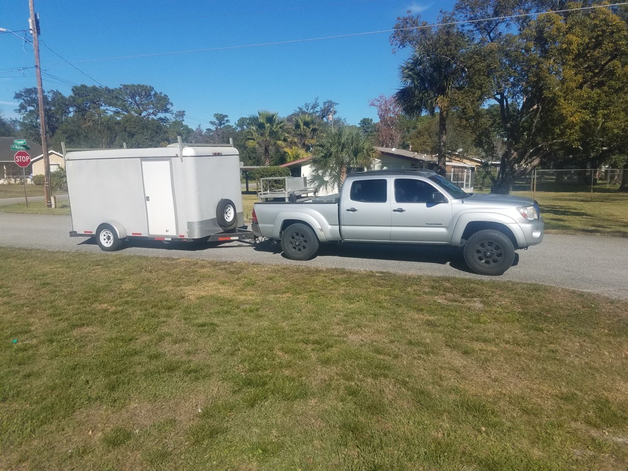

    Awesome got you yes sir my ground wire is a good thick one and it came pre connected to the back of the U-Haul seven-pin connector so I hooked it straight to the frame where the 4-pin was mounted to and screw to the frame. Cross your fingers and wish me luck I'm fixing to hook up to my lawn trailer and see LOL
  2. Jan 17, 2019 at 2:07 PM
    #82
    Lil red 02
    Lil red 02 Spendaholic
    Nov 30, 2018
    #274325
    457
    Brent
    Sanford, Fl
    2005 Doublecab longbed
    Well my brother upon first inspection to hook up to my trailer all lights are working I have power to my lights inside when I hit the brake it shows there's connection. So all there's left to do now is get it and drive it down the road but I believe this light project is done, thanks to you. Not sure where you're at but if you're ever in my neck of the woods I owe you a mixed drink, beer, glass of sweet tea or whatever your taste buds prefer for saving me from going to Toyota and getting ripped off. Hats off sir thank you very much

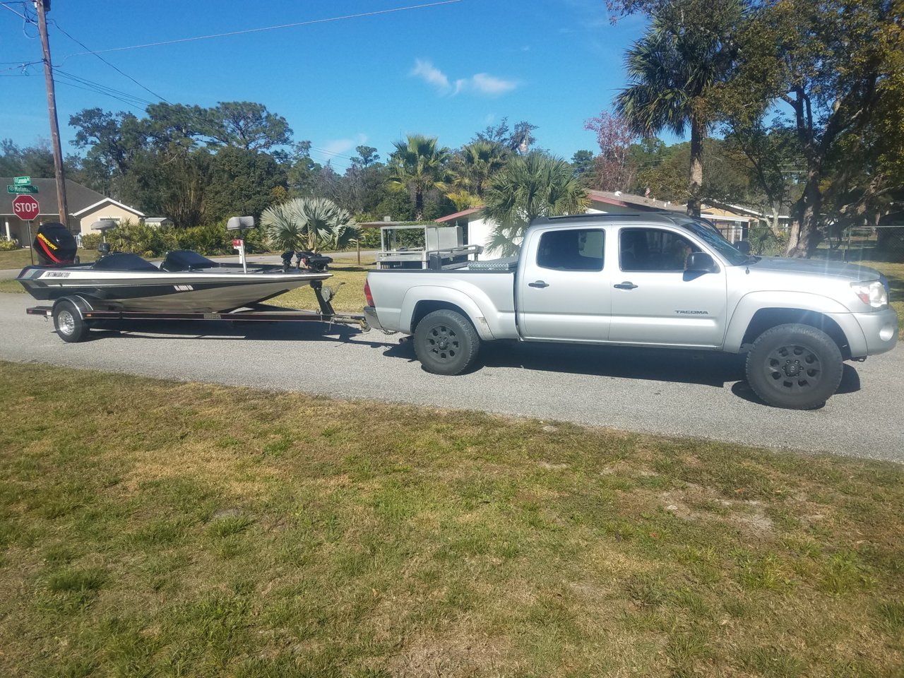

    Worked great on both trailers....If you do make it this way I owe you one for sure. All the lights and brakes worked great, even my bass boat trailer LEDs....now for some stiffer rear springs :spending:It never ends :frusty:

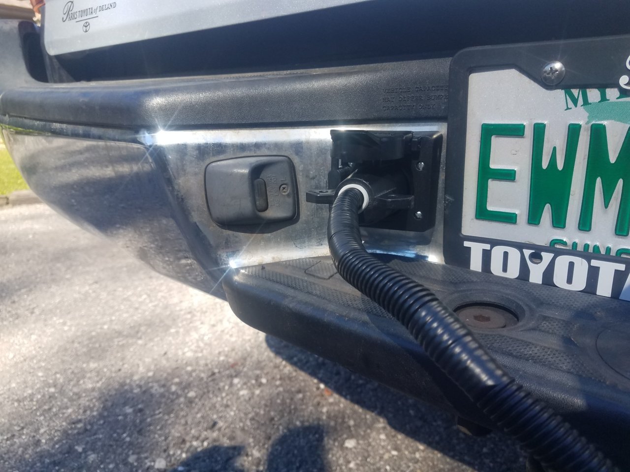

    And I forgot to add I put it where Toyota should have in the first place

    Did you have to cut the hole or did it fit right in?

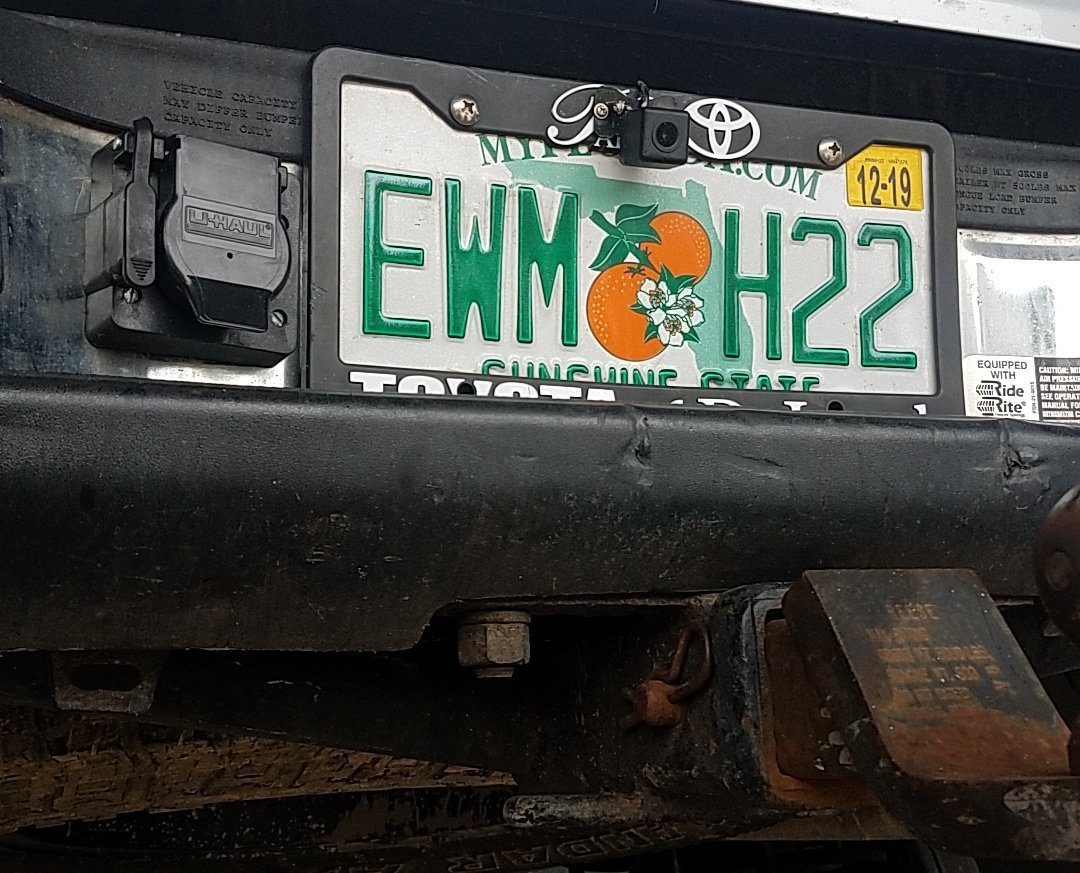

    I cut a hole in the bumper with a hile saw, very easy. I bought the plug just as seen
