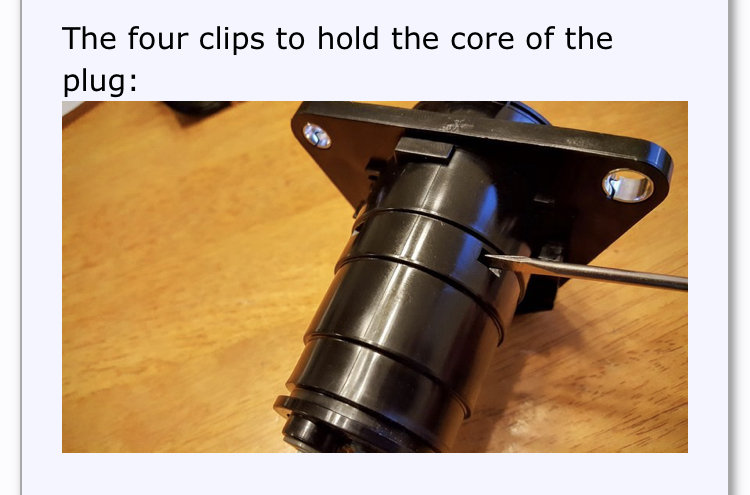

    Whiplash777 can you tell me how you used those four clips to allow access to the core?

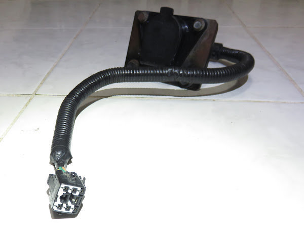

    @kidsmoke @Puppypunter here's the thread I mentioned which shows how the big 7-pin connector comes apart. I was going to try and take mine apart but the tabs wouldn't budge and I didn't want to risk breaking mine.
    Ideally, what we want is a connector that can tap into not this big 7-pin connector but the square connector on the other end which attached up inside the bumper.
    Kolter45 and Puppypunter like this.

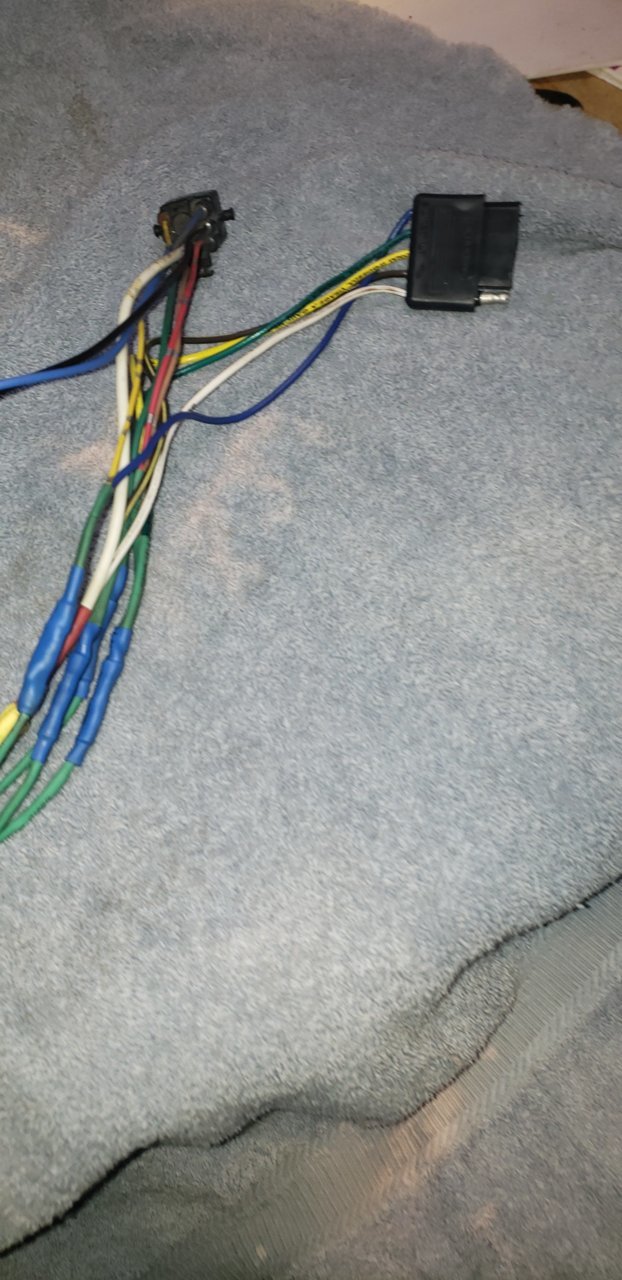

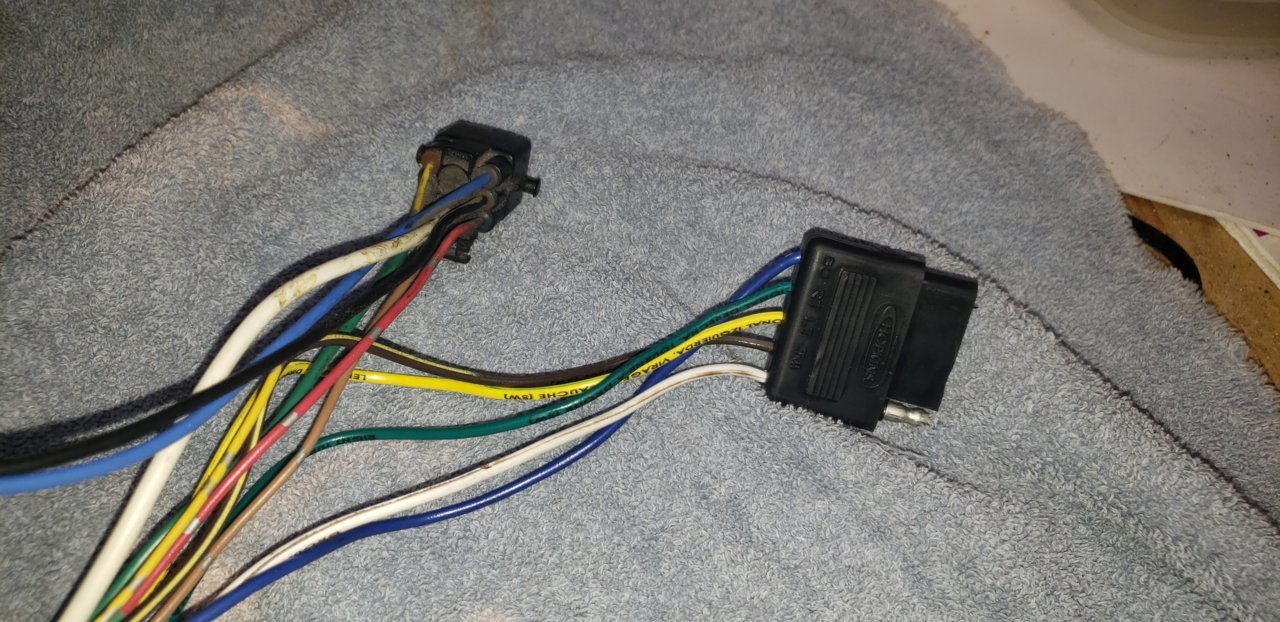

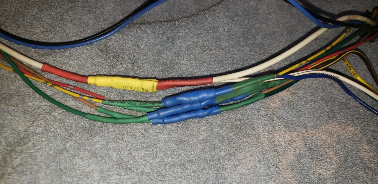

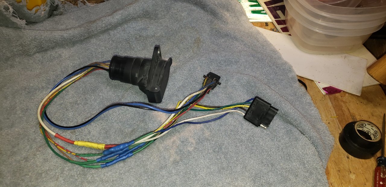

    Here is my solution to add a 5 way plug to the current 7 pin. I spliced the harness wires to the 5 way. Covered with heat shrink and got it back in the loom. The covered it all in electrical tape. The only thing i should have done was stagger the splices more to make it fit in the wire loom better.

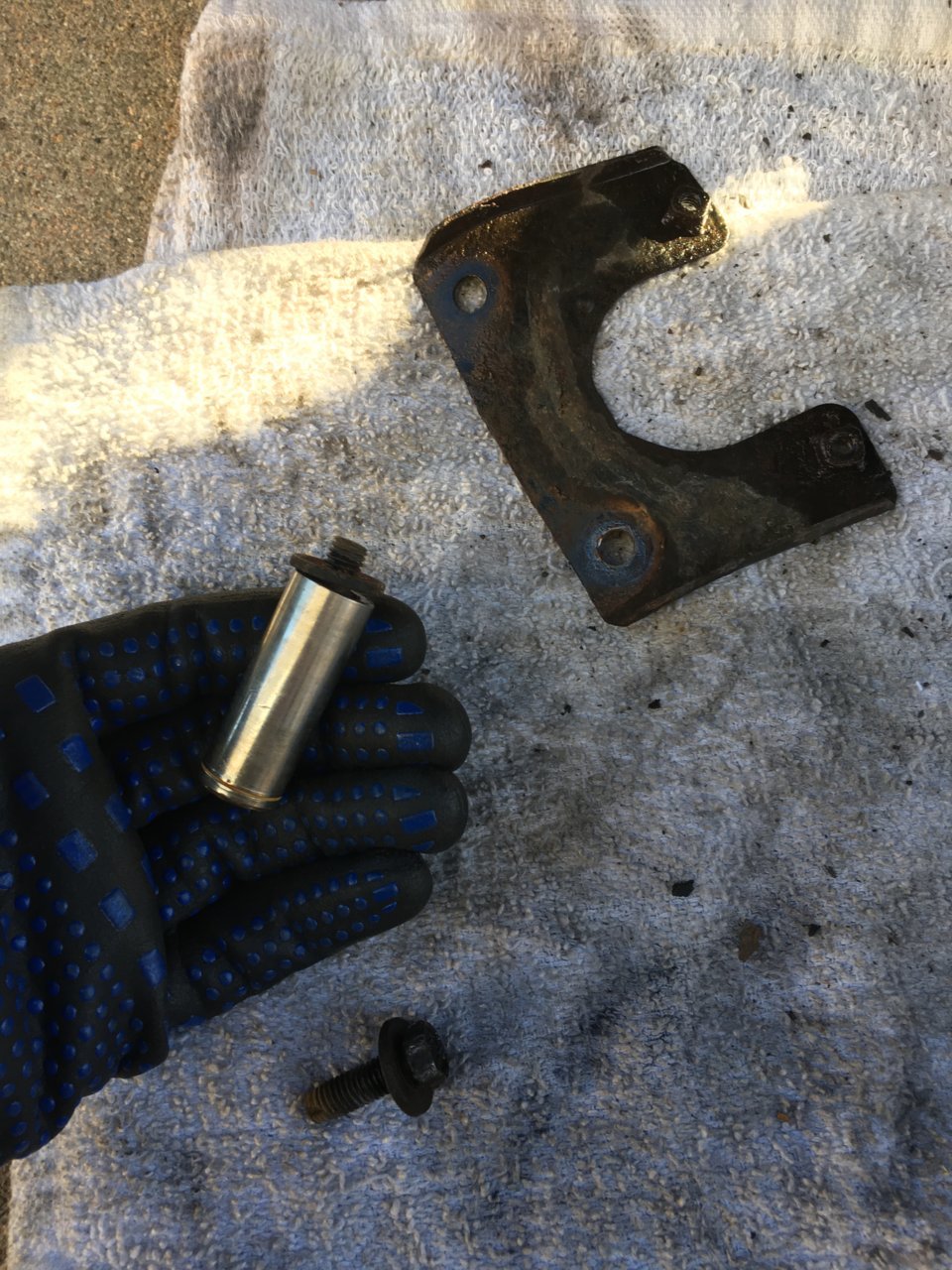

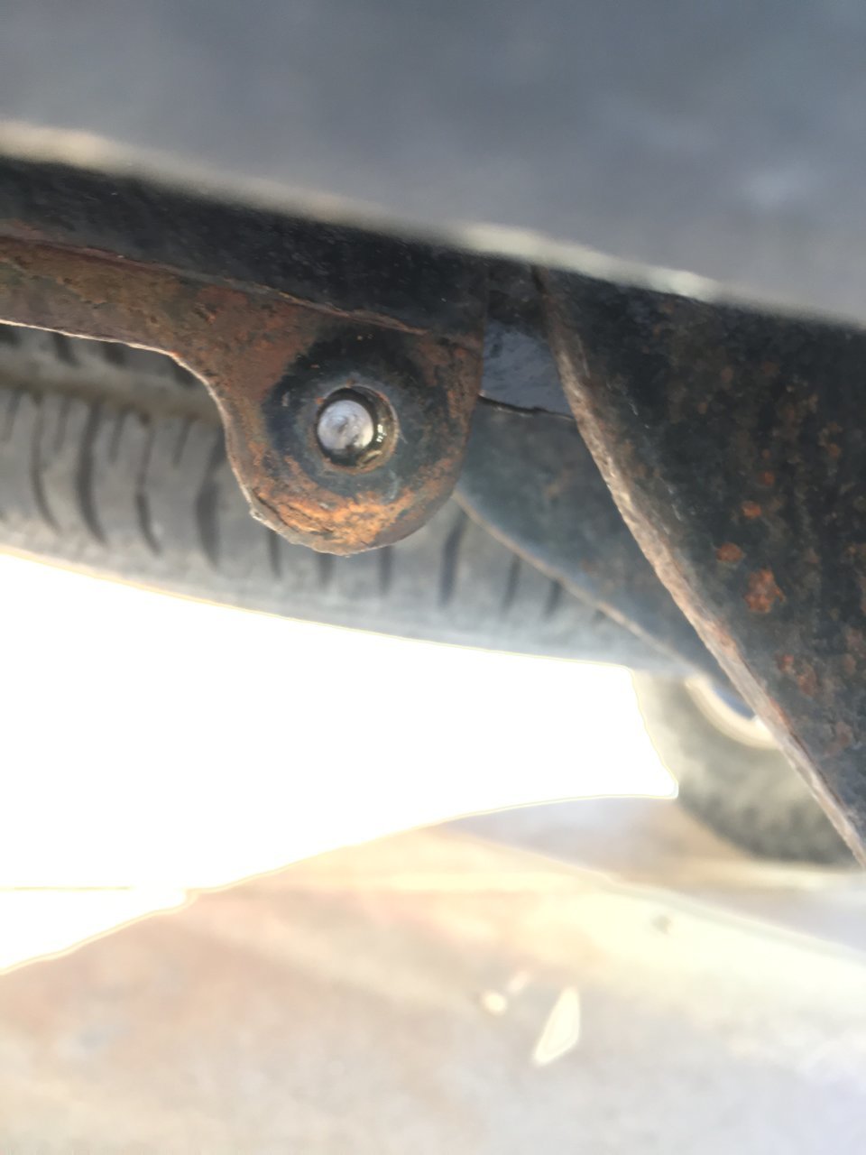

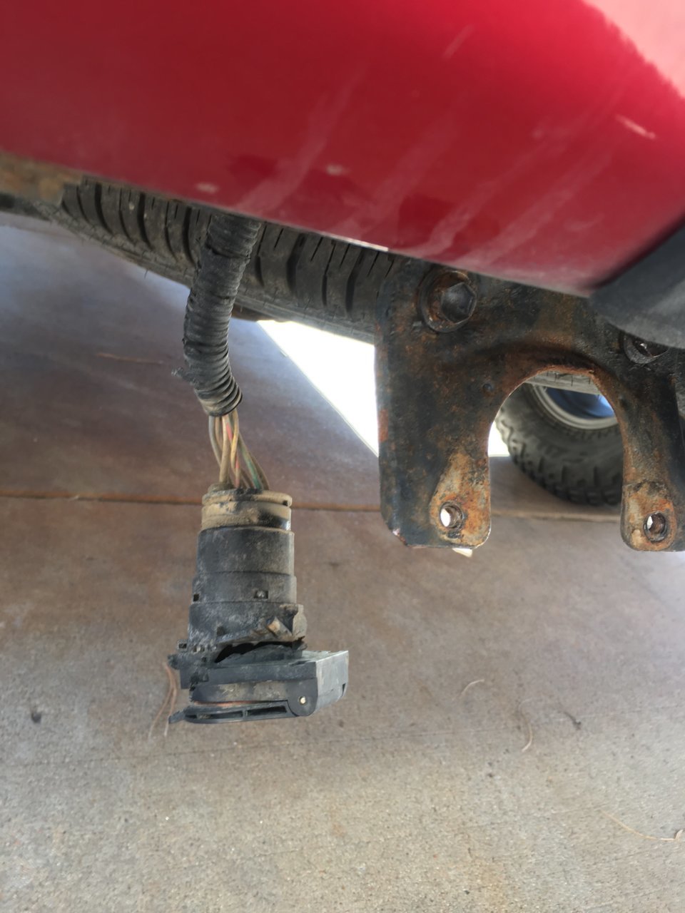

    Here is my story (haha). I was plugging in my 7 pin from my trailer into my truck receptacle and the bracket was so rusted it fell right off the truck. I considered a relocation bracket, but I really needed a 4 pin connector to connect my boat trailer to as well as the factory 7 pin. I had been connecting my trailer wiring to a 7 pin adapter and it would make my life easier to have both. Another reason was that both of the bolt "ears" on my factory 7 pin were broken off. I glued them back on but I really don't trust them. The factory Toyota part IMO is too expensive and the Honda Ridgeline part that is mentioned earlier seems to be suffering from supply chain issues as I didn't seem to find it readily available. I decided to go with https://www.amazon.com/gp/product/B092VHB66X This has the USCAR connector on it, so I disconnected it by unscrewing it at the 7 pin connector and put lug connectors on my harness. I mounted the 7 pin connector on the lower part of my bumper with the supplied bracket and hardware. Only a Taco owner would recognize it as an after-market connector. Looks great and it adds the 4 pin trailer connection for my boat, so I don't need my 4-7 pin adapter anymore.

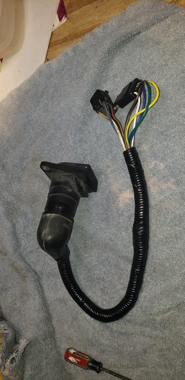

    So, I had a heck of a time getting the "white plastic cap" out of the plug. Solution: Cut off the plug housing up to about the cap, then was able to use a short hook to pop it out (with a bit of prying). (Then proceeded to unclip the wires from inside the housing; noting their placement around the plug connections.)
    Next step, rewiring the Honda Ridgeline component into my Tacoma connecting wires (cable).

    Also, to anyone having trouble getting the white part out, I used a #12 3in wood screw and screwed it a tiny bit into the triangle part of the white bit and yanked it out using that. It doesn’t do any noteworthy damage to the part :)
