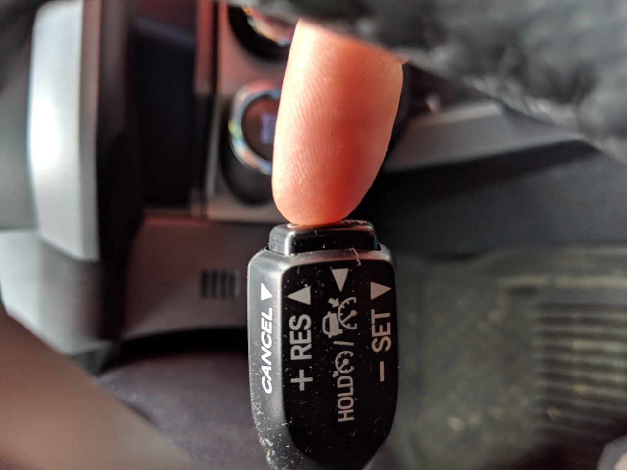

    You still have cruise control, just not the distance monitoring cruise control. Hold your cruise ON button for 3-5 seconds and it will turn on regular cruise control.
  11. Mar 16, 2019 at 9:59 AM
    #251
    RustySidewallz
    RustySidewallz Well-Known Member
    Feb 9, 2019
    #282333
    54
    Dayton, Ohio
    2019 Cement TRD Off Road
    I’ve tried that and still haven’t gotten it to work. The “on” button is the button on the end of the stalk?
  12. Mar 16, 2019 at 10:04 AM
    #252
    EdubTRD
    EdubTRD Well-Known Member
    Jul 31, 2016
    #193361
    117
    Eastern NC
    2005 White SR5 2.7 Access Cab
    This one, on the end of the stalk

    Yeah I figured it out. Thanks!

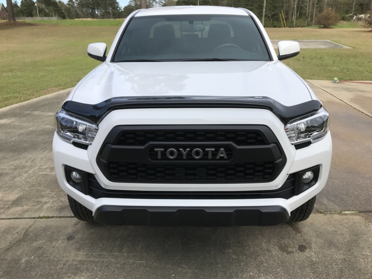

    Installed my after market EBay grill today. I am happy with it.2E224102-A047-45AA-8BC2-40603E85EA4D.jpg

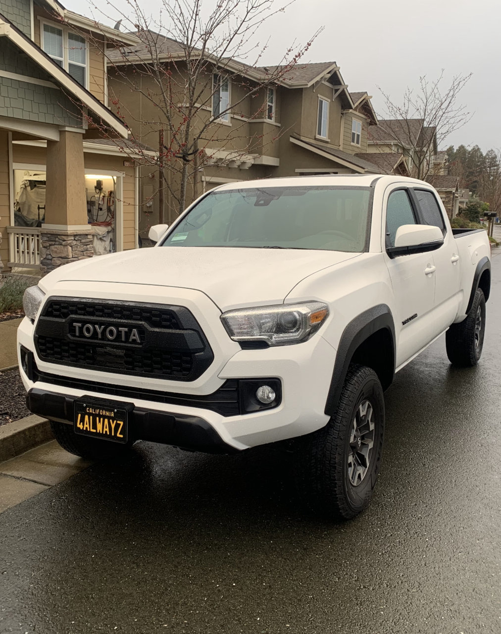

    So I posted this photo in another thread, but as I read through this one I thought it might be a good idea to post. I originally bought an eBay grille and was initially really impressed with what arrived. I also ordered the OEM garnish to go with it and installed within weeks of purchasing my 2018. I immediately ran into the same problem many have faced and that is the garnish didn't fit in the opening. I ended up breaking a tab or two trying to fit it in there. I finally got it held snug in place with the snap springs, but it wasn't flush and I believe was causing me to receive random "Brake!" warnings. To be clear, I never had warnings that the TSS wasn't working or needed to be cleaned. I have since purchased an OEM grille, garnish and extended wire harness, because I was tired of the false alarms. The fit of the OEM grille was much nicer/tighter and the finish was noticeably better as well. Not a huge difference, let's face it, they're both made of plastic. Since installing the OEM grille/parts I have not had one false alarm. I'm not trashing the aftermarket pro grilles by any means. These are just my experiences after running the two for about four months each. I know several people that love their eBay grilles and I'm stoked for them. Hope this helps some. OEM grille is on the truck in photo.13C04A9A-7112-45FA-9B1F-FB613D3146A1.jpg
