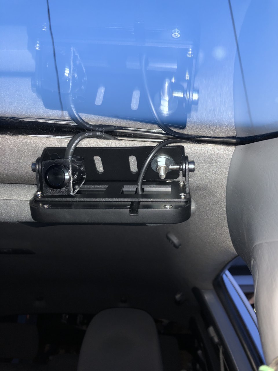

    I ended up getting one on Amazon!
    I decided to fab up a panel to place everything on since having a manual, there is nowhere to use the included mount.
    Take a look at my build page in my signature for more details.

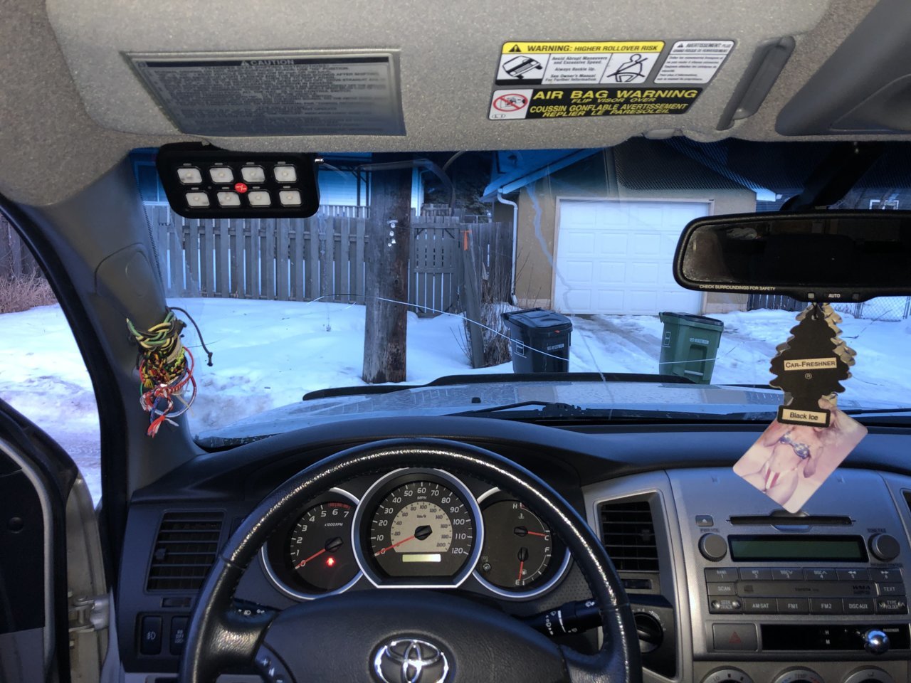

    Here is everything installed inside the truck.

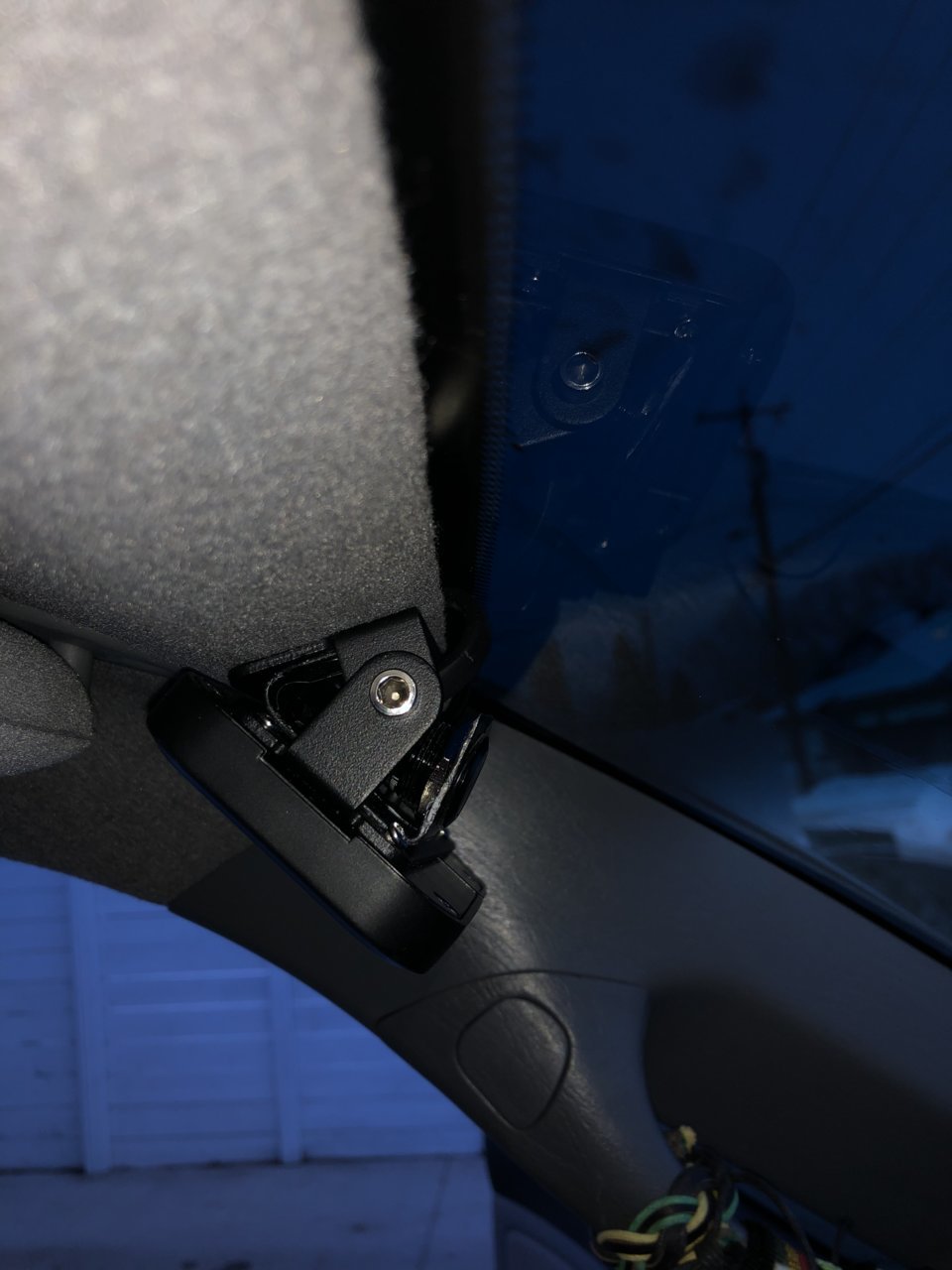

    I bolted the Switch Board to the headliner. I ran the 2 wires through the pillar down into the engine bay. 1 wire is for running the Switch Board, the other wire is for dimming the Switch Board. The dimmer is a momentary push button. The mount that the 8 gang Switch Board attaches to was included in the package. But I did make the mount for the push button.
    Here is the Switch Board when the ignition is on. Keep in mind I don't have any of the sticker/labels on, so the lights won't be as bright. There are 5 brightness levels.
    Full brightness:
    Lowest brightness:
    I needed to buy/add some items that weren't included in the AUX controller package. I can't complain with the price of the controller.

    Overall I am very satisfied with the product. The instructions that came with the package is useless, therefore you need to have some slight knowledge in automotive wiring. I am a rookie at this and I did just fine. The price is much cheaper than something like Switch-Pros or sPOD. Yes this system is not as fancy but it works for me.
    I can't wait to wire up some lights and accessories to this system!
