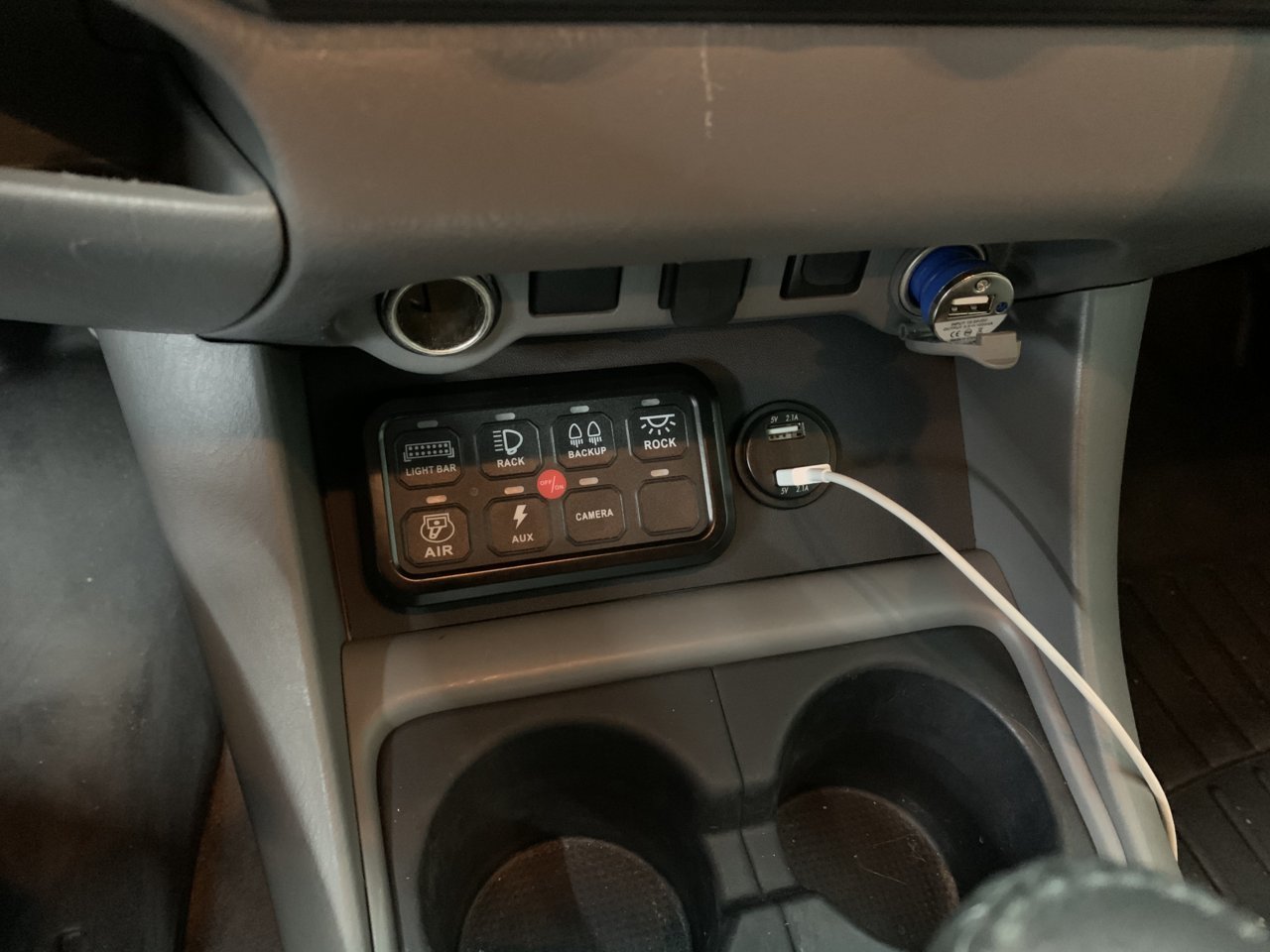

    Yes my truck is dirty. Used the brackets it came with to sandwich it between the cubby hole. Didn’t want to screw it in, but now I want it flush mounted. Works fine but sticks out a bit further than I’d like. Trying not to spend too much more money. Already spent $800 on a 30” Baja 31DF5307-5DB2-4F97-8EE6-EEA5213B16F8.jpg

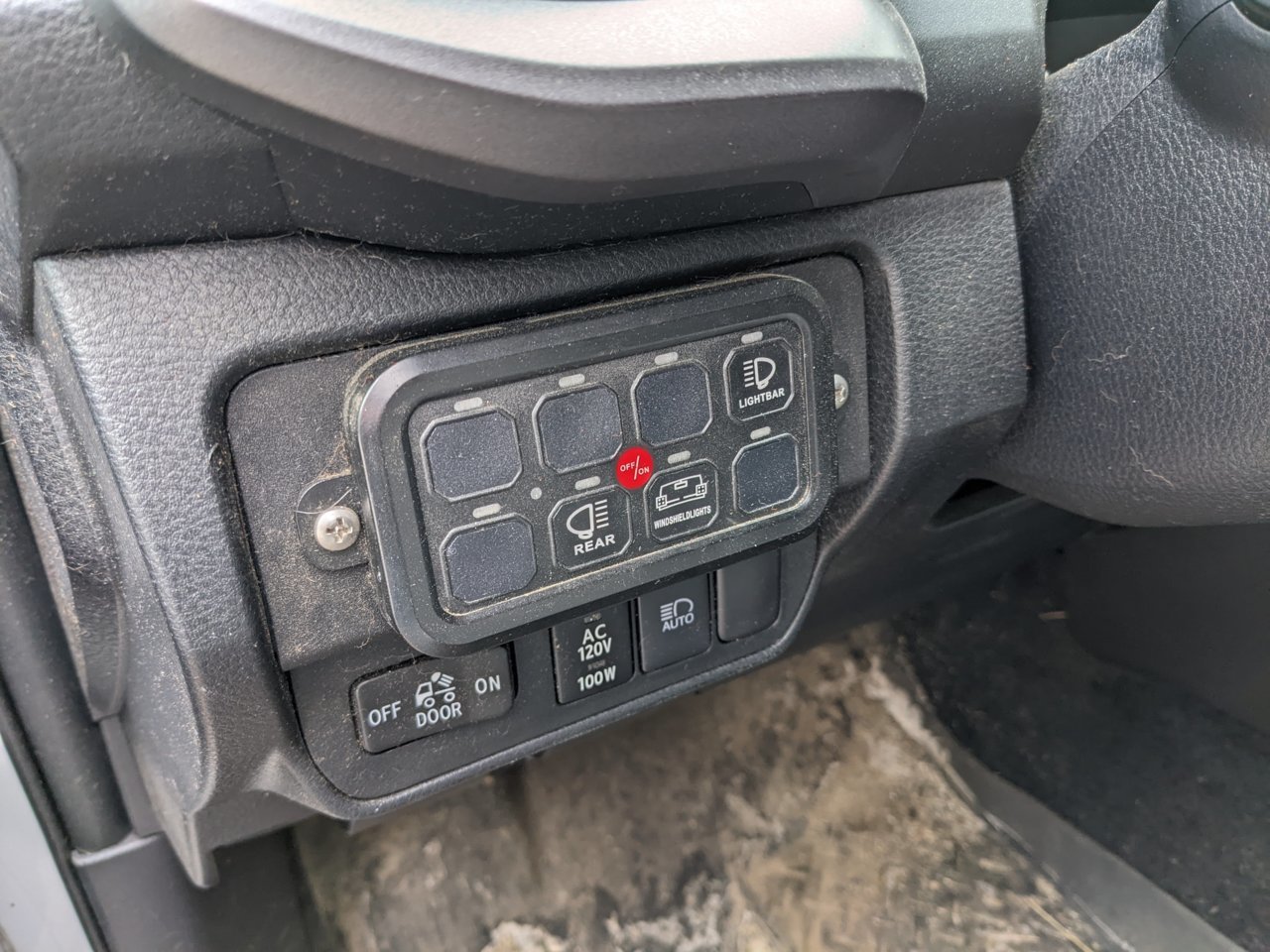

    Its been a while since I installed mine. I think it came with a flush mount bracket. This is what mine looks like:
