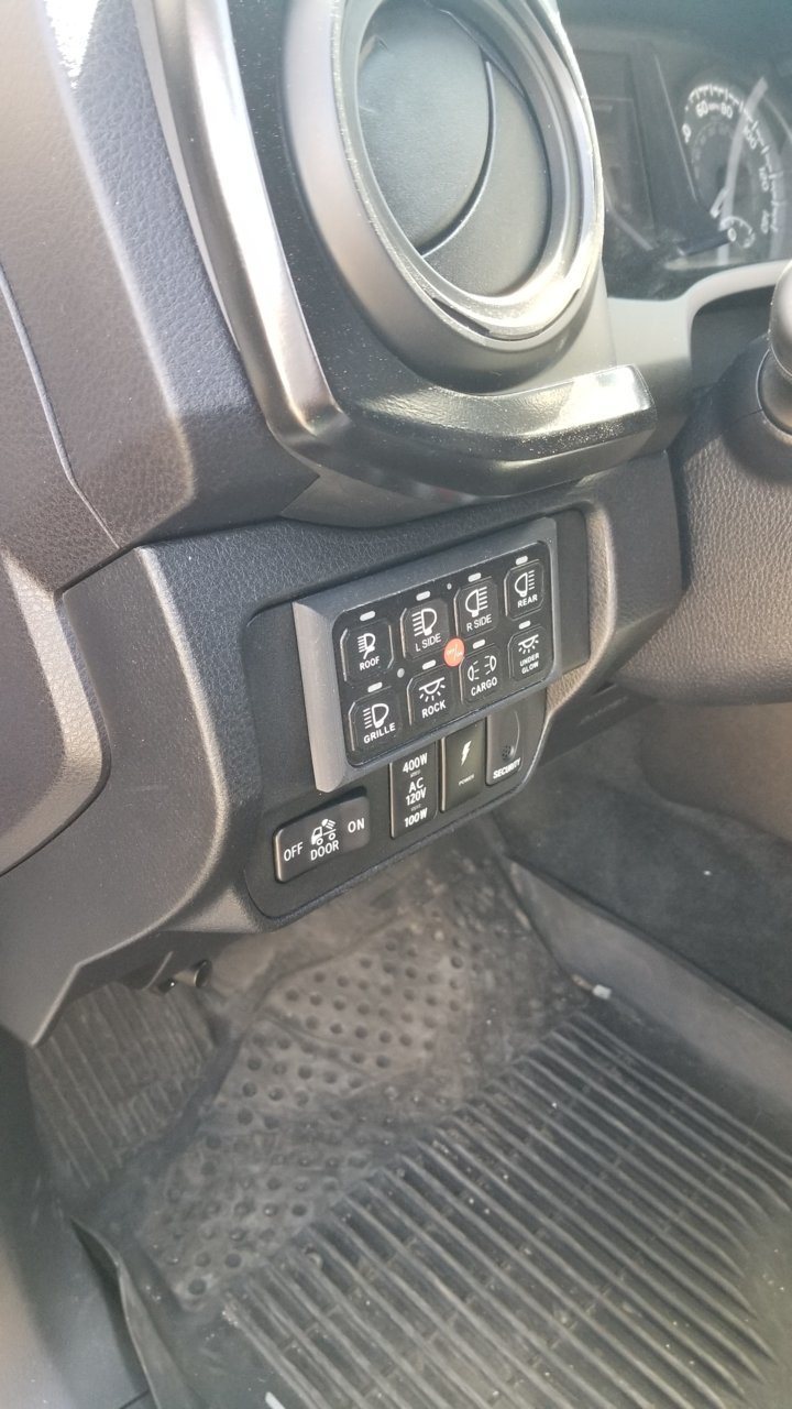

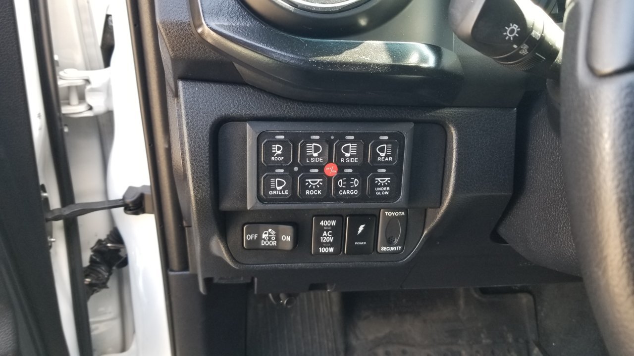

    I switch out the original auxbeam housing/bezel for one that @mkamp98 makes. Makes it look so much better and doesnt stick out so damn far. Good option for those that dont like how bulky the original switch panel is.

    how are you holding it in place?

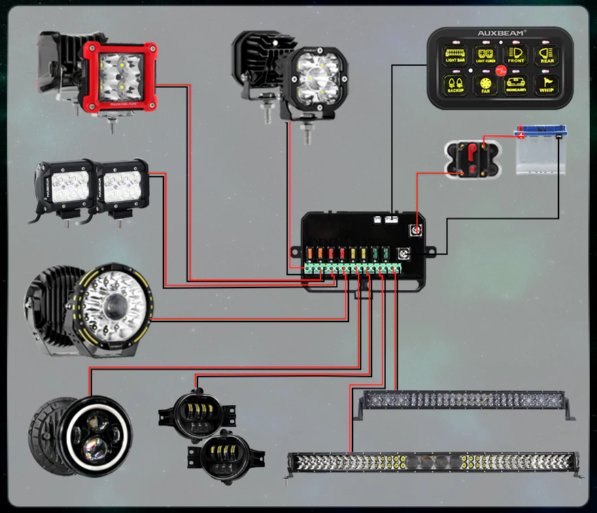

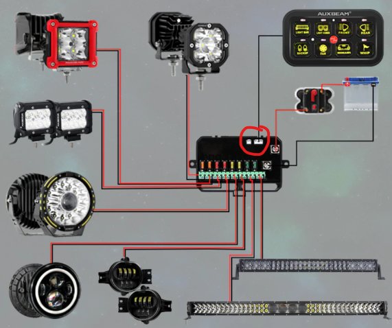

    But their wiring diagram seems off. They don't show the wire to power the switch board. And their "wiring diagram" shows the old module. See the red circles.
    So I am not exactly sure how you can wire it up. Sorry.

    Double sided tape.

    Are you putting the tape on top of switch blanks? I did this and it doesn't stay on very long for me.
  10. Apr 23, 2022 at 10:38 AM
    #250
    iLLFadedBowl
    iLLFadedBowl Well-Known Member
    Jun 5, 2021
    #367742
    210
    2019 Super White TRD Offroad Tacoma
    Remote start w/ vehicle control and locator, Prinsu rack w/ Cali Raised Light Bar and 360 LED lights, LED Bedlights, Tailgate lock, 3" Lift, Wheels and Tires, Raptor Lights, LED headlights and fog lights, Blacked out LED taillights, Front windshield eyebrow tint, Rough country bed molle, 8-gang switch to control LEDS, Dominator D6 running boards/side steps, Blacked out sequential mirror turn signals
    I dont have any blanks where the switch panel is stuck to the dash. Underneath the panel is the cubby slot. Trying getting better double sided tape. Gorilla glue makes a really good double sided tape. There is also a 3m that is clear that sticks a lot better than the foam double sided tape.

    Can you post a side view of the switch panel? I'd like to see how that's mounted. Thanks
