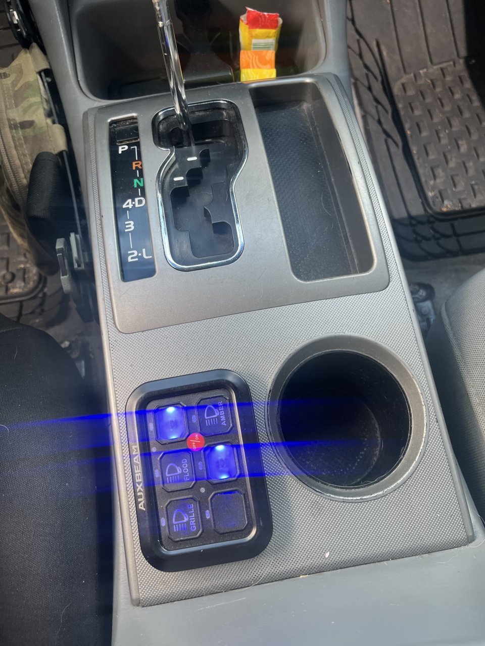

    Not sure why my camera was picking up the blue lights like that lol….just waiting on my sister in law to make new stickers with the cricut.

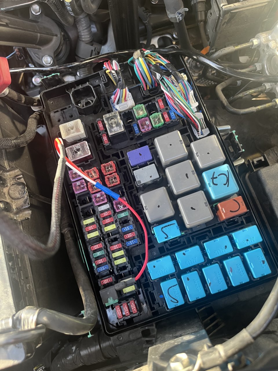

    57AC5B88-0429-4C6D-B261-7654438C7820.jpg 4A1810A3-0DA2-4A92-9D15-7ECD79631620.jpg
    sorry guys still new to this and thank you for the welcome!

    I've had this switch panel on my truck for roughly a year. I bought the cubby insert(link below) for the switch panel to mount left of steering wheel. I wired the add a fuse to the headlights so I can still use the switch panel with the vehicle turned off. I do a lot of camping and night time activities and I use my lights often. If you wire it to turn on with the truck you'll have to have the truck on to use the switch panel, which in my opinion defeats the purpose of this switch panel.... but each their own.

    If you have the same switch as me, the red wire is to power the panel with the switches. The white wire is to change the dimness of the panel lights. So you touch the white wire to a positive power source to change the brightness. I don't think it should be connected to power the whole time. I wired my white wire to a temporary switch (like you would use for a horn). This way when I hit the switch/button, the panel lights dim or go brighter.
    You need that red wire to be connected to a positive power source. I wired mine to the ACC fuse (with an add-a-fuse) inside the truck. You can add it wherever you want.

    Howdy y’all, super new to this, just picked up one of these and am having an issue. Seems like everything is wired up right, I have the add a fuse in the engine bay, I believe tapped in to the IG1 no. 2 space, so that the switch panel isn’t constantly on. Everything works, but now the 15 am fuse for my fogs keeps blowing and I can’t use my fogs. Any help with this issue? I have. 2015, so far just some ditch lights wired up in spot 2, on the panel.

    Before you put in a new fuse for the fog lights, clean the insert before inserting fuse. Also make sure it's supposed to be a 15 am fuse. I had something similar because I tried a few fuses and accidentally put a 5amp for the head unit and it kept tripping, turns out it needed a bigger fuse than the 5amp I wrongfully put in... lol. rookie mistake on my behalf

    It’s definitely a 15a fuse in that spot. It’s just so strange, it blows every time and now one of my
    Drl lights is out. Going to try and run the tiny red cord into the cab and try the acc fuse location.
