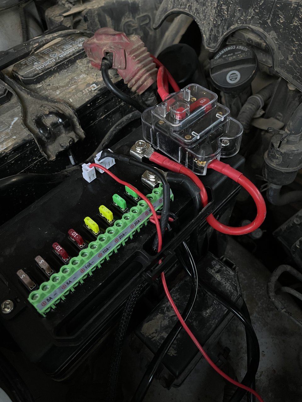

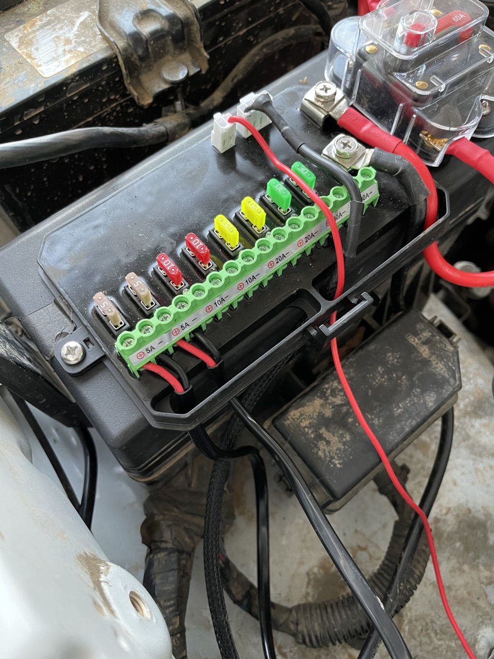

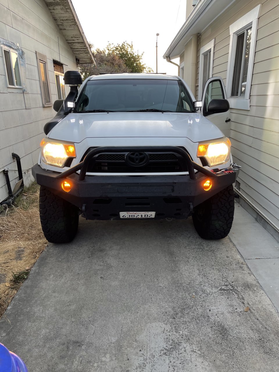

    9DAD605B-3E4E-4EEA-B0A4-74091F6B3AF4.jpg B432F046-2A13-4F0B-9A9C-1BE3537DFE8C.jpg 8C48D16A-7DAF-4BA9-96EA-739F078393A8.jpg A0AAA7DE-FC80-4A09-9B4E-06C4A28AD826.jpg Prior it trying to re insert a 15a fuse in the fog location 3

    So I removed the leafs from the auxbeam. Placed a new 15a fuse in the fog light position, and everything is working fine, now that the auxbeam isn’t connected. Gotta figure out why it’s continuing to pop that fuse when it’s plugged in :/

    What fuse size are you using for the Auxbeam?
    Do you have the 2 fuses in the wrong position?

    That’s what I’m thinking. I may have the add a fuse in the wrong position. I believe it came with a 5A fuse in the top position, and I placed the 7.5 fuse from the acc in my cab in the bottom section. Gunna run out and grab a multimeter

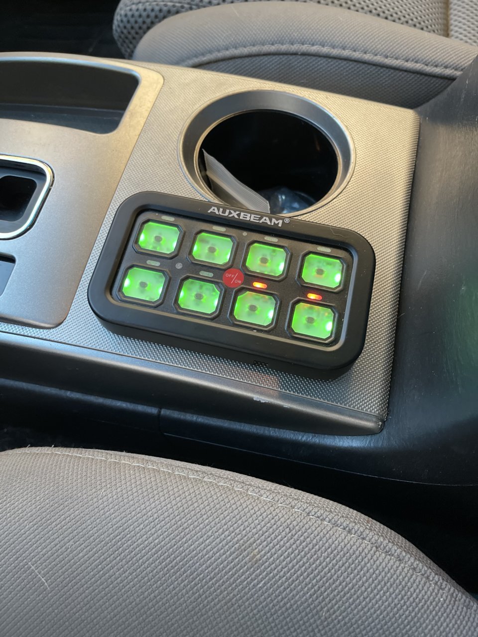

    so I got it working, moved the ditch lights to the 5A spots. No blown fuses, all lights working.
    DB39DBDB-FF37-42CE-BAA0-2C43D525FFFF.jpg 6F6DE4CB-4DB1-47CF-A99A-A7C3E828394A.jpg C0CE93C5-1379-47D2-B4F1-972FFA0EDDD8.jpg

    I really don't know why they pre-assigned the amps for each terminal. You can put whatever size fuse you want to match your load (30A or less).
    I have 1.5A, 3A, etc in there and some 20A in the 5A location. It's just a general fuse panel.
