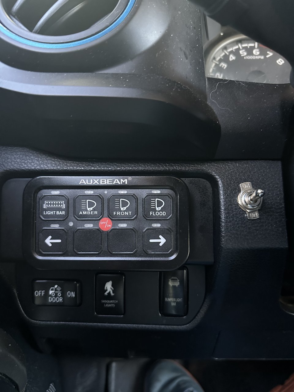

    Tacoma SR5
    I added this ON-OFF-ON toggle switch to power up the panel, I can have on ONLY with the key open/running and I can have it on even if the truck is off. This comes in handy when I go camping, I can lock the truck and control the lights from the tent with the Bluetooth function.
    I would have hidden the switch better if I hadn’t taken the bad decision to drill a hole before I bought the panel :(

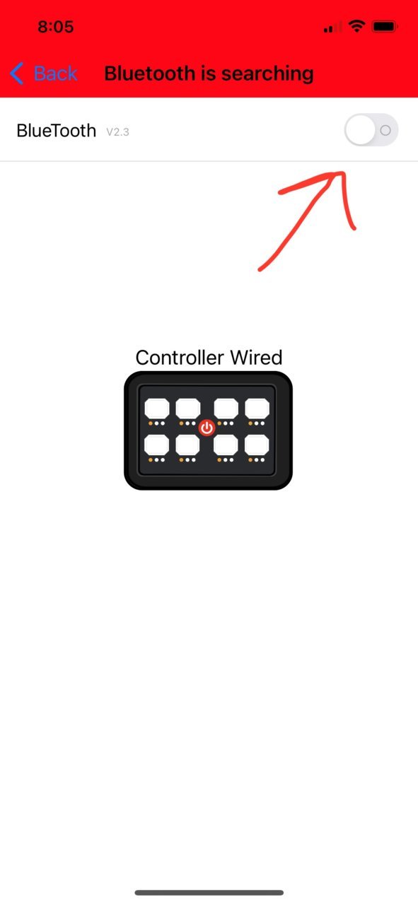

    Does anyone with the Bluetooth function have the problem that the Switch Panel app does not connect to the panel right away or automatically?
    I always need to go into the BT settings, toggle on the BT, and then click on the device to connect.

    Yeah I started having the same issue.

    Shitty. It seems like an app error. Hopefully they fix the bug. We should let them know so they can fix the issue.
