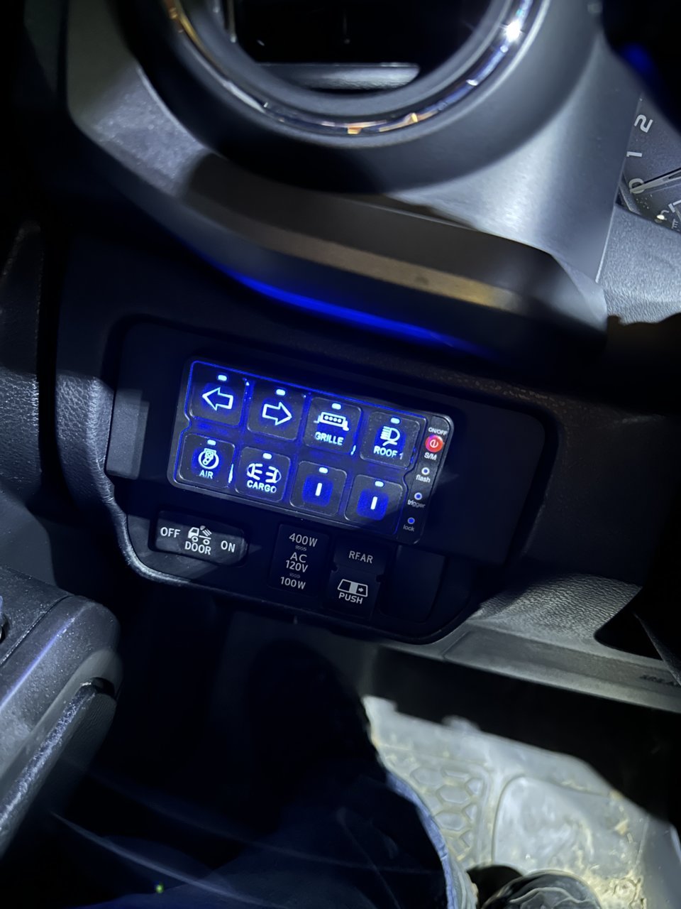

    Thanks for the info! I am happy that I have a replaceable relay type model then!
    I did get mine installed last weekend and am pretty happy with it. Again, I know this is an Auxbeam thread but just incase anybody wants an 8 gang panel with replaceable relays, I'll post my pictures and a link to it. I've only had it installed for a week so I can't comment on longevity but so far, its nice.

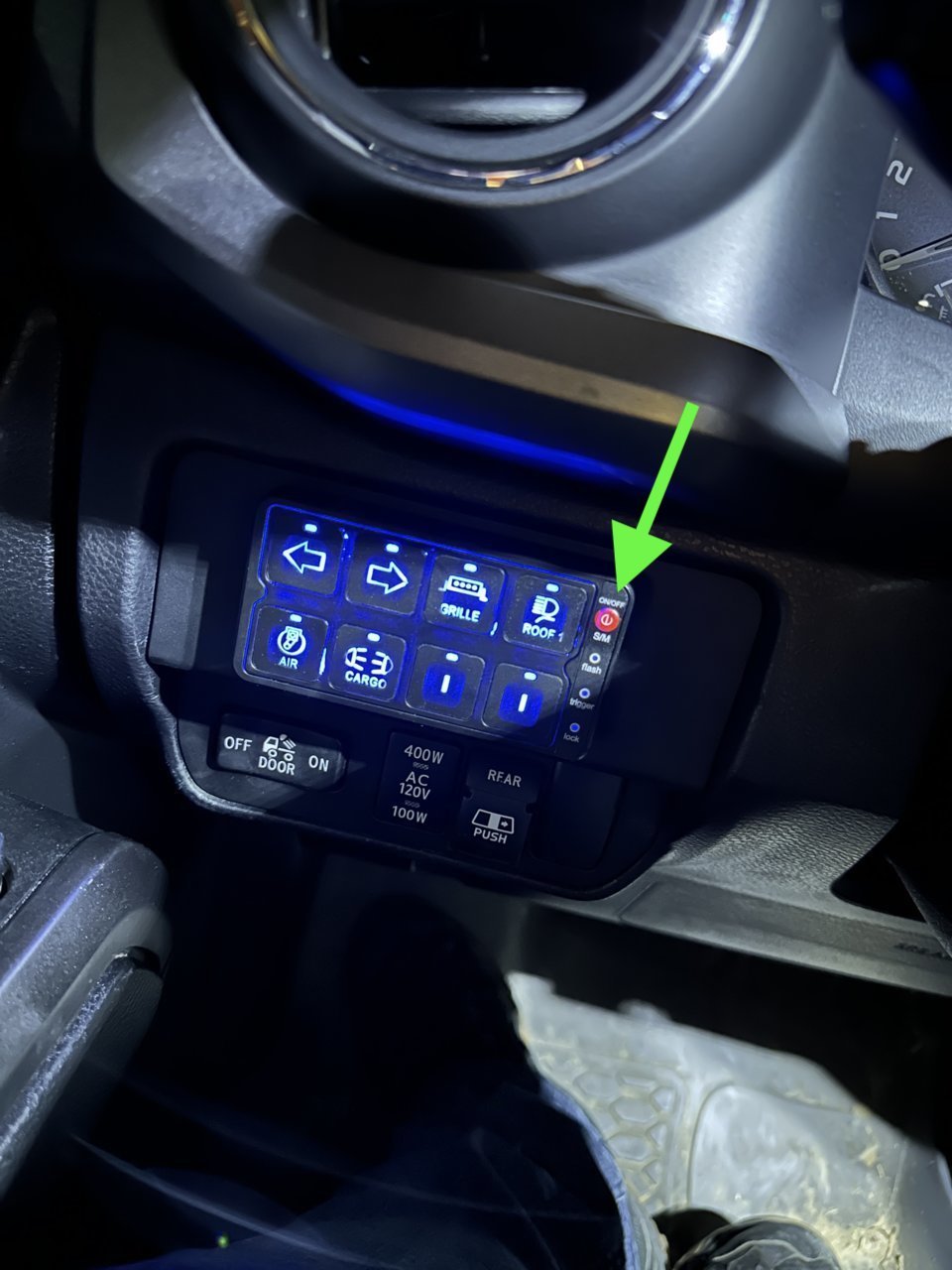

    Do it! There is one thing that I don't like about it. The backlight will turn off after 2 minutes if you don't have any switches active. Then the whole unit will turn off shortly after if nothing has been active. So at night, it can be annoying. I contacted the company to see if you can change that but you can't. It's for "battery conservation".

    When you say the whole unit turns off, can you elaborate? It sounds like the switch panel turns off. How do you turn it back on in order to turn one of the switches on? Sounds like it would make everything a two step process.

    Yes, the switch panel lights turn off after 2 minutes of zero activity, and then x minutes after the backlight turns off and there is still zero activity, the panel will turn off as well to "conserve battery". You just press the power button at the very top right of the unit to turn it back on.
    Let me clarify, if a switch is in use it's not gonna turn off.

    It's actually a good option! That way you can have it wired directly to the battery so you don't need to have the ignition turned on (if you have it wired that way).
    I wish Auxbeam had that option.
    Do you need to power the panel on to hit a switch? Or when you hit a switch, does it turn the panel and device on?

    I do indeed have mine wired so it can be used with the truck off. Nice to use lights without it running if needed.
    you do have to power the unit on before any of the switches will turn on.

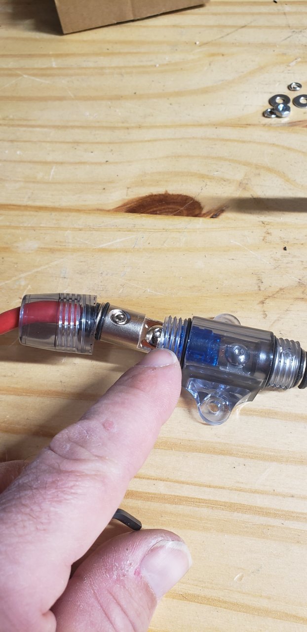

    This may help some of you out. I been reading on web where people have problems with their Auxbeam out of the box. If you have this type inline fuze. Check this screw. Mine was loose.

    +1...I had issues with the backlight flickering and the unit turning off and resolved it by tightening the fise screws.

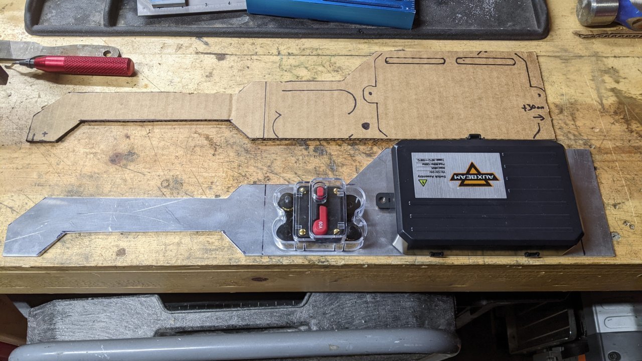

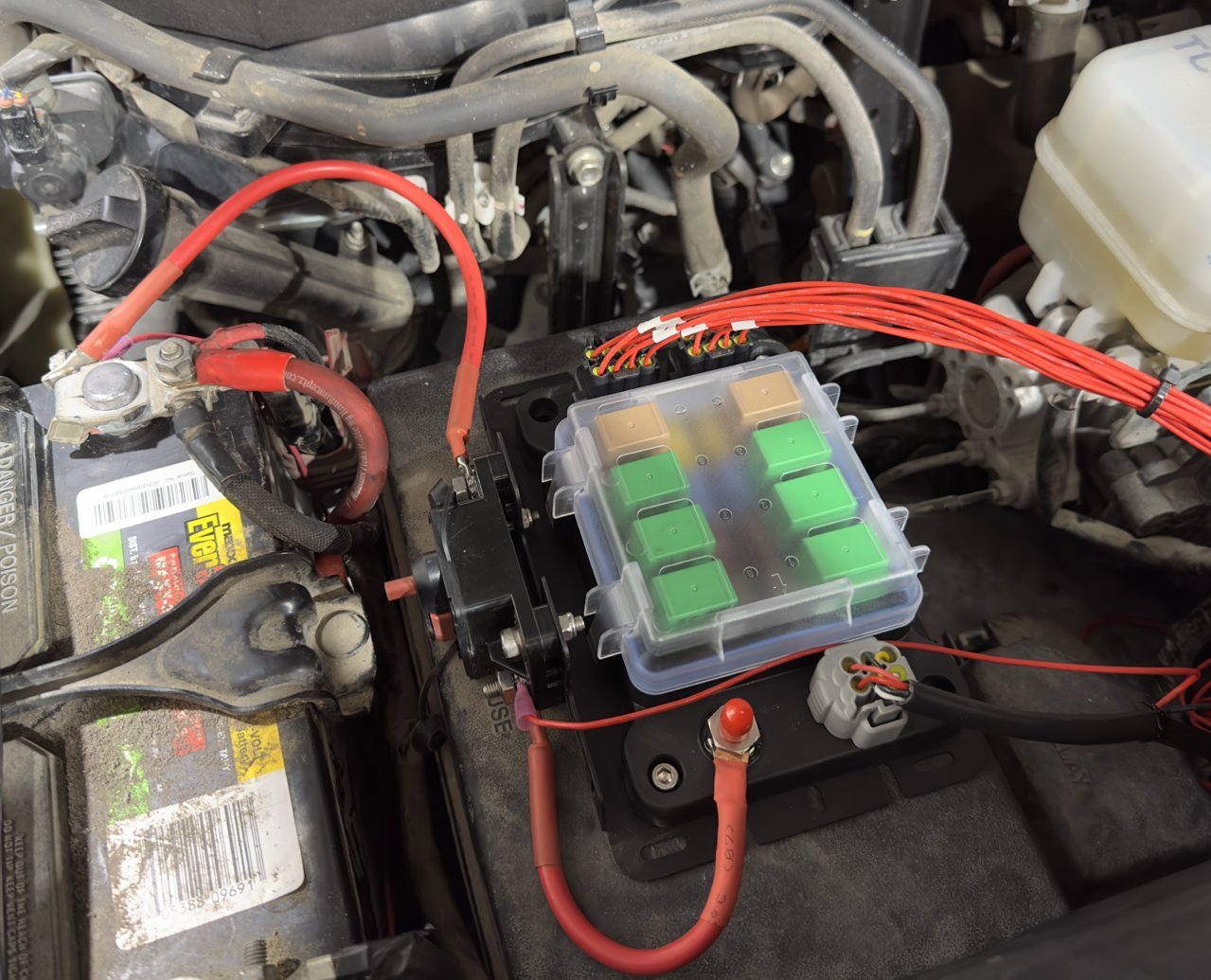

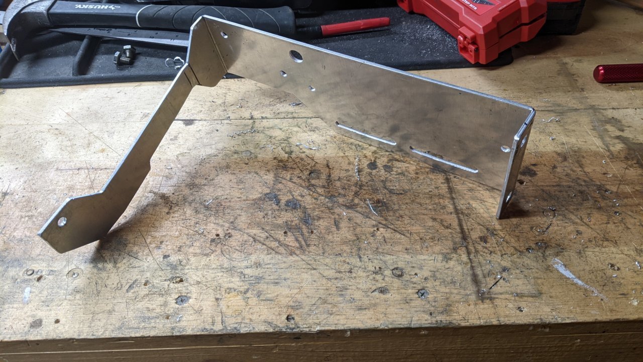

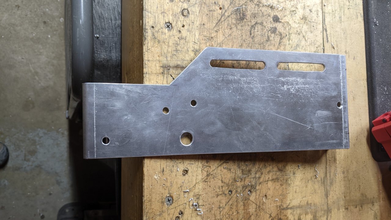

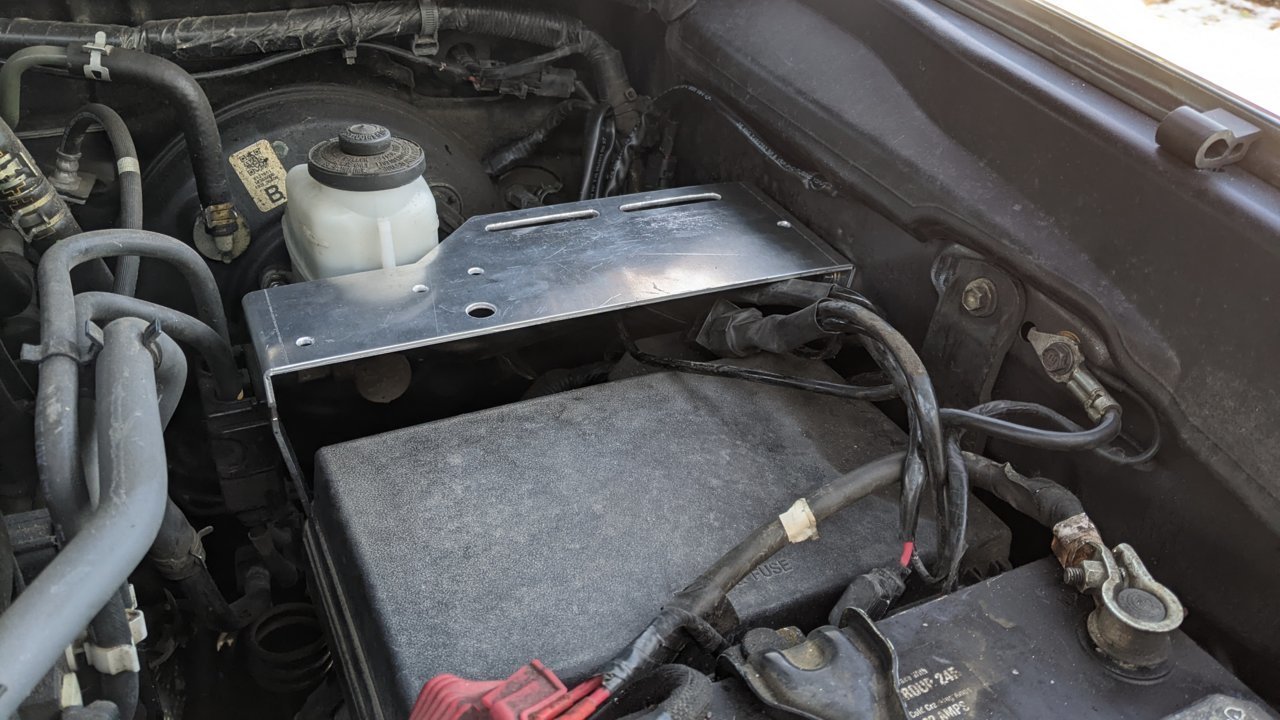

    Finished fabricating my Auxbeam engine bay mount.
    1/8" 3003 aluminum bent using a vise brake.
    I wanted enough space to remove the fuse box covers without having to remove the bracket so I put the bolts on the bottom of the bracket which turned out to be a major pain to install because I didn't leave enough space to get a socket around the bolts. If I ever have to remove it I will swap the bolts out for hex head bolts instead.

    Nice work!
