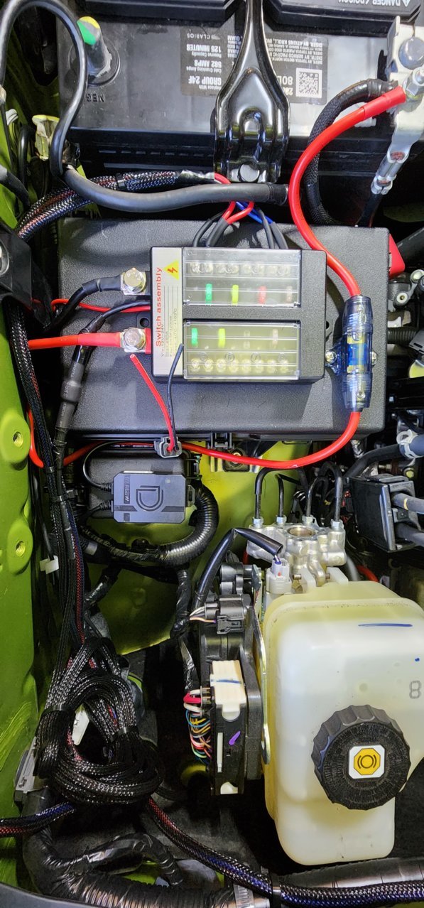

    Got my 8 gang installed this weekend, pretty easy install and everything works so far! Only problem I had was finding a mounting location, I have a manual so where I've seen other people mount theirs is where the reservoir for the clutch is. I ended up having to drill 2 holes in the lid of my fuse box which I wasn't too happy about but I sealed everything with some silicone so I don't think water intrusion is going to be a problem.

    I just purchased the Auxbeam 8 switch panel along with the R4T Runnjng For Tacos switch plate. Some cutting was needed, but I have my lights hooked up, placement on the fuse box nicely set, and it's been working very well for me so far.

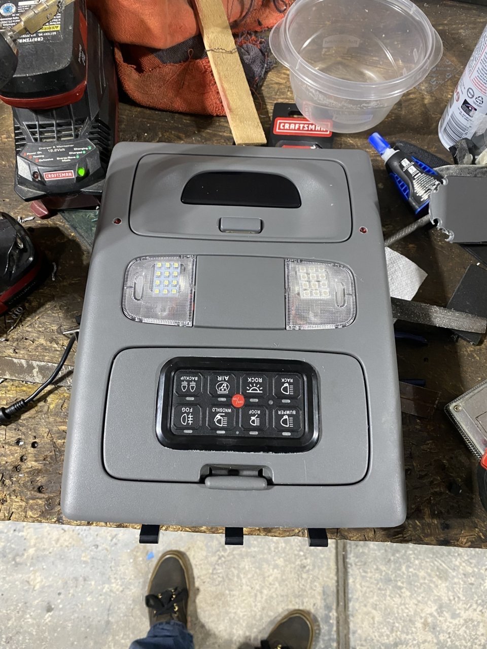

    I've the nilight 6 position in my 2nd gen similarly. pulled the switches up top put them lower and that panel fit just right over the plug holes.
