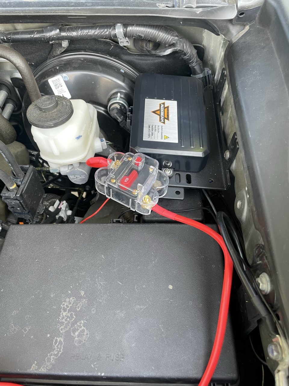

    Seems solid.

    What tray did you use? I have the same Auxbeam, and searching for a bolt on tray to accommodate the unit and breaker. Thanks for any input on installation. Looks great

    looks like the tray that is included in the 8 gang box. the 6 gang variant comes with a very different box, and I made my own bracket from a piece of like 2-inch aluminum plate I had laying around.

    Yeah its the original bracket it came with. I pulled the harness in the back off the tab to make a tad bit more space to mount the bracket. Then it came with a long metal bracket i just bolted it underneath the original bracket and mounted the breaker on the edge of it. It's real solid it doesn't move at all.

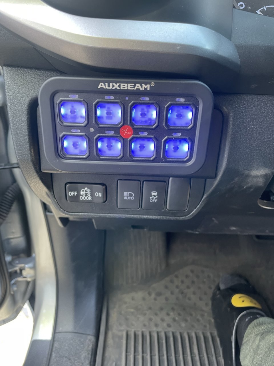

    In the process of doing mine and de-fawking my messy wiring. Put it right here so I dont have to reach to turn anything on, and its available with my free hand/shift hand.
    Will be handy here for f/r lockers, lights, etc without needing to take focus off of wheeling.
    Will get some nicer screws so it doesnt look as shitty
