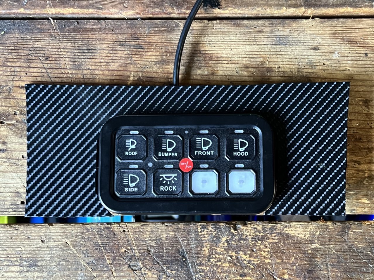

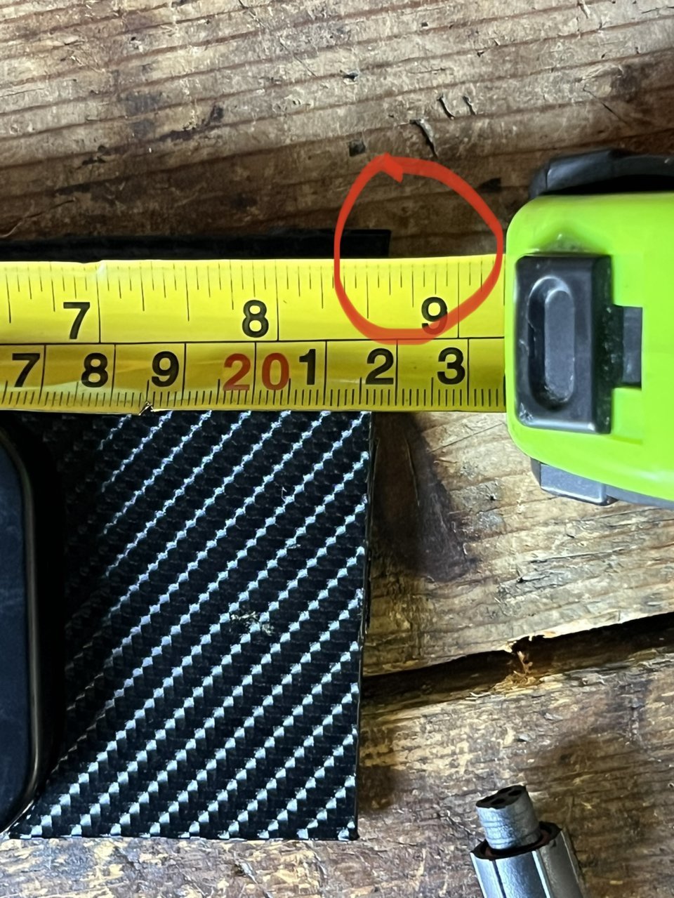

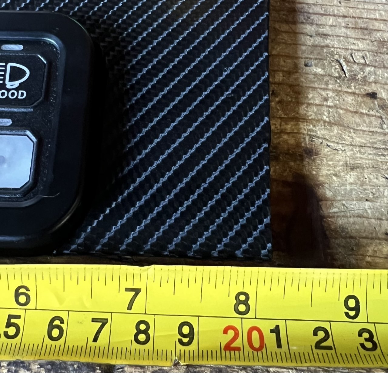

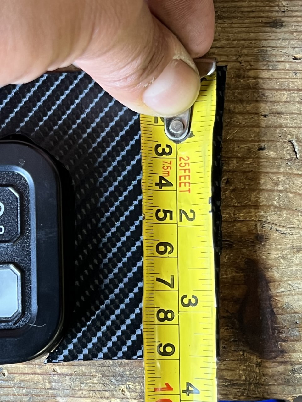

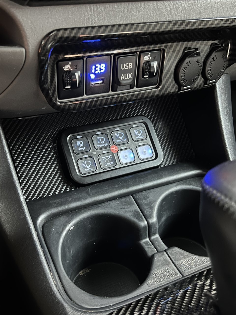

    It could be better with the right tools/resources, I used what I had around the house lol.
    Used a sheet of plexiglass and wrapped it with carbon fibre vinyl.
    Top Length
    Height
    Bottom length
    End result.

    Pretty easy to do with a relay.
    Looks really good.

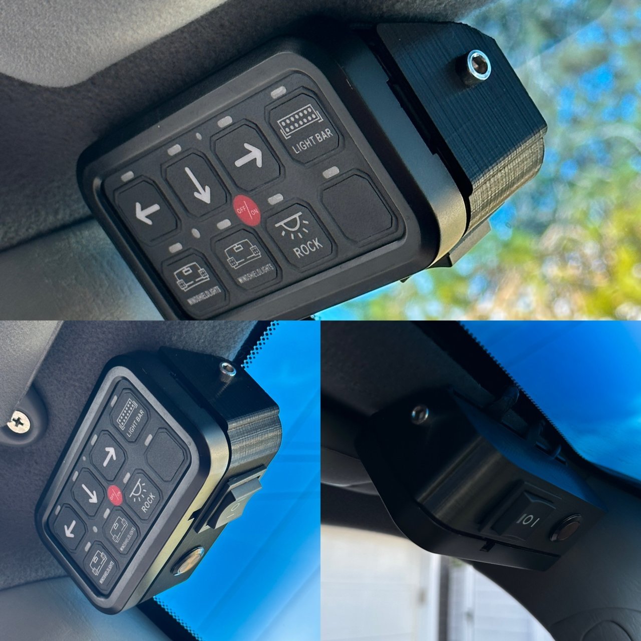

    Hi all!
    I finally wired up my switch panel to be able to pull power from 2 different sources.
    I bought a DPDT switch. This is the one I used.
    Here is how I wired it (see diagram). Very simple! No need to wire any negative wires.
    Power source #1 is a fuse tap to "IGN Np.2". Power source #2 is a fuse tap to "PWR OUTLET". The other wire is the panel power load that runs through the fire wall to the switch board.
    I 3D printed a mount for my switches.
    The round momentary switch was used for my old panel. It was used to dim the panel. The new Auxbeam panel dims automatically but the switch still works.
