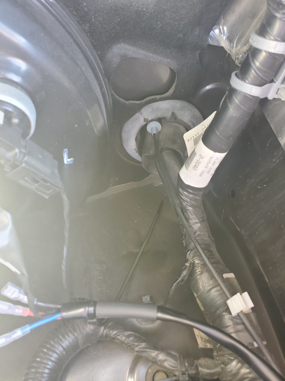

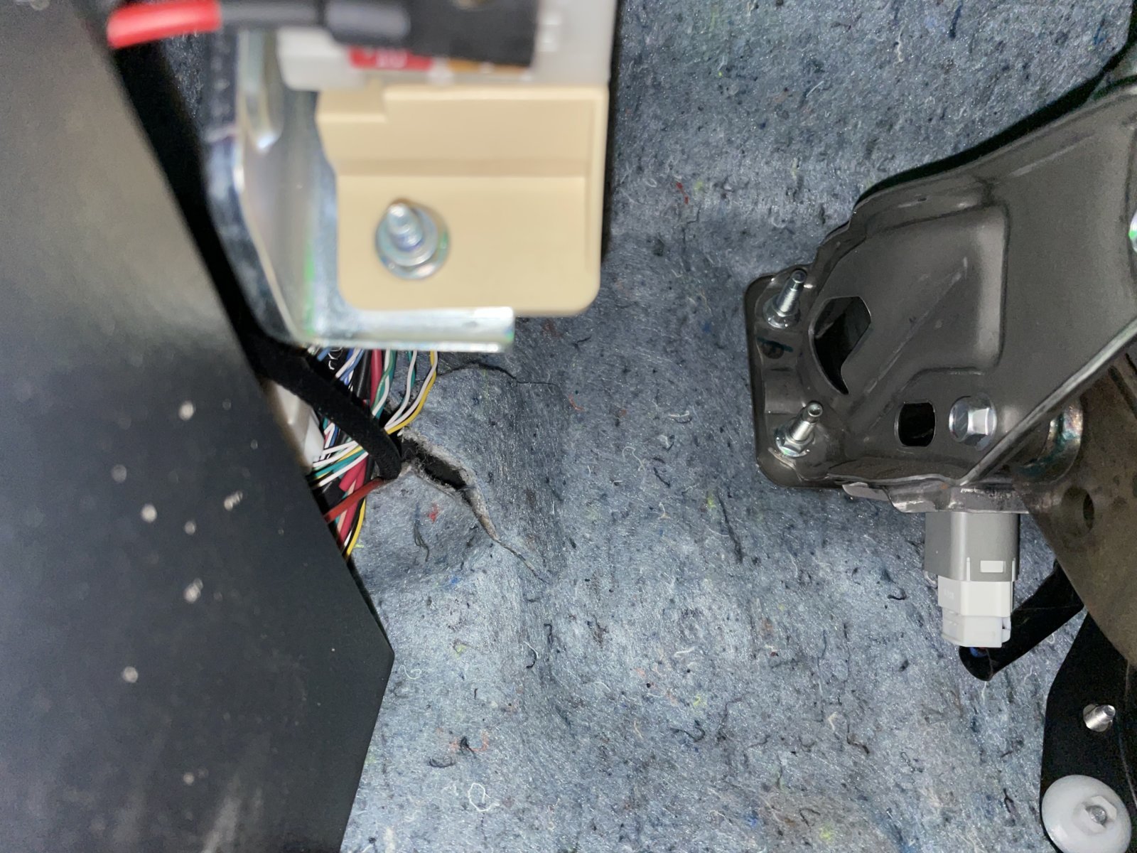

    I have a 8 gang Auxbeam that I'm planning to install. Can anyone post pics of where you are running the wiring through the firewall, from the engine compartment? I've heard to cut a small hole near the factory wiring loom that is running into the cab. Any info, suggestions are needed. Thanks TW

    Yeap it’s just the regular grommet. Just poke a hole through it with a screw driver. That black wire belongs to my aux beam.
    The red wire is my add a fuse for the aux beam panel located in the engine bay. My key needs to be turned for the auxbeam to get juice.

    Thanks for the pic. Is there any chance of getting a pic of the grommet from the engine bay? That's what I'm looking for. Take care

    It’s just against the firewall on the driver side. Not my personal pic tho so you won’t see my wires going in it.
    just slice a small x on the side of it with a razor then poke a screw driver through. Just be careful not to stab the harness. Some people like to silicone after to keep water out but I’ve never had any water leak through there.
