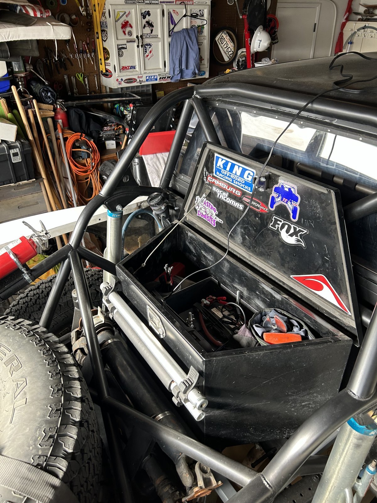

    IMG_2435.jpg Question;
    I picked up the 8 gang Bluetooth dealio and Auxbeam says to ground to battery terminal only. My battery is in back behind cab in a battery box inside a toolbox lol… got positive bus bar up front and was planning on grounding to frame but… so the question is have any of you ground it the frame or only battery terminal? Any ideas? Didn’t want to wire all the way back or place it in back exposed…

    #427841
    99
    Hm... strange, my instructions said to ground to chassis. However, I haven't hooked any lights to it yet (lights and HAM radio coming)...

    #506
    BigCountry762x39
    BigCountry762x39 Well-Known Member
    Dec 13, 2022
    #413129
    1,847
    TL
    PNW, Oregon!
    2009 Tacoma, with the cool white paint peel
    Arb Deluxe bull bar Front Bumper Ironman4x4 12k winch synth line AFE Intake OME 2.75in Dakar Leaf springs (R) Fox 2.0 bypass shocks (R) Bilstein 6112 (F) 33's on KMC wheels off road lighting comfort mods Redrock HD roof rack Retevis rt95 Radio Slotted Rotors and HD pads
    eh... my nilight or auxbeam are all grounded to the chassis. not a one to battery, no issues other then one of mine the control lights quit working but still functioned. but that I'm sure was not to do with the ground.
    and a new control was sent out and ran like a champ yet again.

  7. Jul 23, 2024 at 4:29 PM
    #507
    soundman98
    soundman98 Well-Known Member
    May 31, 2021
    #367288
    6,014
    NW Indiana
    '18 Taco Sport, '14 Ranger
    i suspect they're saying this to remove any other issues out of the system.
    there's absolutely no issue with grounding to the chassis, as long as you are also/previously added a larger ground wire from the chassis to the battery to properly support the additional electrical loads the switch box will create.
