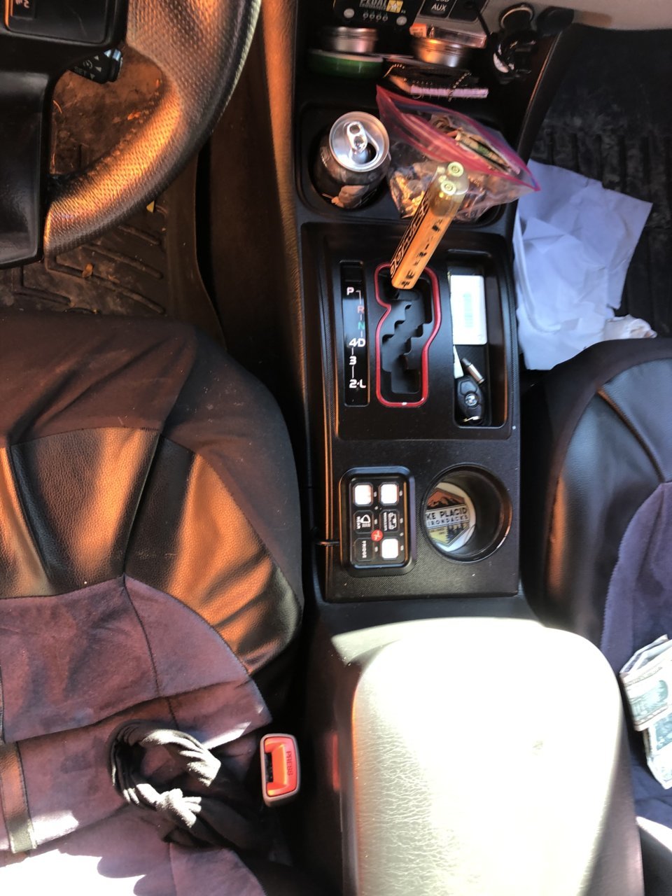

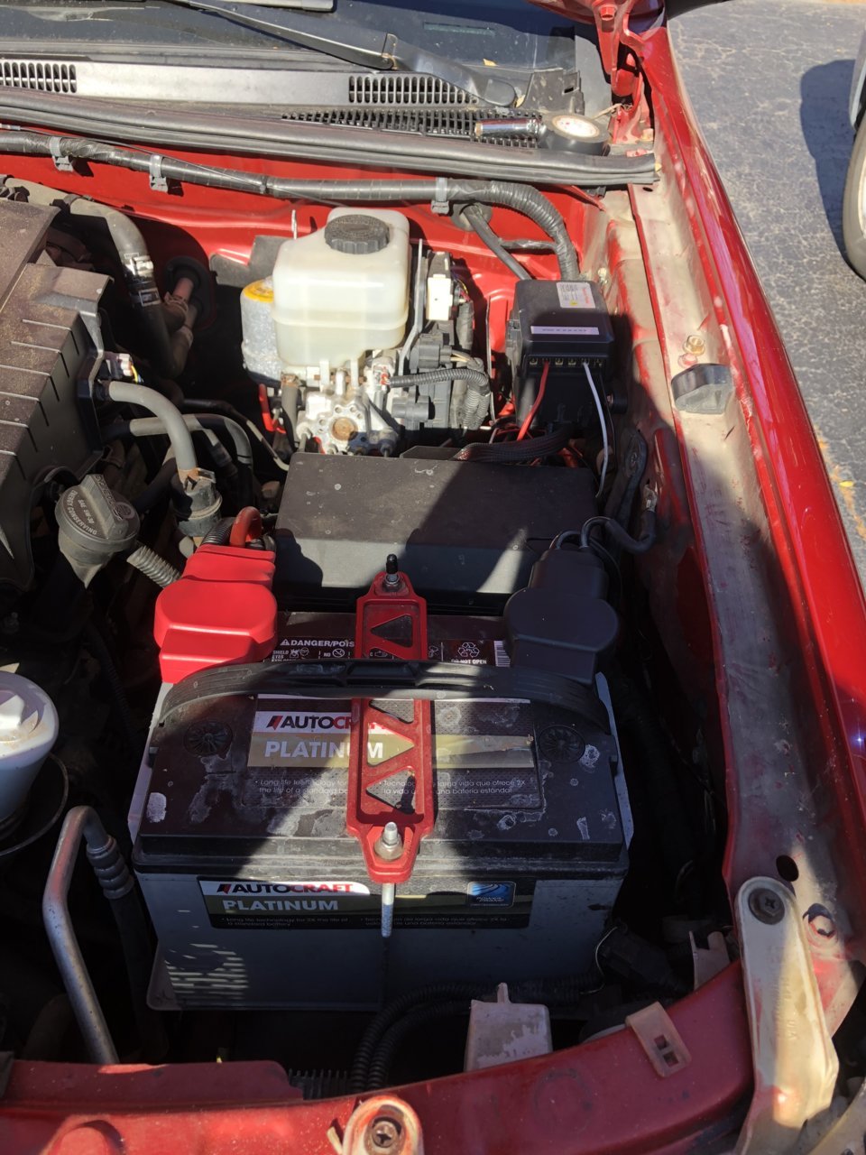

    24F2329A-6A10-48FB-8C14-9DBCB41FFAFC.jpg So I went with the 6 gang newer style with auto dimming feature. The auto dimming is nice and actually works quite well. Easy hook up and works like it should. Can’t complain 32ED9EFD-BE4C-4849-A49E-3AB37BC63EFC.jpg
    truck is a mess I know

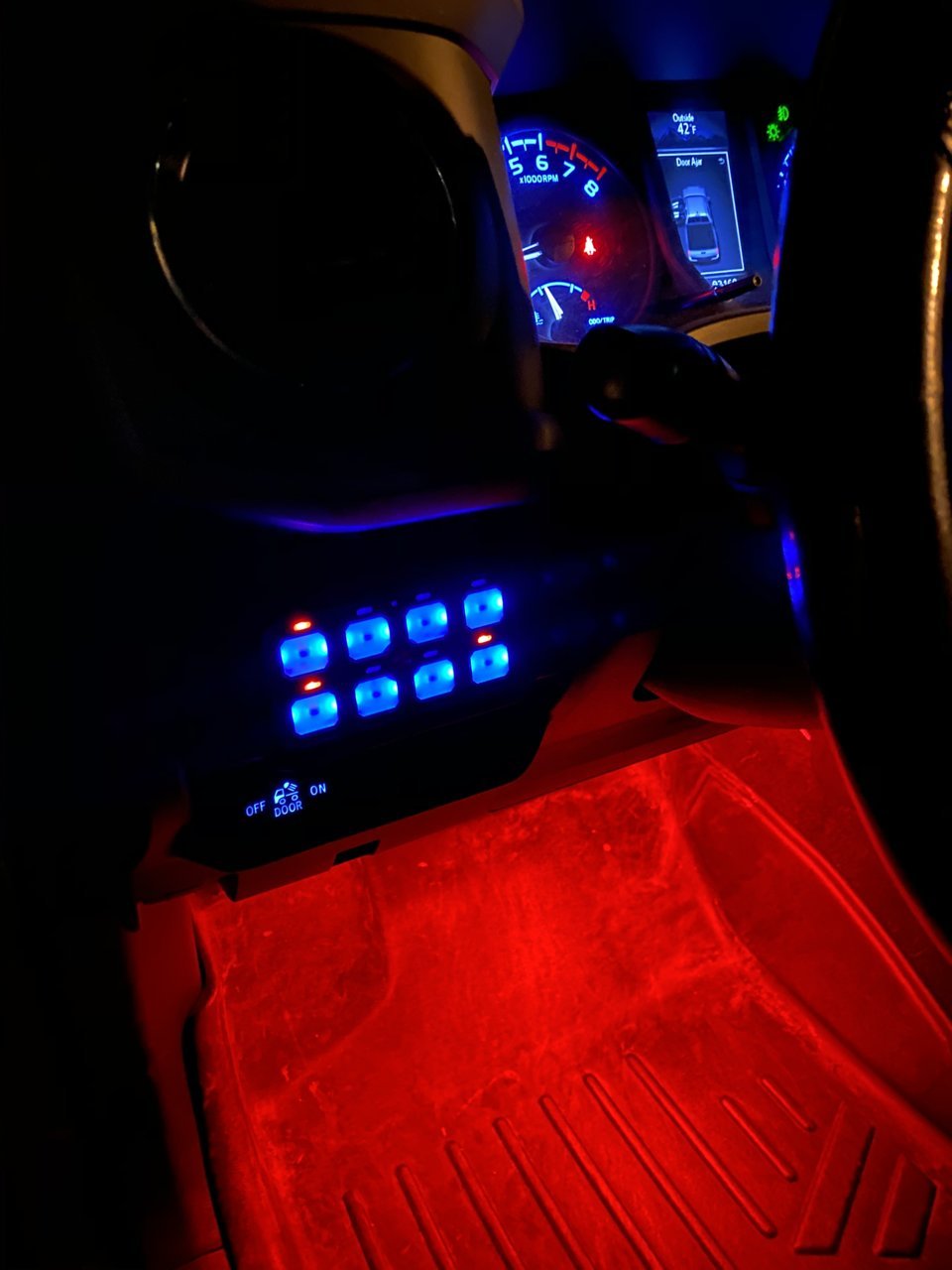

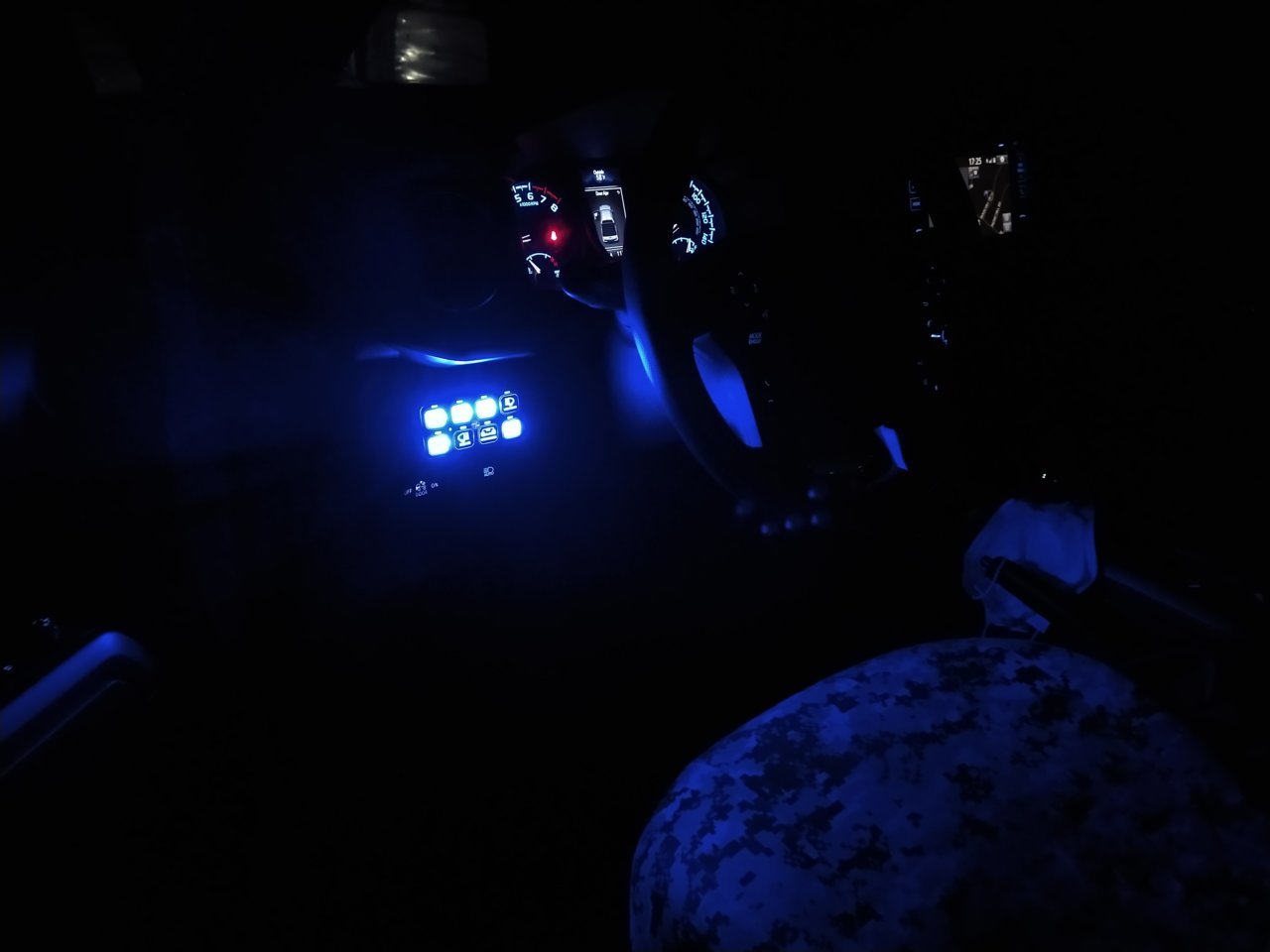

    Here is a picture of my switch at night. Just a comparison with the brightness of the other dash lights.

    There a wire that is attached to the fuse box that dims the board lights lol
    If you look at my previous posts, I wired the dimming wire to a momentary switch. That way I can adjust the board brightness in my cab. Other people adjust the brightness by touching that wire to the battery positive terminal.
    Look back at your install instructions and it will tell you which one is the dimming wire.
    Also, you should cover up your blank switches with the black stickers provided.
    My brightness wire was also white.

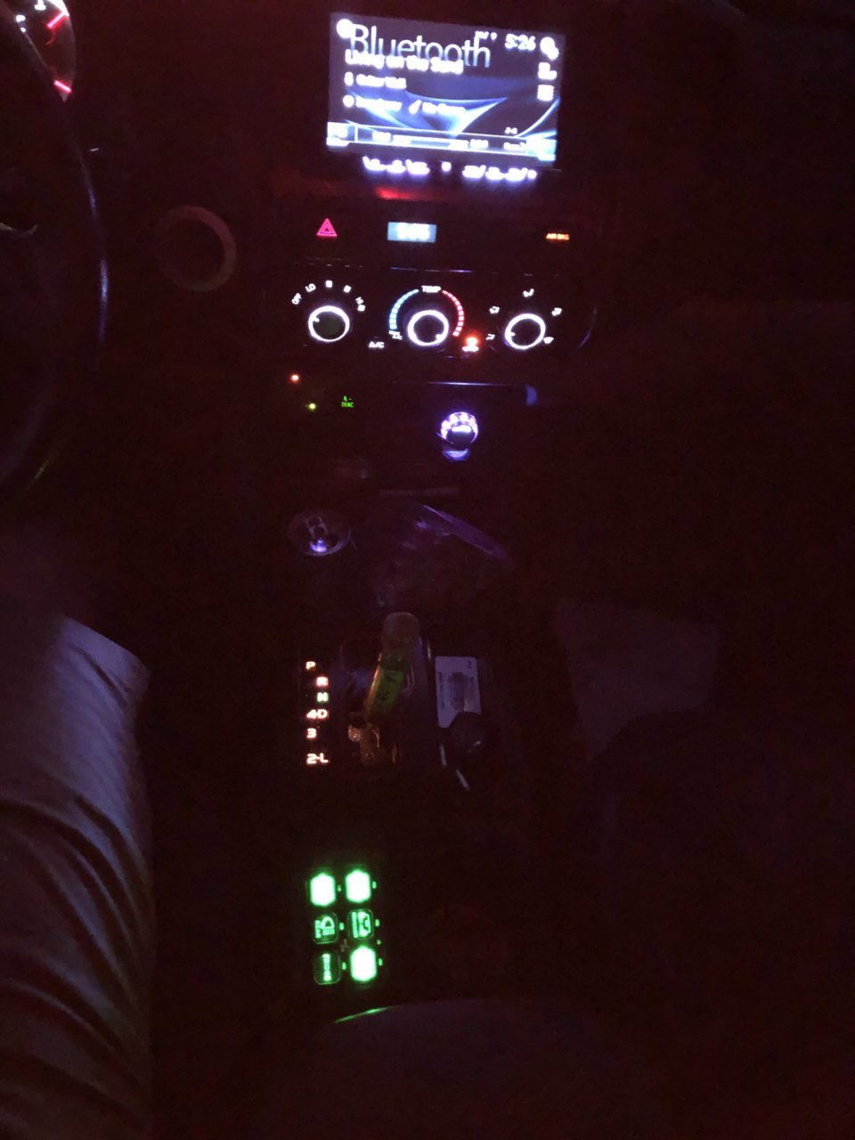

    Night shot. Not any brighter than have 14848102-460E-4202-96F5-714D20DB256D.jpg

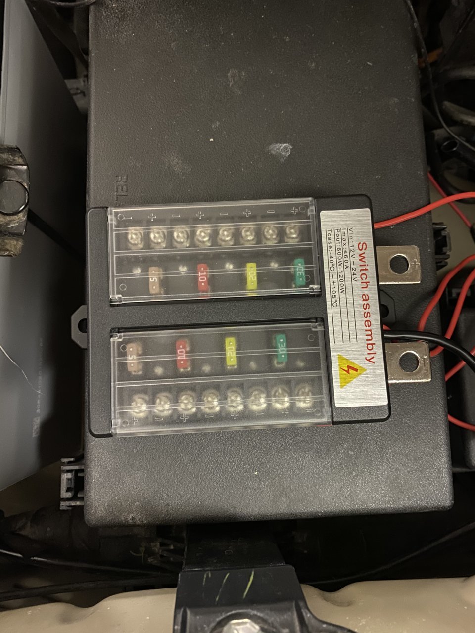

    I’ll take pics of how I wired the stand for the fuse block I basically took my caliraised relay holder and drilled in two holes where i could attach the new bracket to it in the same spot.
    I wired up my light bar and ditch pods as well as footwell lighting to it.
