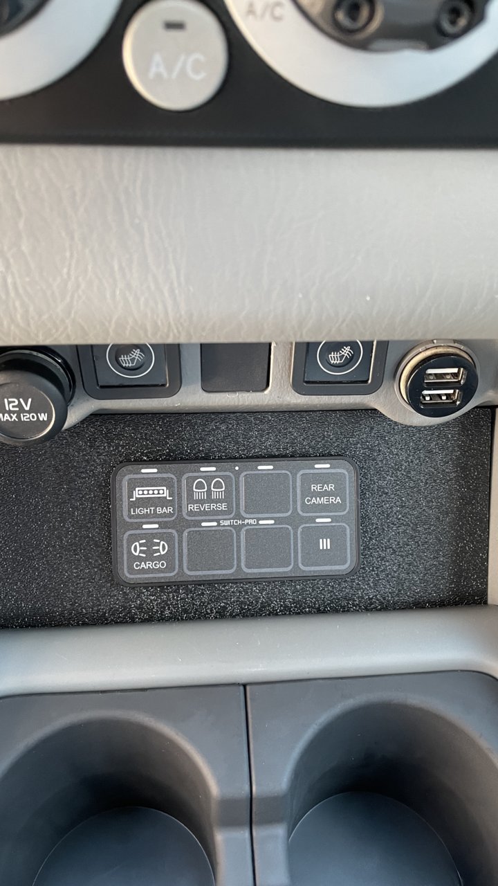

    I finally got the switchpro 1900 it’s pretty sweet 9D2801DD-6B87-4E95-8995-3BF18EA58617.jpg

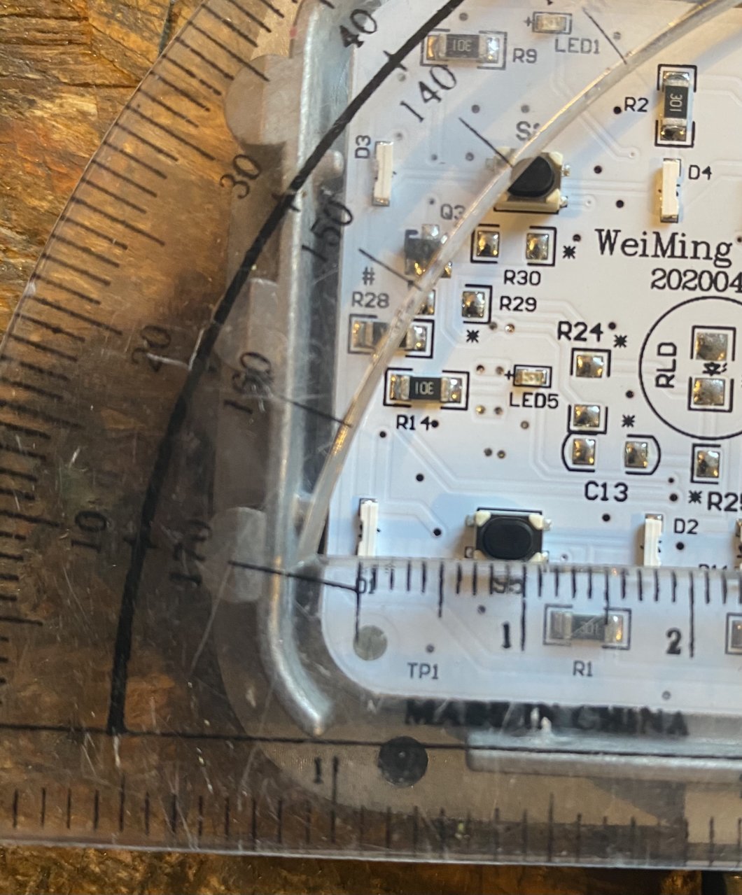

    steveo27 Ask me about my weiner
    Aug 12, 2013
    #110326
    6,077
    Steve
    Pittsburgh
    '11 TRD Off Road & 1992 VW GLI
    The same shit everyone else has.

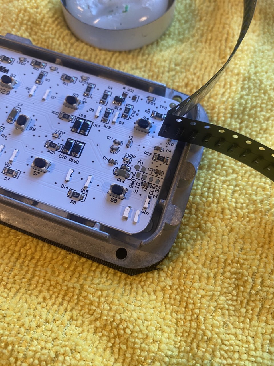

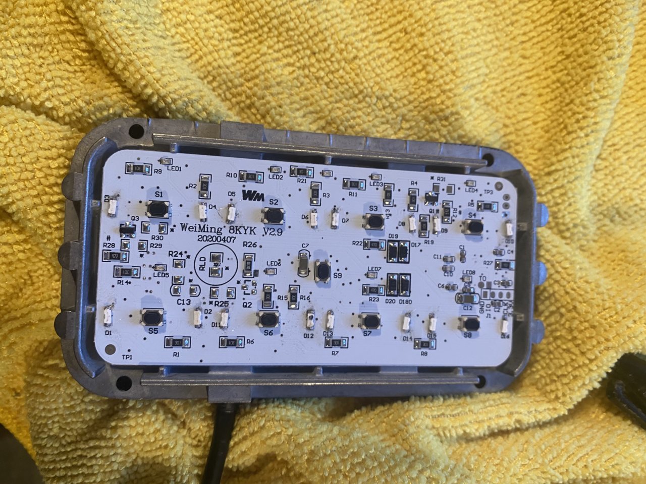

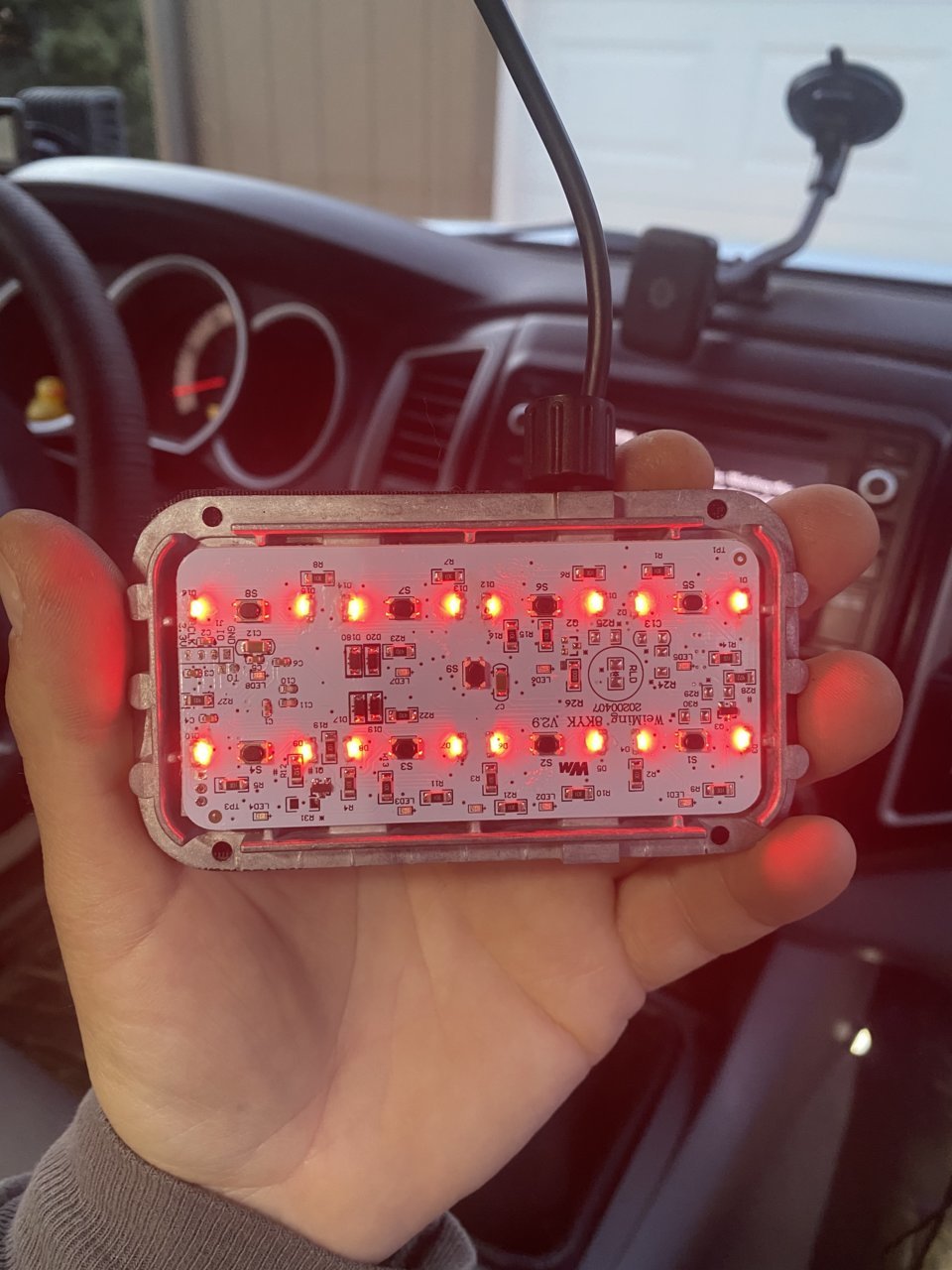

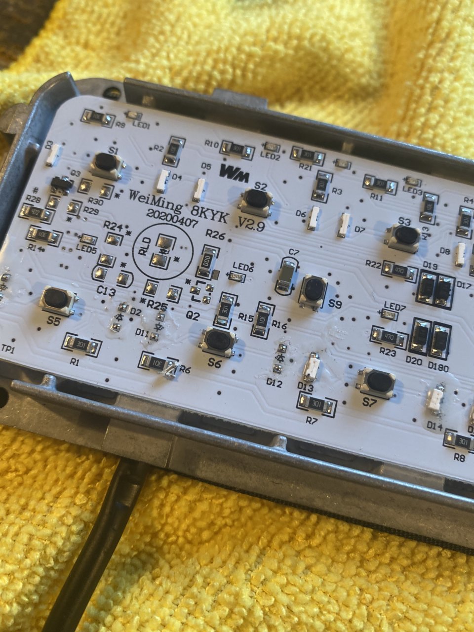

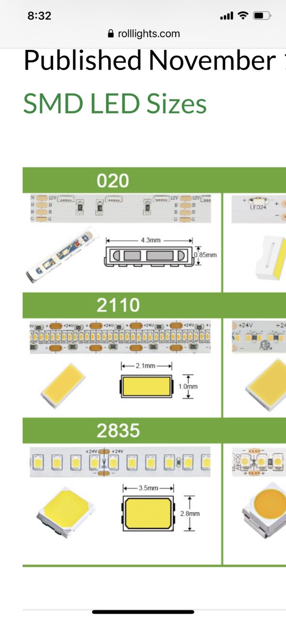

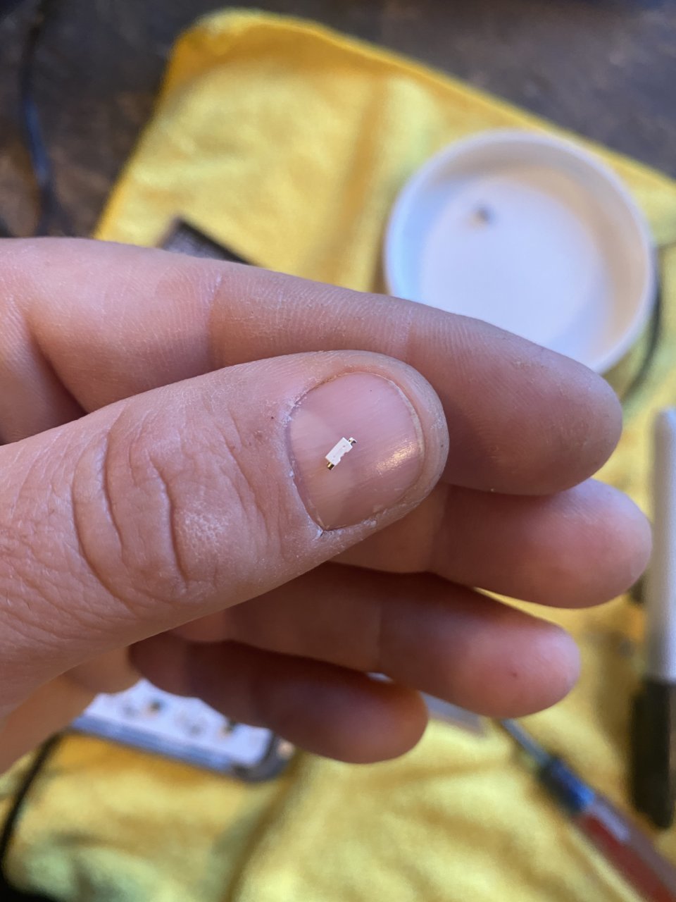

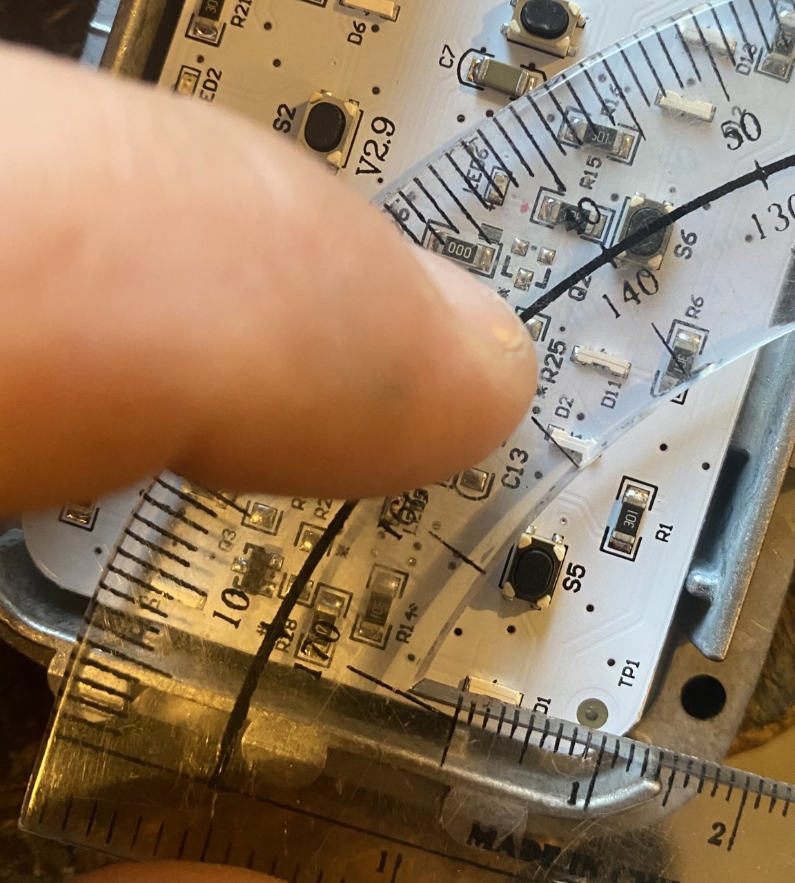

    upload_2021-4-21_20-29-1.jpg upload_2021-4-21_20-29-14.jpg upload_2021-4-21_20-29-40.jpg
    Roughly 1mm x 4mm. Side view. 020 SMD LEDs seem to be the closest match.
    I ordered a bunch and I’ll update once they arrive.

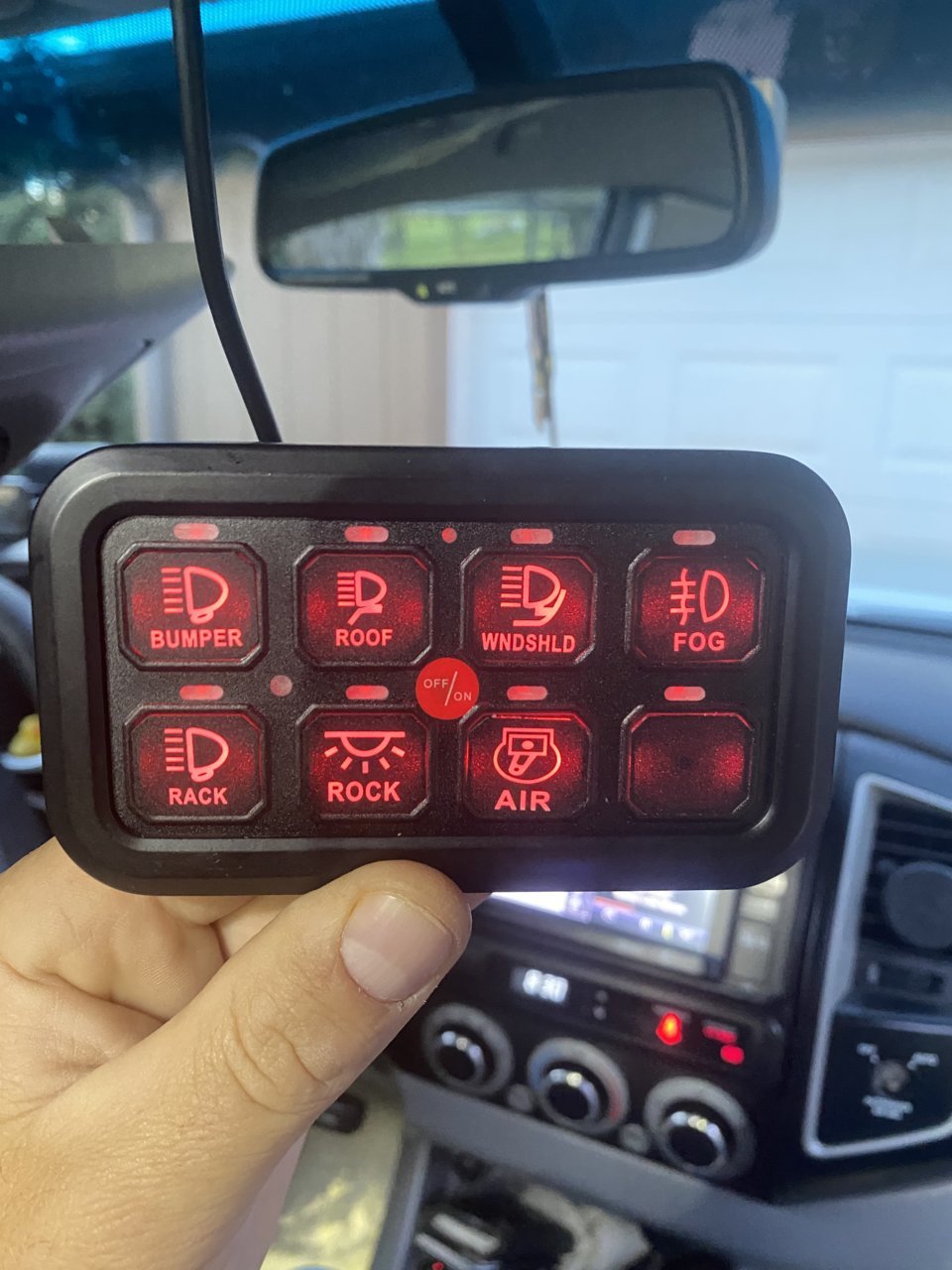

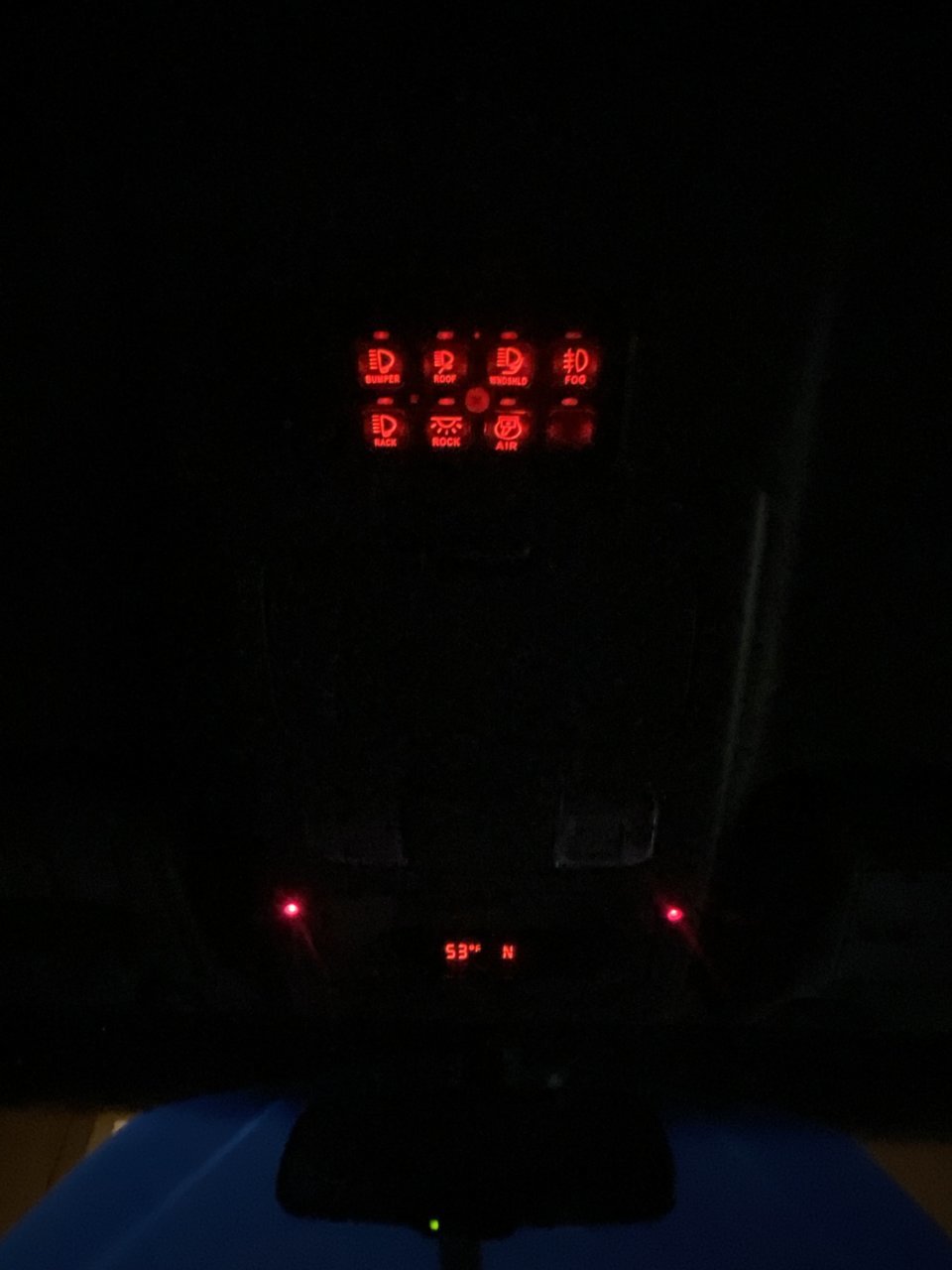

    The self dimming blue isn’t as bad as I thought it was going to be, don’t really even notice it.

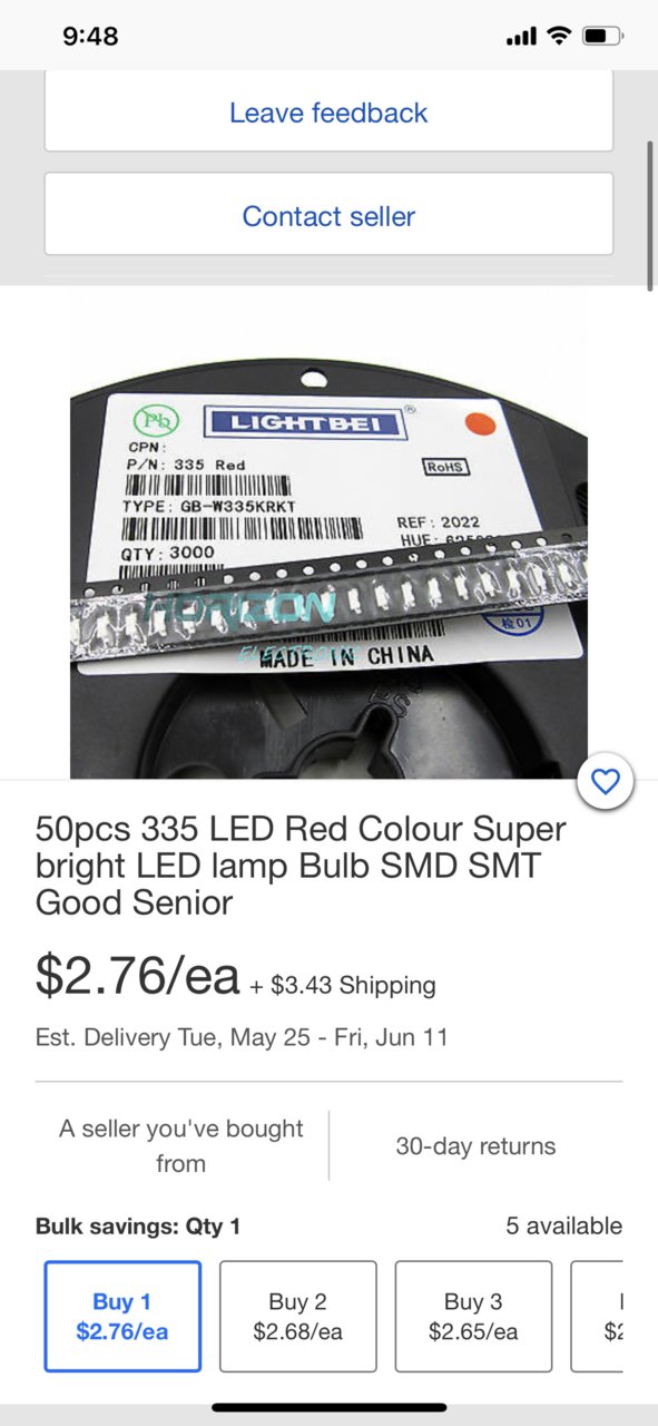

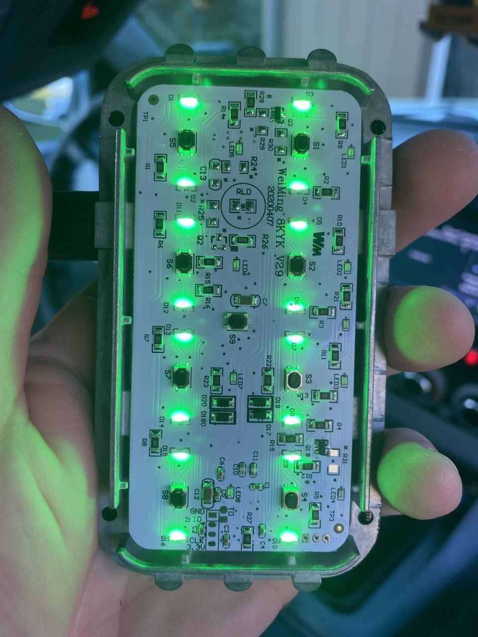

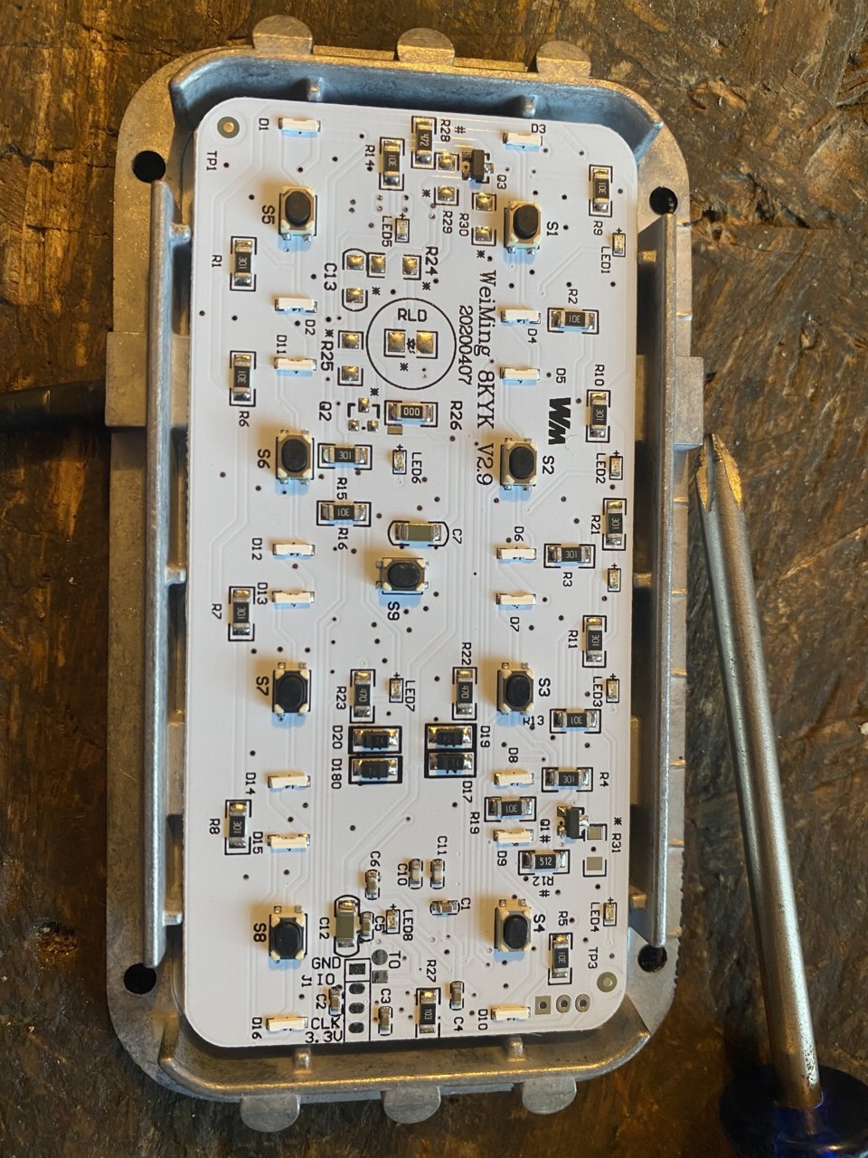

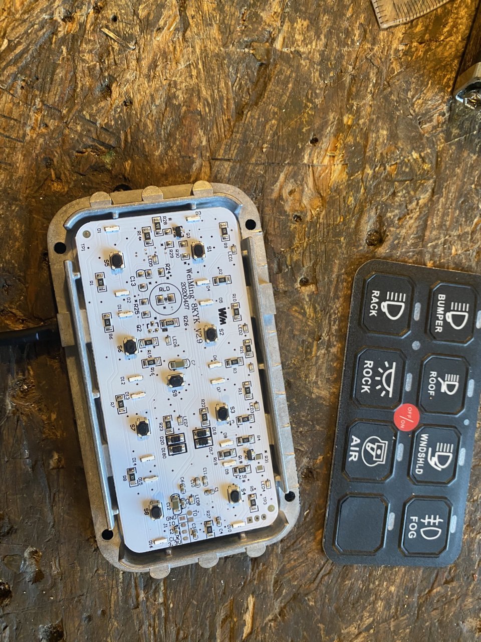

    Ok. So. I ordered 2 different SMDs. 020s and 335s.
    Here’s a comparison shot. The 020 is on the right and the 335 is on the left.
    The 020s are the correct ones but the 335s have a bigger contact surface to solder as you can see here.
    I used the 335s because it would be easier. Here’s what I ordered.
    You can see the factory 020s across the top and the replacement 335s across the bottom here.
    It ain’t pretty but it works.
    I have a roll of 100 red 020 SMDs if anyone wants them. Just pay shipping.

    Nice work!
    How hard was the install?
    I am having trouble finding amber 335s. Do you remember seeing them anywhere?

    Thanks.
    It was super easy, but I solder shit at work all day.
    if you’re comfortable with a soldering iron you should be fine.
    I do not remember seeing them but I specifically searched out red ones.
    Try AliExpress, that’s where the 020s came from. They seem to have a lot of stuff you can’t find here.

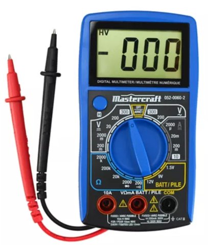

    Be
    This is the most important tool when doing any electrical work. A multimeter will tell you exactly what is going on and what has power.
  20. Jul 12, 2021 at 3:37 PM
    #140
    dagobert
    dagobert Well-Known Member
    Apr 20, 2021
    #363308
    234
    You peeking in my tool box? That is the exact meter I have!
